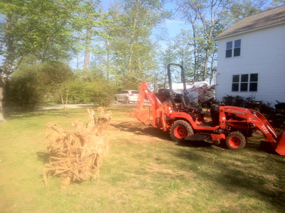

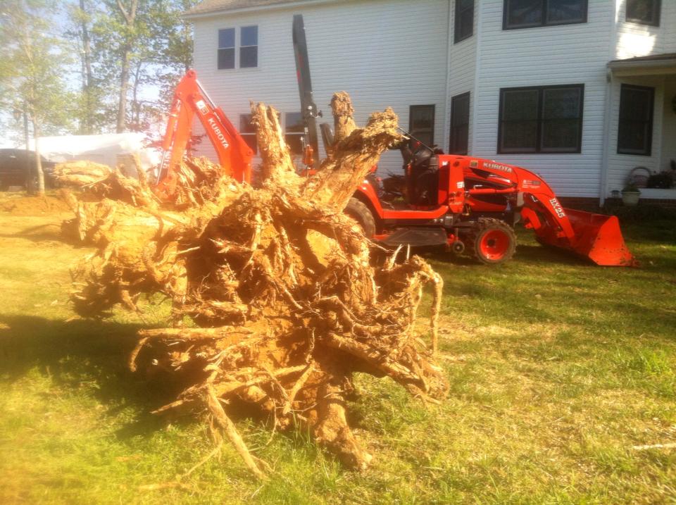

Well;
This girl got her very own tractor in May, and took out her first stump. I bought a Kubota BX 25D 4WD, Loader, Backhoe, Scraper, and mid Mower setup. My first stump took me a while, with a 25hp but for a home with 2.5 acres, it was just the right size. Did I mention I had to put weight in the loader to keep the front wheels on the ground to move it to the burn pile" :)

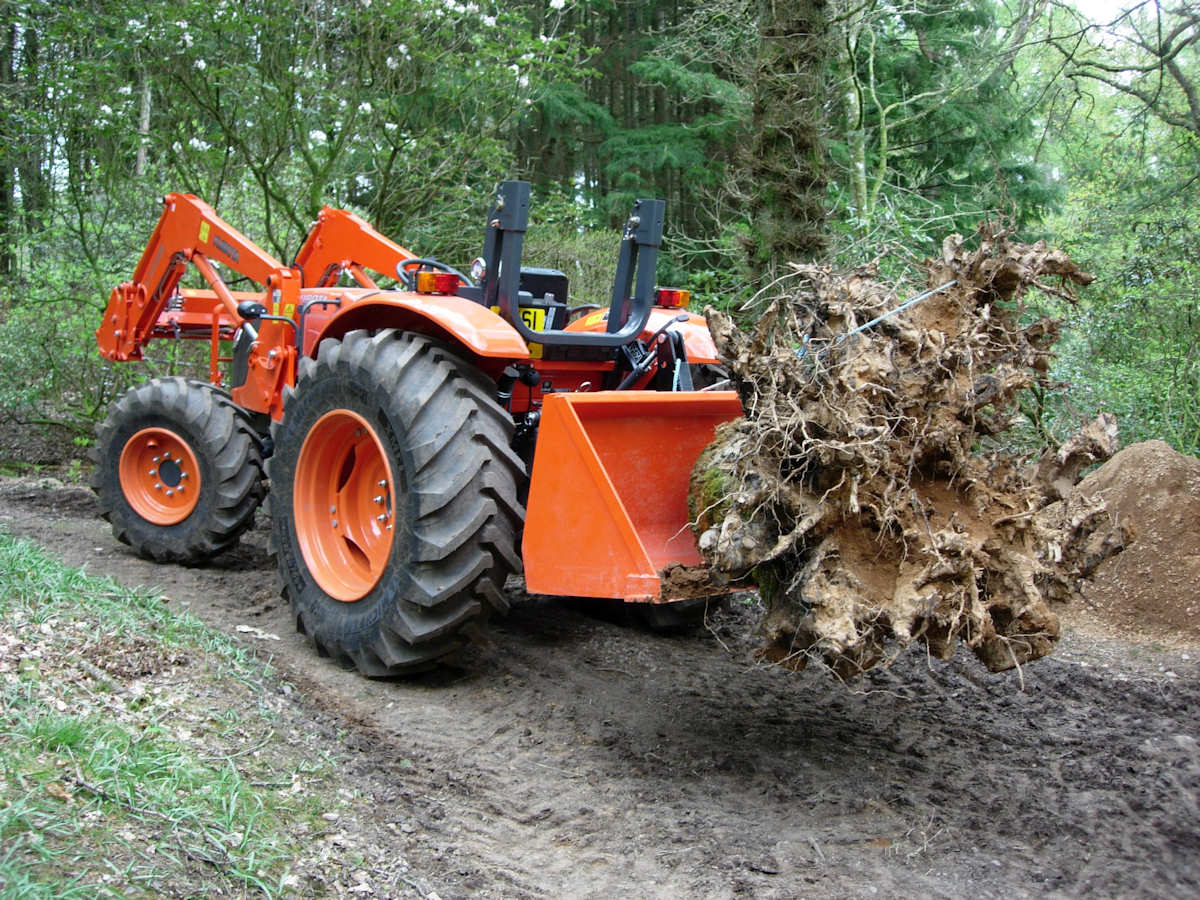

Just a thought - I have found that big stumps are most easily removed while still attached to the big, heavy tree..... method:
1) Attach a wire rope as high up the trunk as possible.
2) Dig round the stump
3) Use a winch on the wire rope to pull the tree over, the trunk acts as a huge lever arm.
4) Cut the stump away.
One I did earlier:
