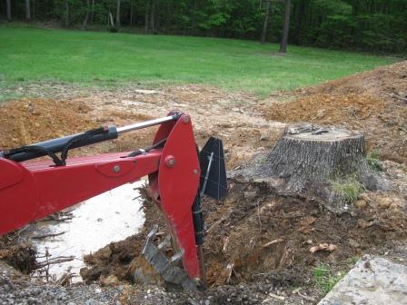

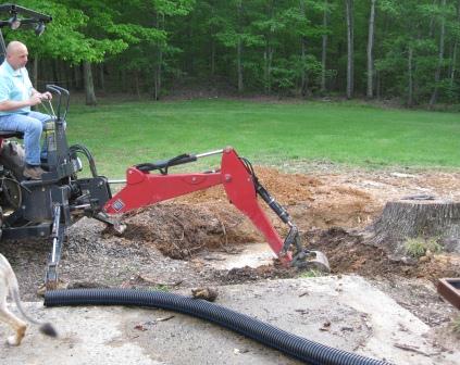

I recently removed a stump that was my worst yet. I ended up cutting some large side roots with a sharpened grub ax. The backhoe wasn't strong enough to pull the stump from the remaining soil so I filled the hole with water and let it sit overnight and the remaining roots came out of the lower soil using the dipper. I had a big problem getting the stump out of the hole and then pushed it into the woods. I am 5' 11" 240 pounds and my arm span is 6 feet 3 inches and overall it may have been larger than seven feet.

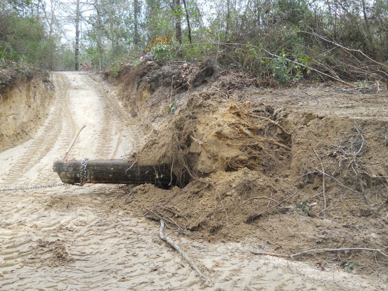

I pulled this one while I was building a road up to the back of the property. I did have to cut one big root. I keep a cheap saw for cutting roots and dig away the dirt and toss a 5 gallon buchet of water to rinse it off before cutting. The tractor is a FarmTrac 390 HST.

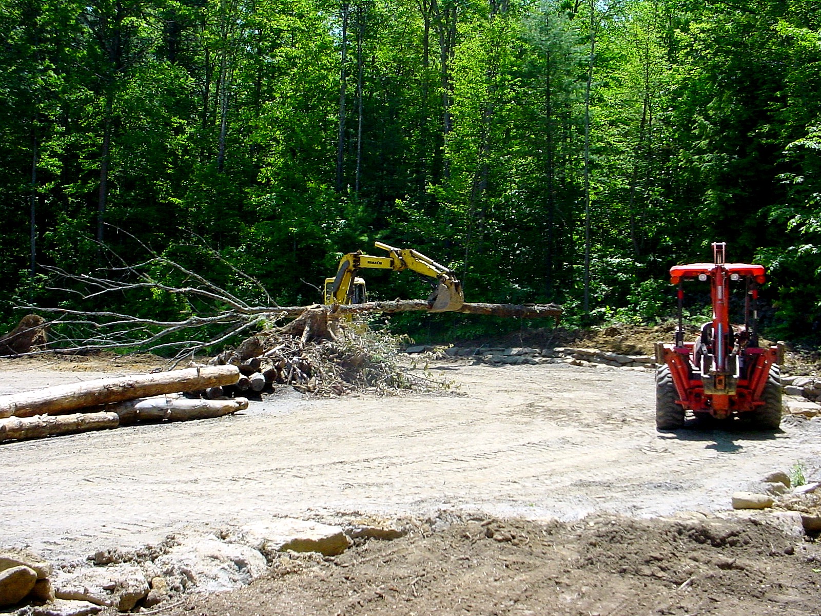

Am I cheating using an excavator. Seriously you guys are tackling too much with too small equipment.
Just to let you know I do the same, I really should have a 12-15 ton ecxavator and a full size TLB

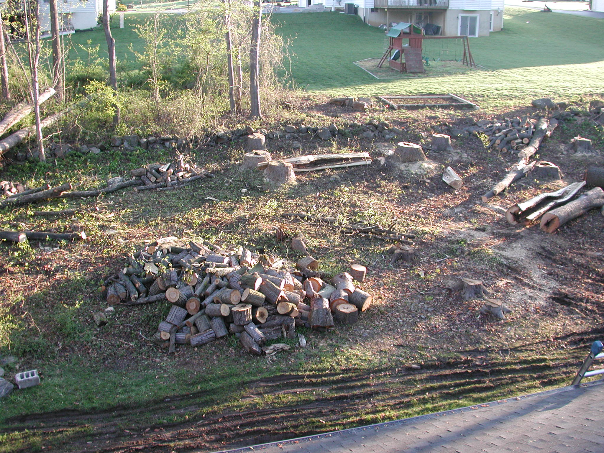

Friend of mine had a bunch of trees he asked if I would dig out once he had them cut down. I told him to leave 3-4 feet of the tree intact until we got them loose. Sure, no problem. Apparently the guys he hired to cut the trees didn't get the memo. So, I now have about 25 oak stumps from 5-20" cut off at the ground to deal with. I think he has one that is about 24". I have half a notion to tell him to bore holes in the big ones and use the acid method to soften them up and we'll deal with them next spring.

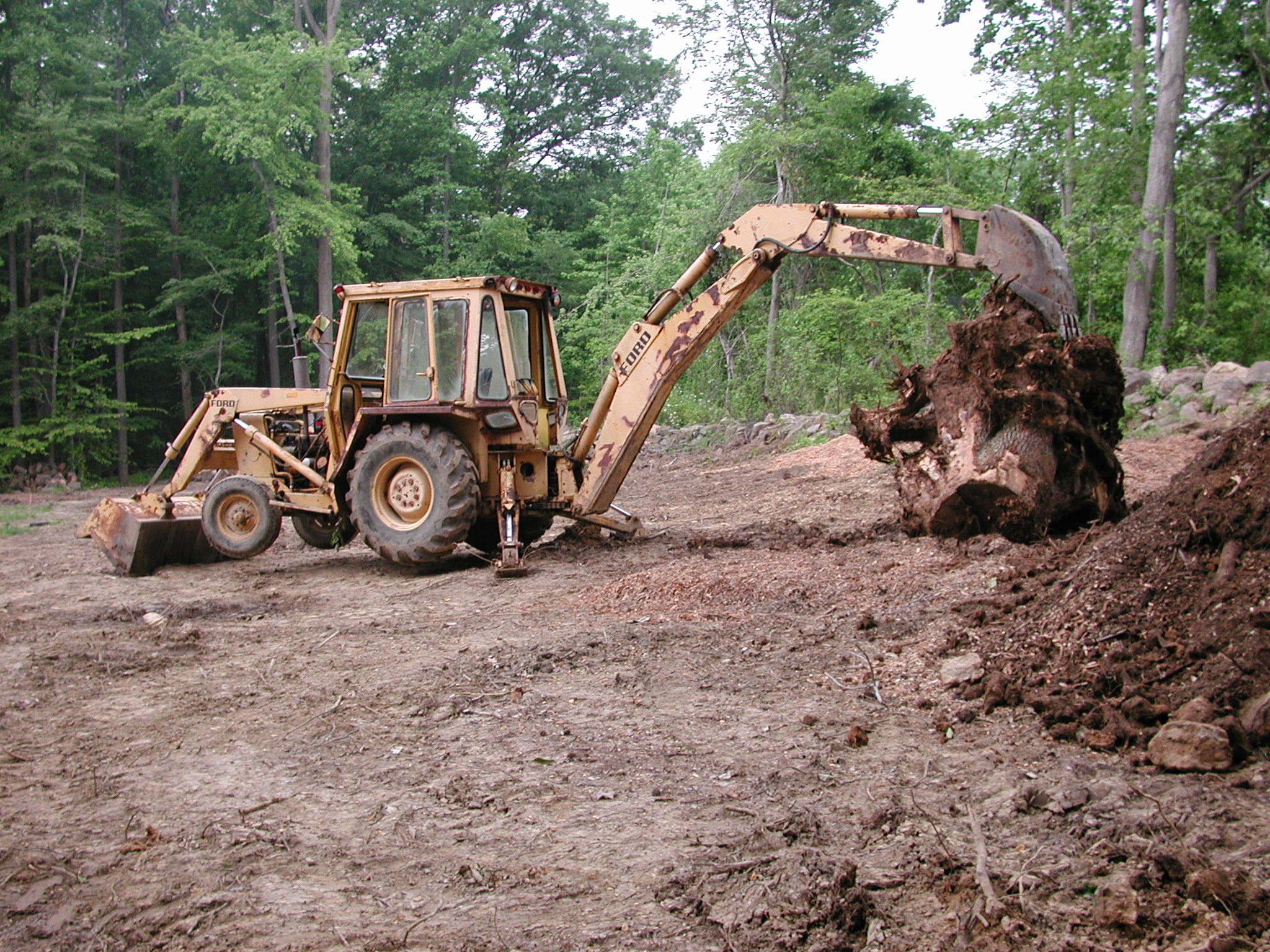

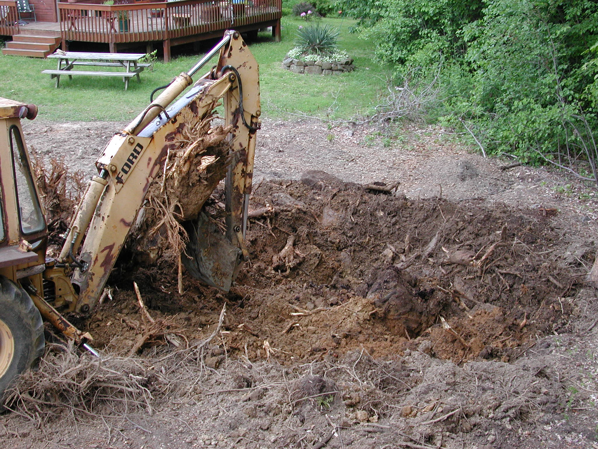

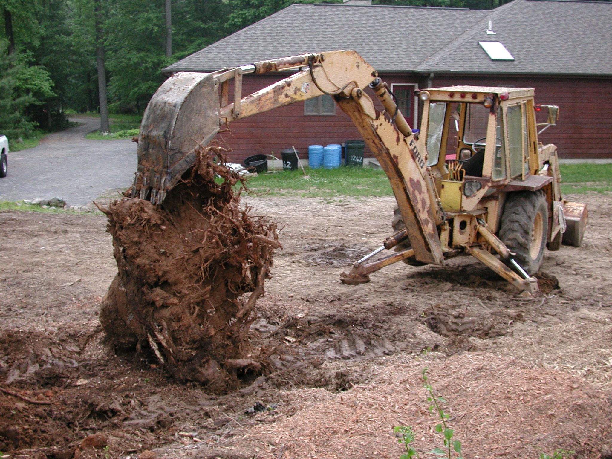

I just dig a trench around each one and break it loose. I use a full size JD 310A. Prior to that I had a 73 Ford 4500.
Yes even a full size backoe isn't quite enough. Once you break it loose you have to pretty much shove the big ones around cause they will make the hoe do a wheelstand LOL
