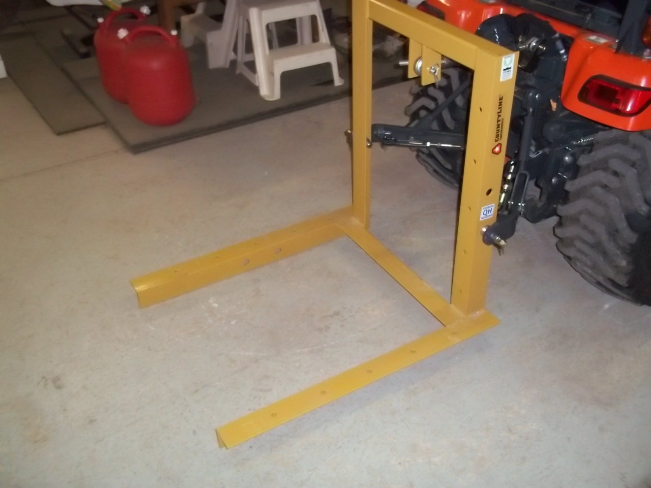

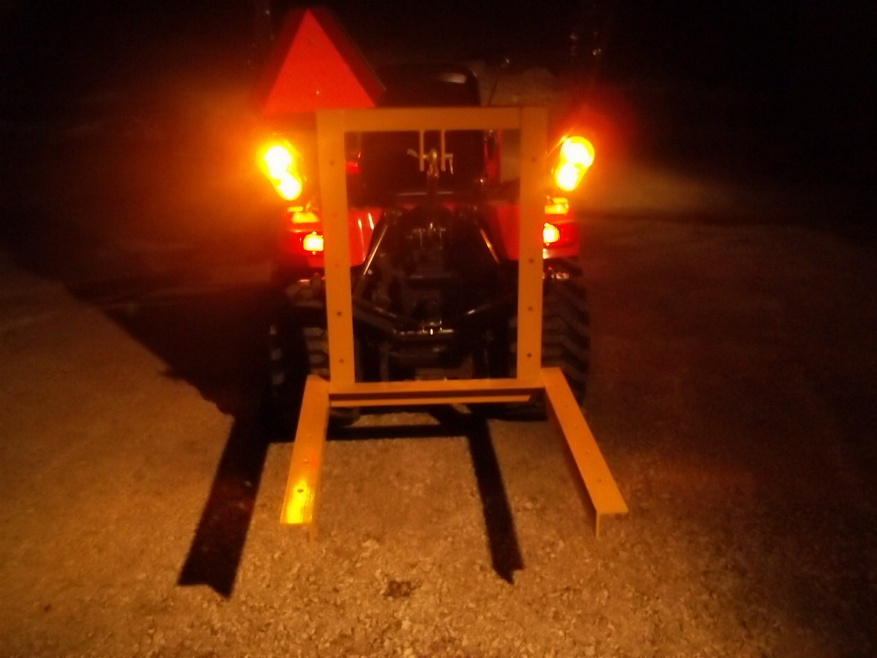

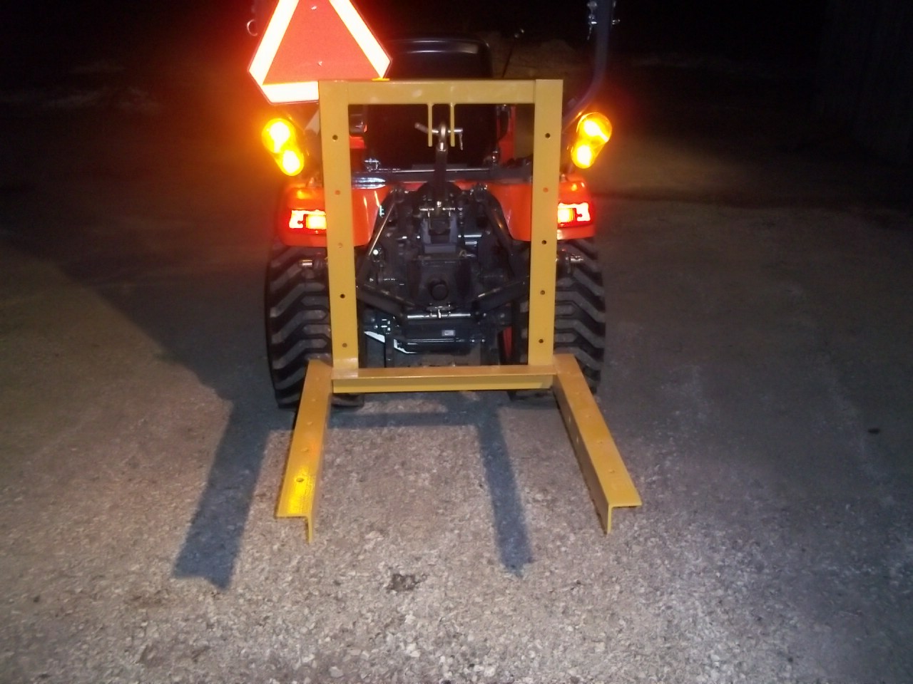

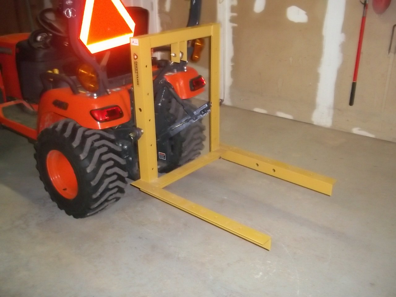

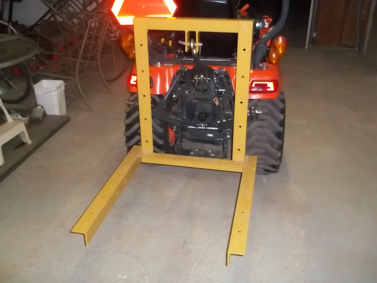

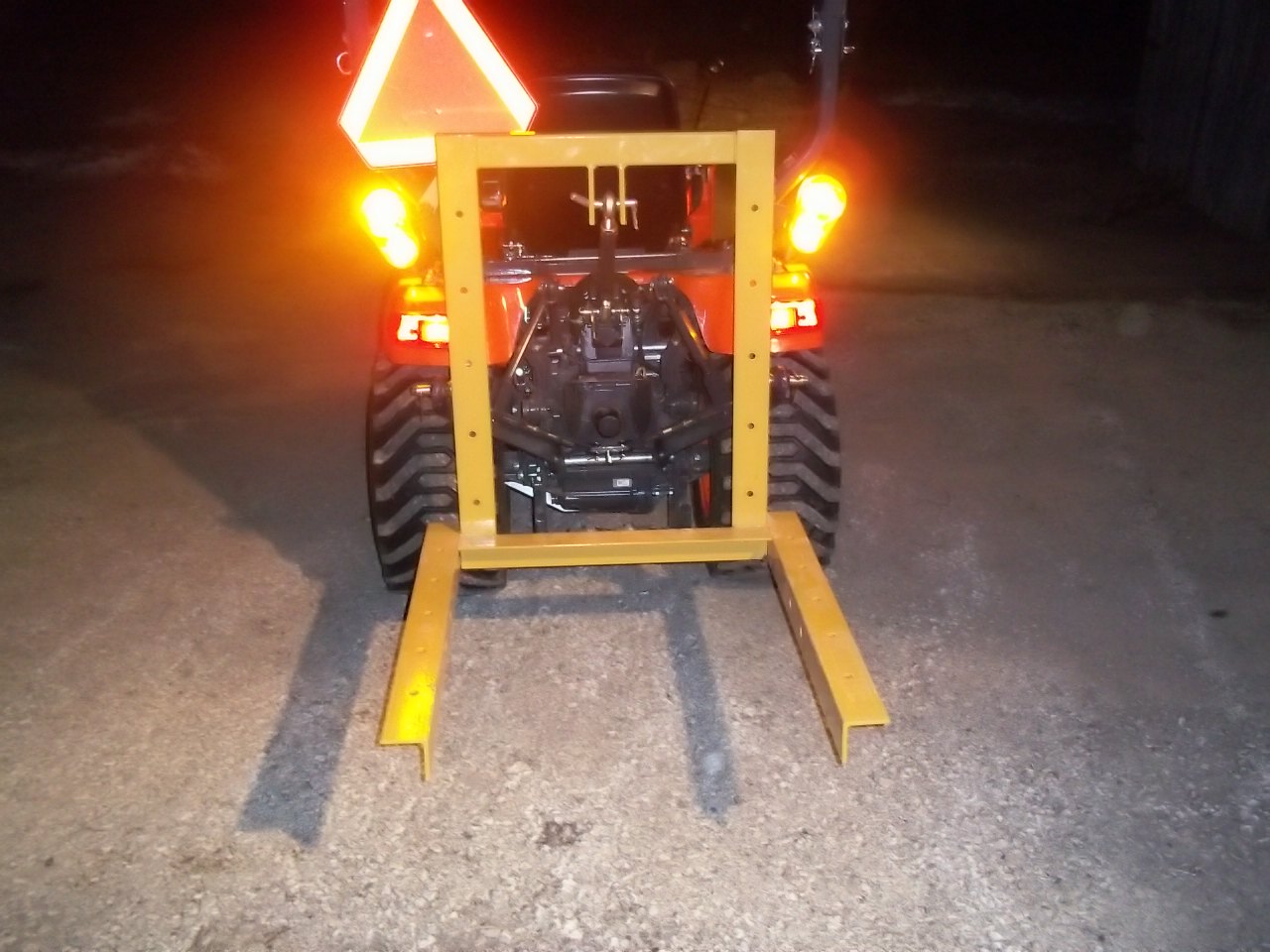

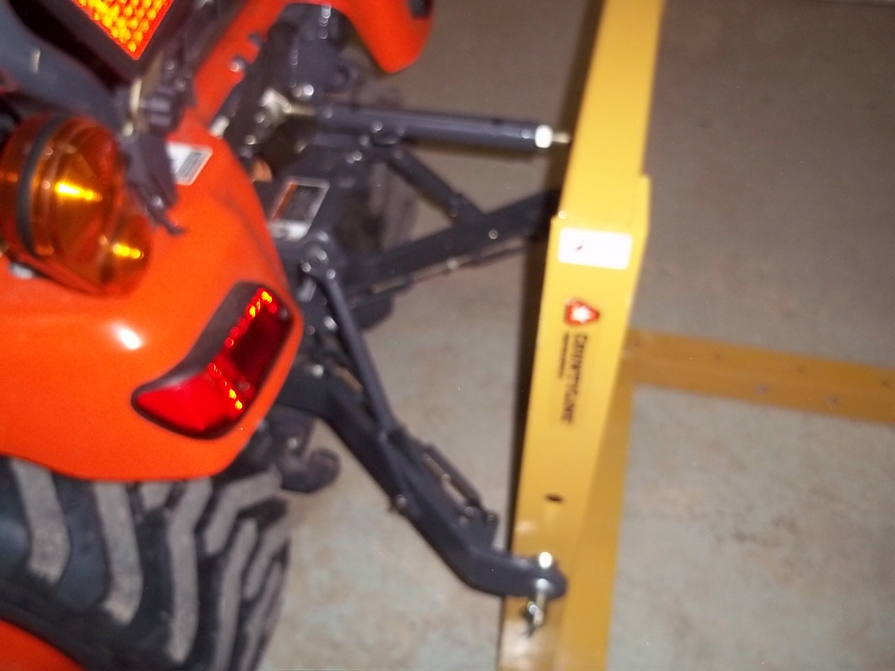

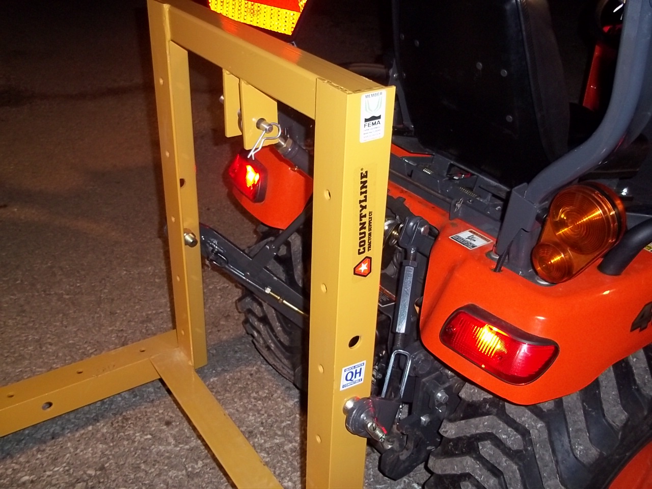

Here are some more pictures:

So, I'm thinking of making the deck 48" wide since the tire width is about 42" and the loader bucket is 47". What do you think?
   / My Carryall Saga... #59
48 is a good, round number. You can buy three, 8 foot 2x12's, cut them in half and have all the lumber needed.
   / My Carryall Saga... #60
You have gotten good advice..mine is:
Lynch pins and top link pins are standard items in our TSC store.. also available from TSC on line... but suggest you obtain in person... diameter and length are important and best understood in person. The Harbor Freight pins will work IF they are the right size for you..... they are too small for my application.
Recommend use of lumber, not plywood which will come apart over time.
Build as stout as possible... you may not think you will be lifting heavy stuff, but you WILL be.
I put a trailer hitch receiver on my carry all... great for moving trailers around.
