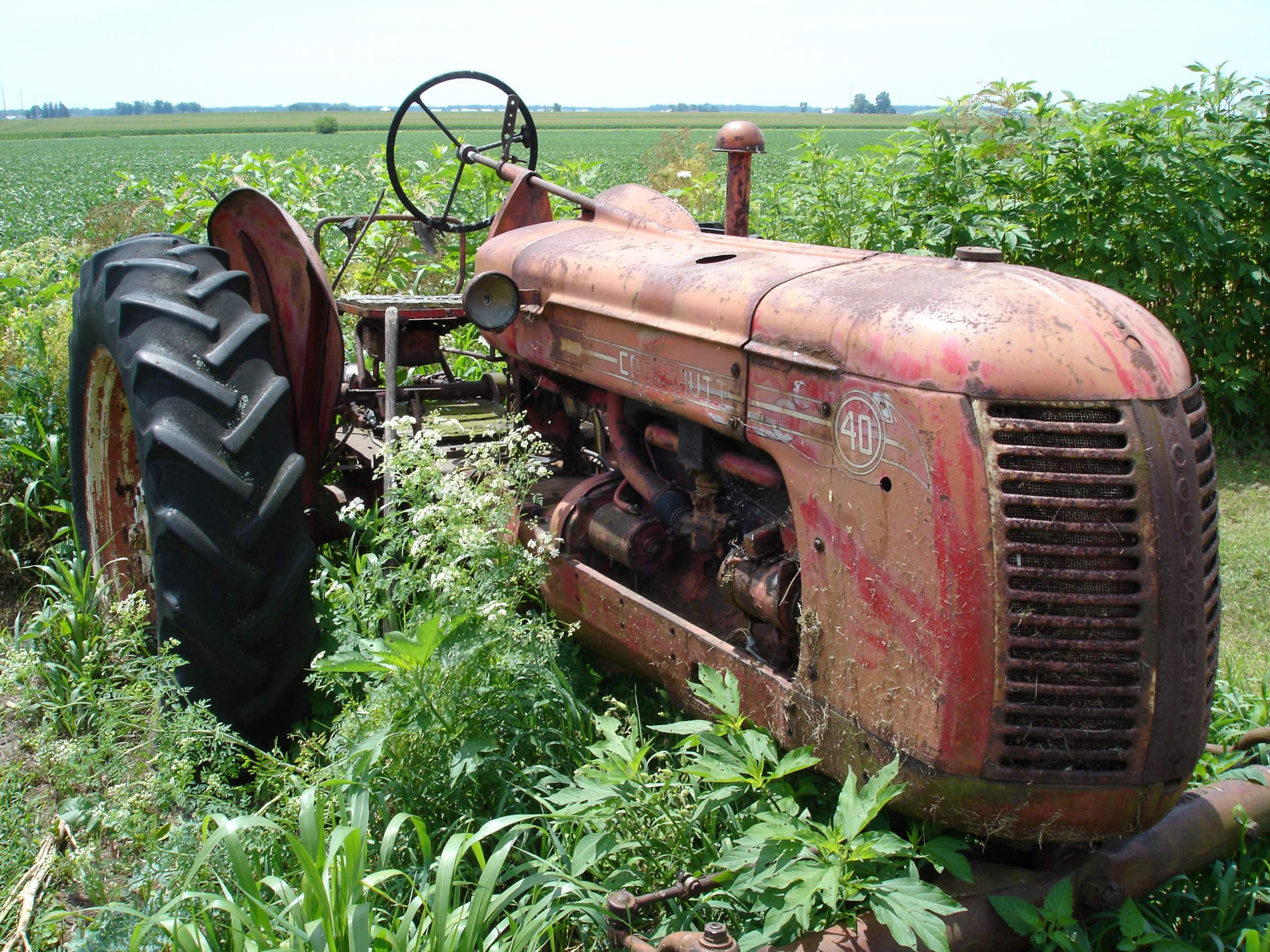

I have finally found a good project to keep busy for years.

Neato. The sheet metal on that 40 looks in good shape. That's my primary criterion for buying old iron--I suck at sheet metal work.
Have a ball.
Right now I'm restoring a 1951 Minneapolis Moline BF.

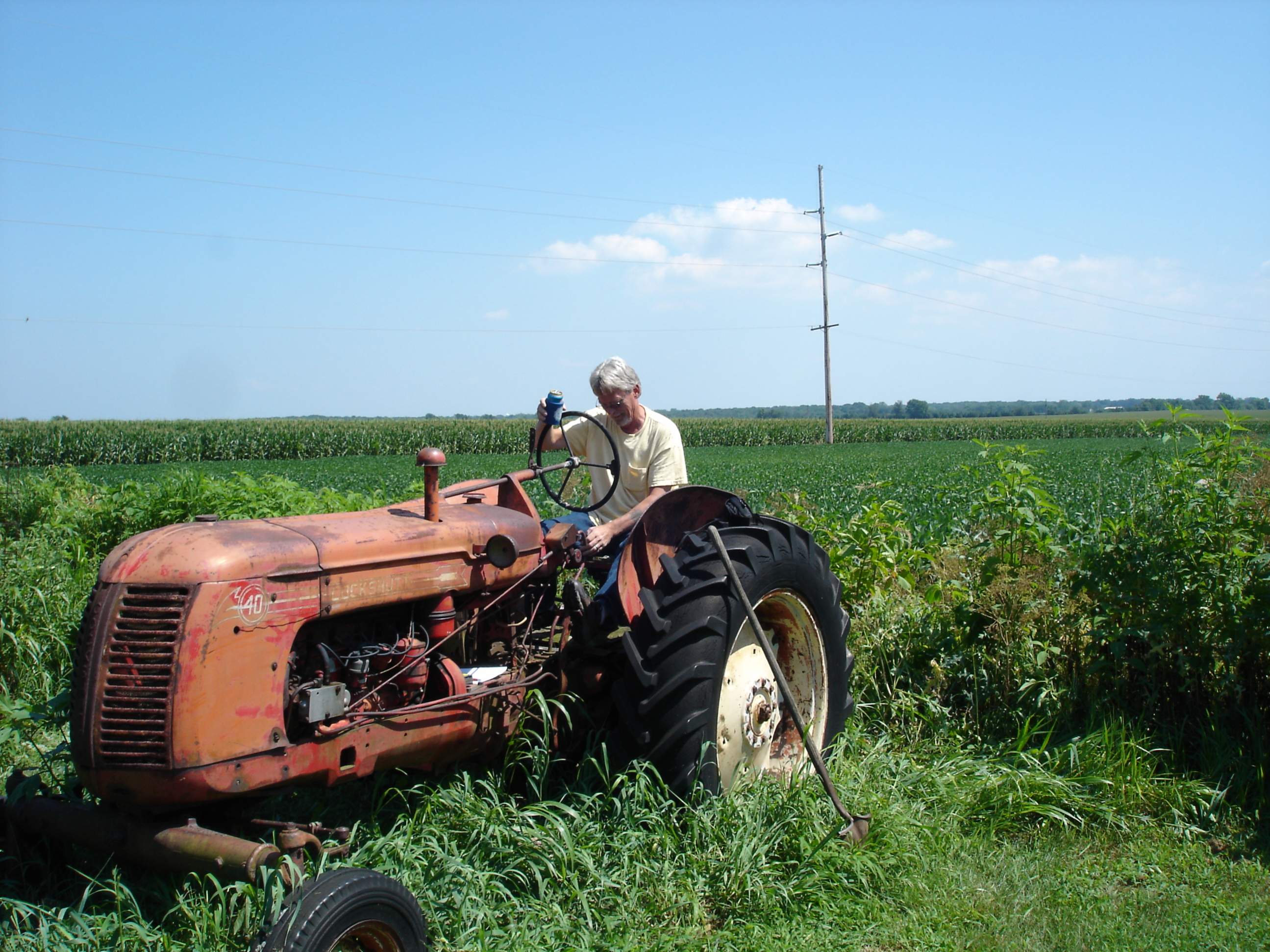

I got it home today. Now it's a foot taller. Was hard to see with all the weeds how much it sank in the ground.
Now I need a gallon of liquid wrench, I did get one brake working today and discovered it also has a parking brake.
This is going to be great. Unfortunately I have never done sheet metal work yet but do have friends that have Hot rods and old cars.

That thing is gorgeous! Please keep us posted with Pic's as you restore. Even if it takes 5 years....
I would be trying to decide where to start. Maybe a bit of cleaning and tinkering around the engine to see what the status is. Put some oil down the spark plugs holes, compression test, see whats up, etc.
Do you have any knowledge of it's past? How long has it been since it ran? Was it running when parked? I'll shut up now.

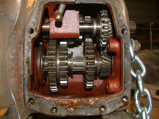

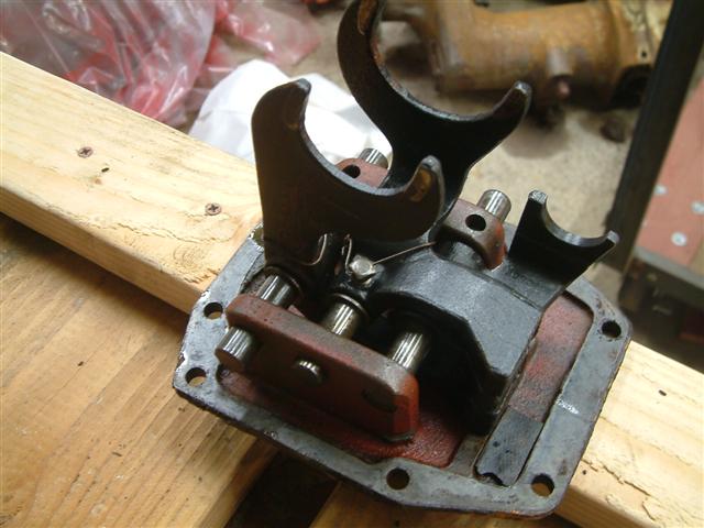

Not to worry. If that Cockshutt 40 tranny is anything like the 3F/1R box on my 1951 MM BF, it's simple as can be--a handful of gears, 4 forks and 3 rails.
The most difficult part is getting the all the forks to engage their proper gears simultanously as you button up the tranny. It takes a little maneuvering, but it's really easy to do.
View attachment 171821 View attachment 171822
I noticed that I made a couple of errors--it's 4F/1R and there are 3 forks, not 4 in that BF tranny.

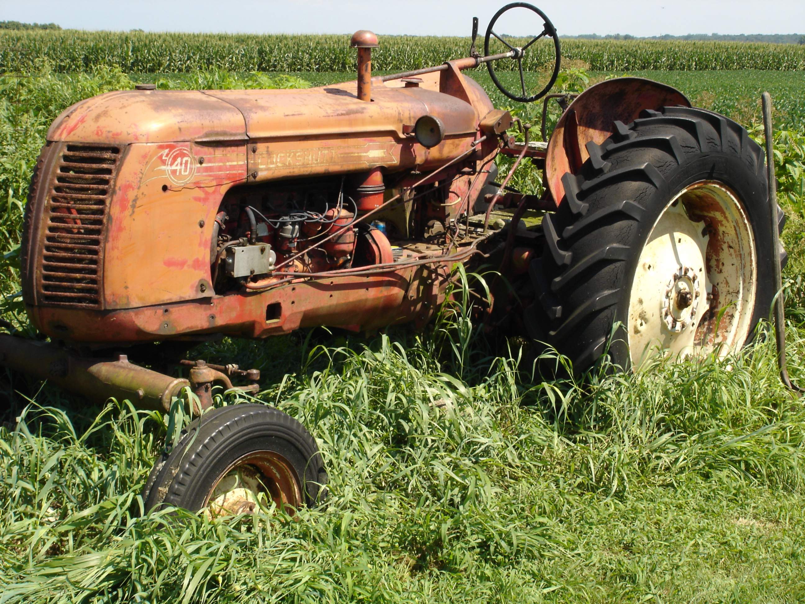

Forgot to mention there is a hydraulic pump on the left side that will have to be addressed when I tear the engine apart. This could get interesting and I am glad I have a friend that does this sort of thing.
I will take pics tomorrow and post this pump. what is really cool is the valve switch connected to the operators station with a bent rod connected to a threaded rod through the control valve. That part has some serious rust. The pics will show a lot.

Here are some pics,
