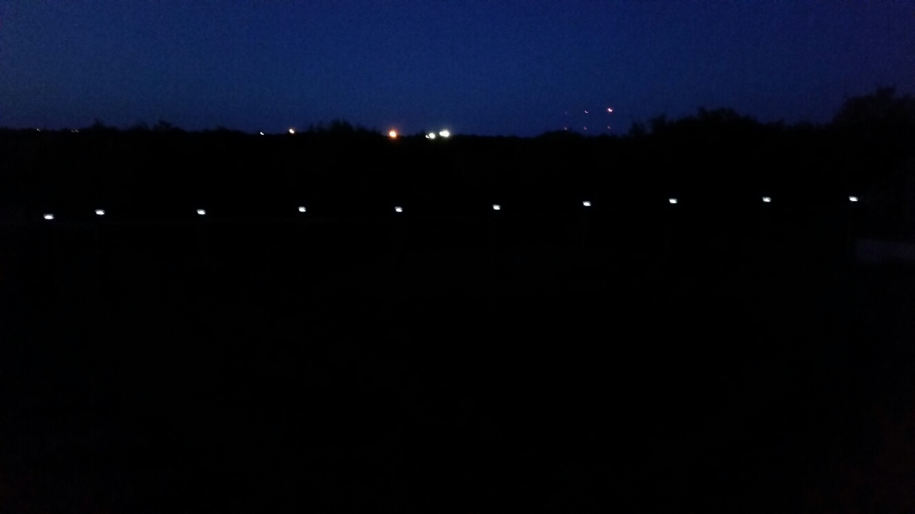

Last, but not least. View from the patio chairs after dark.

You did better than good Brandi!!! You should be proud, and your daughter happy. BTW did I happen to mention when my B-day is??? I wanna a fence too :D

Thanks. You will be the first one when I finish all my fences.
