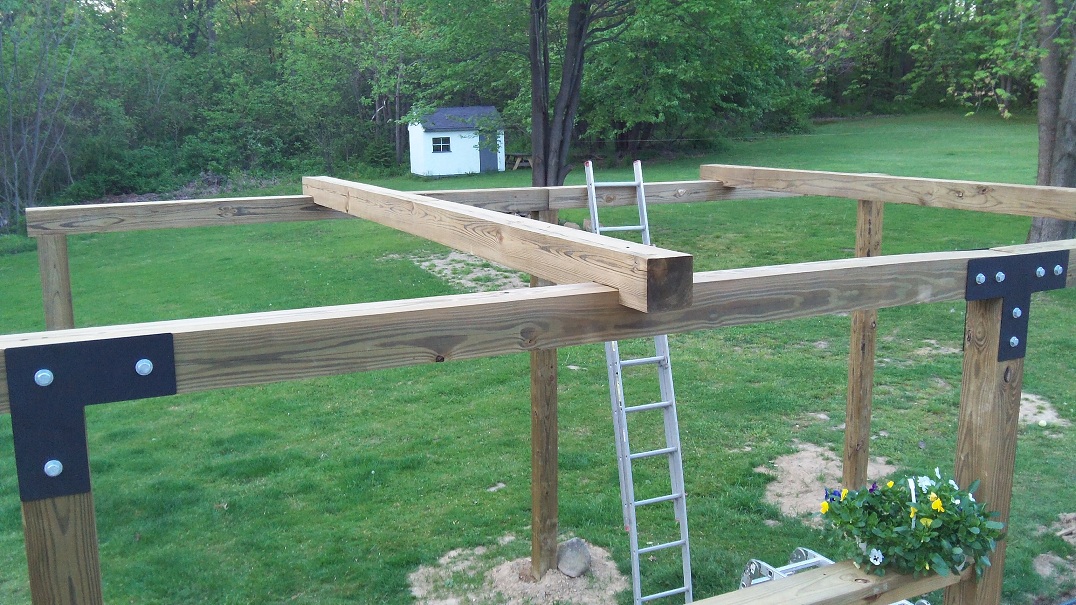

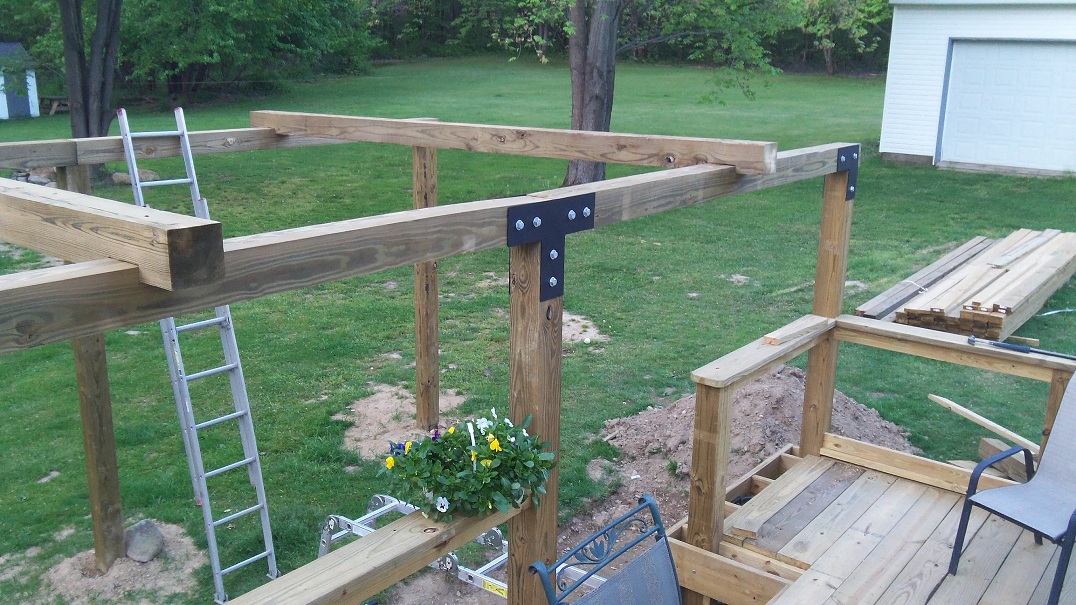

Bolted up 6 of the brackets and set two of the beams today.I hope to get 6 more brackets and the remaining 3 beams done tomorrow.

I like your brackets, I need to make some of those for my porches.
Thanks Motor
I had these laser cut and they are 1/8" thick, I think they should really add a nice look to the deck.

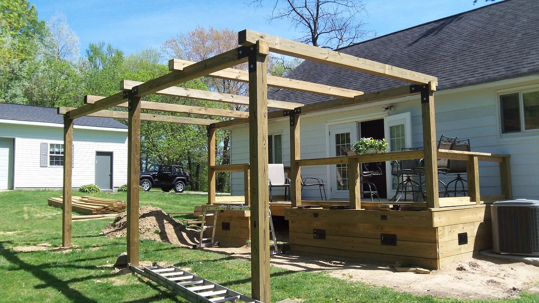

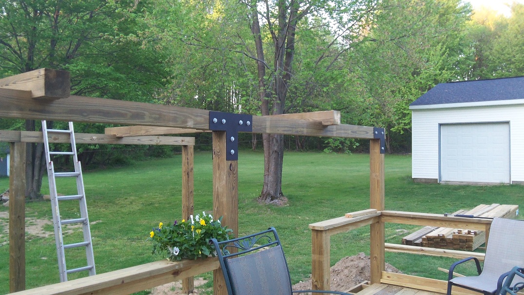

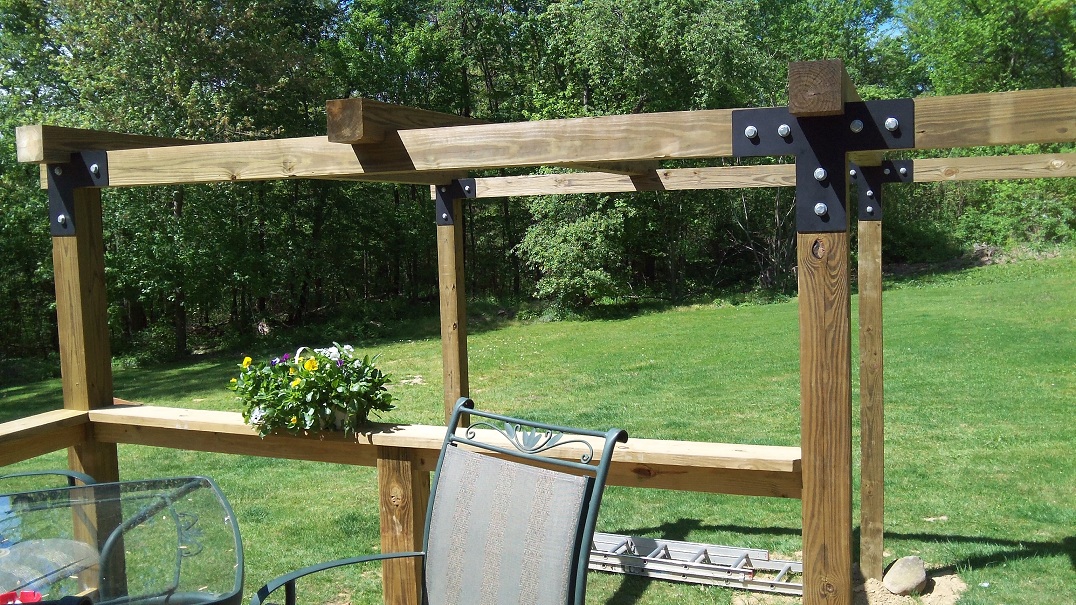

Progress for today,all beams and brackets are up ,so now I will be starting on the roof.

   / my deck/patio project #67
I hate to rain on your parade, but are you planning to put some kind of balusters on the space between the railings and the deck? Most building codes require a suitable railing (including balusters with less-than-four-inch spacing) if the drop-off between the top of the deck and ground level exceeds 30 inches (used to be 36 inches). It sure looks like more than 30 in. to grade, at least on the downhill side.
#68
Baluster will be the last thing on the list , I will be staining everything before I install those.

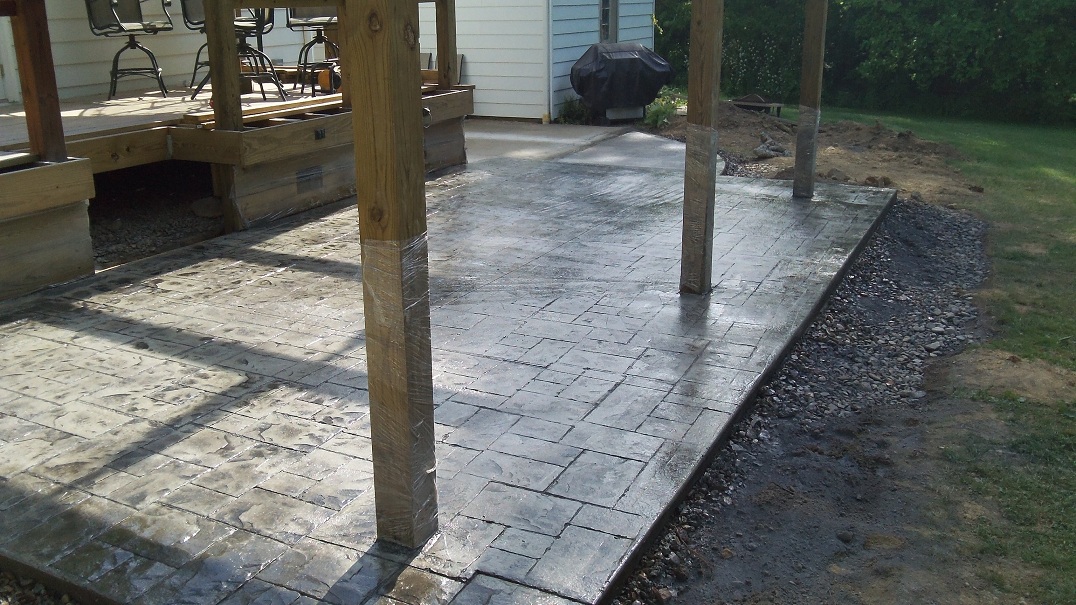

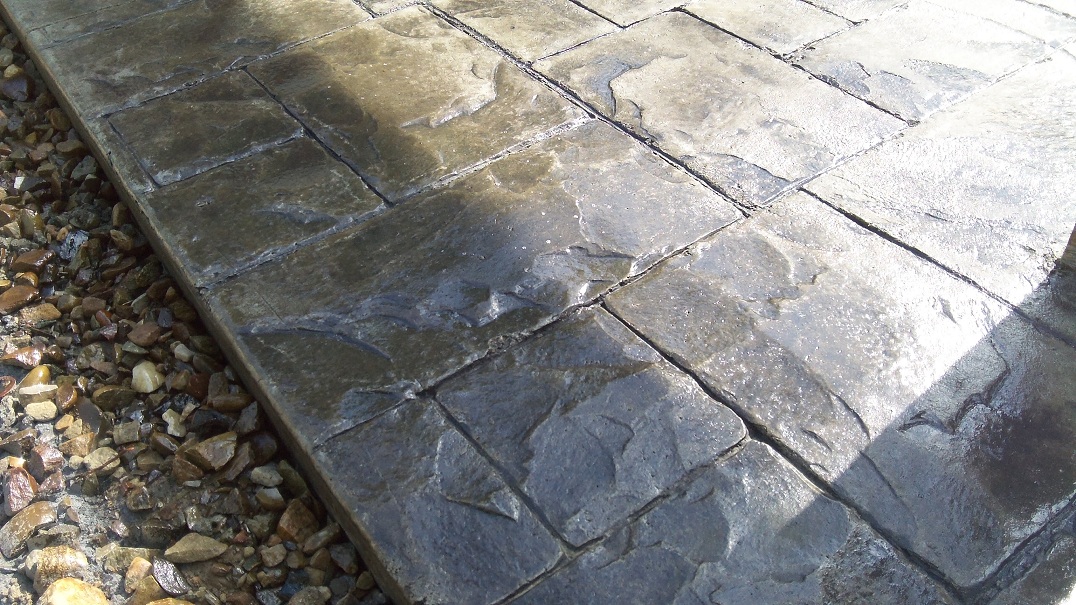

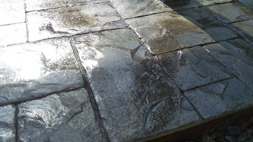

concrete is done.
   / my deck/patio project #70
That looks really sharp! Was that something you did yourself or did you hire it out?
