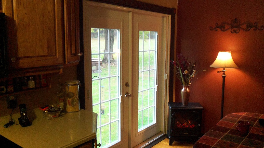

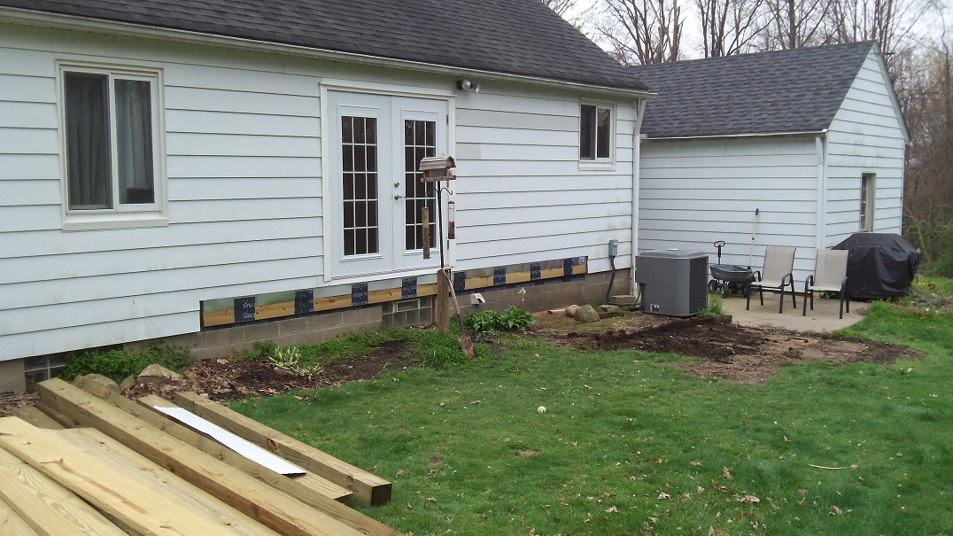

I know how much I enjoy following some of the projects that have been posted,so I thought I would share mine.
I started this project last summer,when I installed the french doors in the back of the house.

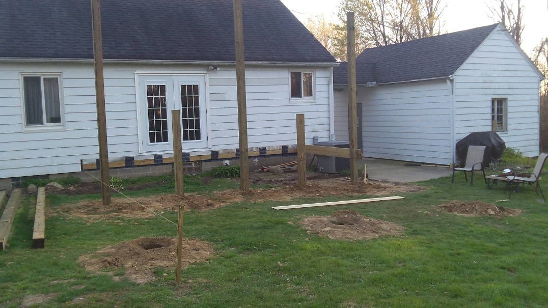

This year I am going to get the deck/patio finished (with the help of my dad)
just to catch everyone up on where I am with the project,I have the ledger board hung,layed out where to drills the holes,drilled the holes tuesday and mixed the concrete yesterday.
I will be setting five of the eight post today.
I will post pics and comments as I go.

/ my deck/patio project #4
Just wondering why you decided to go the ledger board route??
Personally, I dont like the ledger method. I like setting posts next to the house. Several reasons. (I am sure there are also good reasons to use a ledger)
First, where I live, anything attached to the house has different (more strict) codes to follow.
Second, If it is an "attachment" to the house, homeowners insurance goes up a tad. Not much but still...
Third, I dont like the idea of peeling siding off and risking NOT getting it sealed back up good causing rot to the house.
Not saying you are doing anything wrong, because lots of decks are built that way. I just never understood or heard a good reason. That is why I have always set posts and had a "free" standing deck.
Good luck with the build and keep us posted with pleanty of pics:thumbsup:

First:I have no problem with following the "codes"
Second:my insurance on my vehicle goes up when I buy new also (its an improvement).
Third: provided you flash the ledger board properly,there should be no concern of rot.
I hope you dont take my comment as being a "wise ***", I am just being realistic.
I just feel that it makes for a more rigid deck and it is much easier to hang a ledger board instead of drilling and setting an additional 5 post.

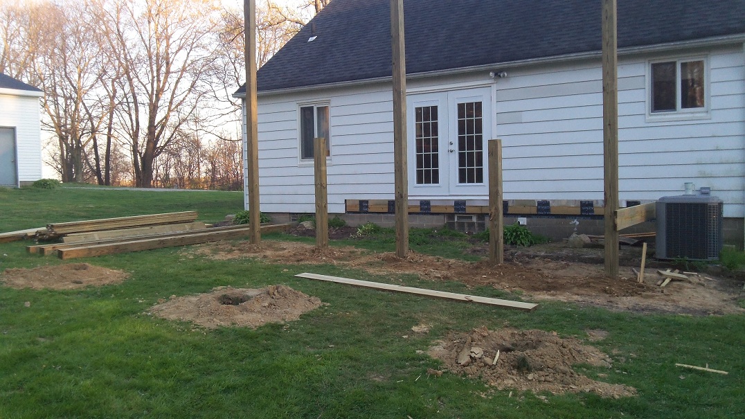

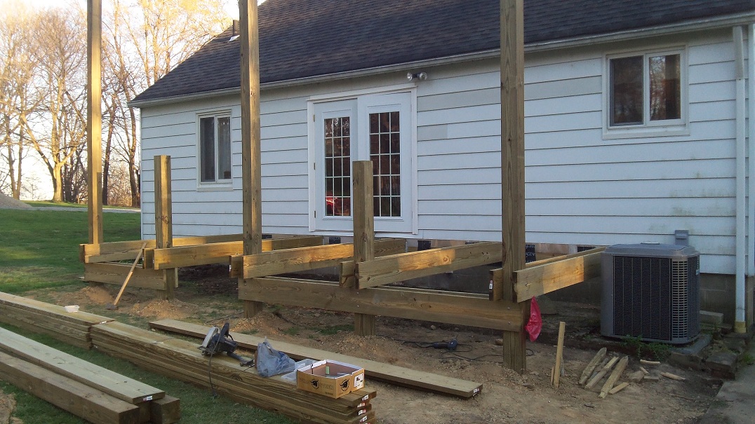

5 of the post are in.the 3 emmpty holes will be
getting 3 more 6x6x16 post, that will be for the pergola
over the concrete patio.
Tomorrow I will be removing the top soil under the deck area
to lay plastic and gravel,then I will be hanging the support beams.
If time allows,I hope to hang some of the floor joist.
thats all for today.

depending on your codes,you may not be allowed to concrete around the post.
In my case,I drilled a 40" hole and mixed 1, 80# bag of concrete per hole and poured it in the hole.After it dries, you drop the post in the hole and the concrete acts as a footer.
I have heard of people using a rubber type boot around the post before placing it in the hole.
They should last 25 years + without a problem.

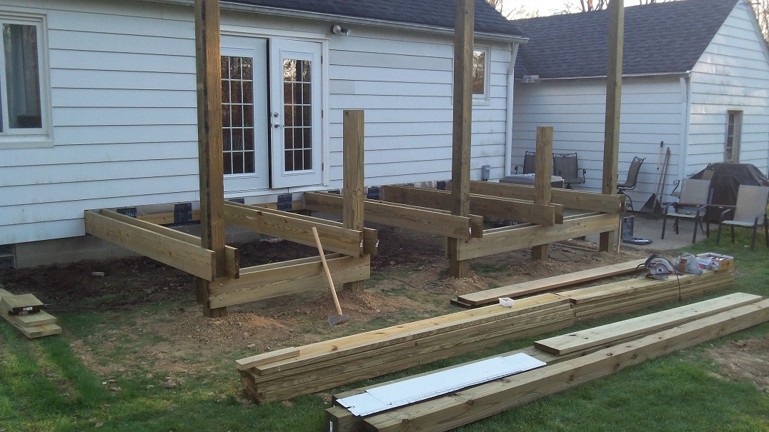

Moving along
I got off to a late start tonight (my helper was late getting to my house).
but I did get quite a bit done.the support beam is in and some of the floor joist.
Tomorrow I will be laying down the plastic and gravel and setting the rest of the floor joist.
They are calling for rain Sunday ,so I will get the day off :)
that is all for today.
