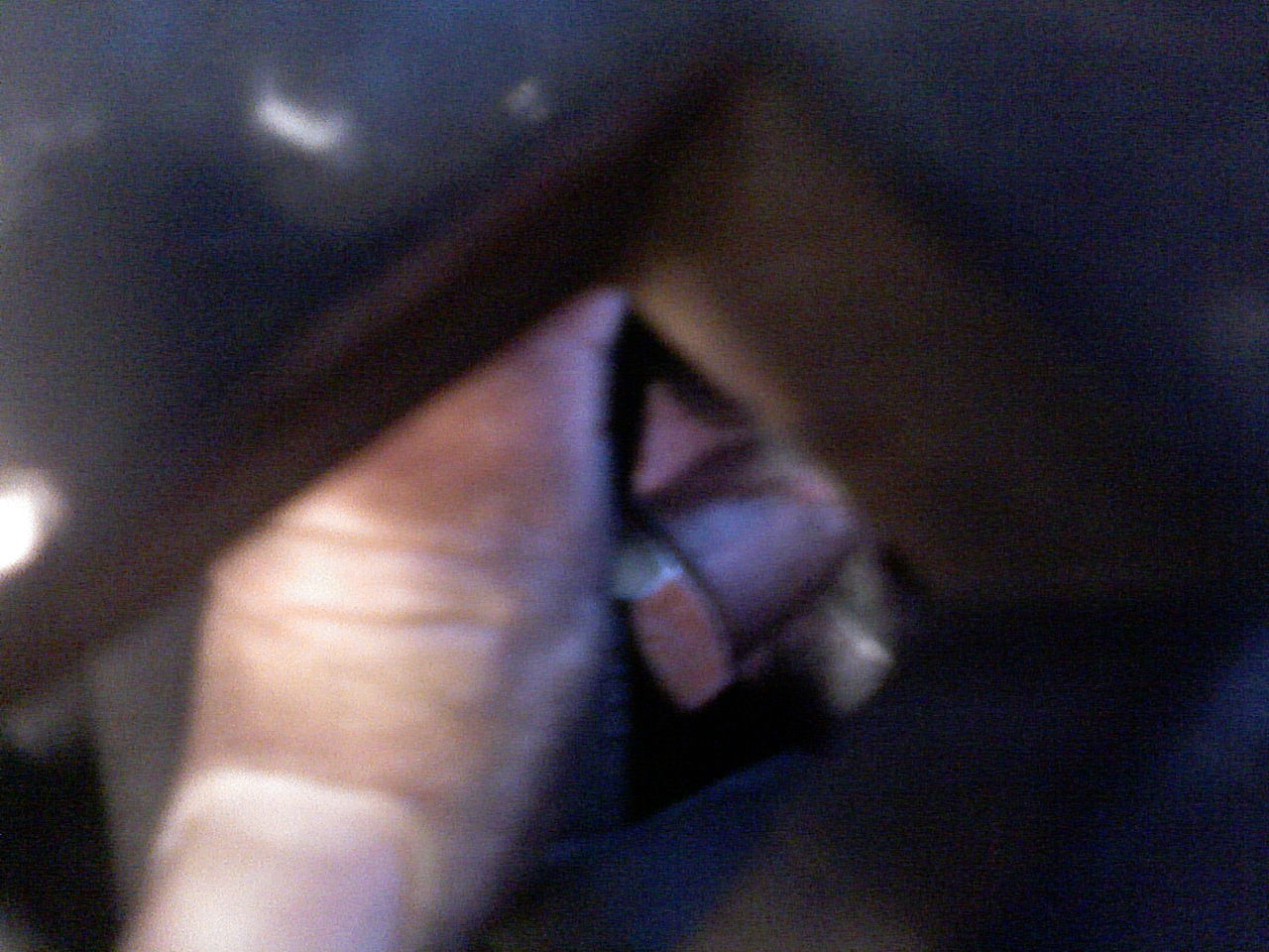

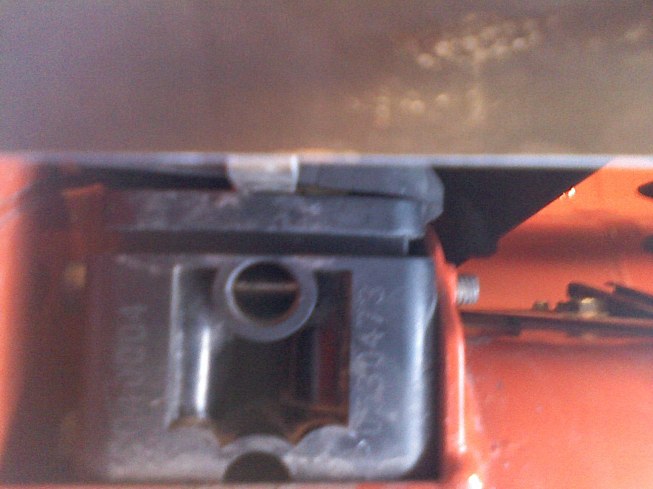

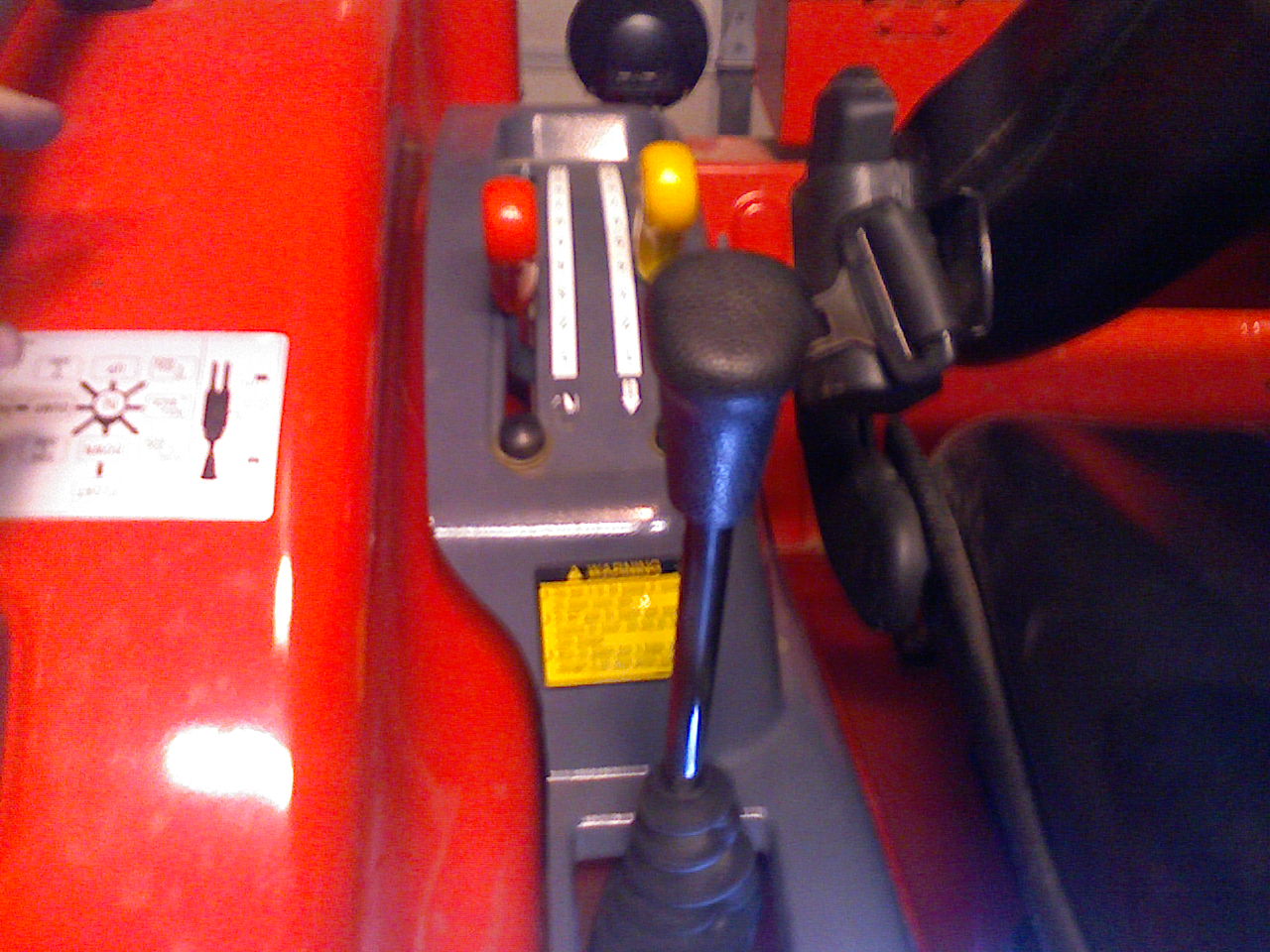

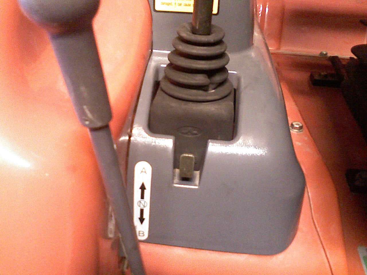

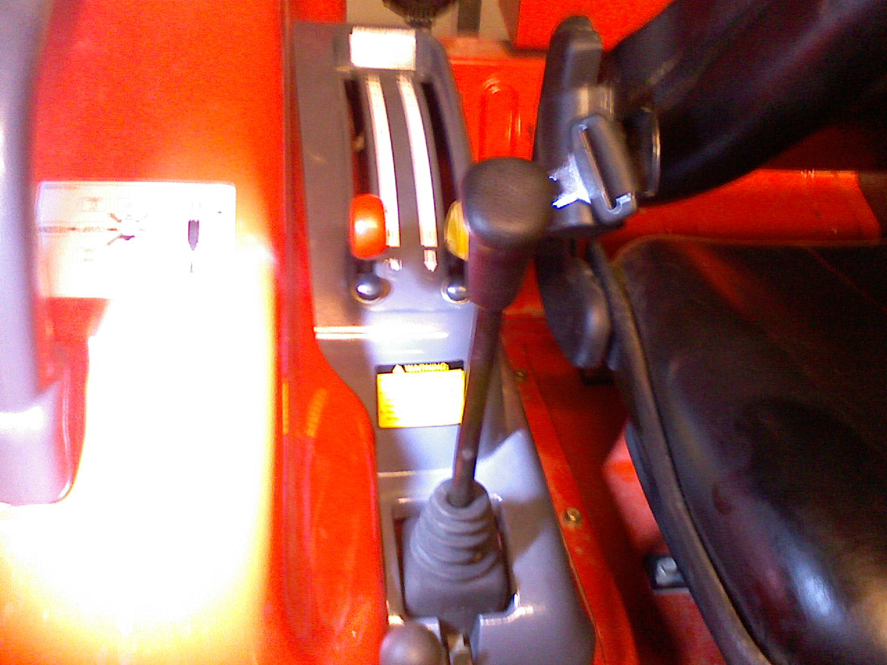

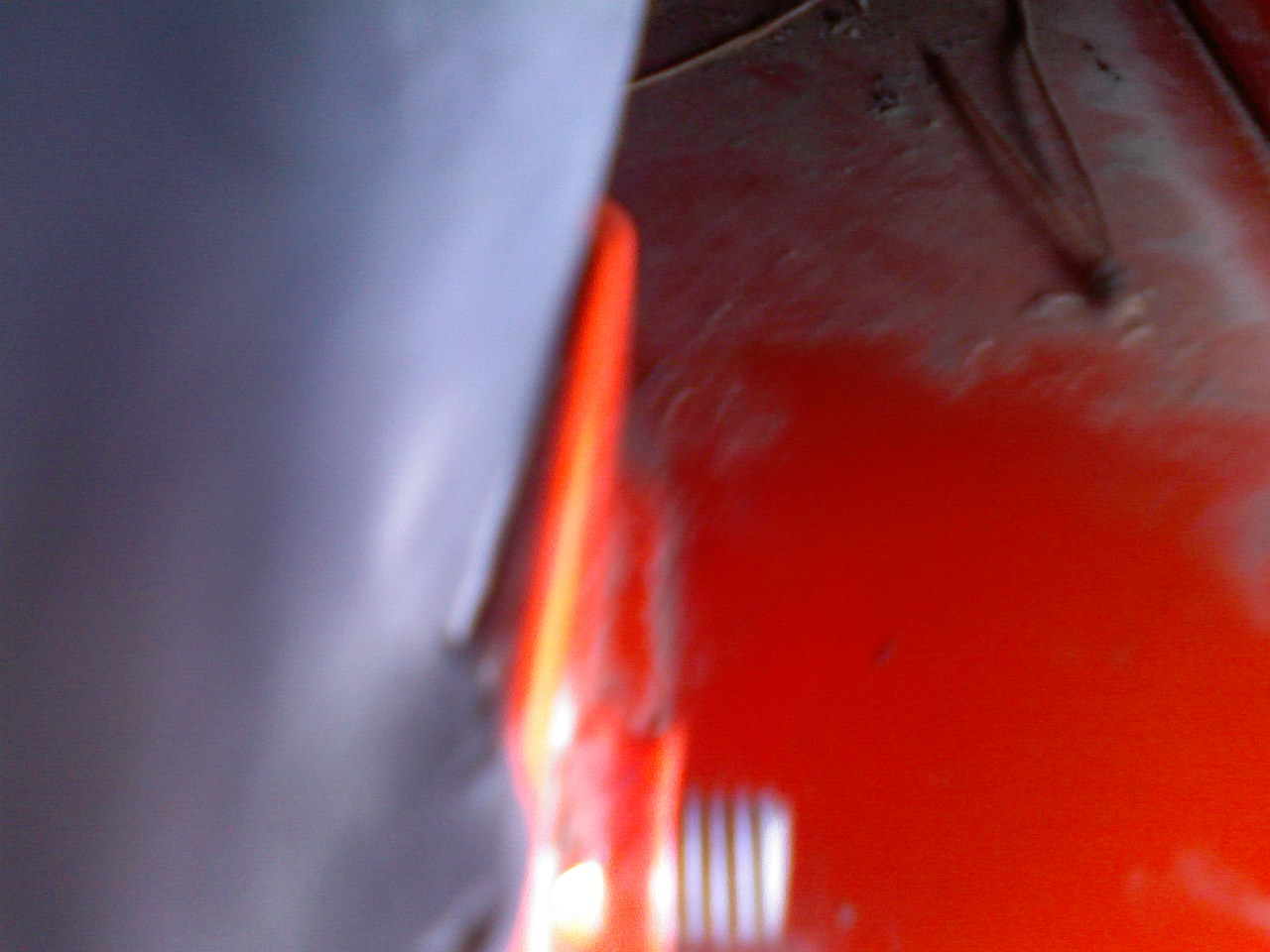

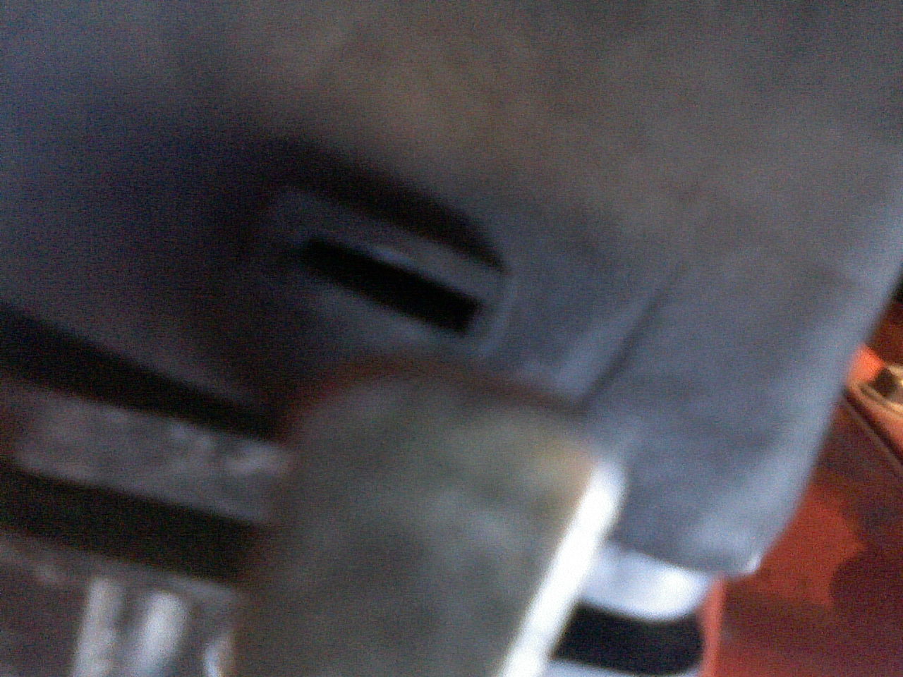

I haven't been doing much lately, cutting wet grass and some maintenance. The first two pics are some of the fresh cut grass. I hate the first cut of the year, due to the ground swelling/moving from winter, always fills the RFM with dirt then you have to dig it out.

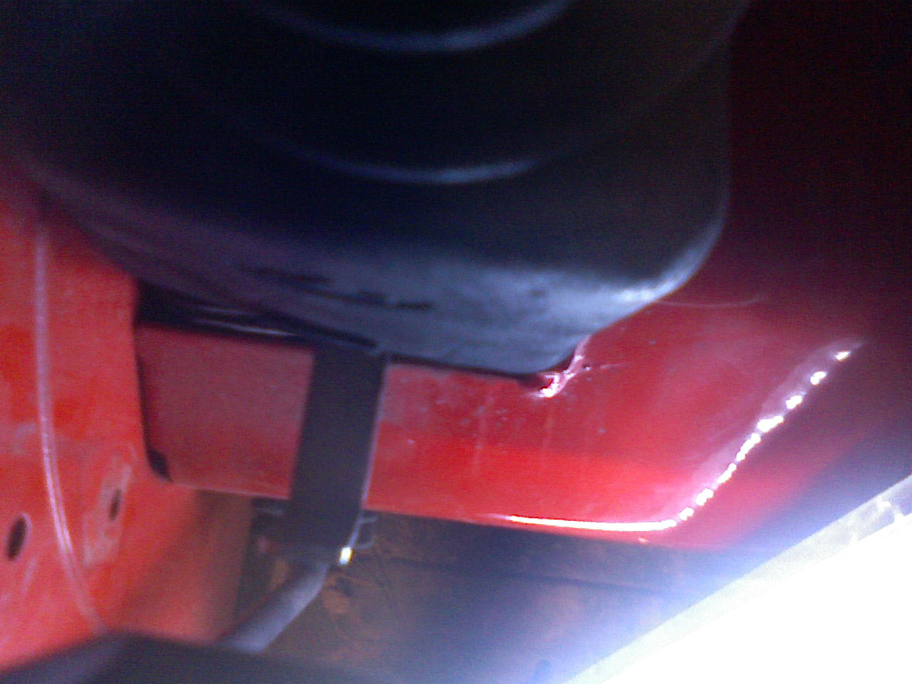

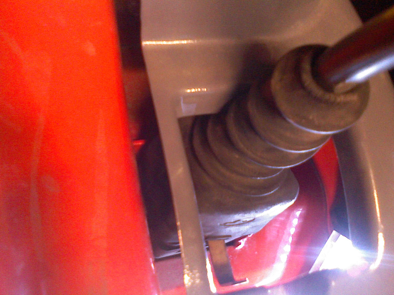

The second batch of pictures is my wonderful fun project of fixing the jamb nut on my FEL lever. Well, the monkey at the factory must have jammed the boot inbetween the metal and the FEL control box, cause I couldn't get it free. I had to take the plastic housing off, but not off completely because the plastic handles for the 3pt and draft controls wouldn't let it slide off.
The FEL lever lock caused problems getting the boot up, the boot was wedged between the FEL lever housing and the metal bracket, and the plastic housing wouldn't come off. Next time this happens, it goes to the dealer fo fixing. I hat to bother the man with stupid stuff, but this wasn't a hard job, just a PITA job.
Hope one of the Kioti wizards here can enlighten me on an easier method. Why don't they loctite these things at the factory?

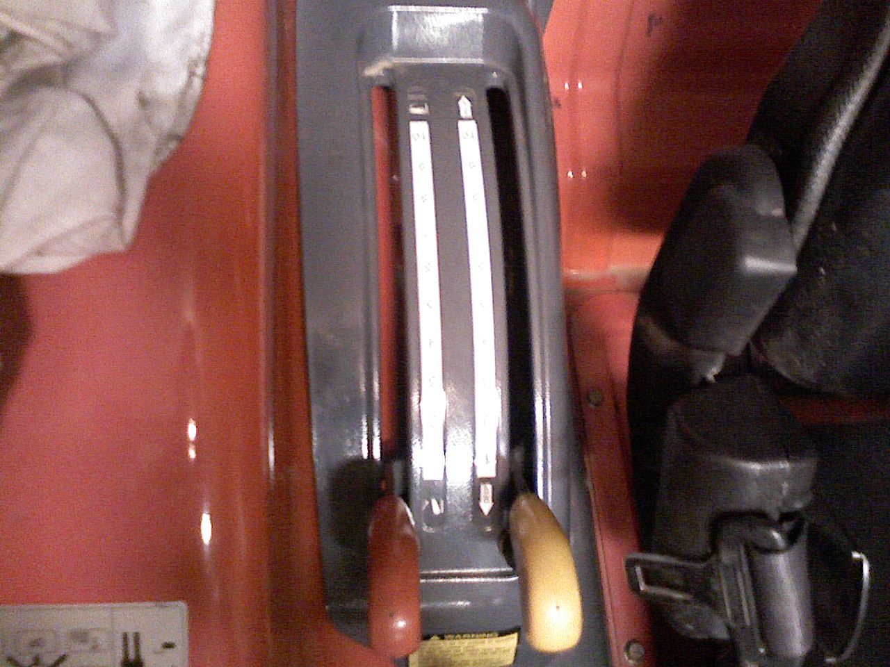

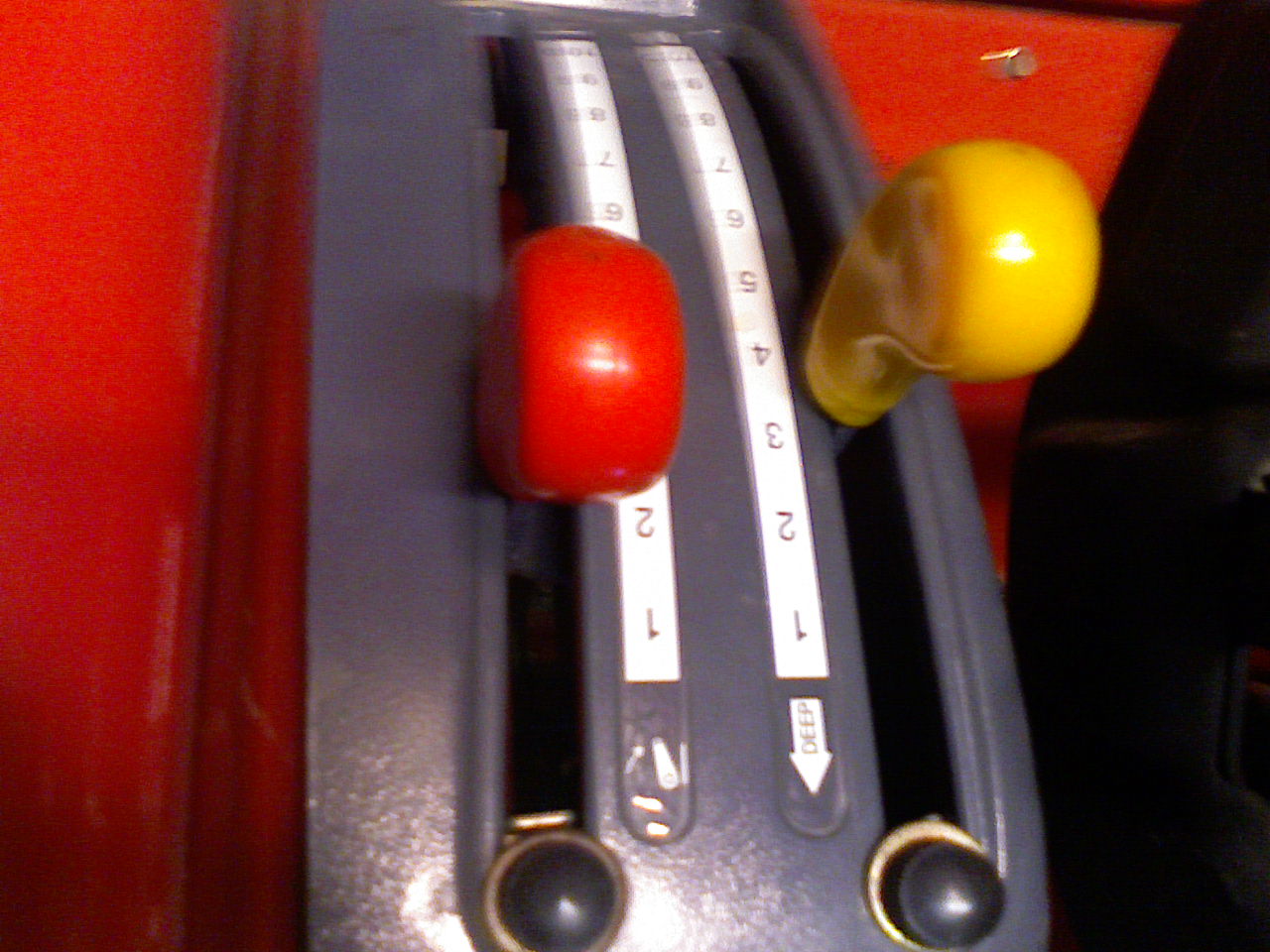

Oh, and I took a pic of the jamb nut as I was trying to pull the stuck boot up to tighten it. Let's just say it was pretty friggin hard to do with one hand while trying to take a pic with my phone. There is also a picture of the draft and position control levers for people who don't have them that wonder what we are talking about. Cell phone pics not the best, but I don't have to compress them prior to posting either.

rest of pics - the second pic here is the culprit *jam nut
The last pic isn't great, but shows the draft and position control, as well as the fact that I did manage to reassemble it correctly.

Good pics, that cellphone does pretty good. There was an xclnt thread and pics about fixing that jamb/lock nut on the FEL lever, but my search did not find it. Luckily it hasn't happened to me yet, but I'll sure locktite that nut if I'm in there for another reason.
