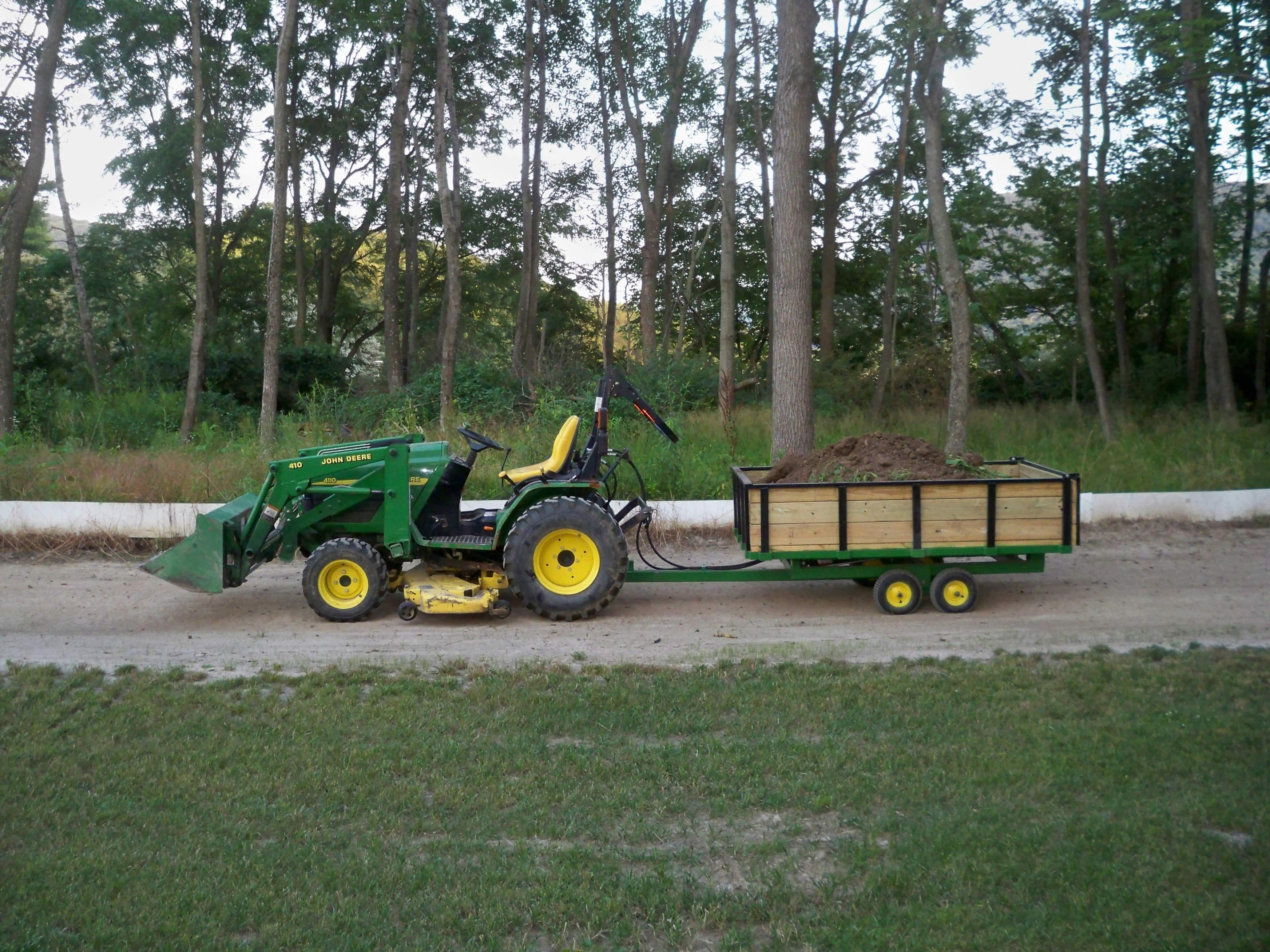

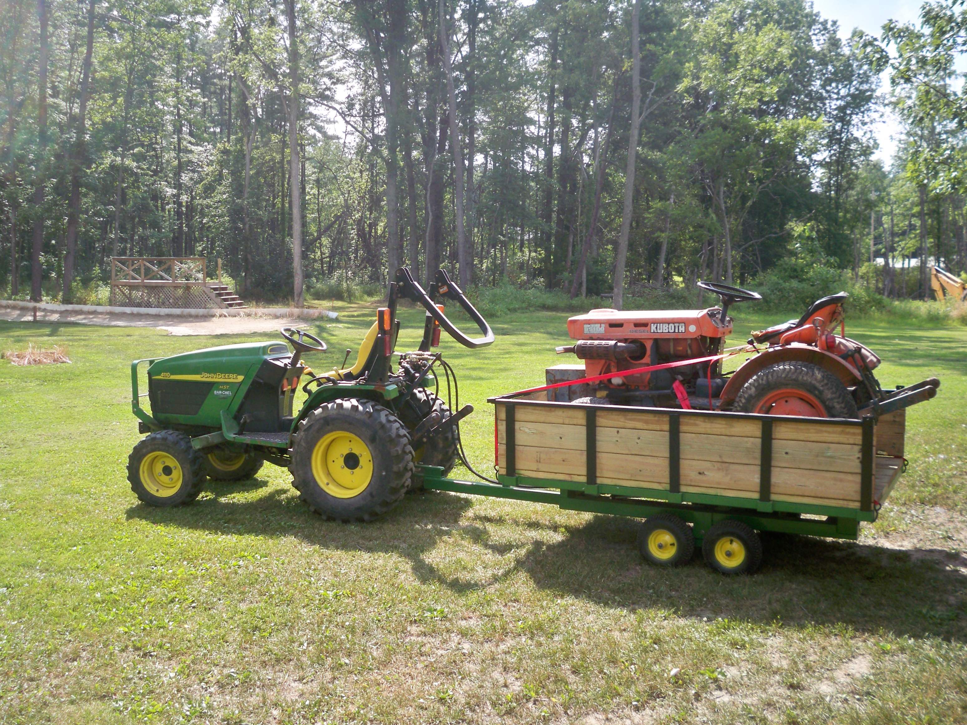

this one goes out to all those kubota fans! :laughing:
here's a pic of my first load. i took it back up to my dads. the kubots was a good tractor it just needs a couple of new bearings.

So. I have to ask ...... Did it stick in the bed when you dumped it or there was enough of a dump angle?

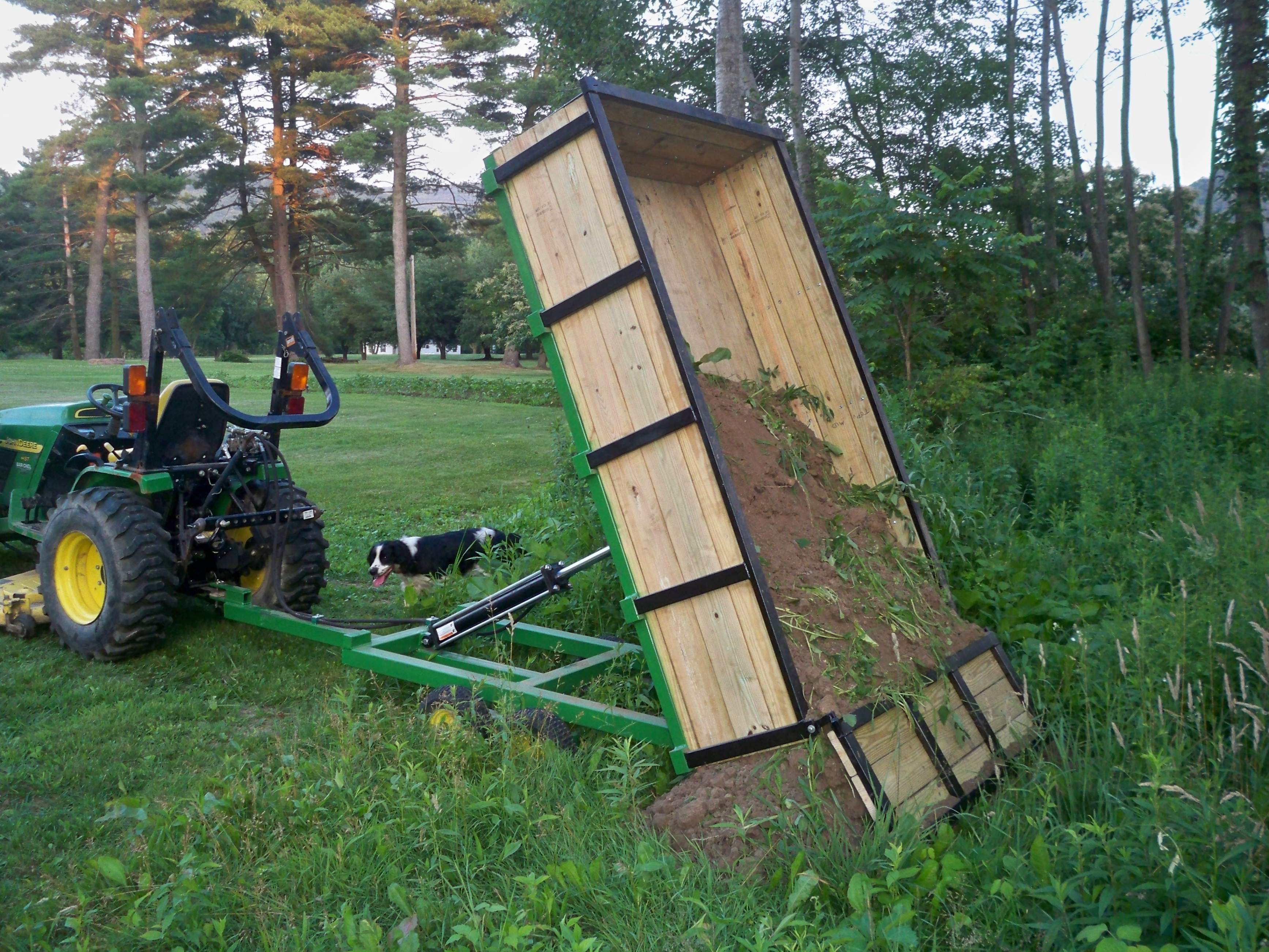

At 2500 psi, that cyl will push 12 tons. He will either lift of push the frame out of shape with that much force.
banditbooker
Just what is the angle of the cyl to the base line?

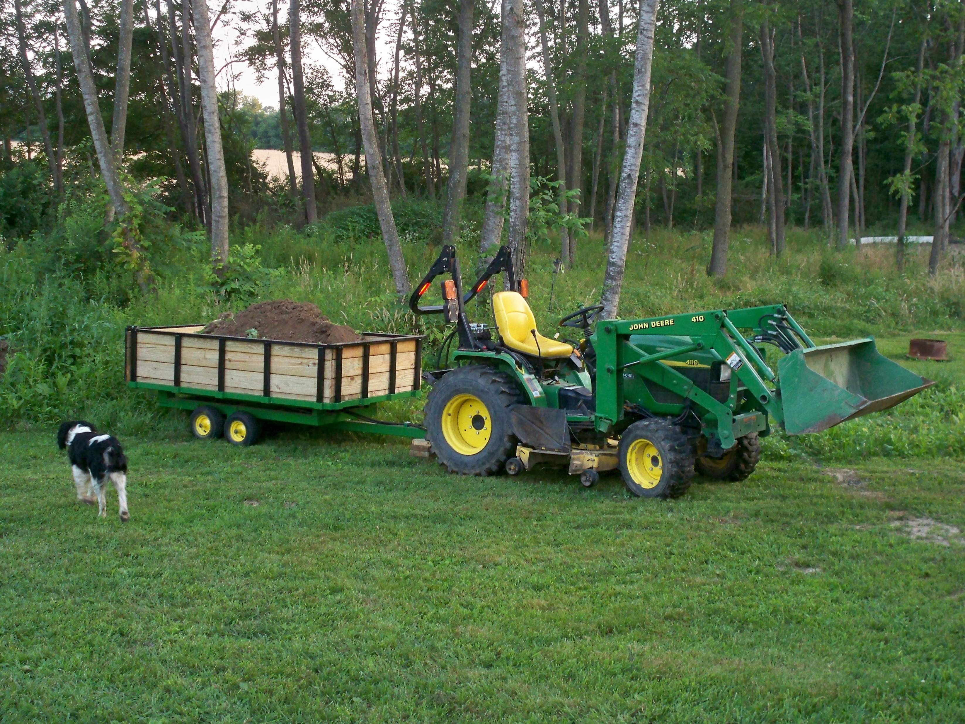

#27
tried it, as you can see it has a pretty good load on it. it pulled around nicely but when i went to dump it i needed to actually help it get started. i think the cylinder is at too flat of an angle. it may be alright with a lighter load, i don't plan on loading it that heavy all the time. when i get the tail gate latch on it i will also be able to load it more towards the rear which should help a little to, not much, but maybe just enough. and of course, the dump angle is plenty and the load came right out even though it was just dry topsoil. overall, im still pretty happy with it, but if i were to go back and do it again, i would put bigger tires and axles on it, not only for the weight, but to also raise it up a bit off the ground so it makes a nicer pile, and i would also make the cylinder start angle a little steeper. its not perfect, but i'll get good use out of it. :thumbsup:

the starting cylinder angle is 6.71 degrees. J J

Nice build. However, I would upgrade the trailer to spring axles, and wheels. One other small comment is the hose supports on the frame. It look home made, but could be wrong and probably have sharp edges, and will chaff the hose.
I wouldn't worry about springs. None of the farm equipment I grew up with had springs under it and it hauled fine. To me it would just be adding another failure point.
   / my dump cart #30
From what I can see of your walking-beam suspension, it shouldn't be a big problem to make a longer beam to put bigger tires on it.
Even with your 20-20 hindsight comments; I'm still impressed with what you built.
