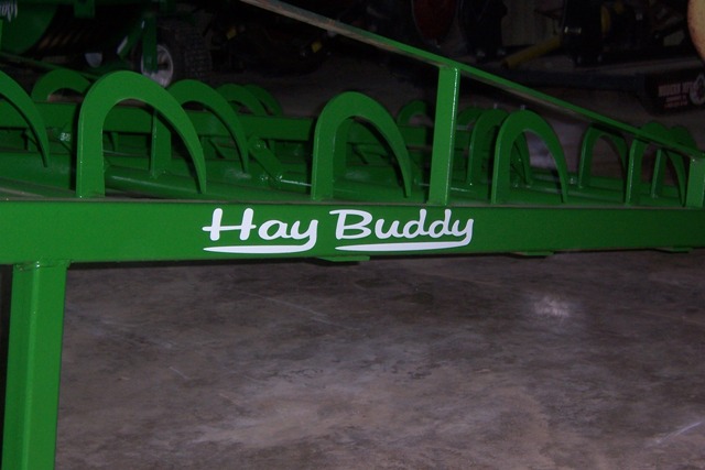

I have some equipment that needs paint ... so I run to the hardware store and buy an inexpensive paint gun for my air compressor ... $47 ... I read the instructions or perhaps I should say I scan over them.
I thinned the paint, set the regulator at 15lbs ... practice on some card board and get the flow about right ... start painting and all is well.
Then the bottom of the canister almost explodes ... the bottom is not flat anymore ... rounded out where it won't sit on its own.
Back to the store for the second one ... turn the pressure down to 10 lbs and painting again ... and dad gum it the same thing!!!
I find no explanation in the manual ... so what am I doing wrong?

If its not a spike as Jim indicated ... I'll turn it way down and see ... maybe I just better get a new regulator.
Not a bad paint job though ...
