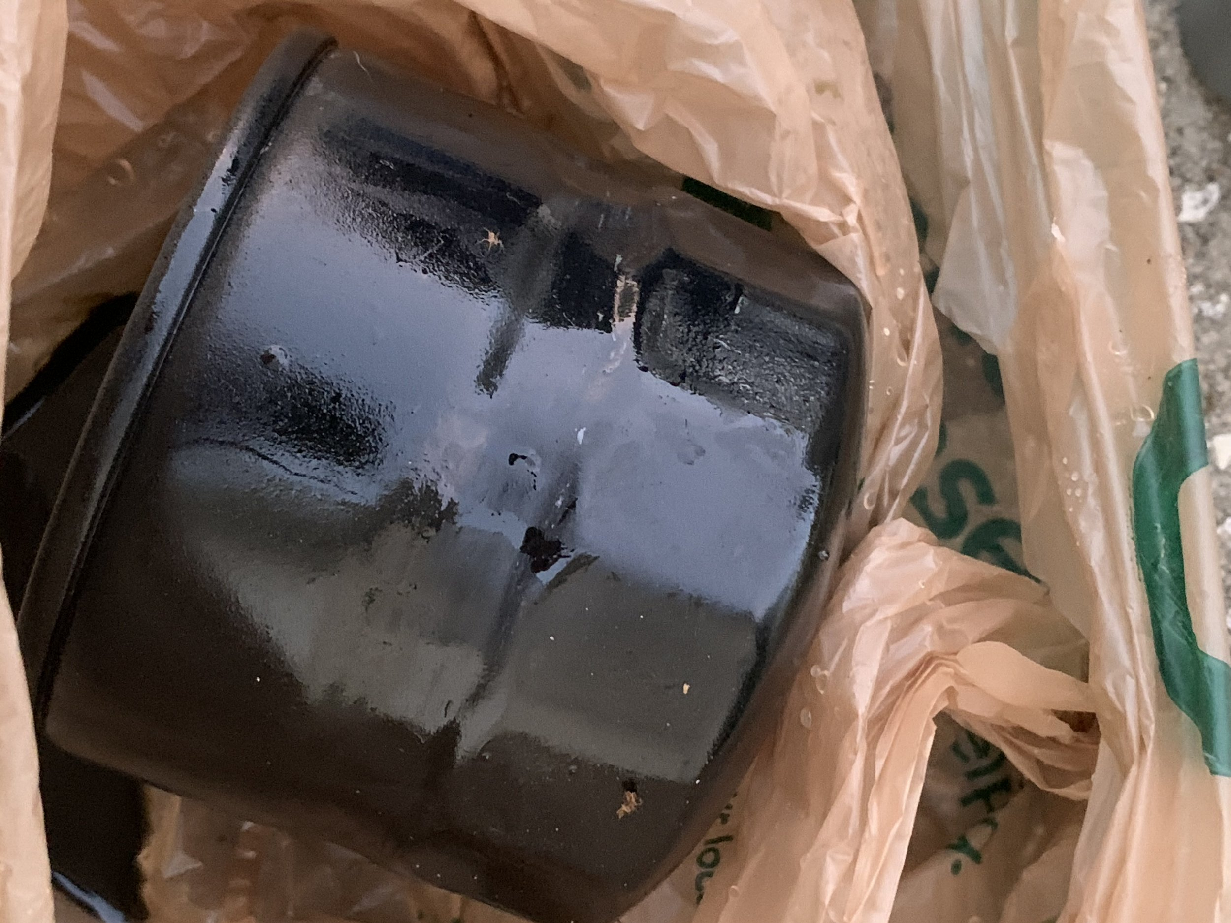

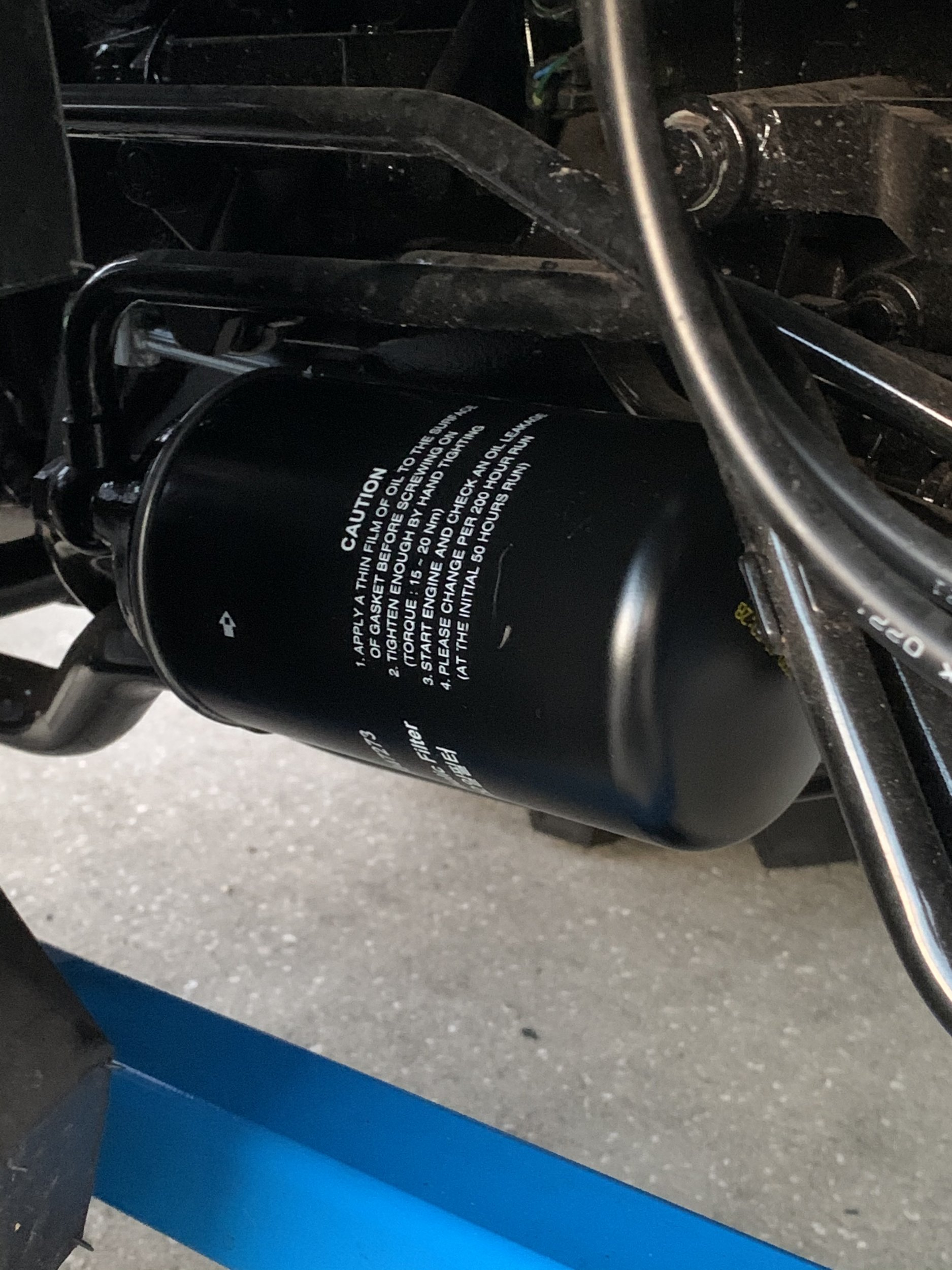

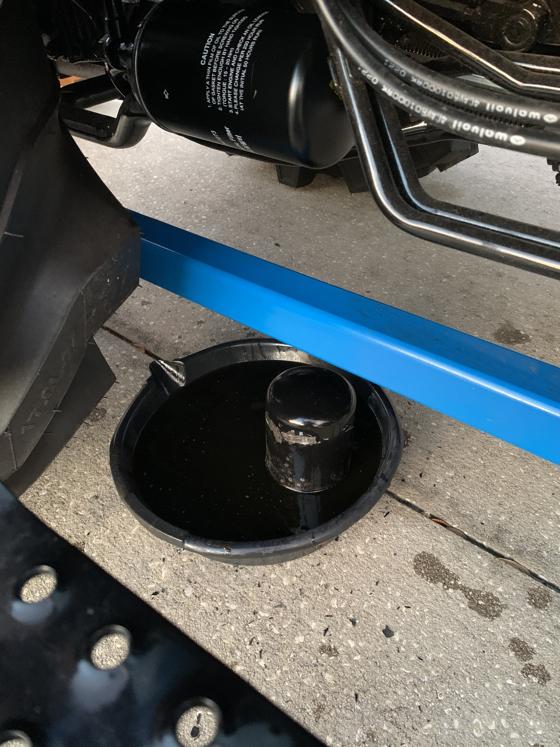

When it was time for the first 50 hour, those filters were just as others described.... put on by a gorilla sized torque wrench, then painted.
I have a very nice pair of the oil filter channel locks. Couldn't budge them.....then I remembered about cutting the paint around the edge of the filter.
Guess what? either I got very, very strong, or cutting the paint works. I was able to unscrew them with two hands....
Absolutely amazing.....you probably loosened them with the wrenches and the paint removal was just a side note......but you were there, you did it and who am I to doubt you....nobody.
   / My experience with the 50 hour service. #22
Yes, you are probably correct about 'breaking free' prior to cutting the paint. The old factory filters did have a really thick layer of paint.... like it all ran down and got dried around the filter seal area. Just very coincidental I guess......
