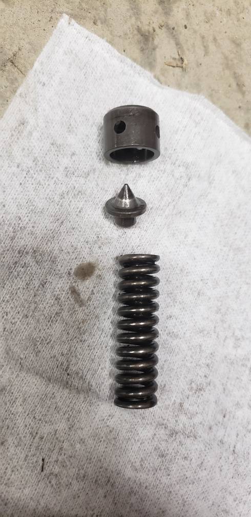

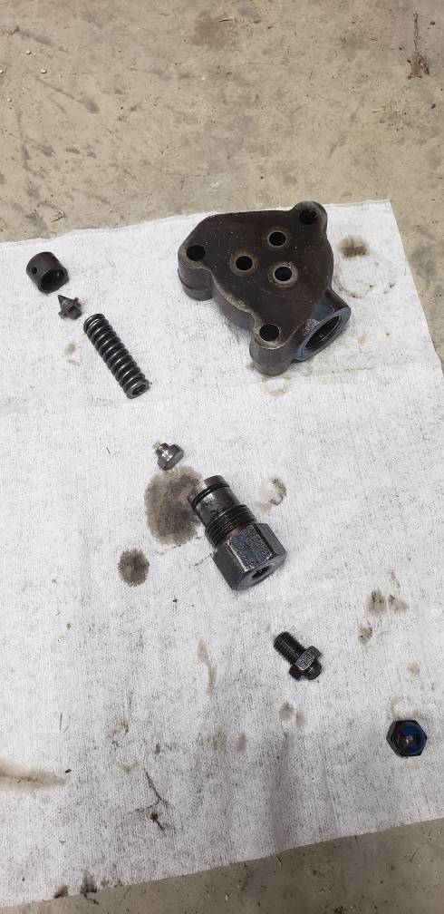

What happens when you manipulate the lift lever, all the way up or down.Any change in vibration or noise? can you post the pic of relief valve in it's entirety ? one that shows spring and poppet. Try it also with the pin and feed back arm removed from right lift arm and see the difference you might observe. Post back.
Ps. do you see any shims in the relief valve by any chance?

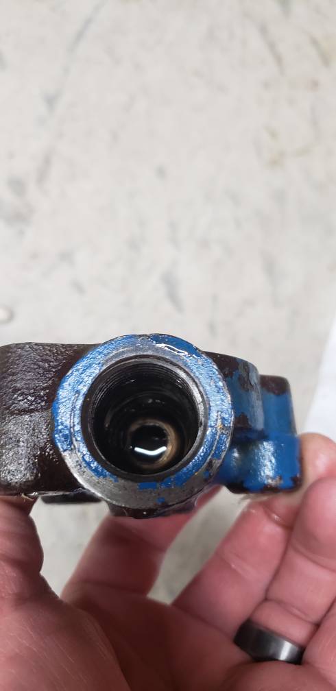

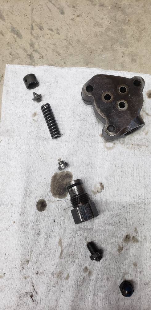

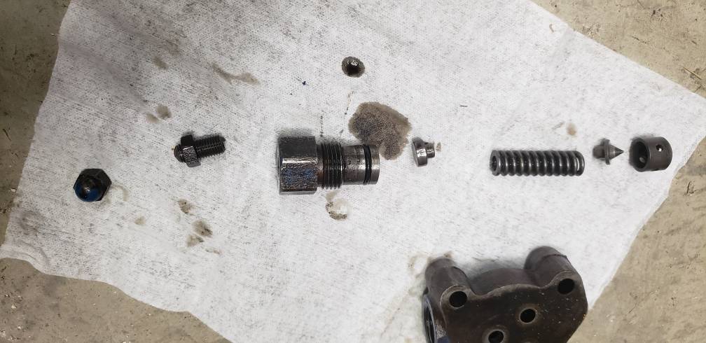

Relief valve pics of how I dissembled it 20200315_102624.jpeg20200315_102551.jpeg20200315_102525.jpeg20200315_102441.jpegImage.jpeg
