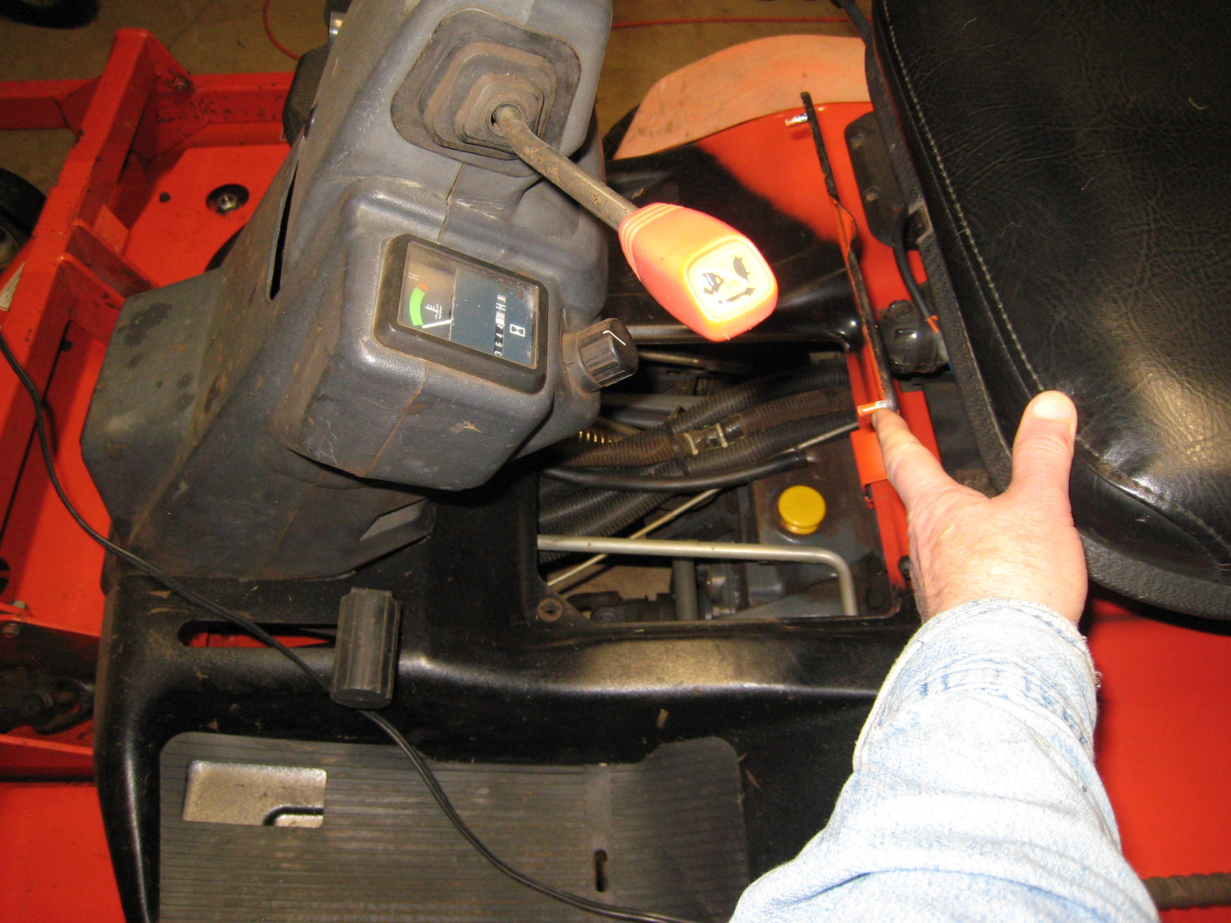

Does your seat have a latch that will let it hinge up so you can get to the top of the unit were the filter is?
I wouldn't expect a seal to drop that much oil, I'll agree with more likely a line or hose or the filter.

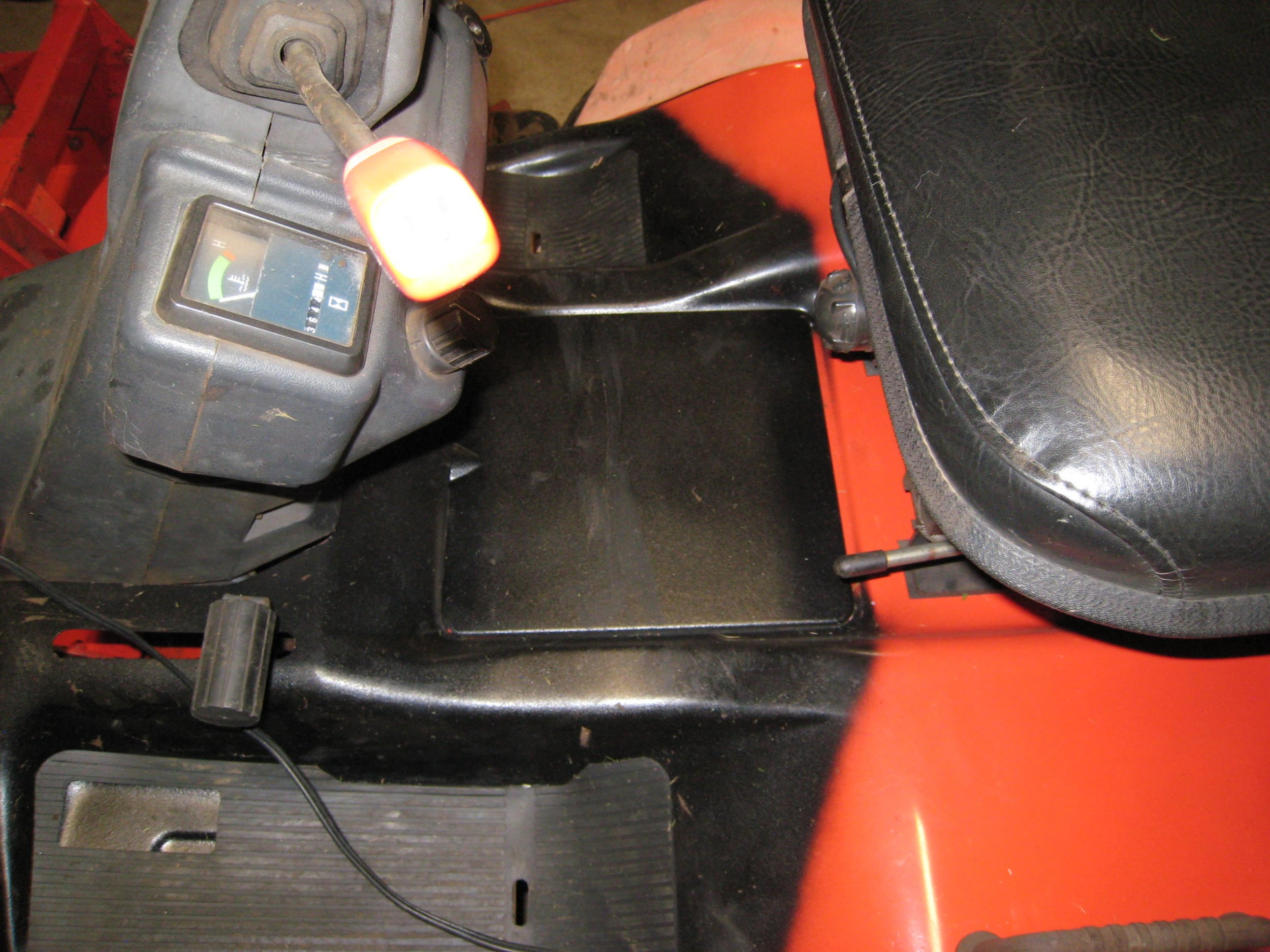

F3060 has no such seat latch, but the seat can be removed by opening four bolts - however filter can be accessed without seat removal.

My old F2000 has a simple latch and the seat will flip up forward to access the fill and filter.

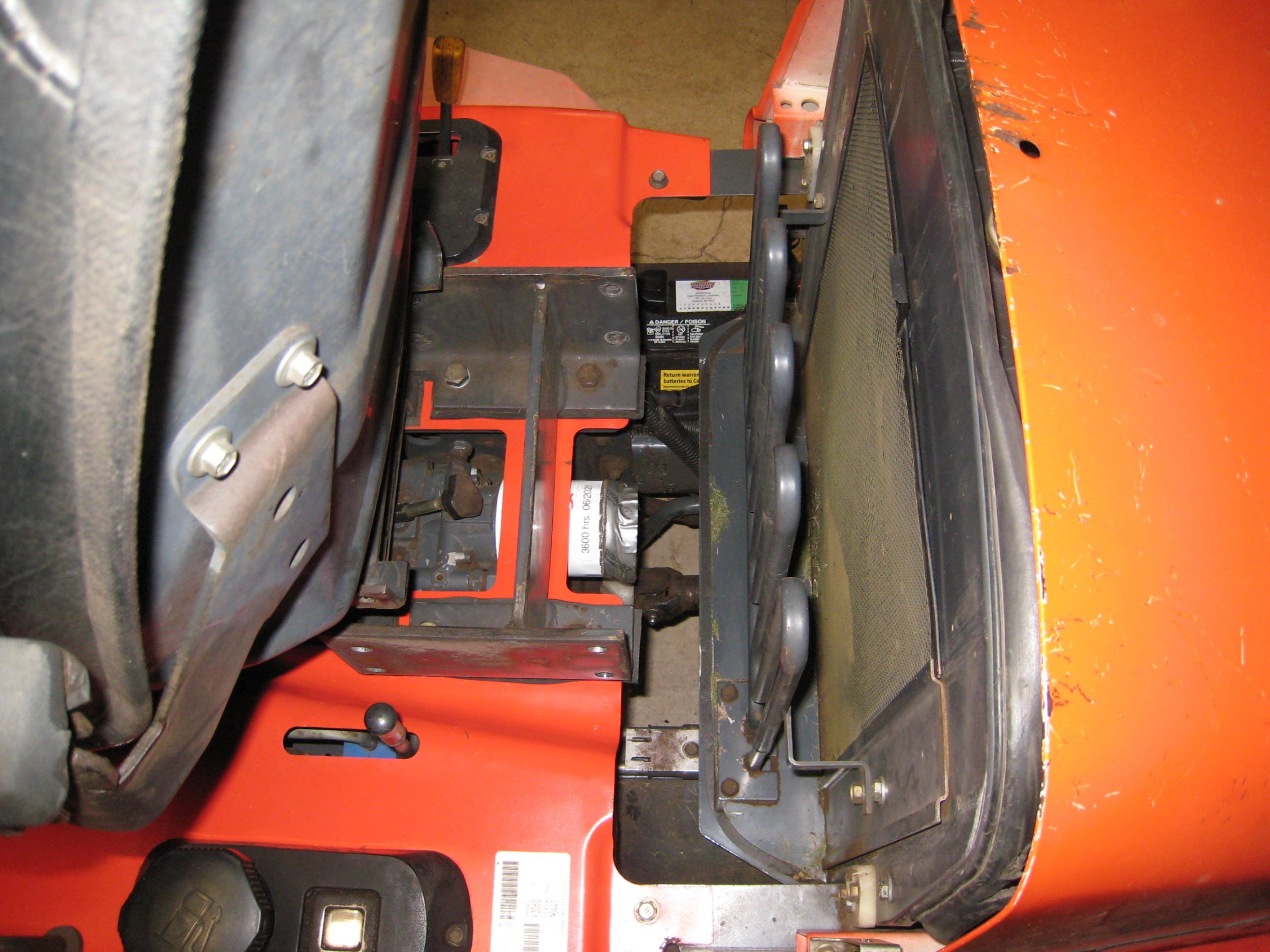

Since you asked, here are couple of photos showing F3060 access to HST oil filter and oil fill opening.
There is another large debris screen in front of the HST cooler / radiator which I removed before taking this photo!
