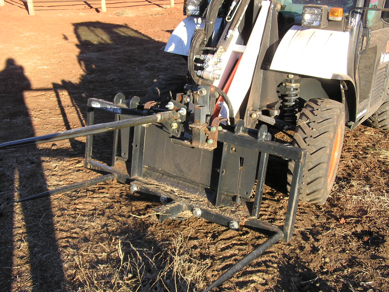

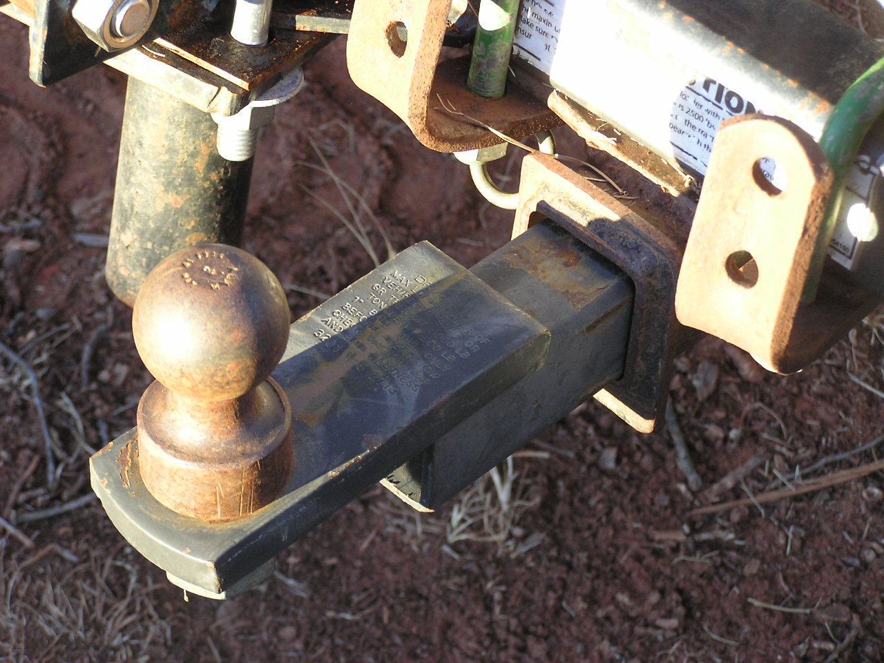

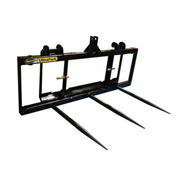

I have a Speeco UltraFork that fits on the 3 point hitch or the front SSQA.

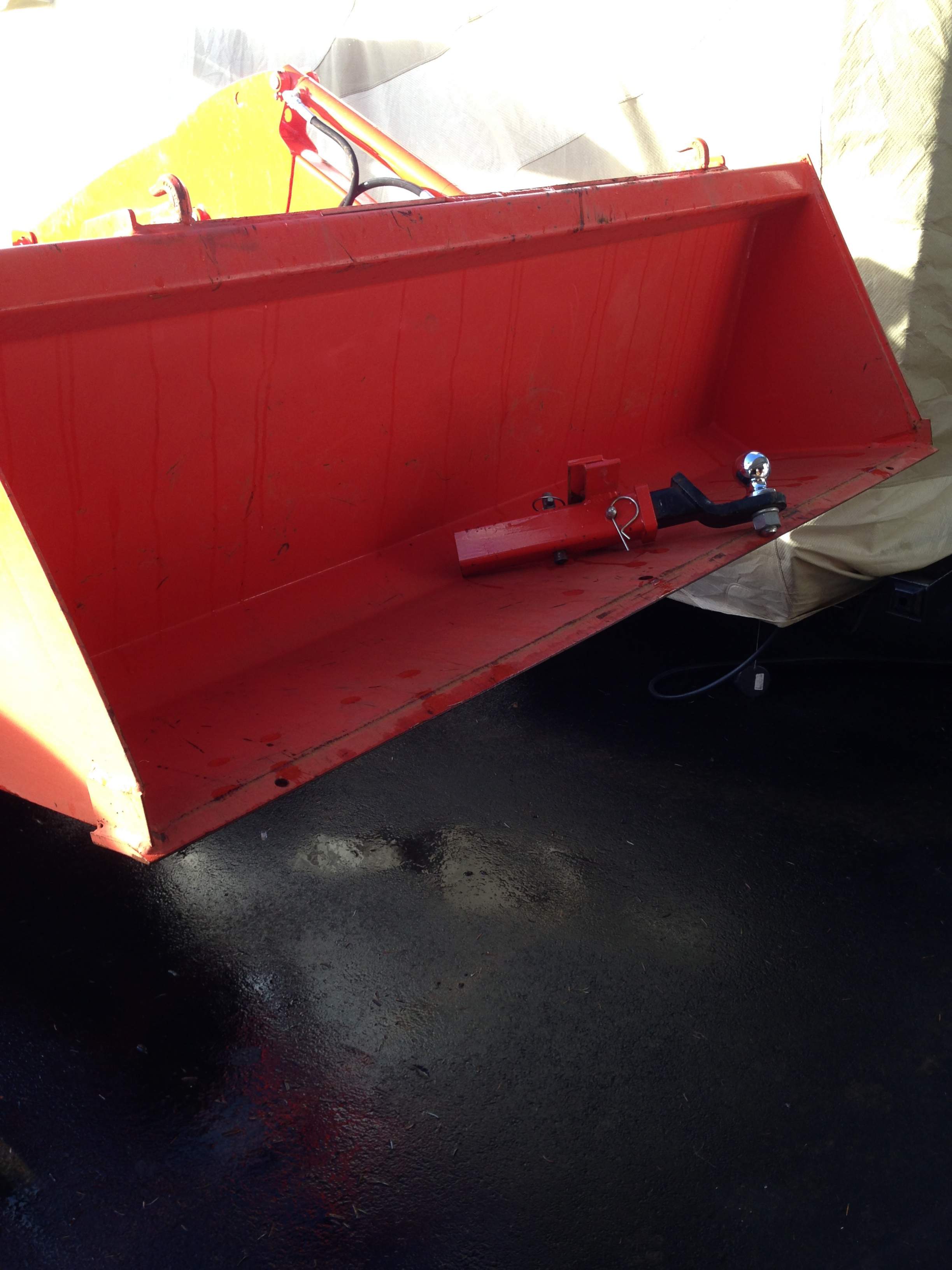

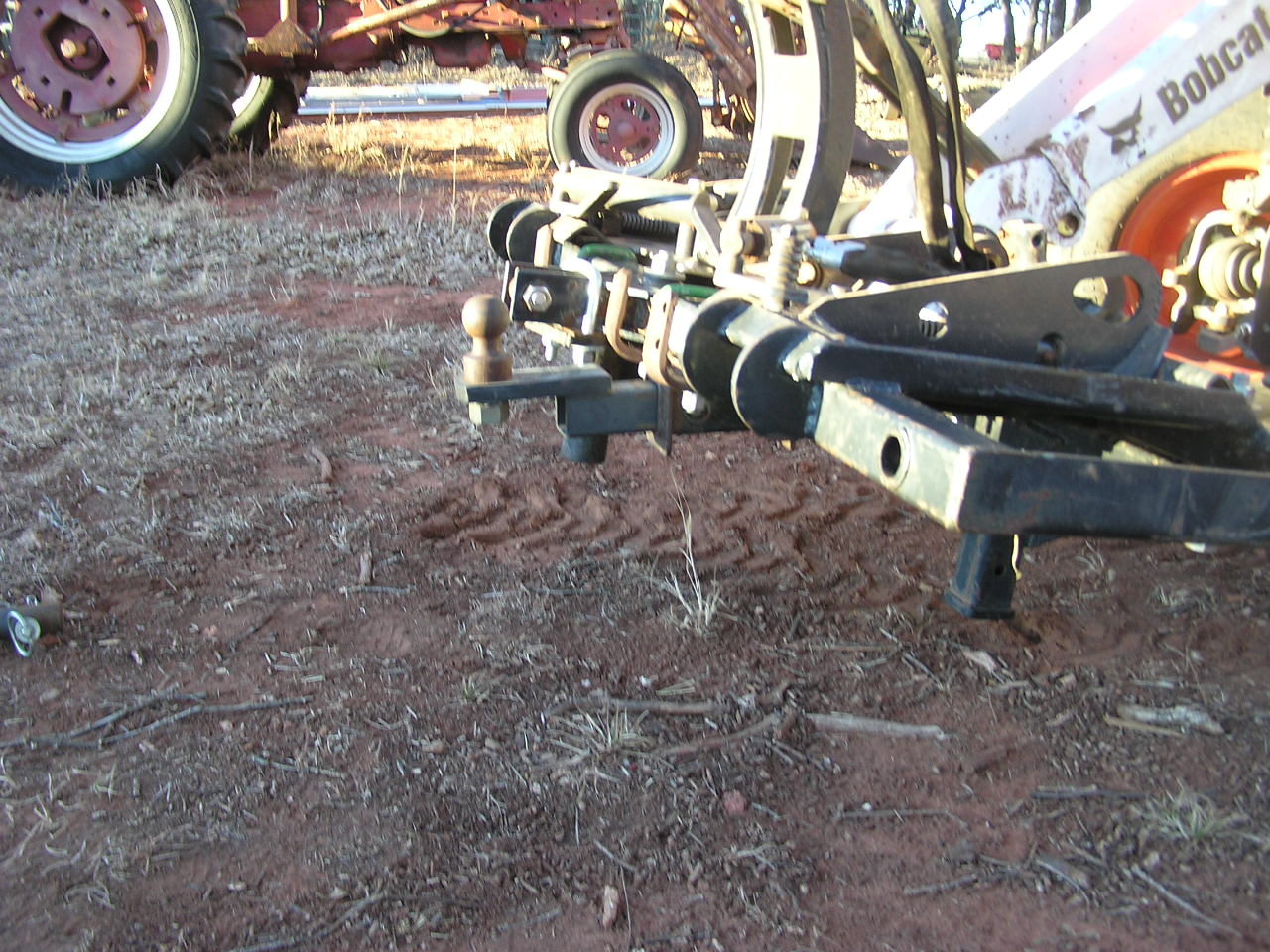

I added a receiver hitch and use it on the front for moving trailers.
Works gooder-un! :D :thumbsup:

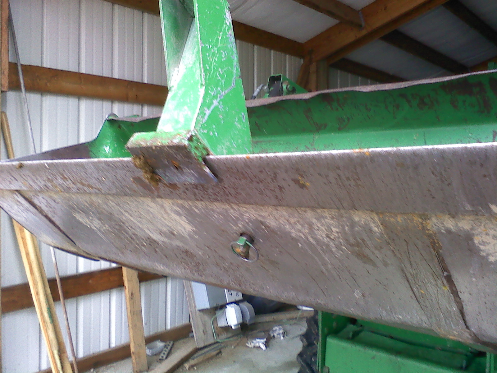

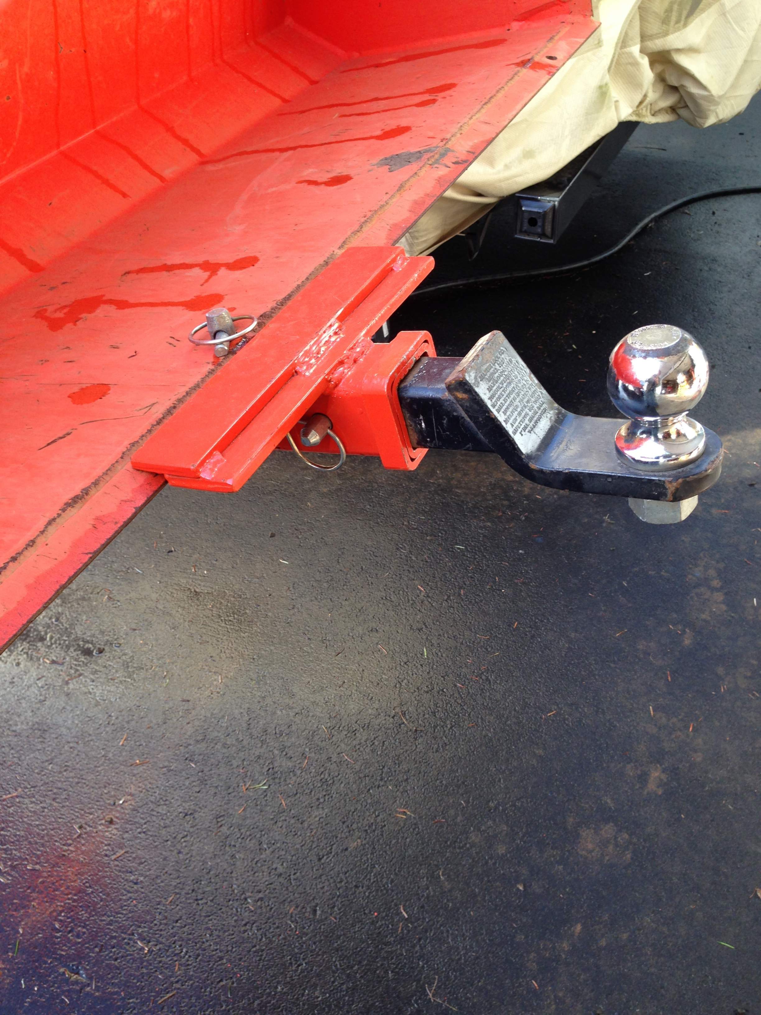

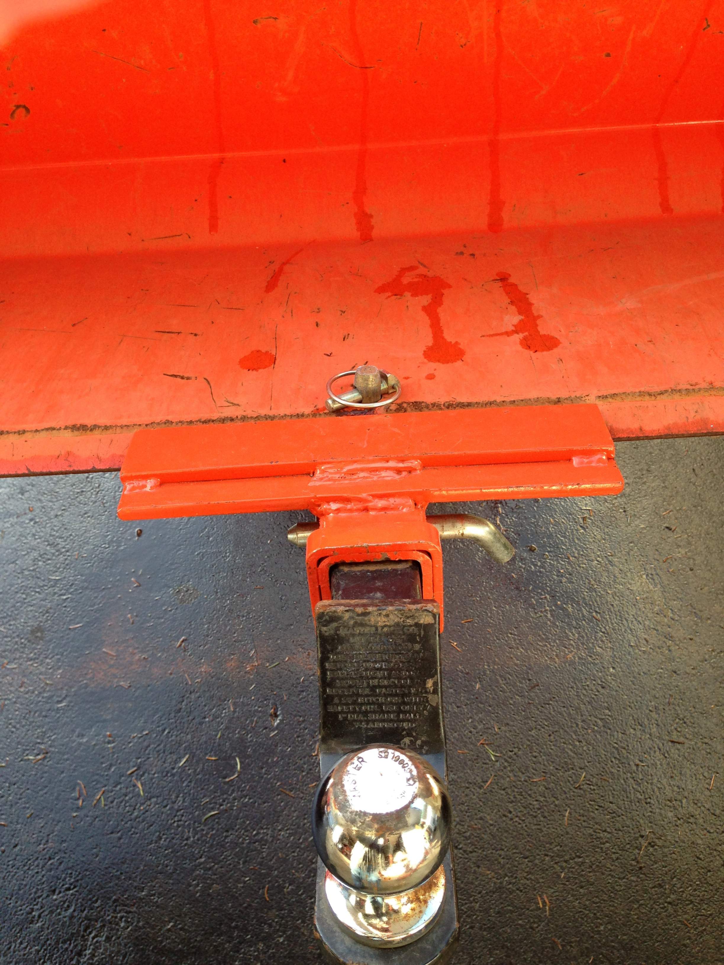

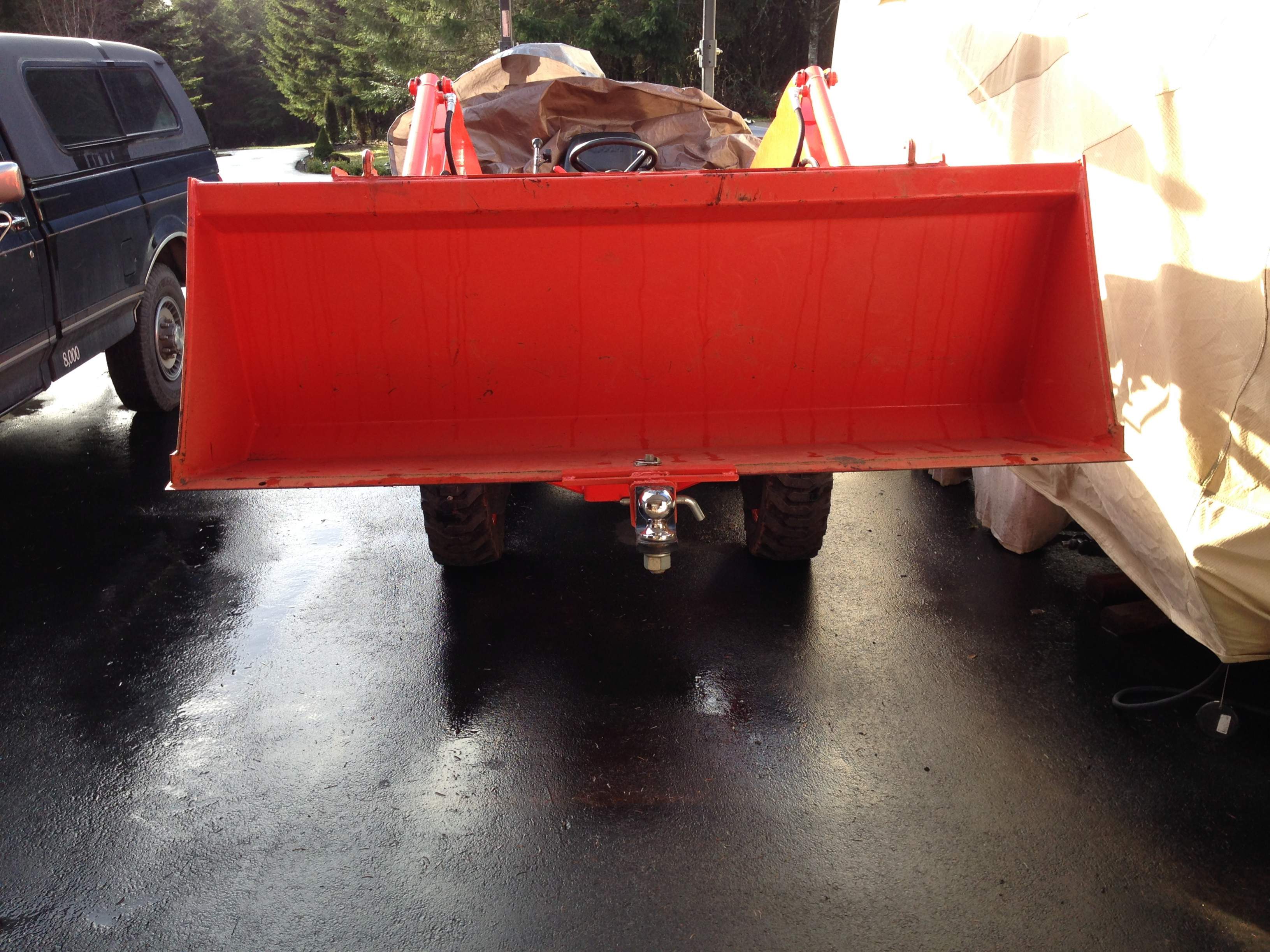

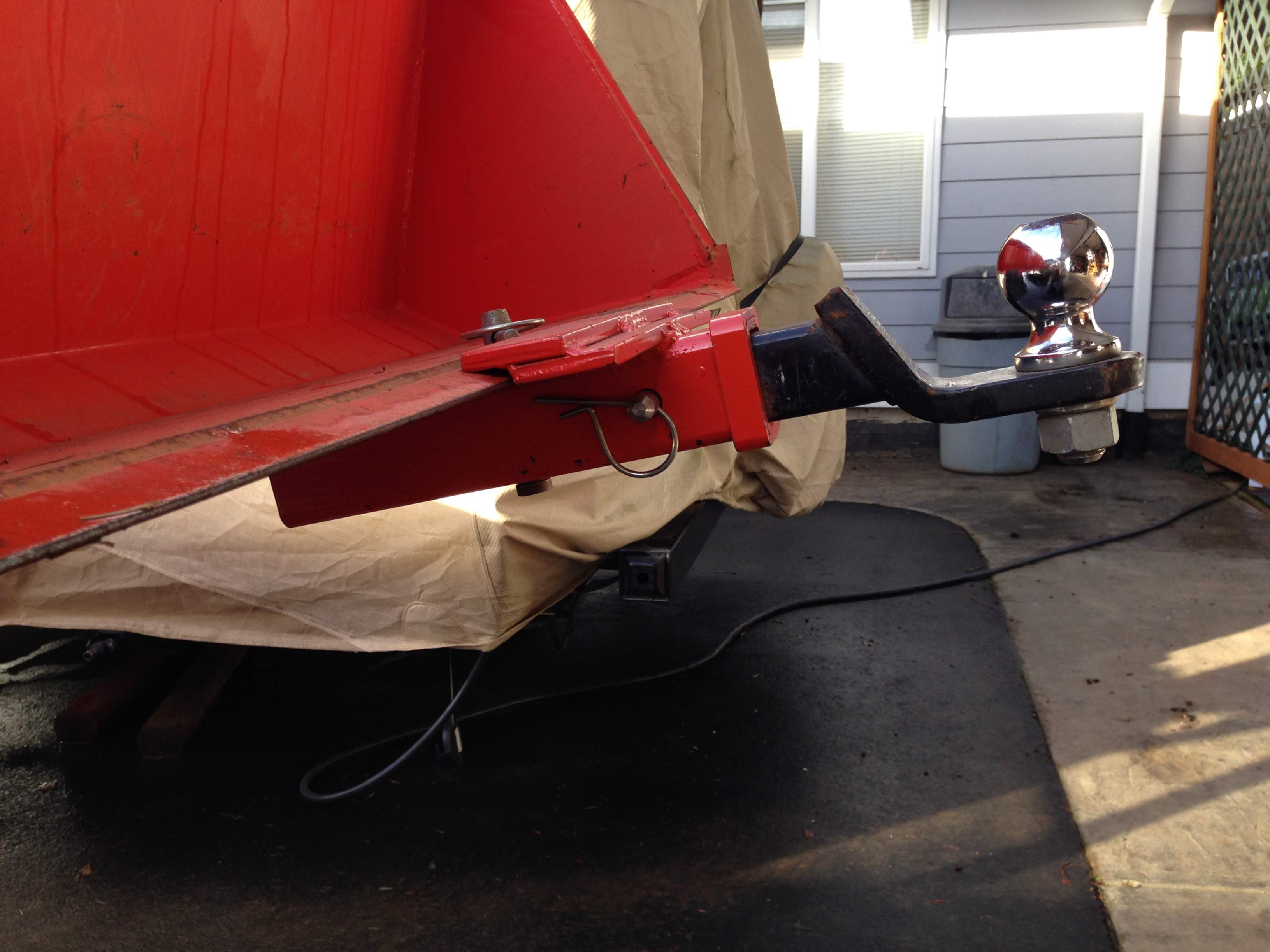

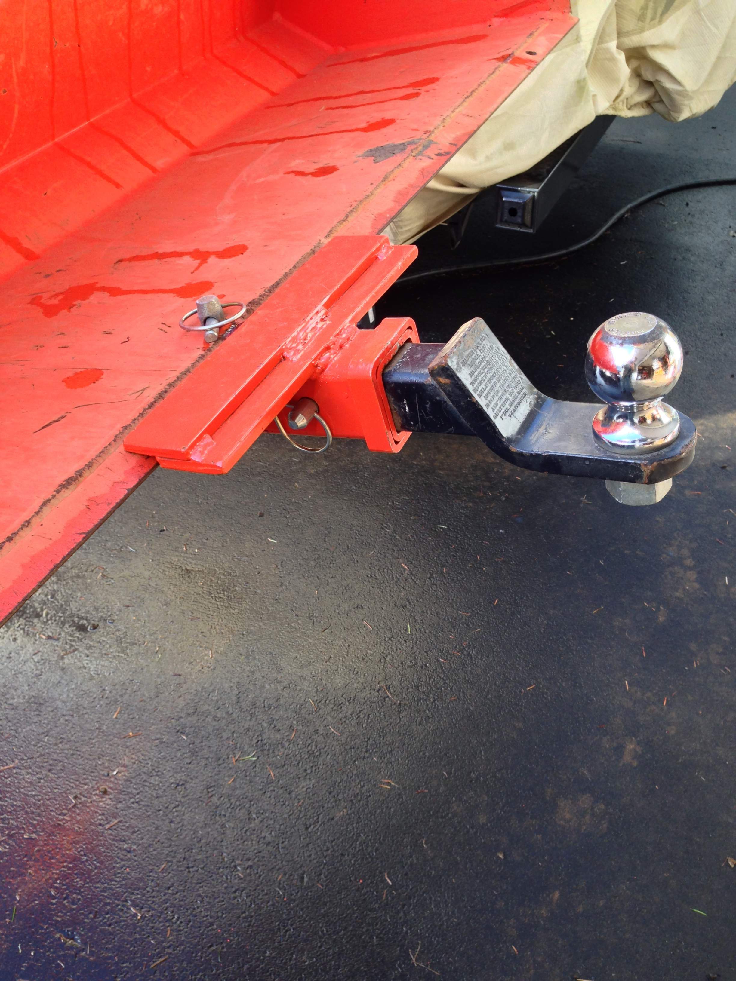

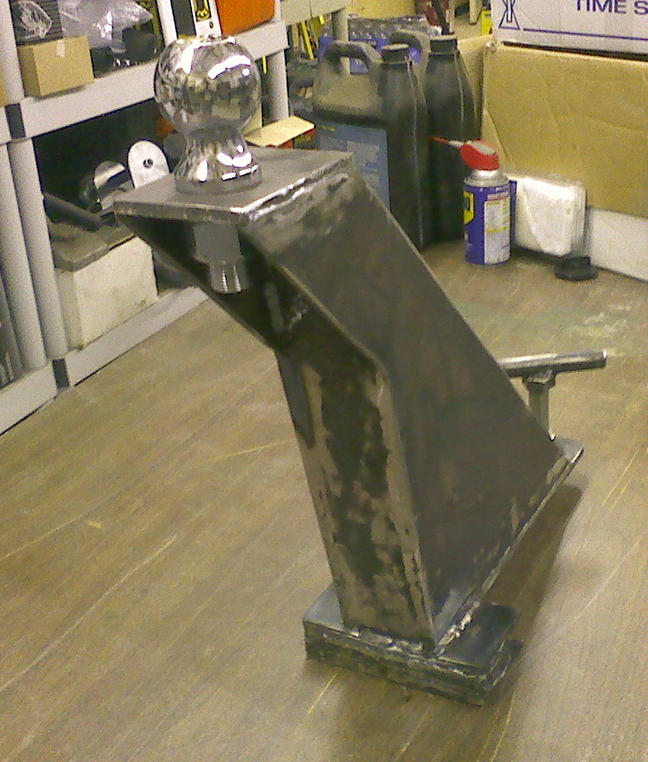

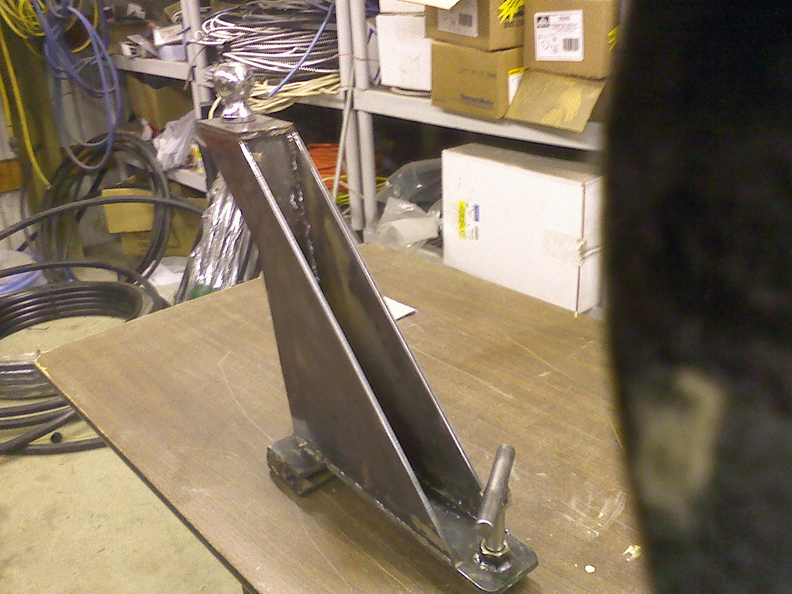

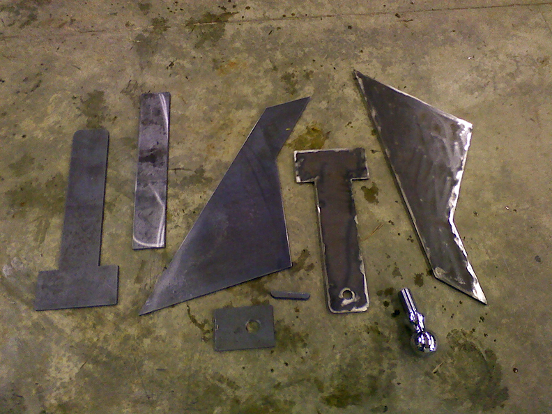

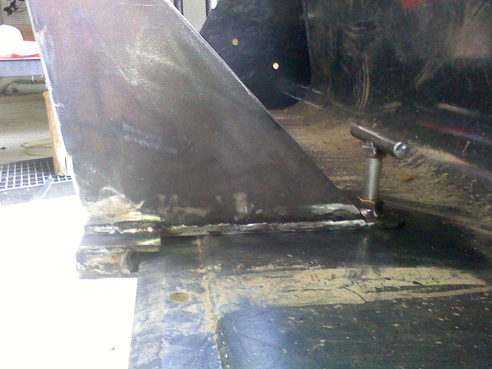

thats exactly why i didnt do that. i made this instead. works great on all bumper pulls and i can see the ball from the cab.
I drilled a simple hole thru bucket and the unit hooks on or removes in 20 seconds when needed.
plate 4.jpgplate 5.jpgplate 6.jpg0328111040a.jpg0328111041.jpg0329111630.jpg0317111122.jpg0317111123.jpg0317111123a.jpg

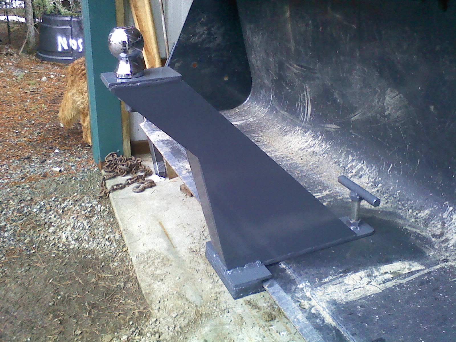

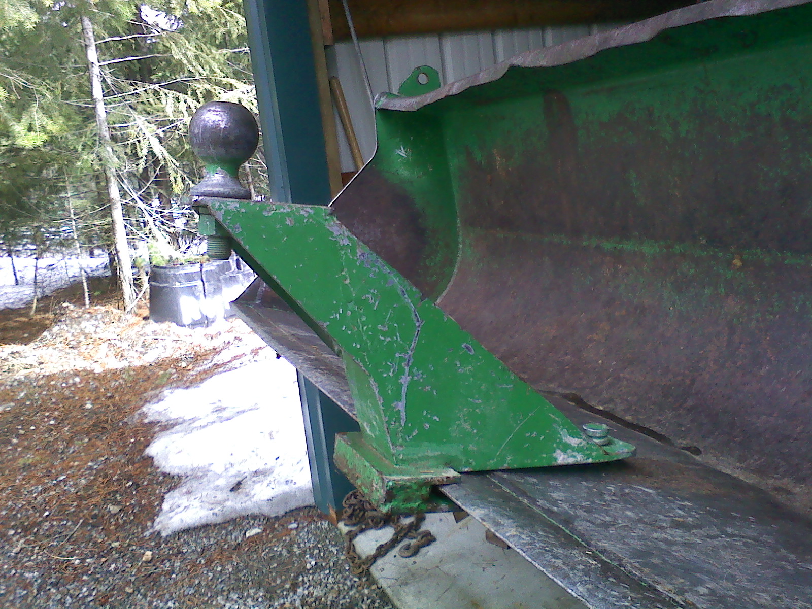

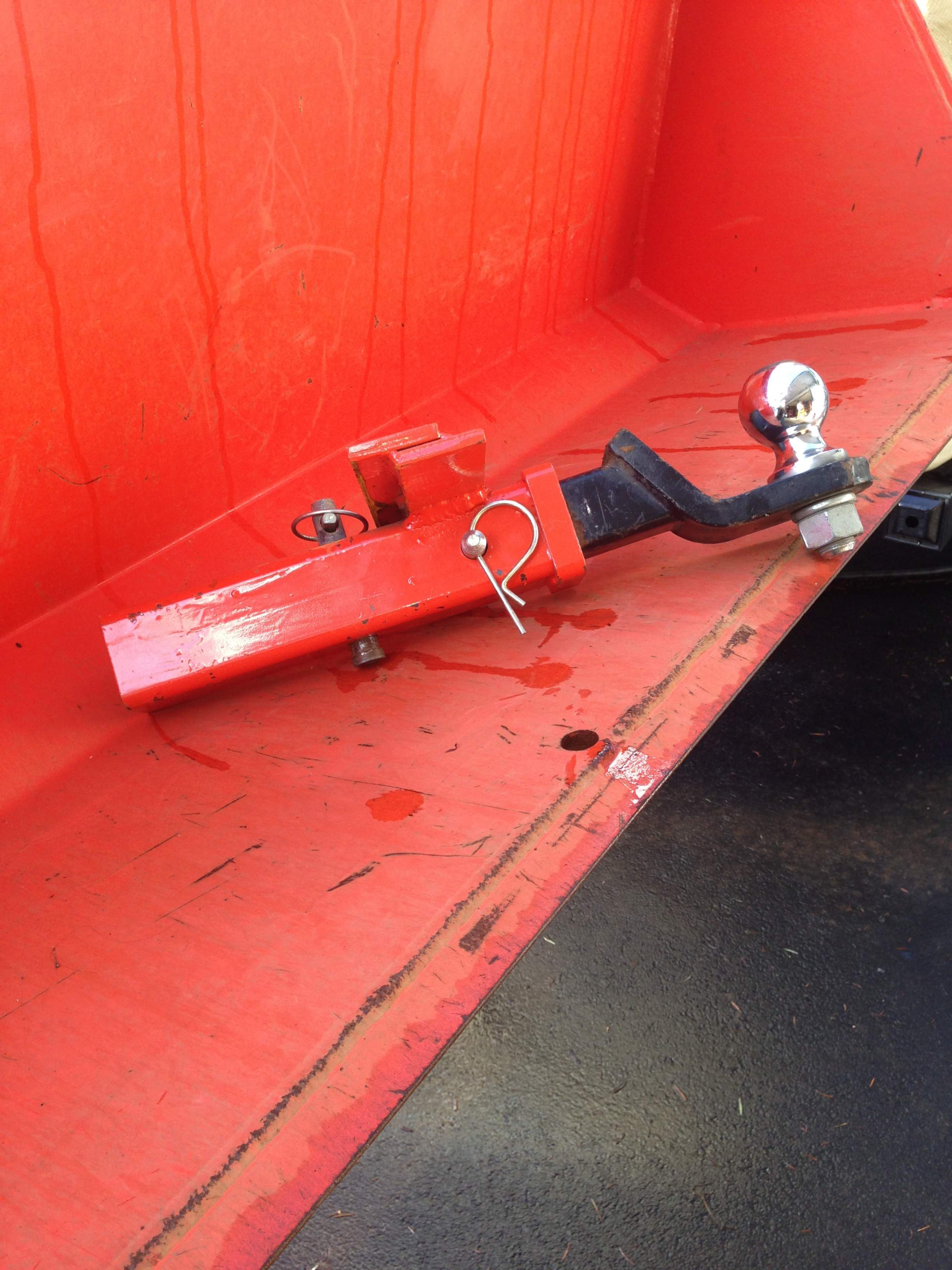

Here's my setup. I made this for easy hookup and removal, and to get the hitch in front of the bucket for visibility.
Very nice Pete. I think I'll try to make something similar when I'm able. Thanks for sharing.

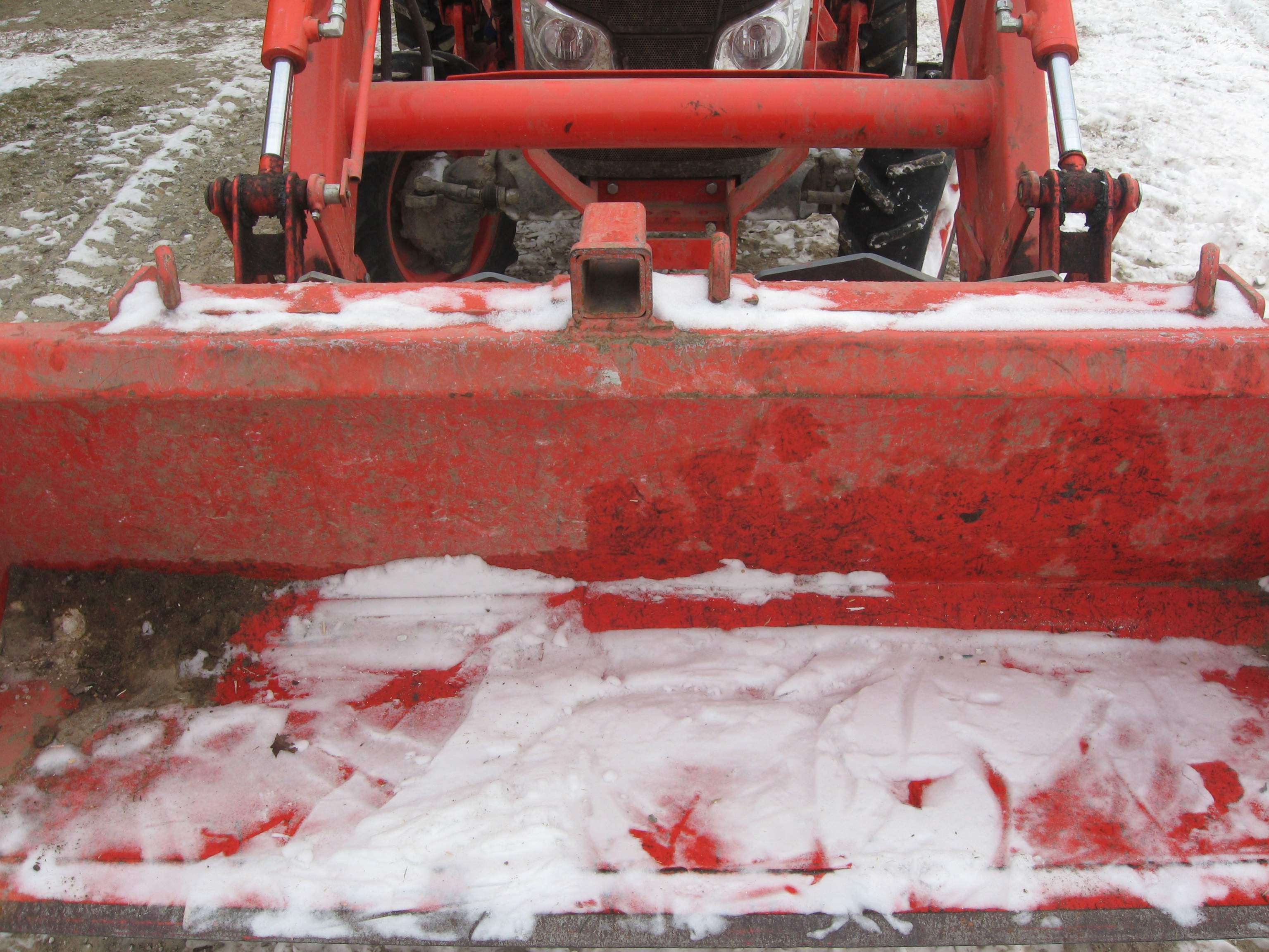

The best tjingI ever mounted in my tractor bucket is a reciever hitch. I use it for my homemade brush forks, mt 10000 lb. dump trailer, my 3 way hitch ball for a capstan to pull wood etc.. Bolted to the inside of my bucket blade it will not interfere with loading or backbladeing. Mine is on a CK30, and it has no problem moving anything. icandigit

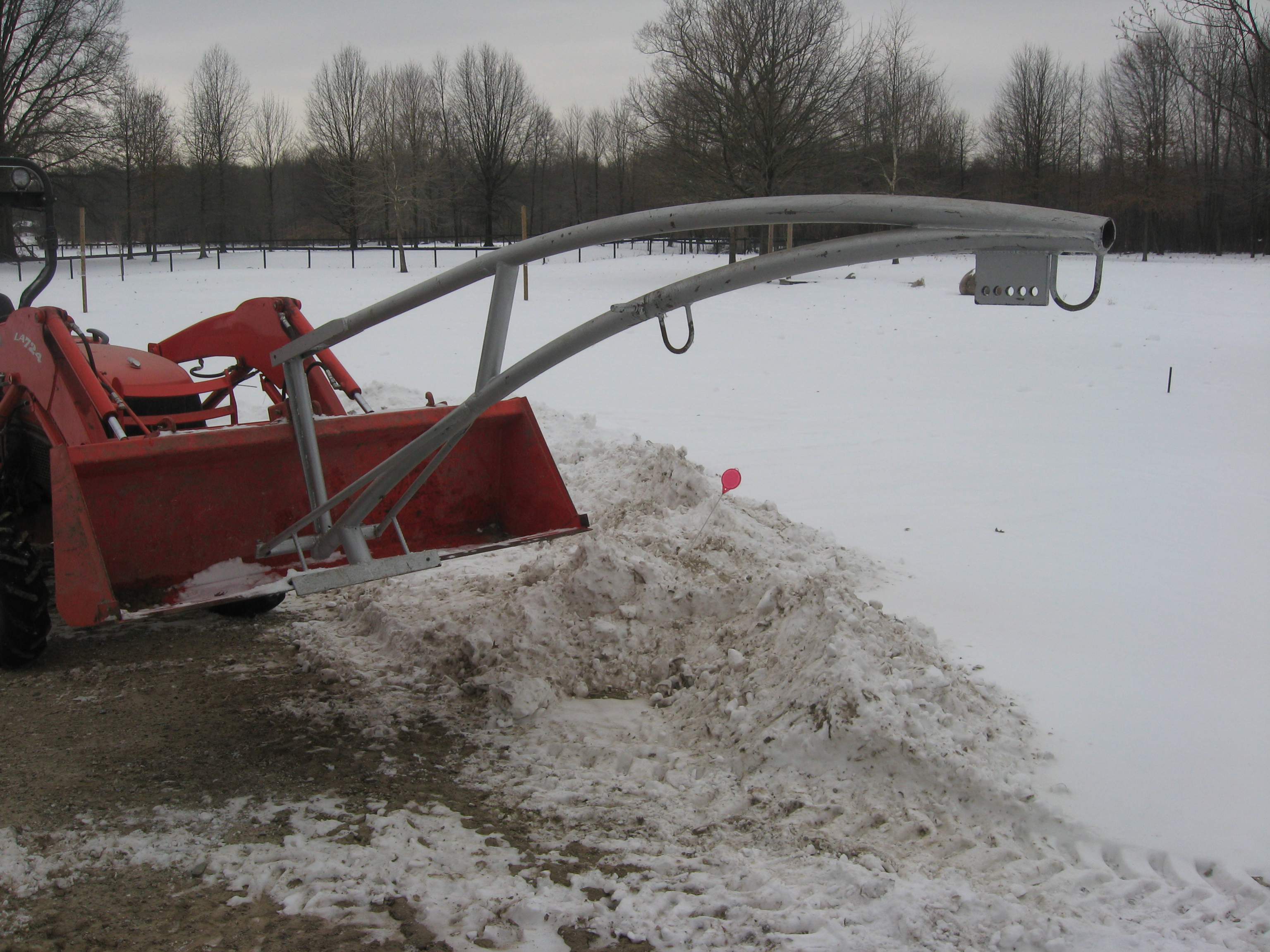

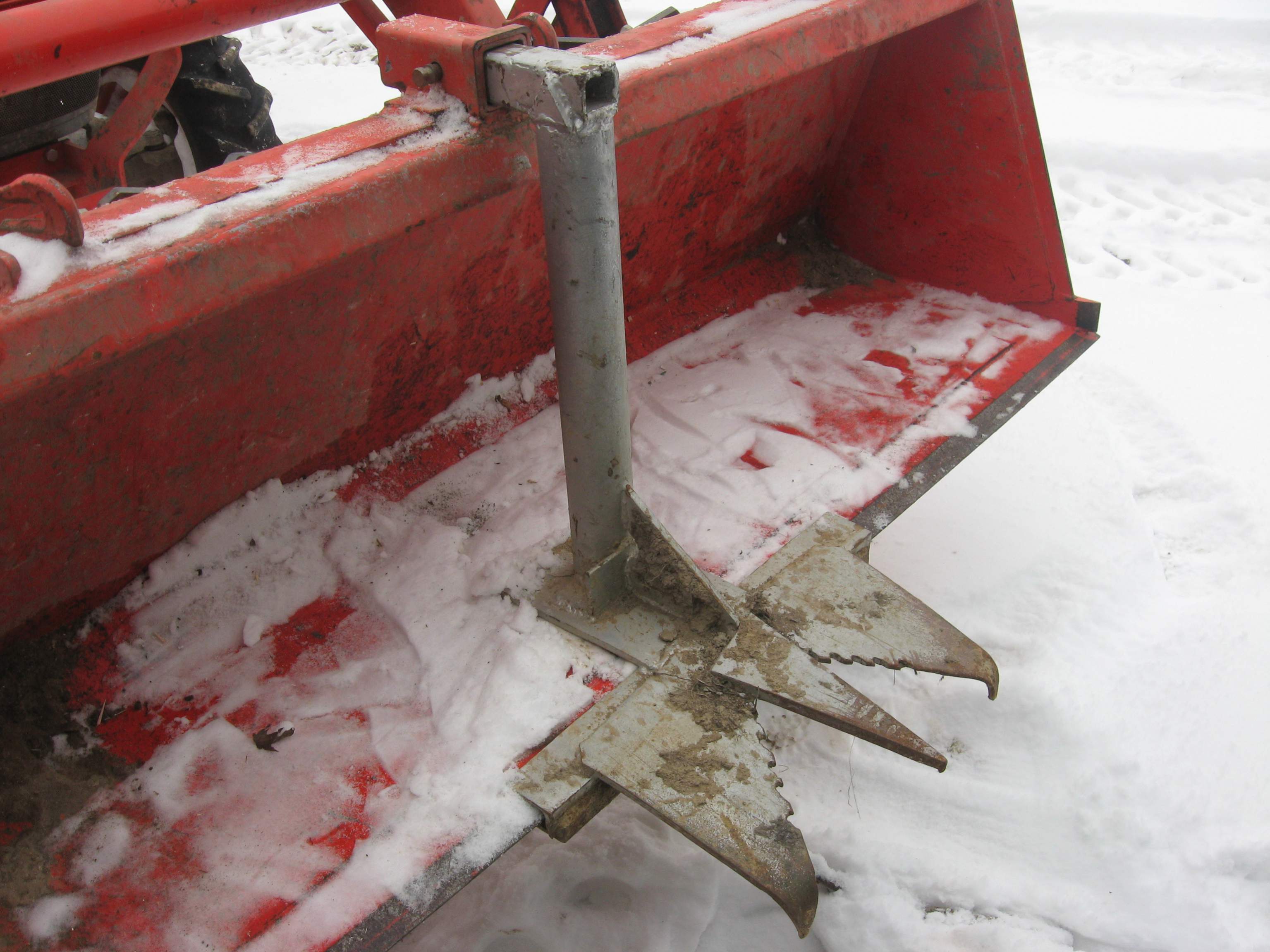

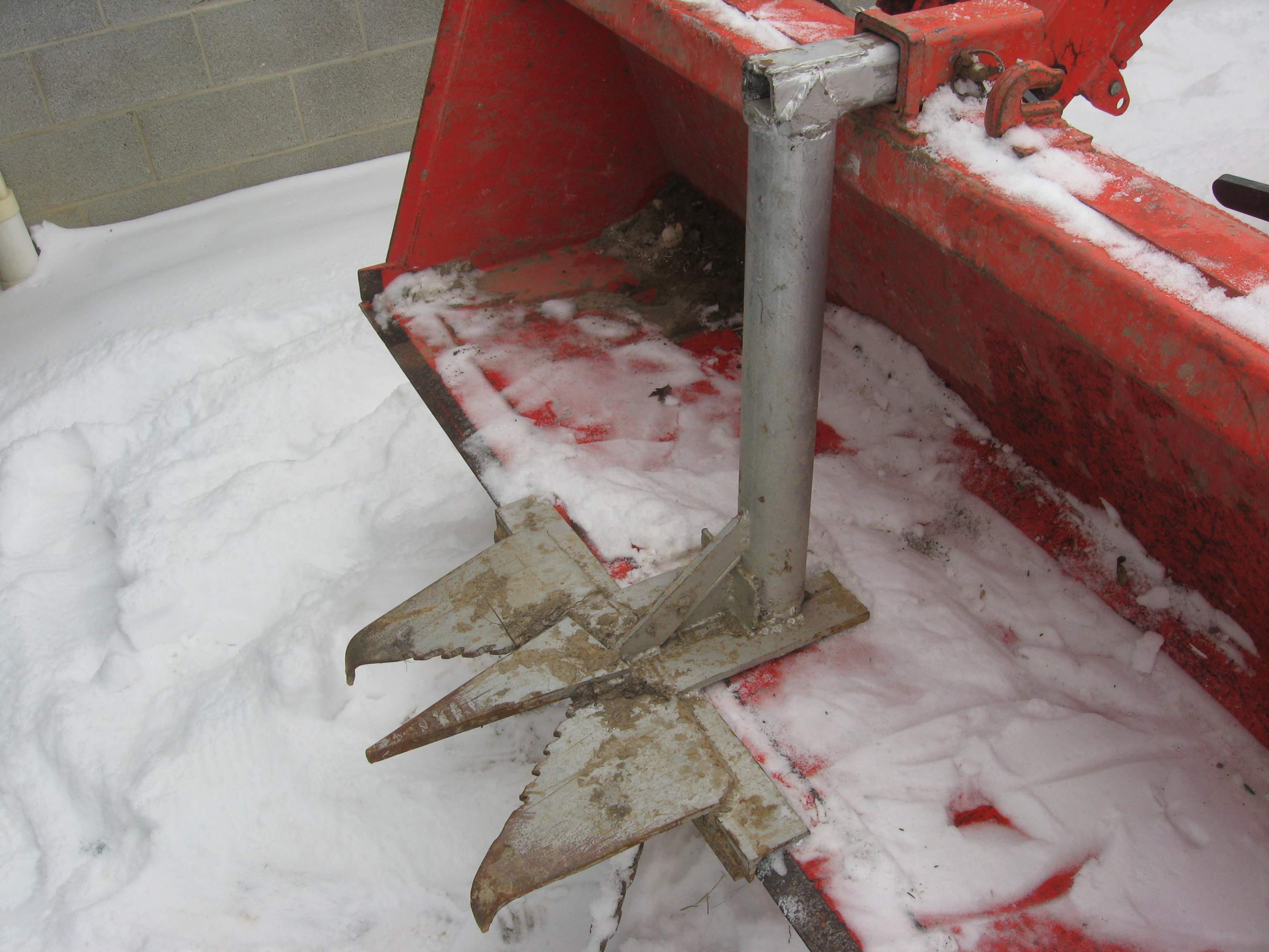

Maybe I used the wrong term. What I made has 3 teeth that hooks on the front lip of the bucket and the hitch on top. I then can either get into the roots or the trunk and pop the brush out of the ground. I'll try to get some pics later.
Jeff

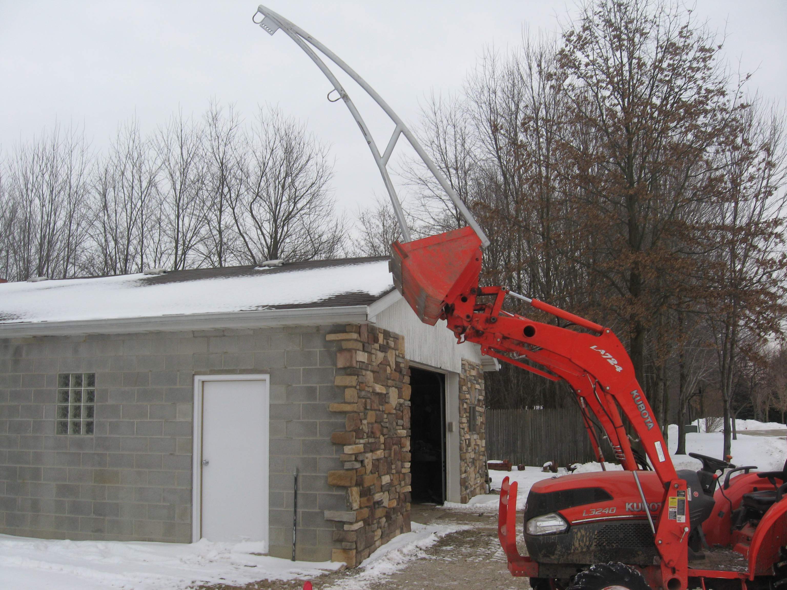

I guess I didn't descibe it too well.Here's some pics along with my boom attachment.IMG_1007.jpgIMG_1008.jpgIMG_1009.jpgIMG_1010.jpgIMG_1012.jpgIMG_1013.jpgIMG_1014.jpg
Jeff
