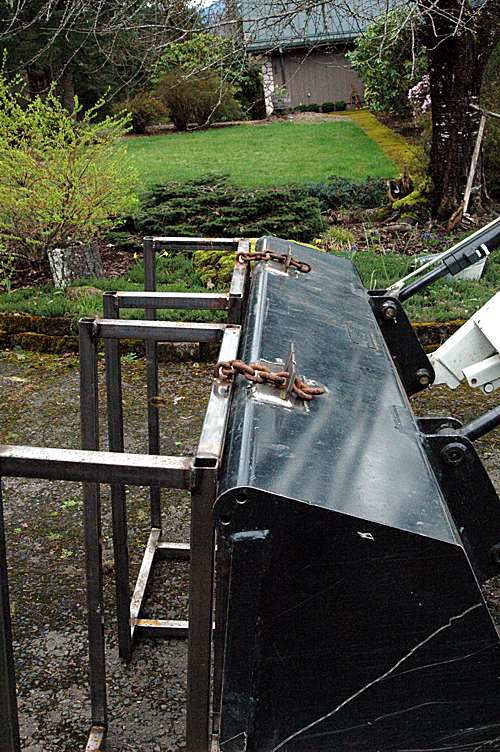

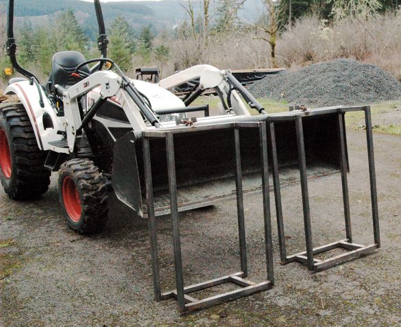

I built a set of firewood racks out of 1 1/4" tube, so I could haul wood from the shed to the house. They have some old chain welded to the top-piece so I can carry them using the FEL and my chain slots.
View attachment 503841 View attachment 503842

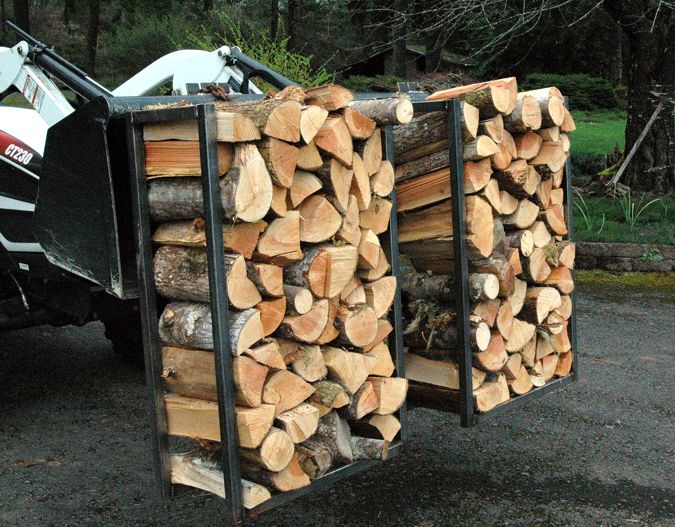

Here's a photo of the racks full of wood being carried by the tractor.

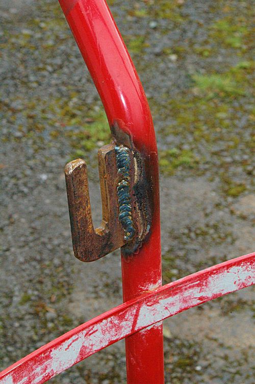

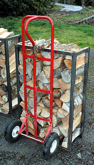

Once I get close to the house, I use a little Harbor Freight hand truck to move the wood to my deck. I welded a little chain-slot onto the hand truck to help secure the load.
View attachment 503844 View attachment 503845

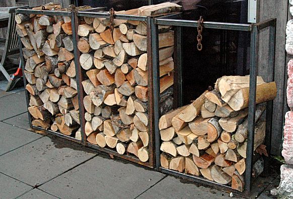

Here are three of the racks staged next to the chimney and a sliding glass doorway.
I forgot to show the canvas cover I sewed to protect the wood from rain and bird-poo :smiley_aafz:. It's open on the house-side so I don't need to take it off to get wood.
The nice thing is that I now don't need to stack wood in the bucket, then carry it from the bucket to the staging area and stack it yet again.
To me, there is no better way than to containerize or palletize wood for this wood burning game we do.With that said, my attempts with this method was an utter failure and here's why: I burn 5-6 cords per year. I have 3 years worth of wood waiting in the wings (wood processing lot). This would necessitate 16-17 built palettes for one years worth of wood. I would need twice this amount for the two year drying time. When I take the palettes to the wood shed, they take up so much room to manipulate and store, I can't get half of the wood in there when they are palletized. The palettes seem to get beat up very quickly so one is always having to repair and fix the darn things. Lastly, I've discovered I have very little patience making palette containers. It all came down to doing it the old way. That's me and heck, I prefer a gear tractor to HST.
