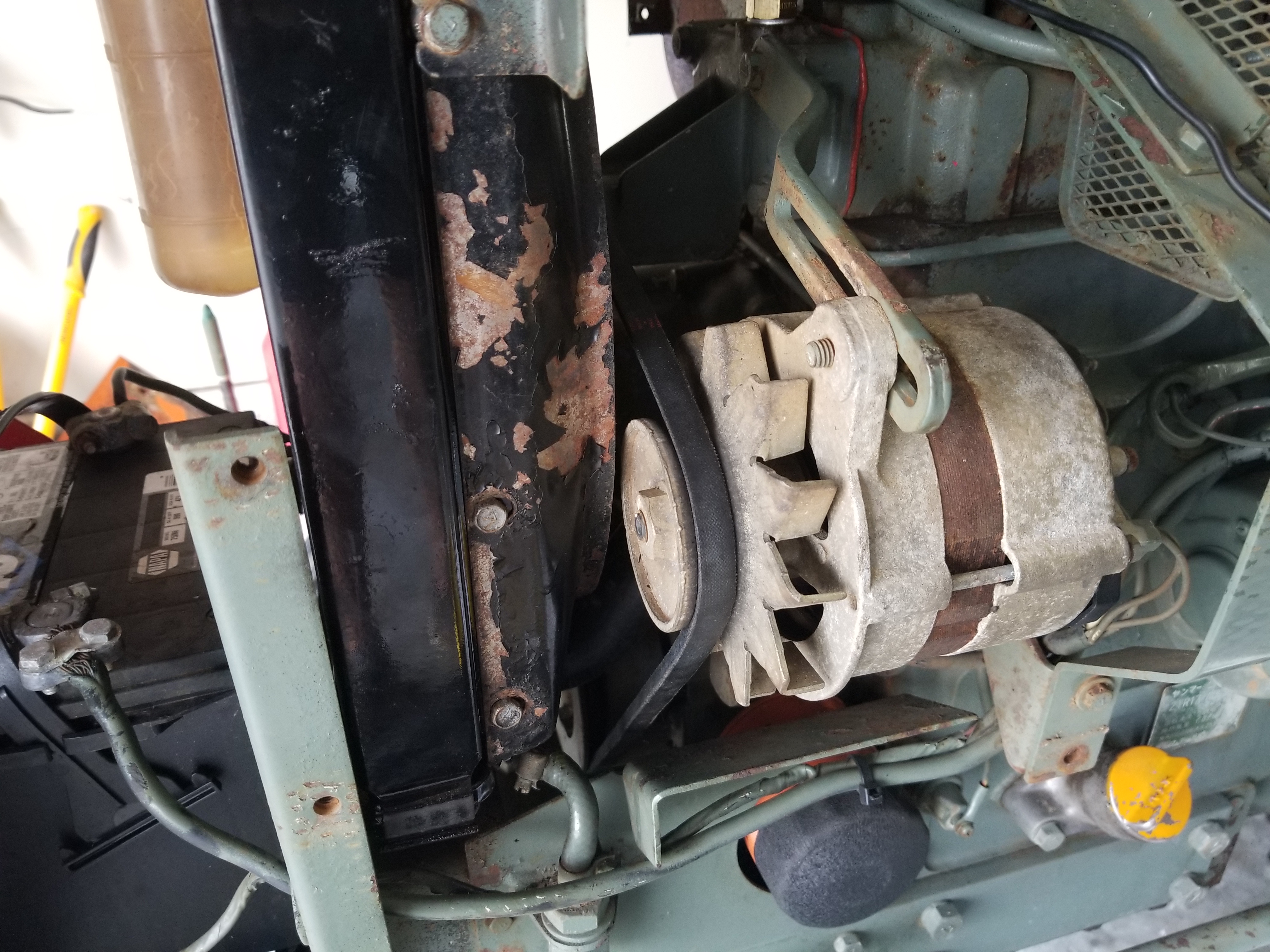

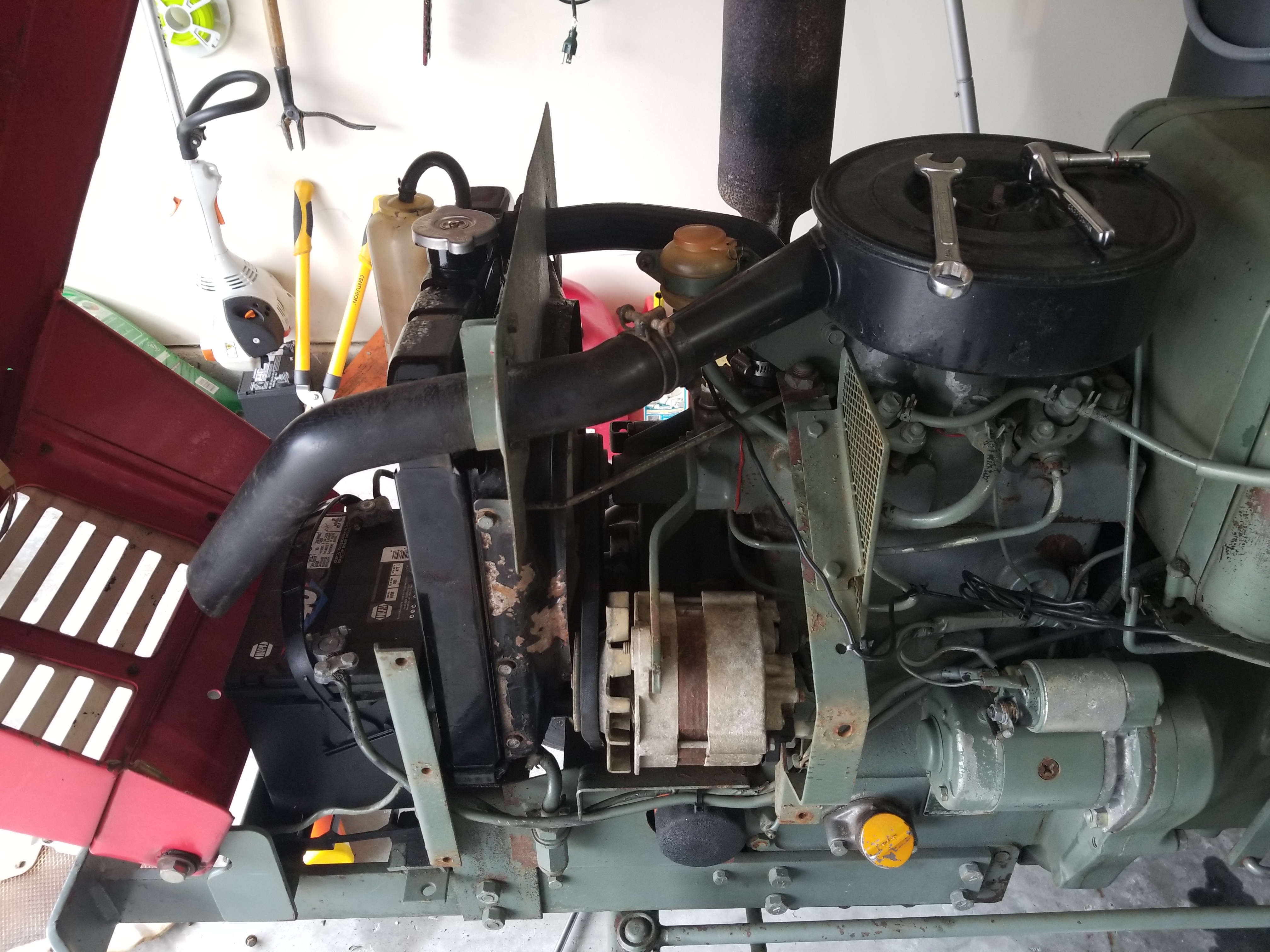

Here's some pics - everything is in and looks great but the alternator is awful close to the fan shroud. Is this normal? Or should I trim the shroud a bit? 20170928_174105.jpg20170928_174109.jpg
   / My First Real Tractor! #108
Not to worry, it will trim itself. :D
Wait and see, if you hear a racket then it needs to to be trimmed!
   / My First Real Tractor! #109
:laughing: it will look like factory! All kidding aside if the motor doesn't roll around much should be good. Ever look hard in the engine bay of new car and trucks and see how close everything is in there.
