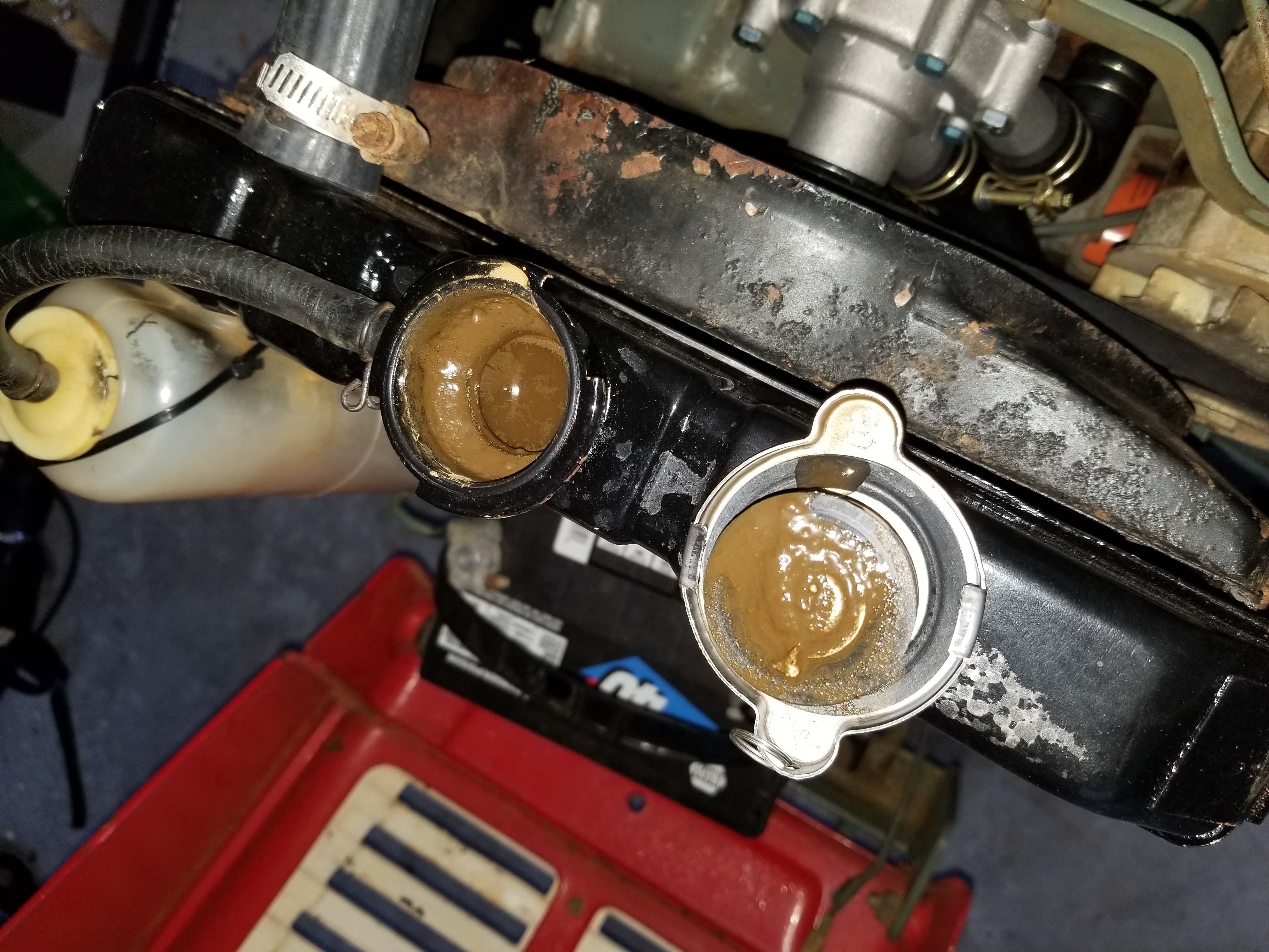

AHHHHHHHHHH! It never ends! Alright, so this may not be a big deal. But I pulled the cap off the radiator after running it for a while, with just STRAIGHT water. It NEVER did this before the water pump, not with straight water, not with antifreeze mix, etc. It was always extremely clean. Now I figured the water pump would stir up some nastiness inside the block (which is why I pulled the cap to check it) and I am really hoping that is all this is. I am thinking the water pump rushing water through there just stirred up all kinds of crud that has sat untouched for a while. I wiped on a paper towel and it is NOT oily at all nor does it smell like oil or fuel. Smells like antifreeze still and wipes off like water. Should I just run a few flushes through it, refill it, run tractor, repeat, etc.?? nasty.jpg
