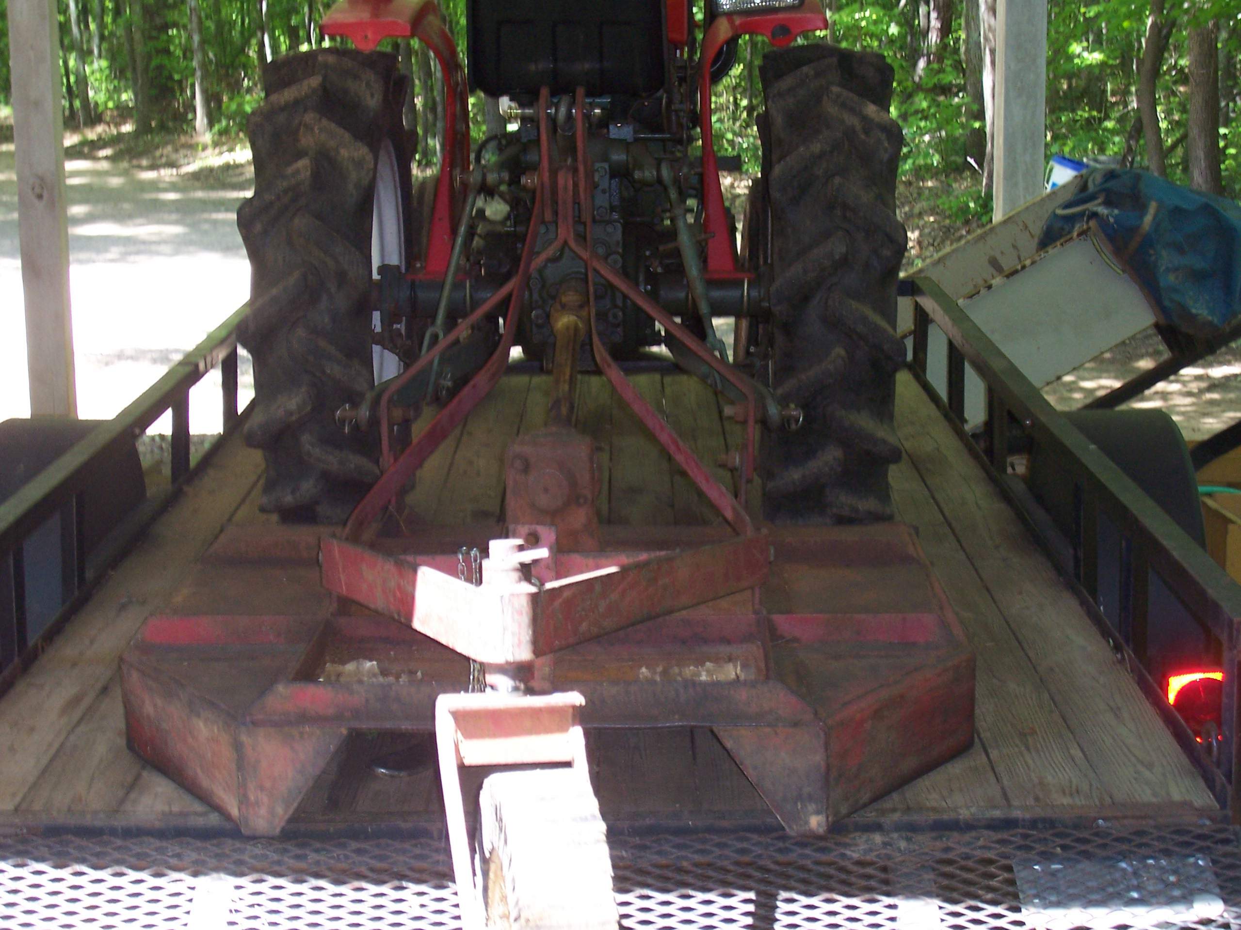

I use a 4ft. BH. which what I like about it is it pretty much the same width as my rear wheels. That way I don't catch it on things. It also has a stump jumper which is a wedge under the BH. that is in front of the Blade and Drive shaft. Try and make sure you buy one that has it then if you hit a stump Etc. the BH. won't get caught on it.
Here a pic. of my old International BH. and it's a beast!! I use it to clean/clear trails and growth in the wooded land behind me;)

Man that is exactly what I need! Currently, all of the one's on CL are like $700+!! I know I can find a deal if I hold out a bit.
