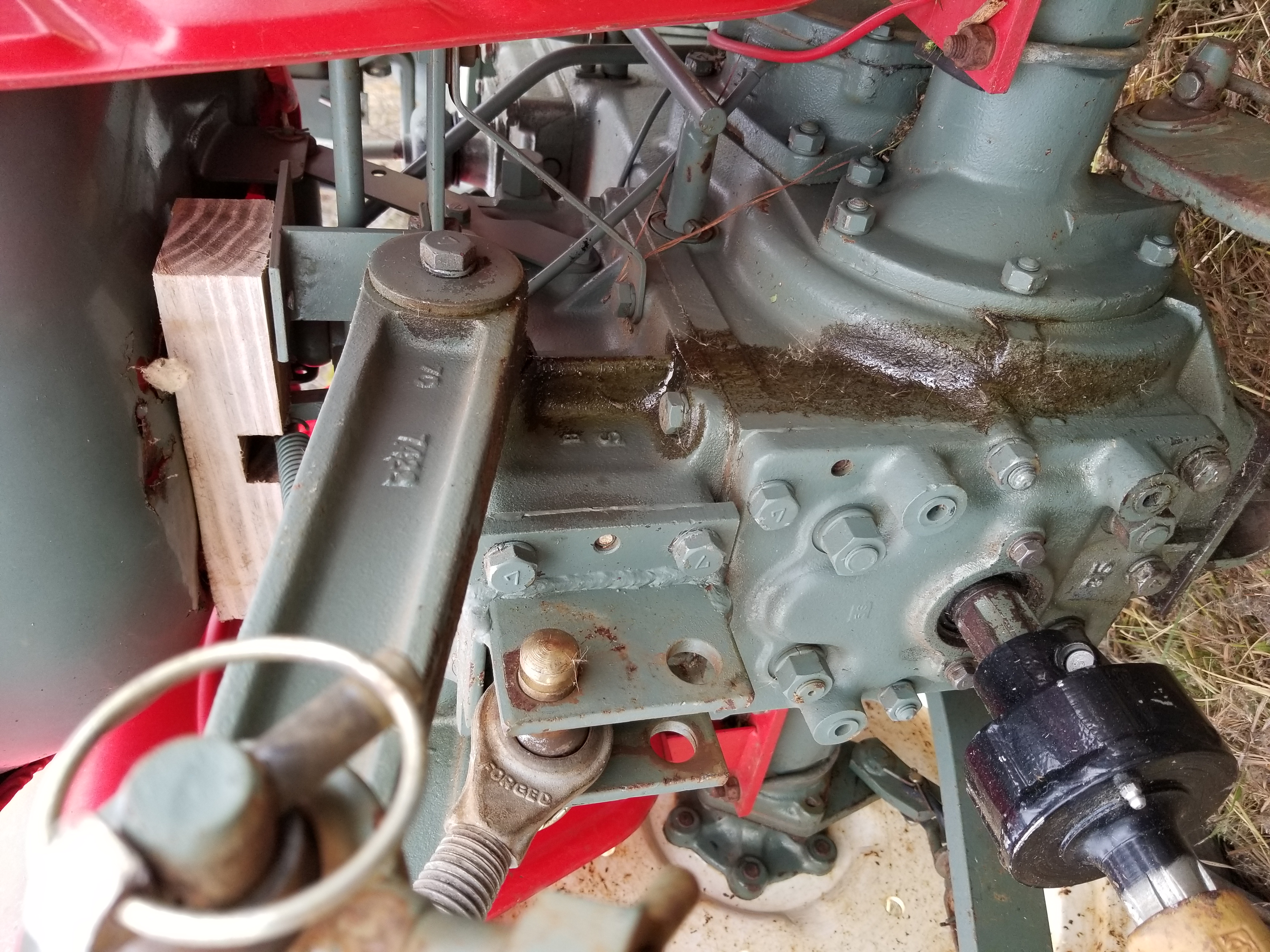

Finally got to really work it hard for the first time. Ran the bush hog for about 4 hours today. Cuts great, works great! Couple of things I need some advice on:
1. The temp started climbing to around 215-220 after running for about 45 minutes. The stuff I am cutting is chest high and some places head high and very thick. Tractor is not bogging or lacking of power, but it is work. I shut it down and checked the radiator - FULL of crap from cutting. Put some mesh over the grill and I also forgot my "driver" side engine cover which will help next time. I brought a blower and cleaned and blew it out the best I could every 30 min or so but the little white things in the air literally kept caking on the radiator. I would shut it down for a minute, clean off what I could, then let it run around 1800 RPM for around 5 min and temp would drop down to about 175 and I'd go again. Kind of annoying, but I noticed the water in my radiator still needs to be flushed a few more times along with the radiator clogging up is probably the reason as it is obviously cooling correctly once clean again. Cleaned radiator with compressed air when I got back home and drained the dirty water. The block must just be full of all kinds of crud. Again, no oil at all - literally just muddy ditch water.
2. I developed a leak here on both sides. What would cause this, just old seals? Easy fix? It's odd, it seems like it almost stopped leaking as it's not getting any worse and I don't think it leaked anymore after the initial time....? Is there a vent or something that could be plugged possibly and made it "squirt" out there temporarily?

#8 in attached is the vent for the transmission/hydraulics. Might want to check and make sure it is open. #s46 & 47 are the seals for the rockshaft but I doubt you would want to change them. HYDRAULIC_LIFT: Yanmar Tractor Parts
