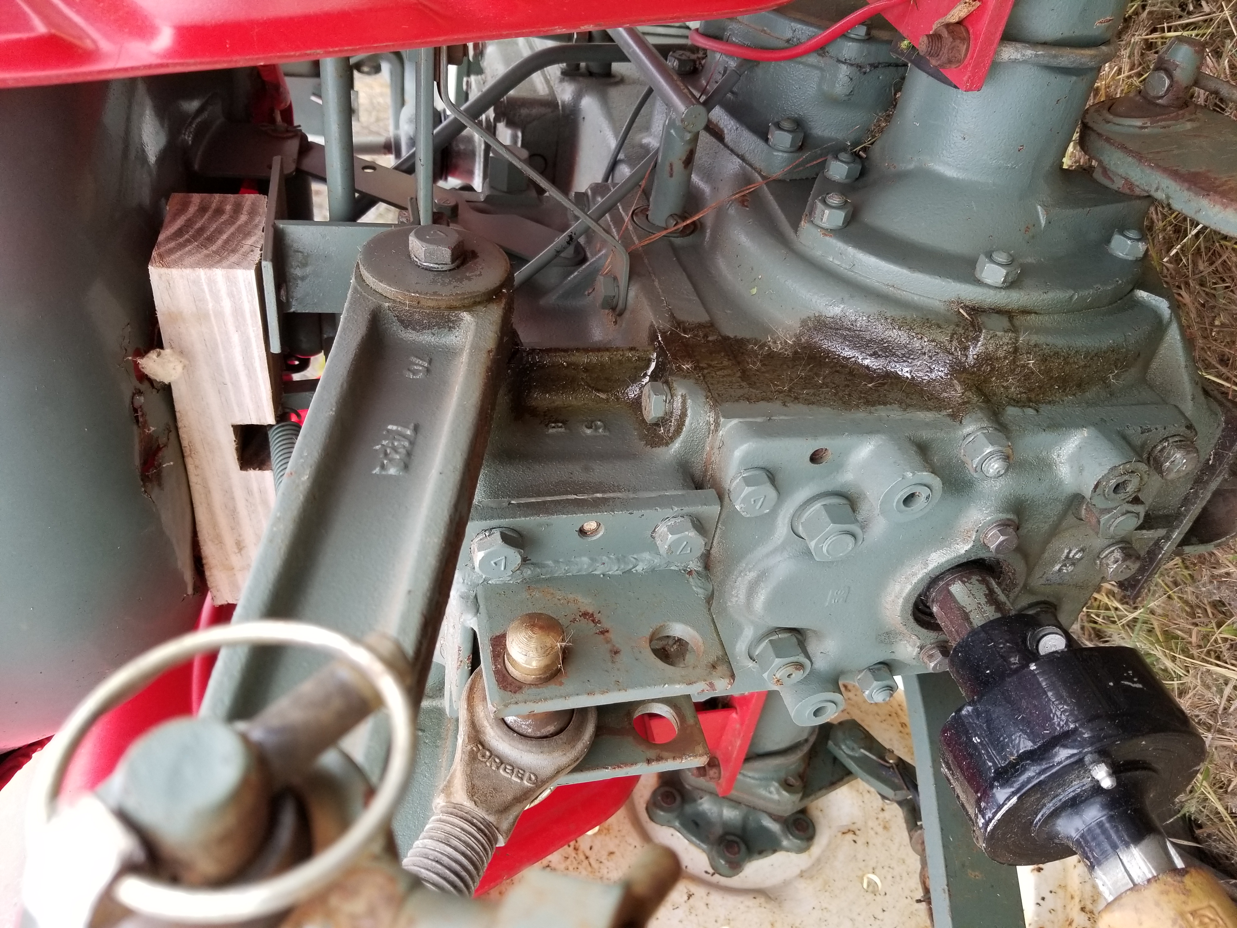

Finally got to really work it hard for the first time. Ran the bush hog for about 4 hours today. Cuts great, works great! Couple of things I need some advice on:
1. The temp started climbing to around 215-220 after running for about 45 minutes. The stuff I am cutting is chest high and some places head high and very thick. Tractor is not bogging or lacking of power, but it is work. I shut it down and checked the radiator - FULL of crap from cutting. Put some mesh over the grill and I also forgot my "driver" side engine cover which will help next time. I brought a blower and cleaned and blew it out the best I could every 30 min or so but the little white things in the air literally kept caking on the radiator. I would shut it down for a minute, clean off what I could, then let it run around 1800 RPM for around 5 min and temp would drop down to about 175 and I'd go again. Kind of annoying, but I noticed the water in my radiator still needs to be flushed a few more times along with the radiator clogging up is probably the reason as it is obviously cooling correctly once clean again. Cleaned radiator with compressed air when I got back home and drained the dirty water. The block must just be full of all kinds of crud. Again, no oil at all - literally just muddy ditch water.
2. I developed a leak here on both sides. What would cause this, just old seals? Easy fix? It's odd, it seems like it almost stopped leaking as it's not getting any worse and I don't think it leaked anymore after the initial time....? Is there a vent or something that could be plugged possibly and made it "squirt" out there temporarily?

Here's pic of the leakView attachment 525806
Run BH at say 2200, level a little bit for reserve. Bouncing is normal. Sometimes you can tighten the cable and it helps some.
That stuff your cutting would be hard on any tractor that's a lot of stuff. And that white fluff does that to all our tractors. That's why I said get some window screen on the front and even of its that bad the sides. This is normal, I stop every 15 mins to an hour to clear mine depending on how bad It is. Do you have the yanmar original screen that goes in front of the radiator that is suppose to catch 90% of that crud that can easily be pulled out and dumped? You need to get one of those if noalso...where are the leaks?

#8 in attached is the vent for the transmission/hydraulics. Might want to check and make sure it is open. #s46 & 47 are the seals for the rockshaft but I doubt you would want to change them. HYDRAULIC_LIFT: Yanmar Tractor Parts

Definitely check the vent.
But those are the orings on the shaft. I just did those this summer as mine would leak but not that bad. They do it when the fluid gets hot and thins. Get those O rings from Hoye you will never find them local, I tried. There easy. Unbolt the arm it pulls right off behind a washer that orings just sits in there. One of the easiest ones to replace. It stopped all of that leak on mine...but again mine was not near that bad.
I have a post where I described it..not sure in how mch detail or if I posted pics? It's literally nothing, 5 mins a side. I did it when I did brake shaft seal and resurfaced on of my drums this year.

Thanks guys! Well my vent tube looks like it is broken off, just a little hole left in the housing haha - so it is nt clogged but is this something to worry about?
Also noticed, there seems to be a vent tube for each brake - both of these are clogged. I'm afraid to mess with them though as they seem very brittle due to age.
