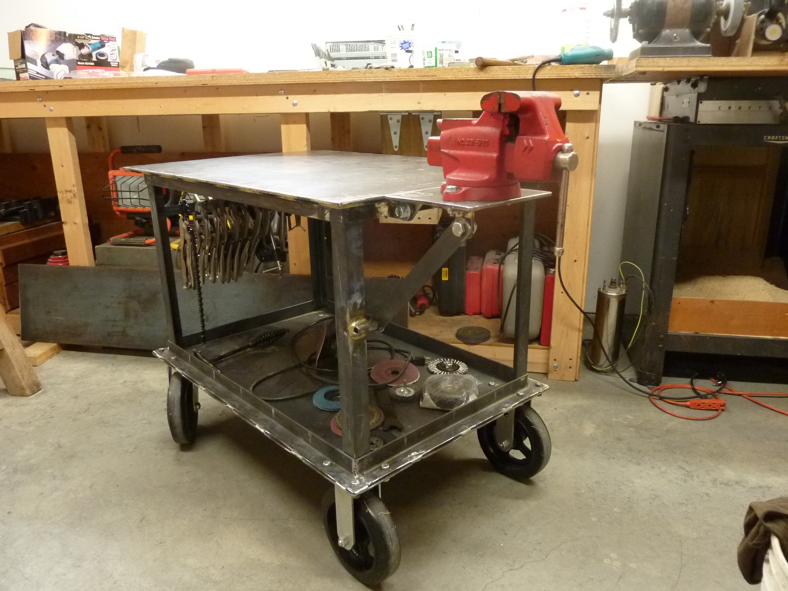

I love the hinge on the vice Gordon ! If you take the filter out of the shop vac you may have less chance of sparks lodging in it and starting a fire from the fanning action. Had a case where someone used a shop vac to take ash out of a pellet stove and a fire started in the filter. They do make a ash vac that has a 'fire proof' filter.
   / My First Stick Welding Project #12
GG, as groundcover said , take filter out, add some water to vacuum base and you should be ok. Still have plastic hoses. Nice start. At any level, welding can be fun.

That fume extractor looks to work well. You put much more into it than I would have, likely just a fan at the window sucking the smoke out would have been my lazy way but then I don't work in a basement either so my smoke extracting is just to keep it down to breathable conditions. I don't do a lot of welding in my shop anymore and when I do, I roll my table to the edge of the doorway so smoke isn't a consideration so much.
Very nice table build by the way.

Thanks Dragoneggs. I built the table with my torch set along with some advise I got here. In the same "shop". It is one of the handiest things I have. I use it for everything it seems. It was my first major welding project.
gg
Nice welding table. Only thing I would have done differently is use non-swiveling casters with locking capability.
Good luck
