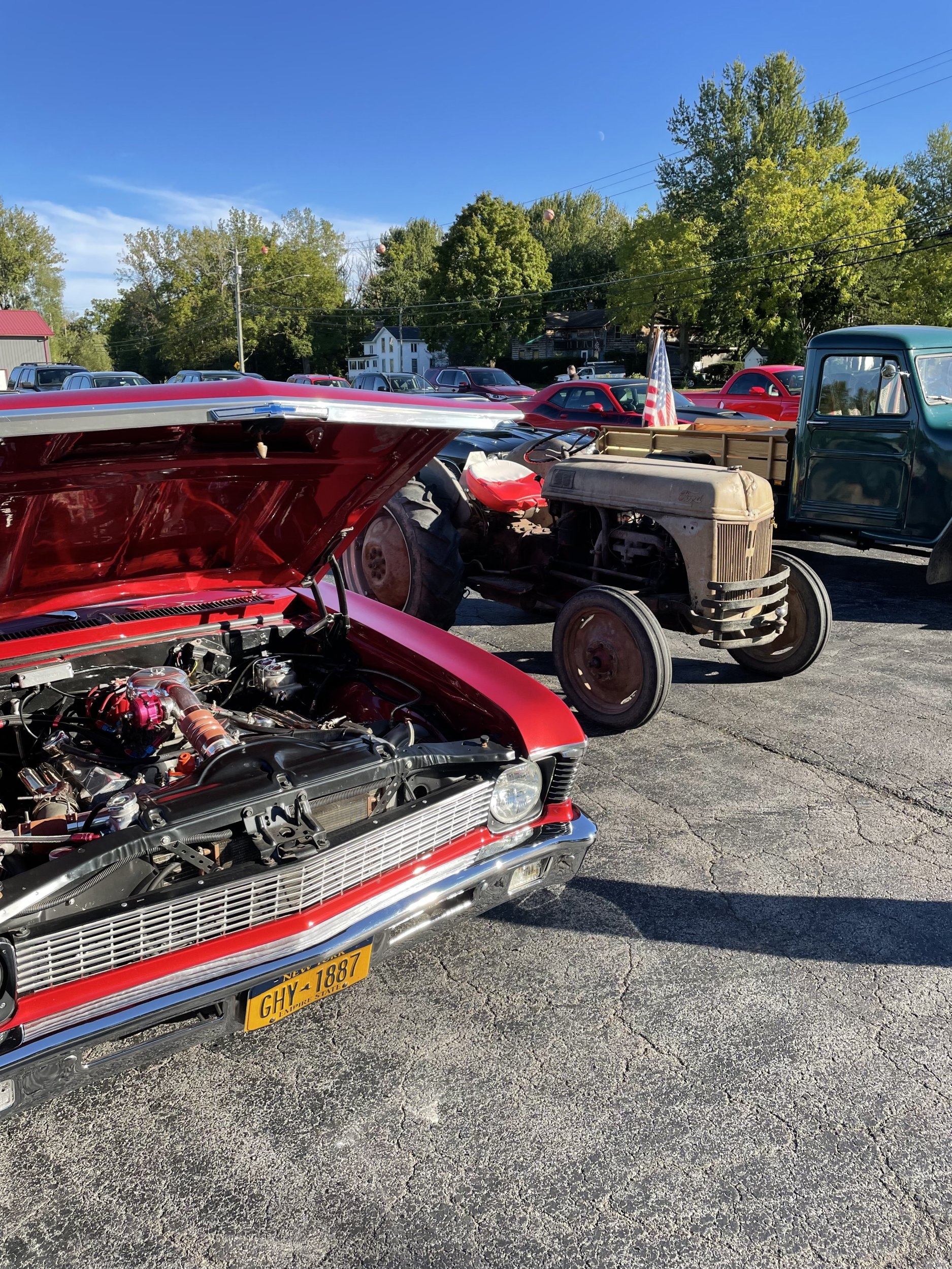

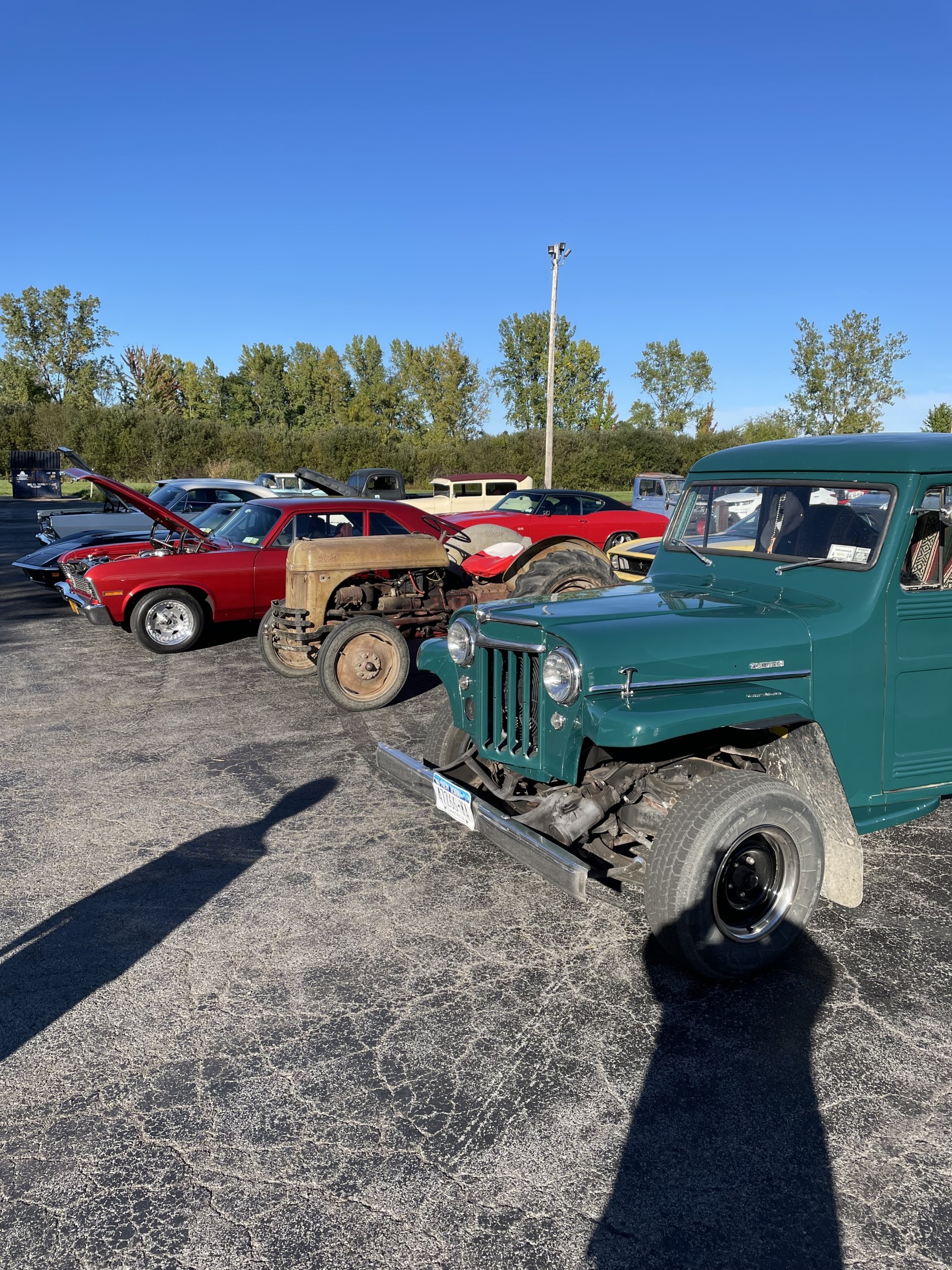

I definitely prefer to keep tractors in their original paint, if possible. That gets tough, because so many are left outside, and the sun is very punishing to paint jobs (and rubber).
My uncle, who was a collector of old cars and tractors, passed away a couple years ago. They had a little wake for him down at the fire hall. Lots of friends and family showed up with their classic cars.
I drove my 8n over there. It was the only machine that still had the factory paint and rubber. My late uncle’s Gran Torino was the star of that show.

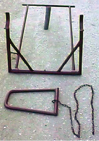

We had the Ford 8N 3 point accessory jack that lifted the whole back end to remove both rear wheels when changing to the cultivator spread
Probably a rare accessory to find nowadays

You can still find them. I just sold mine. If you had the front piece, you can lift all four wheels at one time.

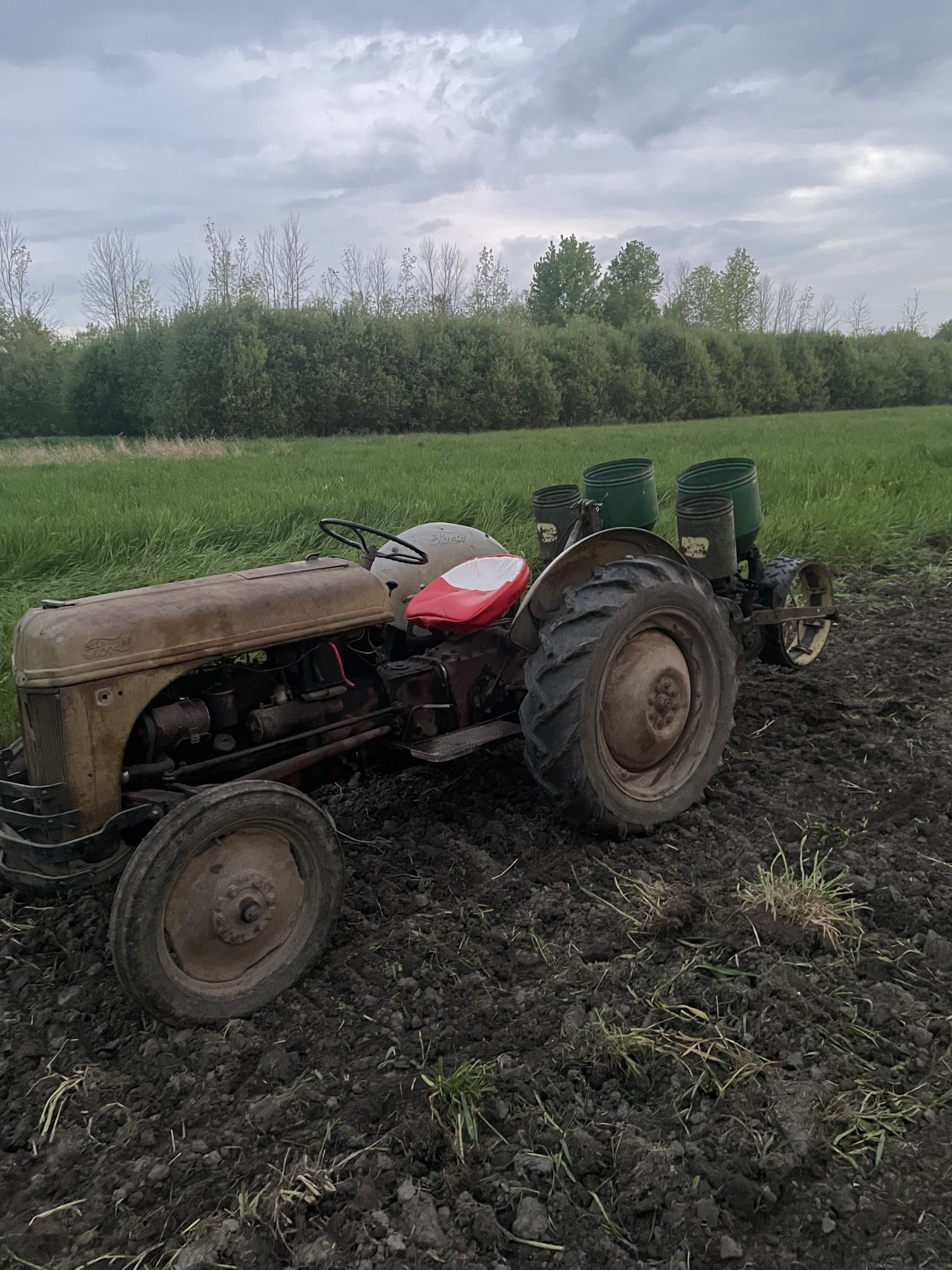

The old 8n sputtered a little while I was plowing this area but didn’t miss a beat on the planter yesterday. I suppose that prior roughness was a result of using up
The gas that was left in the tank from last year. It ran like new once the fresh gas got to it.
There is certainly no modern tractor that I would prefer over the 51 8n on that 2-row corn planter. The quiet running gas engine lets me easily hear any malfunction from the planter, and the low platform, easy on easy off from either side is a very nice feature when planting low quantities of sweetcorn.

My 1951 8n has been laid up for some time now with an electrical issue. The sputtering got worse as I was getting ready for my second corn planting in late May. I tried a new cheap aluminum carburetor on it but no go.
It seems to have very intermittent spark. My cousin thinks the problem is in the wiring harness. I’m thinking either that orctge cheap replacement coil I installed about (5) years ago.
I have a new harness for it and I think I’ll get another new coil from NAPA this time. I’ve heard they are better than the ones from TSC. I probably won’t have time to work on it until winter. As long as it’s ready for spring plowing next year, I’ll be happy.

I had problems with my '49 8N not wanting to start when it was hot. My buddy the mechanic went through everything electrical on it several times.
The cure? He made up a new coil wire from the resistor to the coil. That solved the problem.
