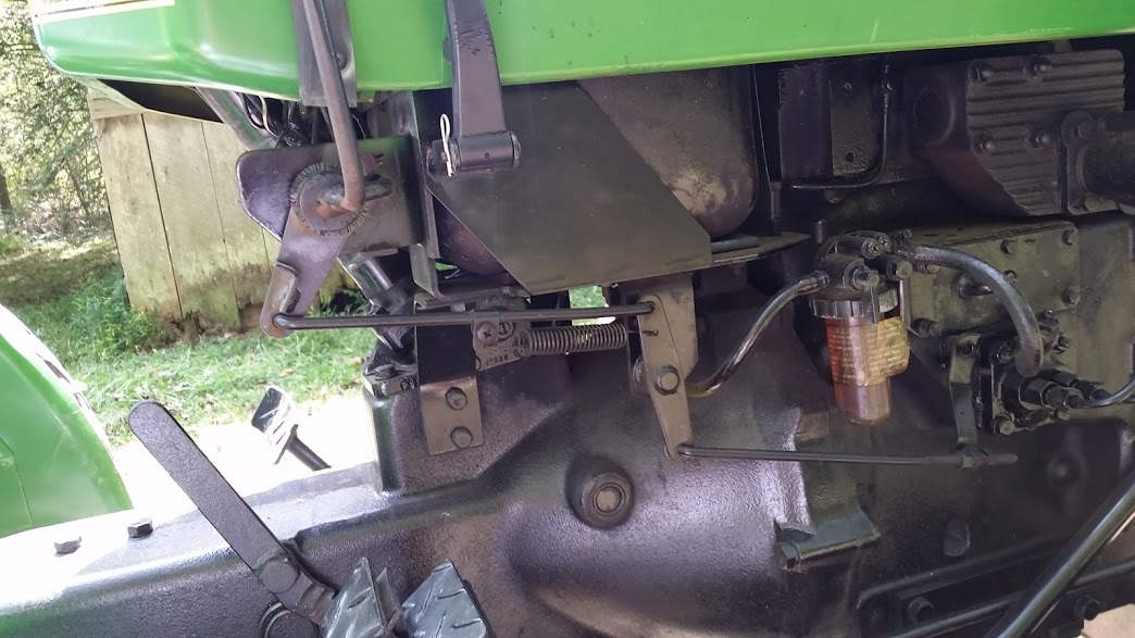

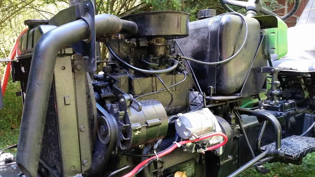

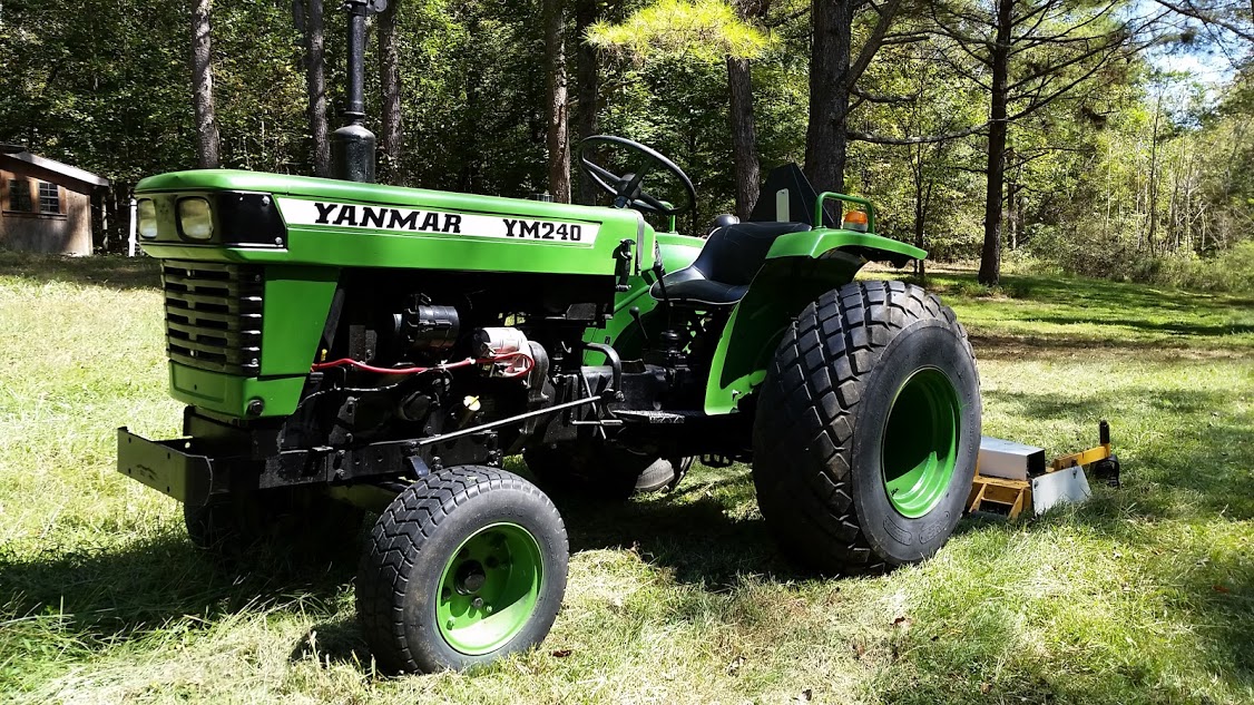

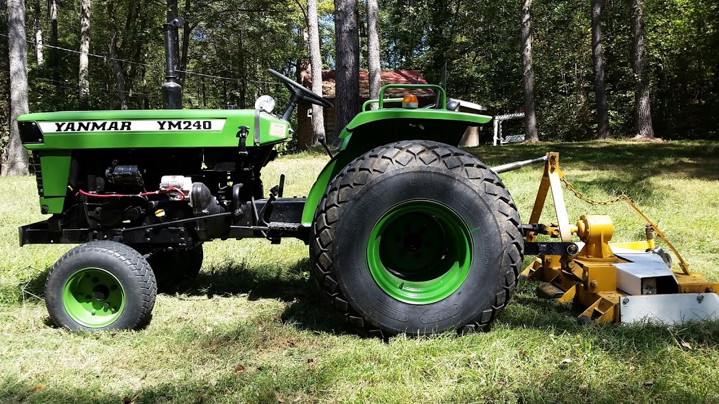

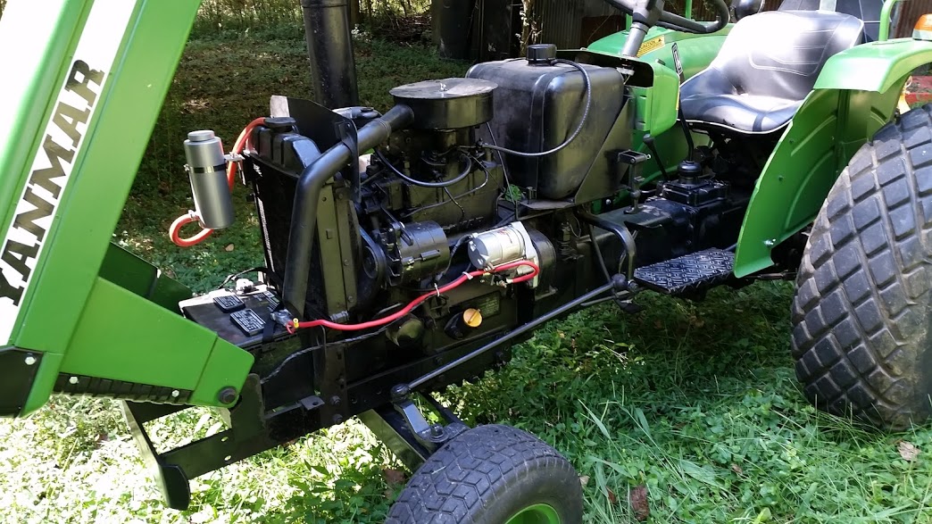

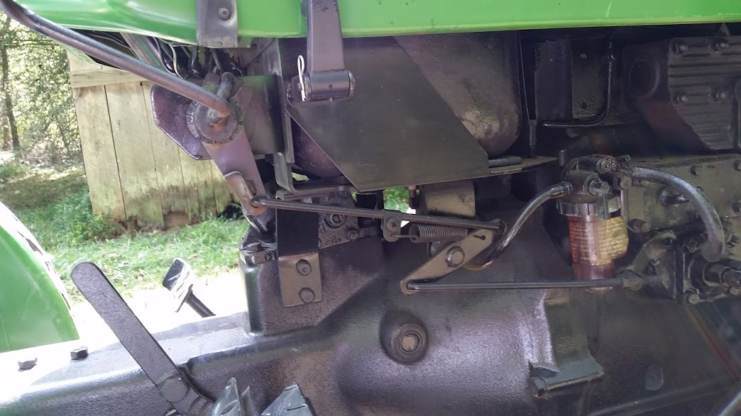

Hello all, I'm new to the forums and new to the world of tractors. I just completed my first purchase, a Yanmar YM240 that I found locally on Craigslist. The prior owner was an older farmer a few towns over, who used it mainly for mowing his 2 acre lawn at the house. Other than that, he just tinkered with it in the garage. I think that it's in pretty good shape, very clean, and you can tell he took care of his equipment. He was good enough to offer to deliver it to my cabin about an hour away, so that was the icing on the cake and made it too good of a deal to pass up.
I bought this with the following goals in mind: mowing my 1.5 acre lawn around the cabin, clearing out approx 2 acres of overgrown pasture, and finally putting in some food plots for next year's deer season. It came with a finish mower, so now I'm in the market for a roto tiller and maybe a brush mower (have a DR field and brush mower, so I can alternatively do some brush clearing by hand).

1) The throttle does not stay where set for more than a second or two, having the tendency to move downwards towards off. From reading around, I think this is a pretty common thing, but couldn't find a discussion of the problem for this particular tractor. Any tips on how to modify the linkage to get it to stick in place?

you need to either tighten the throttle shaft up and or need and new friction disk. You can buy it at Hoye but the shipping will probably be more than the disk. I think there like $1 each? This is a good chance to get new fuel and oil filters while your there.
