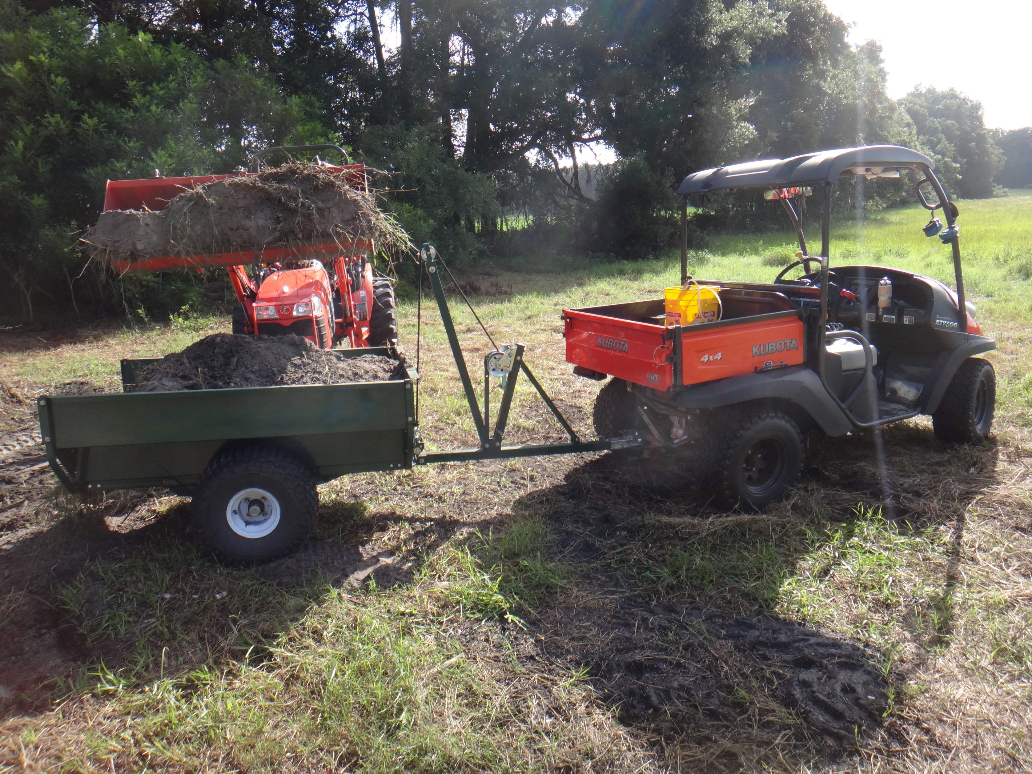

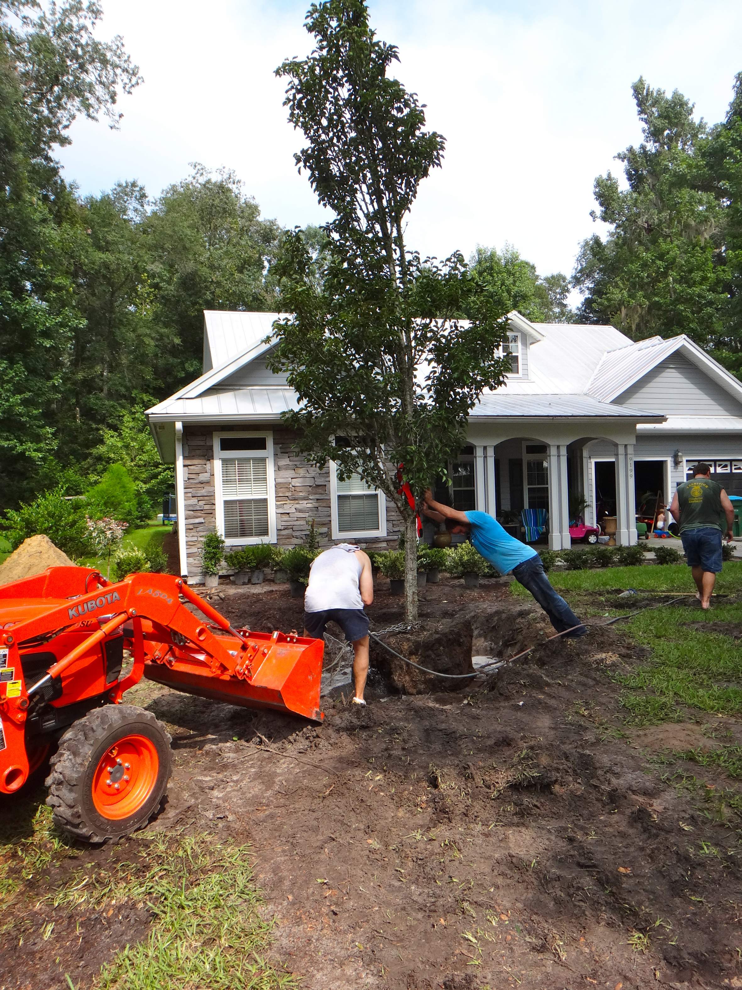

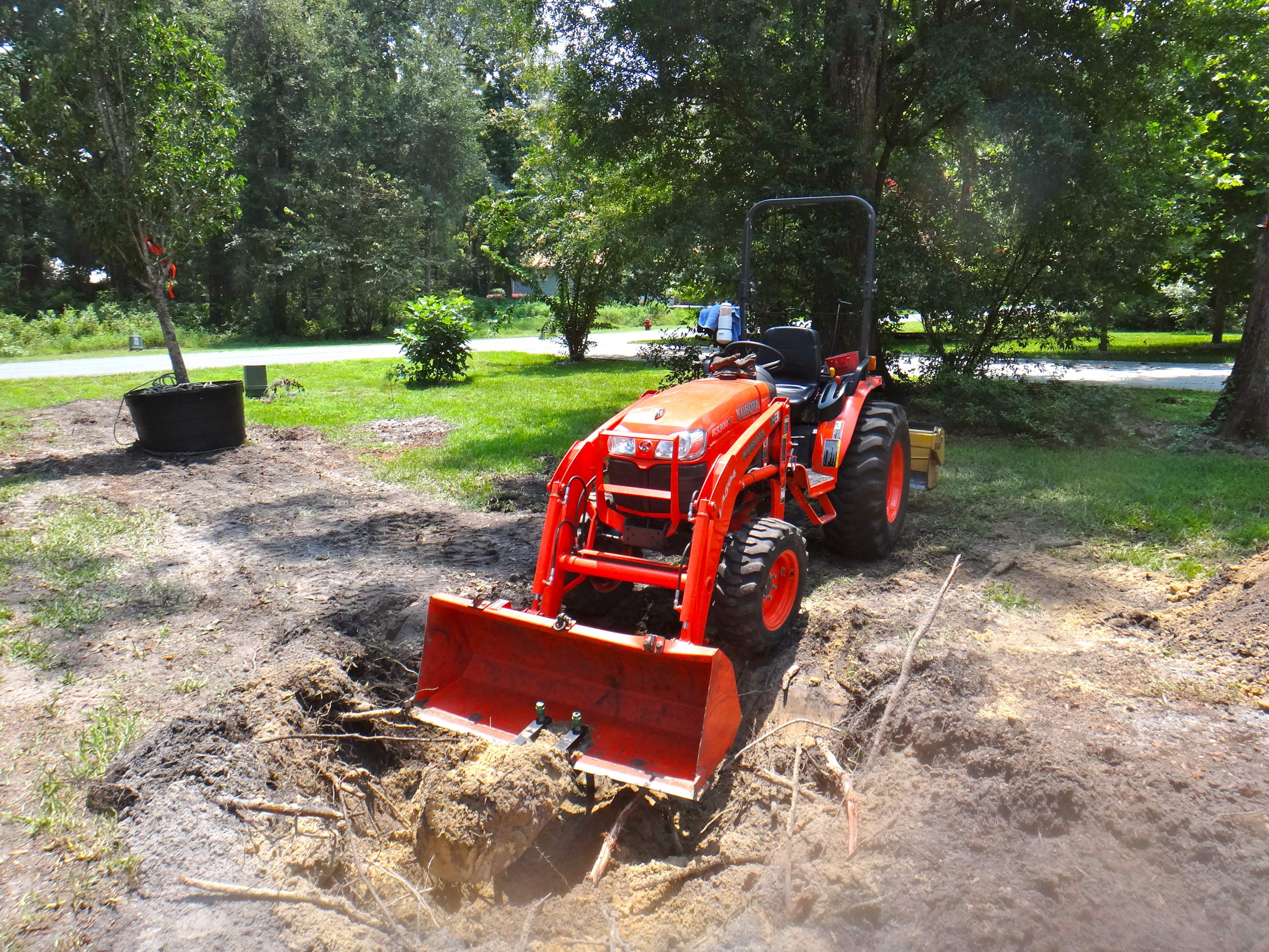

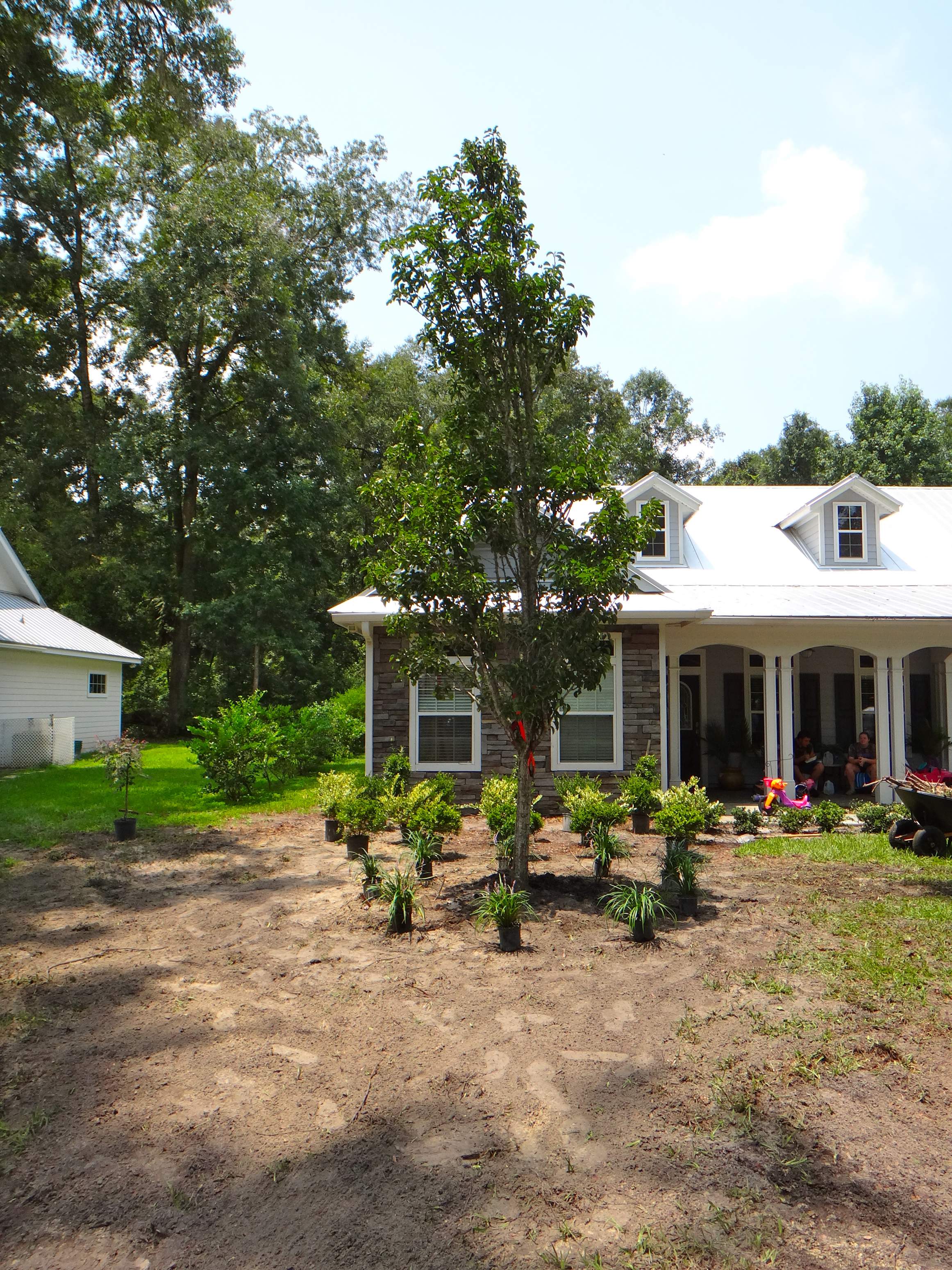

The only tasks I had in mind for a backhoe were digging a smallish pond and planting trees, shrubs, bamboo, etc. around the property over the next year or so. If it was just the pond I would rent, but I'm not sure what I would use to plant larger trees other than a backhoe, besides a shovel.
With a <$400 Bucket Spade attached to your FEL bucket you can dig holes 48" in diameter and 54" deep pretty quickly---------if the FEL and tractor are heavy enough. (Don't use ambiguous words like "larger" give the size/weight/dimension.)
You can rent an excavator for the pond or, you can dig a pond slowly with a Tooth Bar attached to the FEL-------if the FEL and tractor are heavy enough and if you have a truck or trailer to haul the spoil.
A backhoe is fine if you use it frequently. Most tractor owners do not; some do. Sitting in storage does backhoe hydraulics and pin lubrication no good.
Take your backhoe money and invest it in a larger, more capable, tractor/loader.
