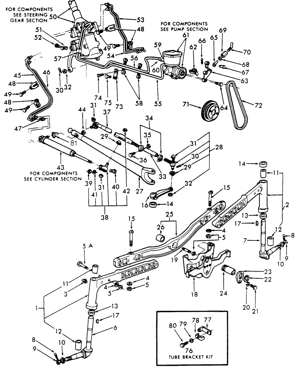

here are some pics of some of my fords.. they have a similar engine and setup as an 821.. first 3 are the genny on the left side.
next pic is where the PS pump SHOULD be, again.. pic is of my 950.. but it's the same engine.. etc.
last pic is a diagram found at the site where rick linked to.. it shows the ps pump diagram on the right side of the engine... etc.

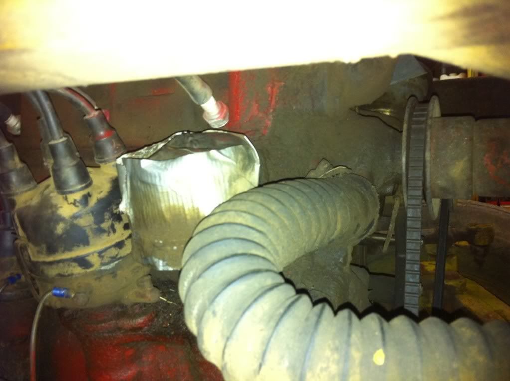

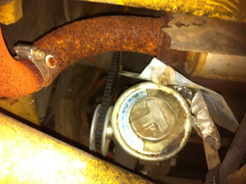

heres some pics of both sides of the engine, the pump is on the top left of the engine,

show yer top hose connection at the engine.. see if there is an ear.
too funny.. has the ps pump mounted in place of the genny...
strange what people will cobble together... :)

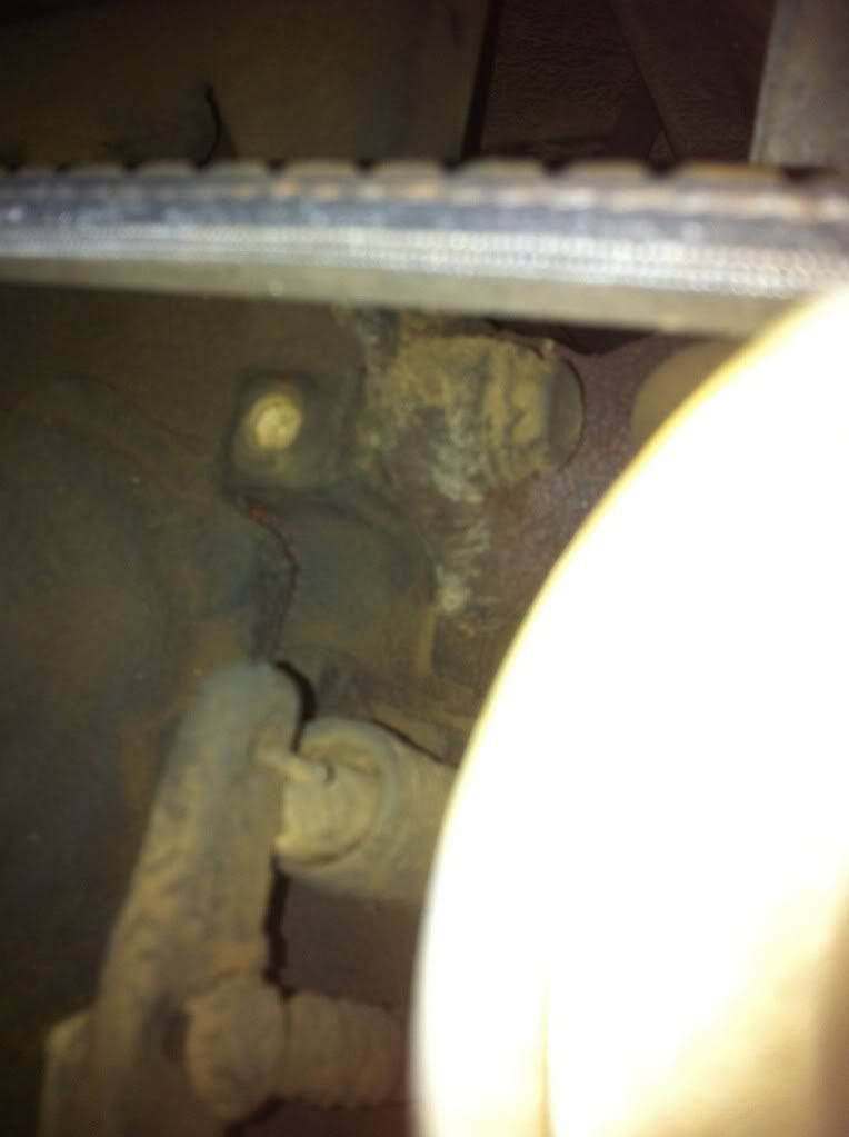

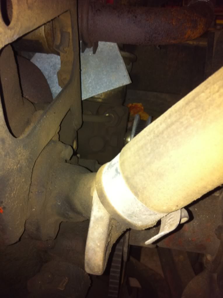

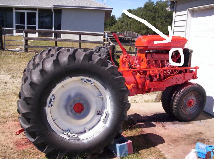

LOL, Yes it is cobbled together, the wiring someone used wire nuts for a house electrical for all the key switch wiring, The electrical is the first thing I am gonna do then start on the engine, here are some more pics, its very hard to get into to it due to the front loader frame covering everything up, Im hoping I can take that off when I start on the eng work, and I think it needs more weight on the front, the front tires will come off the ground if you let the clutch out to fast, lol but any help is greatly appreciated, I am a railroad diesel mechanic and new to tractors, so if I put a alternator where the PS pump is where will the Pump go are there a bracket kit for the right side of the engine?

yep.. yer top hose connection has the ear for mounting the power steering pump...on the RIGHT side.. :)
