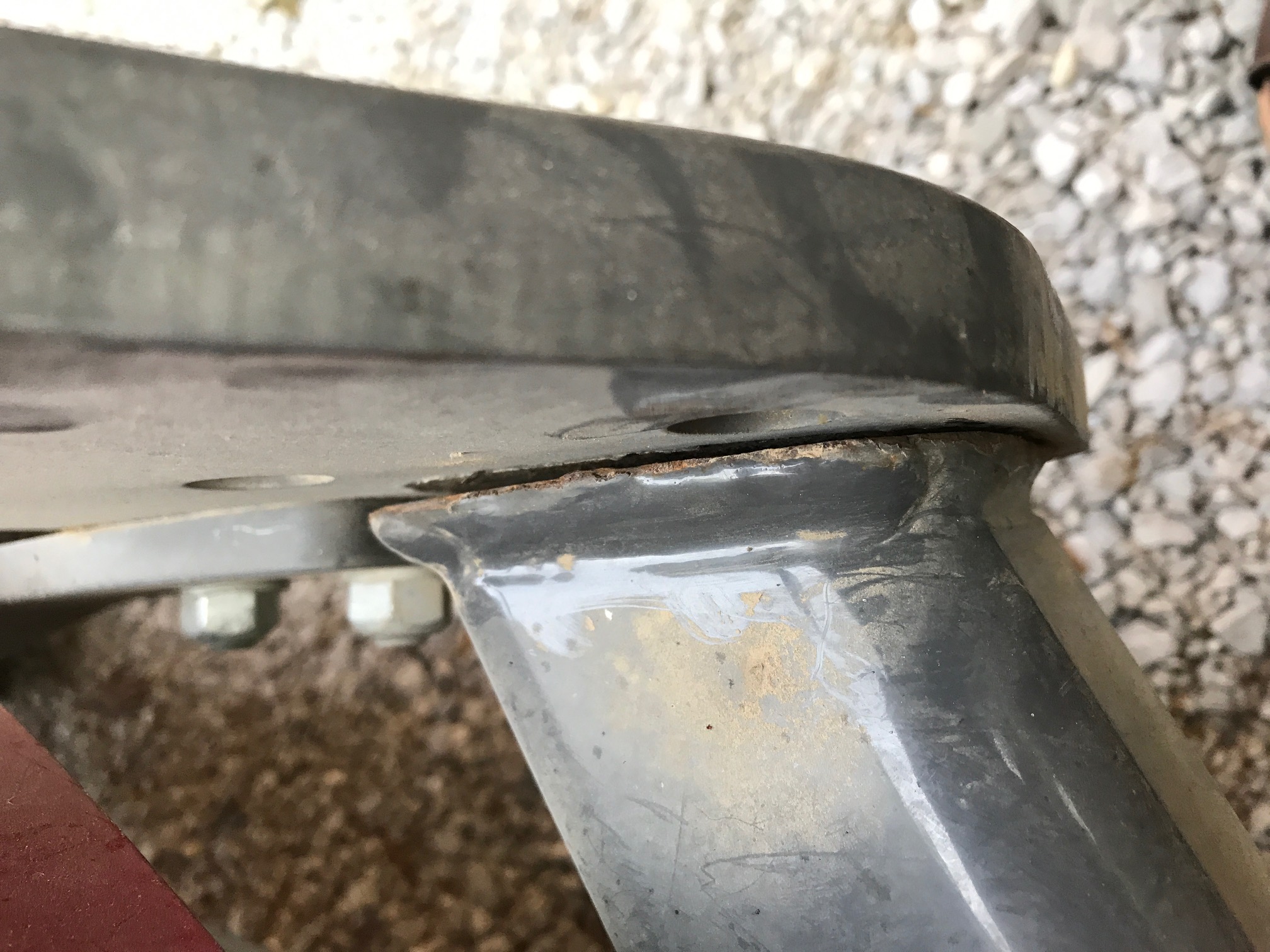

And, to the weld in question, I'm NOT a welder, but, I say that what can be seen of that particular weld; it failed miserably. Why? It seems to have not fused with the loader support piece from which it is clearly detached, not torn or jagged or split in any way, from what is evident in the one pic.
This much I do know about welds; done properly they fuse two surfaces together by melting them and then bonding while cooling. To break a good weld it would take tearing the weld apart and destruction of one or both pieces of metal that were fused together when the weld took place. None of what I described is evident in the picture.
Bad weld, result of material or workmanship failure or a combination of each. OP should be given a new loader or at a minimum a new support piece for the side that failed. Last, but not least fix might be a reweld of existing structure, IF that is specified in the manufacturer's warranty remedies section.
Best practice by the manufacturer/dealer would be to attempt to make the OP happy/whole and replace the entire loader frame/structure.

I say: it is one of the most obvious poor welds any of us will ever see on a major manufacturer's tractor. Very clearly from the picture the weld DID NOT melt the metal on one side of the weld. An obvious manufacturing defect if there ever was one. "Shear tear" of a weld is a strange invention grasping at straws. There is no plausibility argument how you get clean shear in this situation. Call it what it is -- a very bad defective weld.
JWR, if the picture Stlmatt posted is a stellar example of a manufacturing defect "if there ever was one" - "a very bad and defective weld"; then how do you explain it didn't fail in the first few hours of use? Lets just look at your logical path:
1. the failure is in a spot of high stress and leverage issues.
2. we know from Stlmatt's prior posts of 2 years ago and now - that he works his tractor heavily. Its primary uses are not for lightweight activities like pulling a cart or cutting the lawn.
3. So if that picture proves its merely a horrible and obvious example of a very poor weld that never got metal to puddle (if there ever was such an obvious example) - and its in a high stress location - such a blatant example as you claim it is - should have failed in the first couple hours of heavy use.
4. But it did not fail then. In fact this "obvious example of a defect "if there ever was one" - didn't fail in the first 20 hours of heavy use - or 40 hours of heavy use - or 100 or 150 or even after 200 hours of heavy use.
So logic isn't supporting that the weld never puddled or puddled very little. In that particular location - all the leverage of the fel and its payloads and impacts is focused on that weld location and the matching one on the other side of the tractor. Merely raising the fel one or two times would have exceeded stress loads if the weld was so faulty as you indicate. In effect - you're describing a weld that would have been inferior to a simple "tack weld". So logic would dictate some other considerations. Here are a few:
A. The photo is not showing the true weld damage.
B. Or the Metallurgical composition and alloys of the components was not correct.
C. Or some damage occurred to the tractor in a collision or roll over or ???? (I'm not saying this happened)
D. Or a "shear tear" created a force not planned for in engineering the pieces - that caused all the stress to be focused on one specific point or spot and not dispersed across the surrounding pieces. Examples are acid or salt oxidation or rust or a laser cut or mis-alignment of pieces or very large sudden temperature changes (dry ice type effects or a fire) or torque settings not correct in combination with mis-alignment or bolts fall out or shear off and the fel arm starts to collapse very quickly.
My point in my prior post was that a terrible weld in a key location with a lack of any puddling could cause such a straight line crack with no visible metal ripping - but that to do that after 230+ hours of heavy use is not a reasonable assumption of certainty. And a stress tear is not an "invention grasping at straws". You see them in bridges and cranes and earthquakes etc. etc.. My point all along is that STLmatt's problems seem far more likely to have begun when someone improperly assembled and installed/prep setup all the parts at the dealer's location. And from that simple but important activity - it caused numerous problems to develop in this specific tractor.
Again for logic - many of us have GC1700 units and have and are operating them successfully and without similar issue to Stlmatt's unit.
And while Stlmatt may work his tractor in a more contractor type activity - its a tractor and not a flimsy toy.
And while Stlmatt rapidly developed many hours of use - its not exceptional to many others.
In summary - I don't think this is a "Buyer Beware" situation for GC1700's - and hopefully for Stlmatt - if the dealer prep/setup person was at fault - at least Massey is a class act and is getting it fixed so Stlmatt doesn't have to go after the dealer about it. I personally know of someone with a brand new LS, another with a Kubota, and a third with a Deere who all spent too much time over more than a year each for catastrophic type failures/problems caused by dealer service issues. In two of the three cases - they bought Massey units and are happy as can be.

I know this is an old thread and maybe better to let sleeping dogs lie, but the subframe with the defective weld on your tractor has a made in China label on it on my GC1720. I thought the GC1720 was mostly all made in Japan and the US and probably would not have bought the tractor had I known how much of it was made in China. So far no problems with mine but I've only had it a couple of weeks.

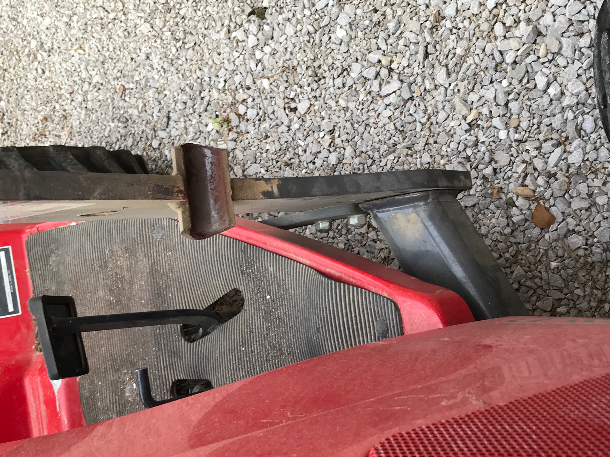

Now the latest major issue. I was using the loader to mover some dirt when I heard a loud POP and the tractor almost tipped over, I had a decent amount of weight in the bucket (but it was NOT overloaded or even close to Max weight) the weld from the LH loader support (the part that mounts to the frame of the tractor) broke and the loader tilted causing the tractor to feel unstable....I dropped the bucket ASAP when it happened and I think that's what saved me.
You can see in the picture that its a faulty Weld, it was really one welded in one small spot, 95% of the weld was never really welded.
I couldn't believe my eyes when I looked at it......WHAT a crappy job! So time to load up and make another 2.5 hours round trip to the dealer........when I got there he agreed and was like what the ****!!!!! that's horrible, said I should have it back in a week, they are also going to replace the throttle cable, order the correct bolt for the three point arm pin as well as service the machine.
That's was on 5-23-17, I called today and they are still waiting on warranty approval for the broken weld.......when I asked why is it taking so long, I was told here is the number to AGCO call them myself.....so I did, and I'm still waiting on a return call.
Interesting, the prior versions of this model were of Japanese construction. Is it just the loader frame fabricated in China? In any case, QC falls on Massey/Agco to assure buyers. I wonder how many other major manufacturers sub out China fabrication.
