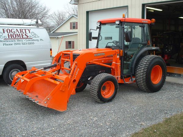

#53

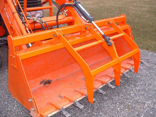

Finale)
Ladies & Gentleman, please direct your attention to the center isle. New for this spring, in matching Kubota orange and gray, we have my grapple. (pic 19)
PS> For your safety, please wear shaded glasses /forums/images/graemlins/shocked.gif /forums/images/graemlins/wink.gif

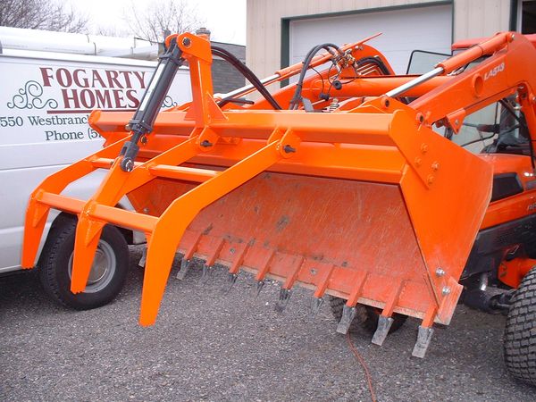

#54

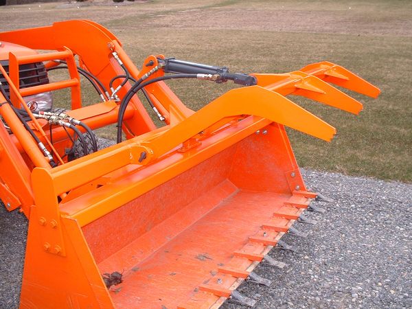

Finale
another
   / My Grapple Project (part 1)
#55
Finale
Open wide /forums/images/graemlins/laugh.gif

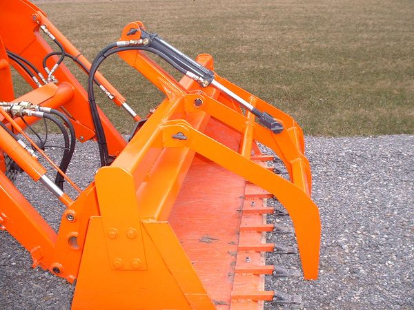

#56
Finale
Say aah /forums/images/graemlins/grin.gif

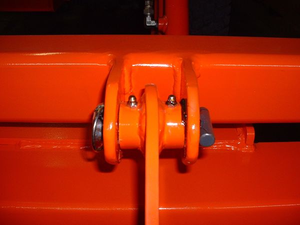

Finale
Here’s a pic of the grease fittings installed.

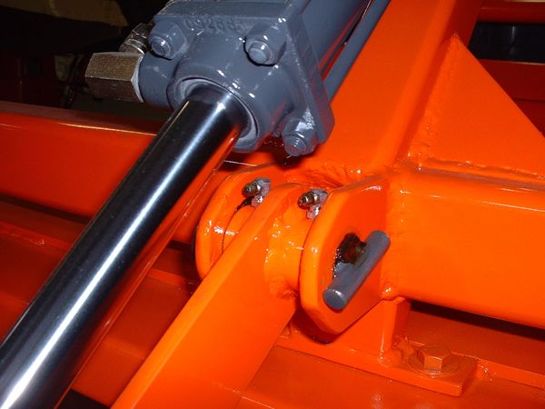

#58
Finale,
Another grease pic, center arm.

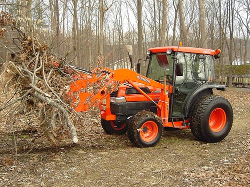

#59
All in all, I’m very pleased with my grapple project. I’m guessing that it added 150 lbs. + or – to the weight of the bucket. It can be removed in less that 1 minute by unhooking the hydraulic hoses and pulling 5 pins. The 3” square rail remains on the bucket and does not interfere with anything. After operating the grapple, I made one small modification; I increased the hole in the restrictor to 1/16” to allow the grapple to cycle a little faster. It now opens in 2 seconds. (pic 23)
Bill
#60
I have a few action shots, but nothing fantastic. It is still very wet where I want to use the grapple and it just isn’t worth making more of a mess than I have to. It will dry off by July. Thanks for looking at my posts and remember to make your seat time, safe seat time.
