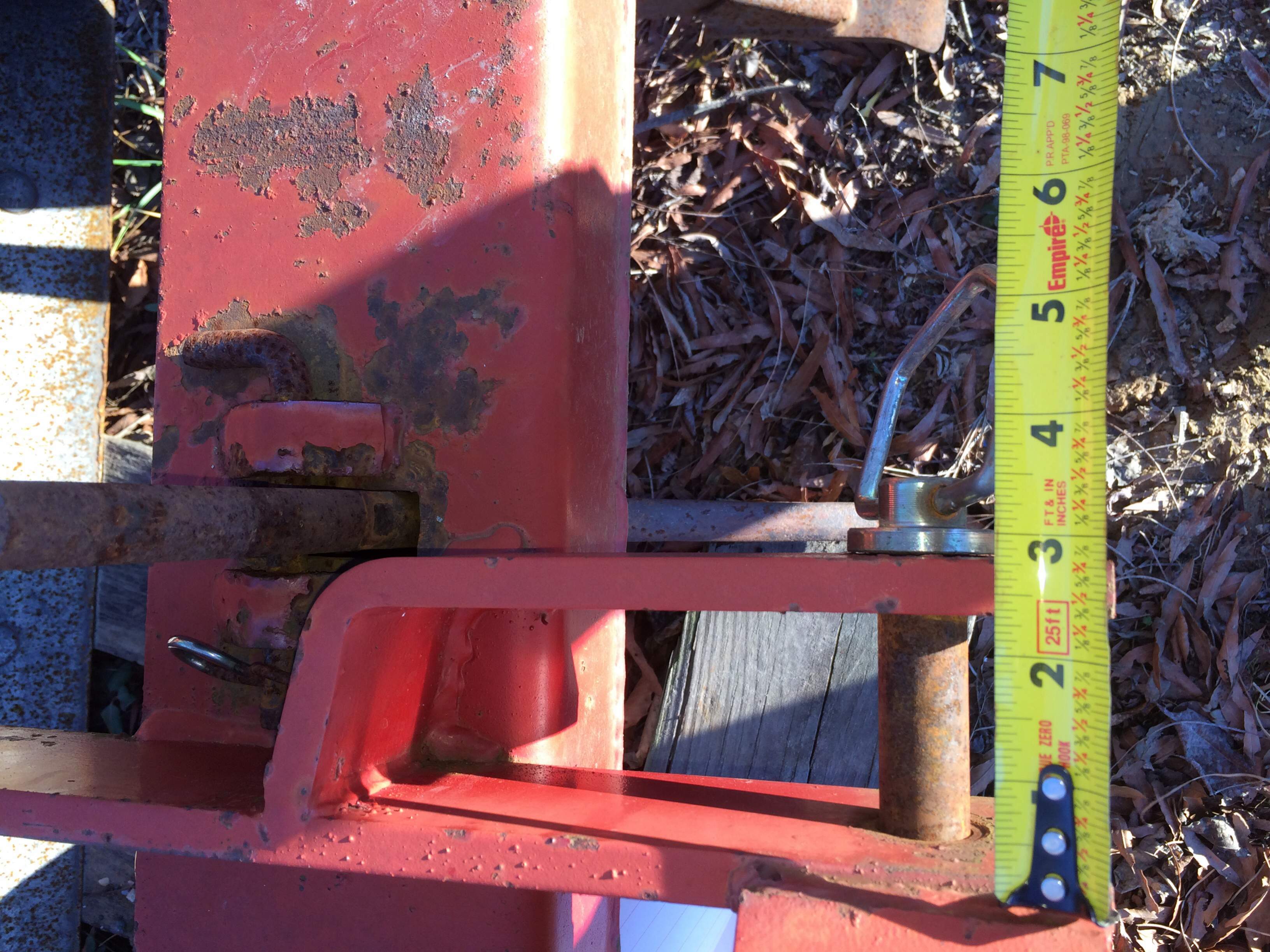

I received mine on Thursday and had it installed in about an hour. I had to made some adjustment to the top hook so it would fit my box blade. Had to hook it to the cross bolt as there was insufficient clearance to use the normal pin that was used for the top connection. I have not tried it with my cutter yet to see if my PTO shaft is long enough. While the hitch is "quicker" to use, I still find that I need to get off and set the bottom hooks open, hitch to the implement and then set the lower hooks closed. I guess I could do it from the seat, but I am new to this and am trying to work safely. My tractor is a Mahindra 28. As an aside, I received a catalog from AGRI Supply of Friday and to my dismay I found what appears to be the exact same quick hitch for $89.95 and the adapter sleeves for $9.99, so you are interested in a quick hitch you might want to check them out.

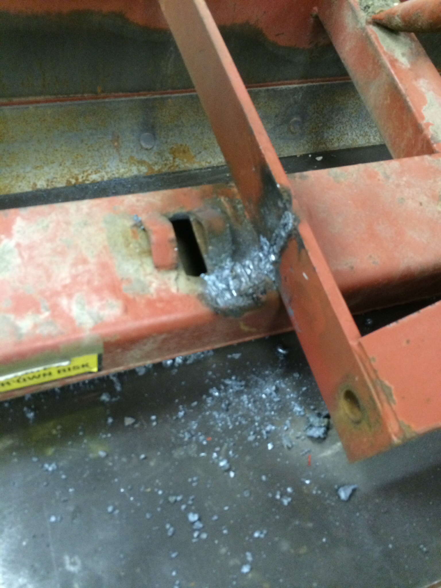

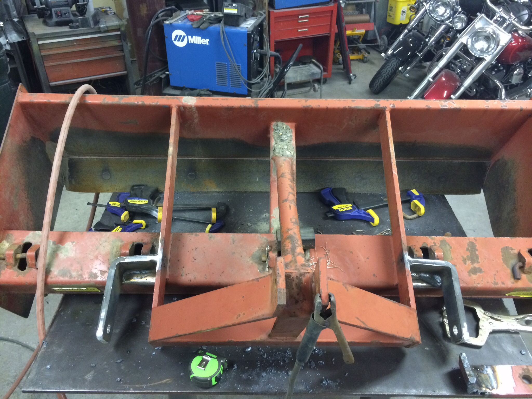

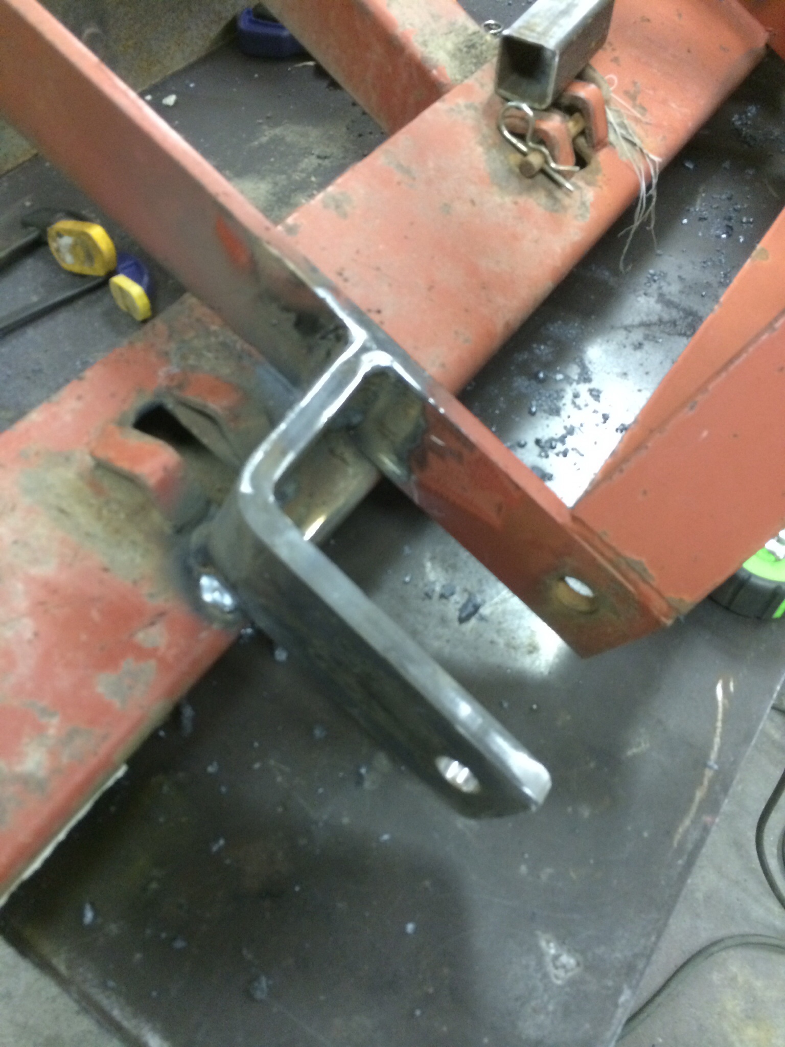

Had to do a little a modification to my box blade to work with my Harbor Freight QH. I wish I had the skills to do it all by myself, a buddy ended up helping me out by fabbing these up.

Looks like that should do the job.
