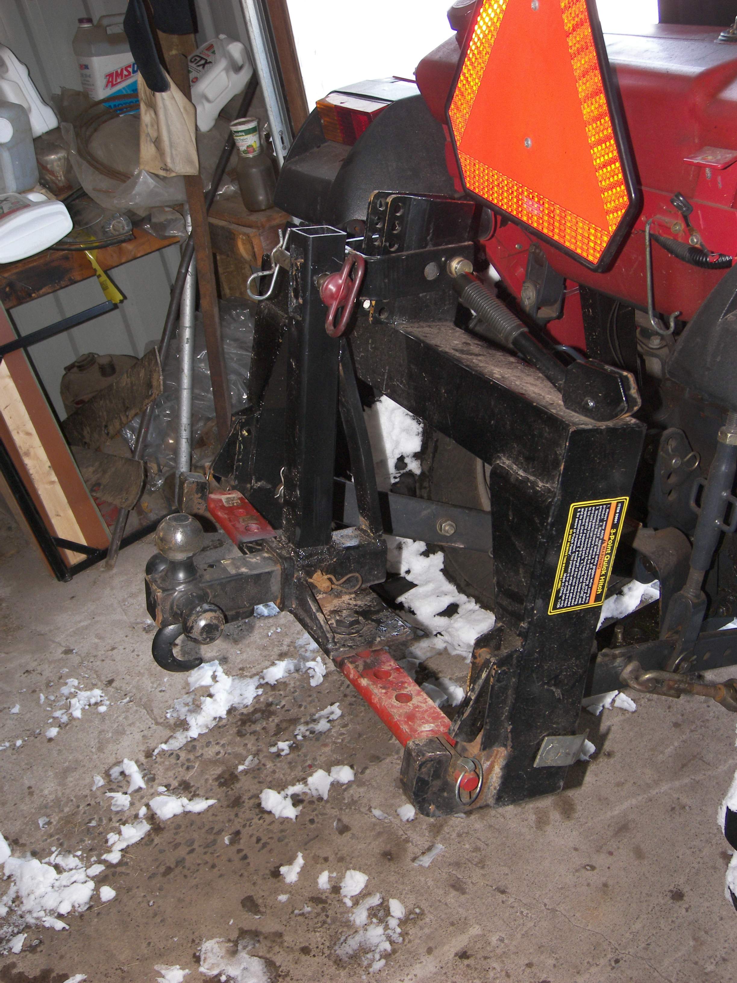

I bought a HF quick hitch several years ago and discovered the lower hooks were Cat ll size instead of Cat l. I just use Cat l to Cat ll bushings to take up the slack.

Heres a picture of my Harbor freight Quick Hitch with my trailor balls attached. Its used mostly to move wood with my dump trailor. . . .John
I just noticed this post and your photo. I like your trailer hitch add-on! I'll have to cobble one together myself.
