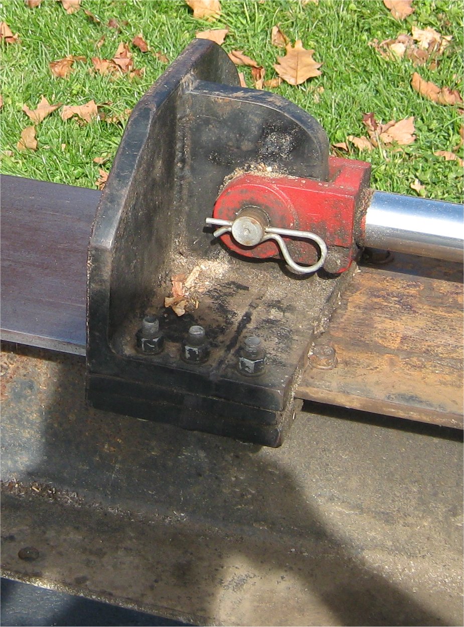

Thallman, you are going to have to extend the length of the push plate slide, the bottom of the push plate should be as long as it is high, if you look at the one we built we only have 6 bolts, 3 on each side. The bottom slide is only 1/2 inch material, this goes in almost all the way to the web on the Ibeam.
the other thing we do is to have a slight downward angle on the cylinder toward the push plate.
We also box in the ends of the Ibeam, this adds lot of strength to it and helps to keep the top plate from twisting. Looks like you are going to have to damage that nice paint job..... Jim

here's a better pic of the push plate, this unit has 646 hrs on it.

I would do as Jim said (;the other thing we do is to have a slight downward angle on the cylinder toward the push plate.;) and make sure the leading edge of the plate running on the I beam isn't sharp. Lee

Thallman, you are going to have to extend the length of the push plate slide, the bottom of the push plate should be as long as it is high..... Jim
Thanks Jim, this confirmed to me what I was thinking. I used some really thick material when building this push plate (1"+) --it's heavier than my tractor :D -- I think though you are right about it being as long as it is high. I really like how tall it is. I'm hoping I can get some left over scrap metal to fit under the cylinder and then weld on some gussets to fix my problem. I'll post pictures of the results.
For now it still splitts everything I throw at it fine, but I hate "splitting on eggs shells" and having to watch every step I make --though maybe that will help my keep all my extremities.

other thing we do is to have a slight downward angle on the cylinder toward the push plate....Lee
Unfortuently, if Jims idea doesn't work I'll have to do this. For all intensive purposed horizontal "should" be the best. A downward angle would cause the same undesirable force as the upward slope but in a less harmful action.
Also, the work desired to change the angle would be horrific. I'm not sure how I would go about doing that because if you look at the hitch end of the splitter, I have the mount welded (triple passed), bolted, and the hitch build around it. It's not going anywhere!! The pusher end could be lowered but the widining the hole slightly (through 1 1/2" metal) would be very difficult I'm sure!
Let's hope lengthening the push plate does the job!
