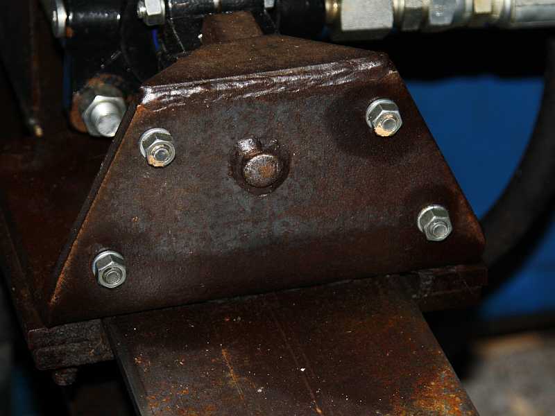

Thanks for the compliments. The push-plate problem was solved by making the surface of the push plate which touches the I-beam longer than the part that pushes the wood. I started out with the cylinder a hare from perfectly horizontal (pushing downwards just a smidge) which, in theory, should keep the splitter from binding. Instead of extending the bottom portion I simply flipped mine around now using the pushing part of the plate as the base and the base now, the pusher. I'll post pictures soon so those of you here can compare the before and after.

QUICK UPDATE:
I re-constructed the push plate as shown in the photos below. The photo's show and the "rough" looking version. I didn't want to grind and paint it to perfection until I've run this new design more. I worked with it tonight and it works so far (knock on wood) like a charm :D

I have a suggestion for ya. My pusher was smooth like yours except for 1 bump in the middle and I had a problem with wood that wasn't cut quite square trying to slide off the pusher. One popped out and almost caught me in the family jewels. I solved that problem by putting a few bolts in the perimeter of the push plate. Those nuts (pun intended) sink into the rounds quite nicely and stop any lateral movement.

I have a suggestion for ya.... putting a few bolts in the perimeter of the push plate. Those nuts (pun intended) sink into the rounds quite nicely and stop any lateral movement.
Ian
attachment.php
Thanks Ian, that was actually going to be my next step if needed. I already have holes there from the previous set-up that would work quite nicely.
