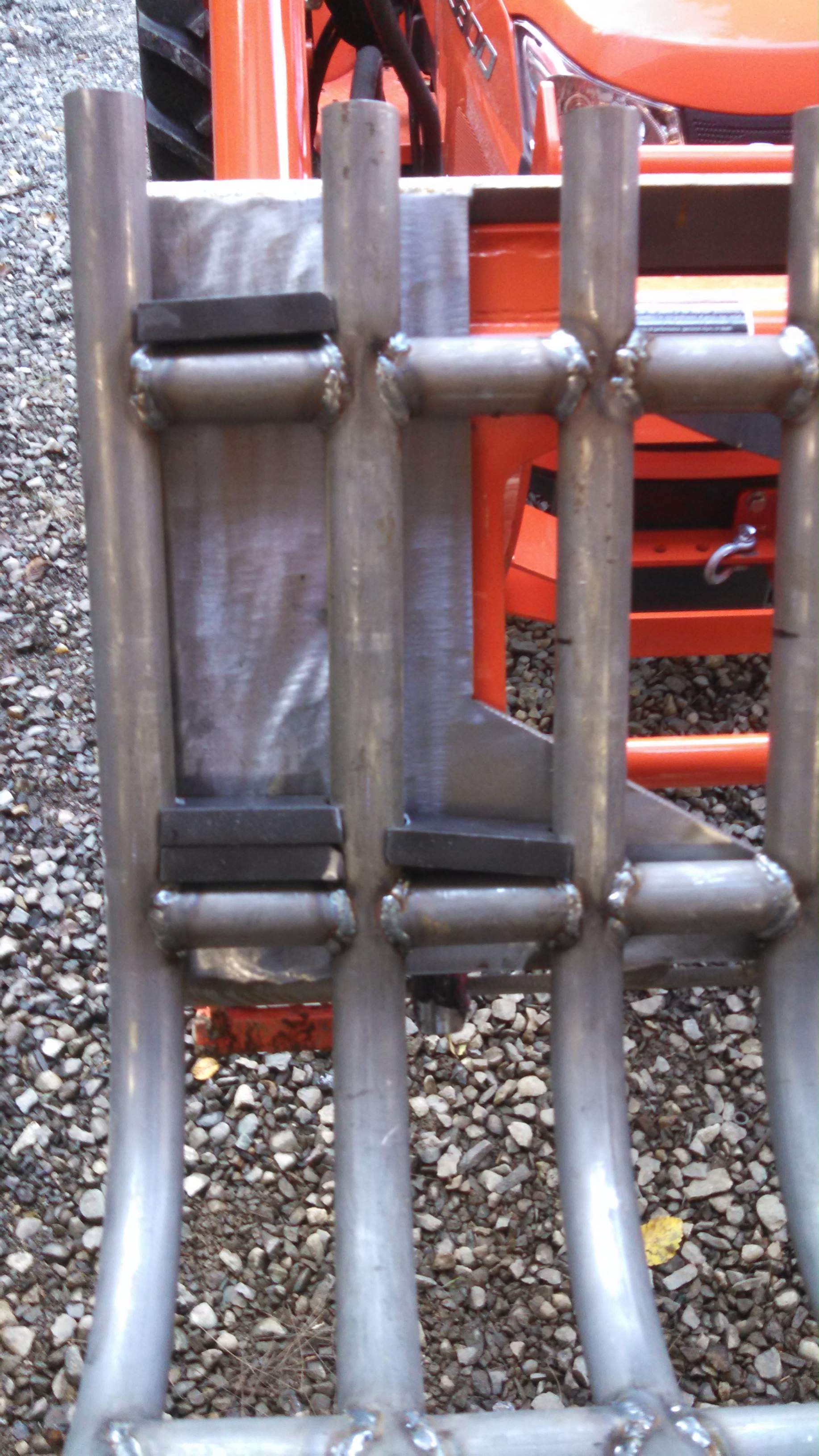

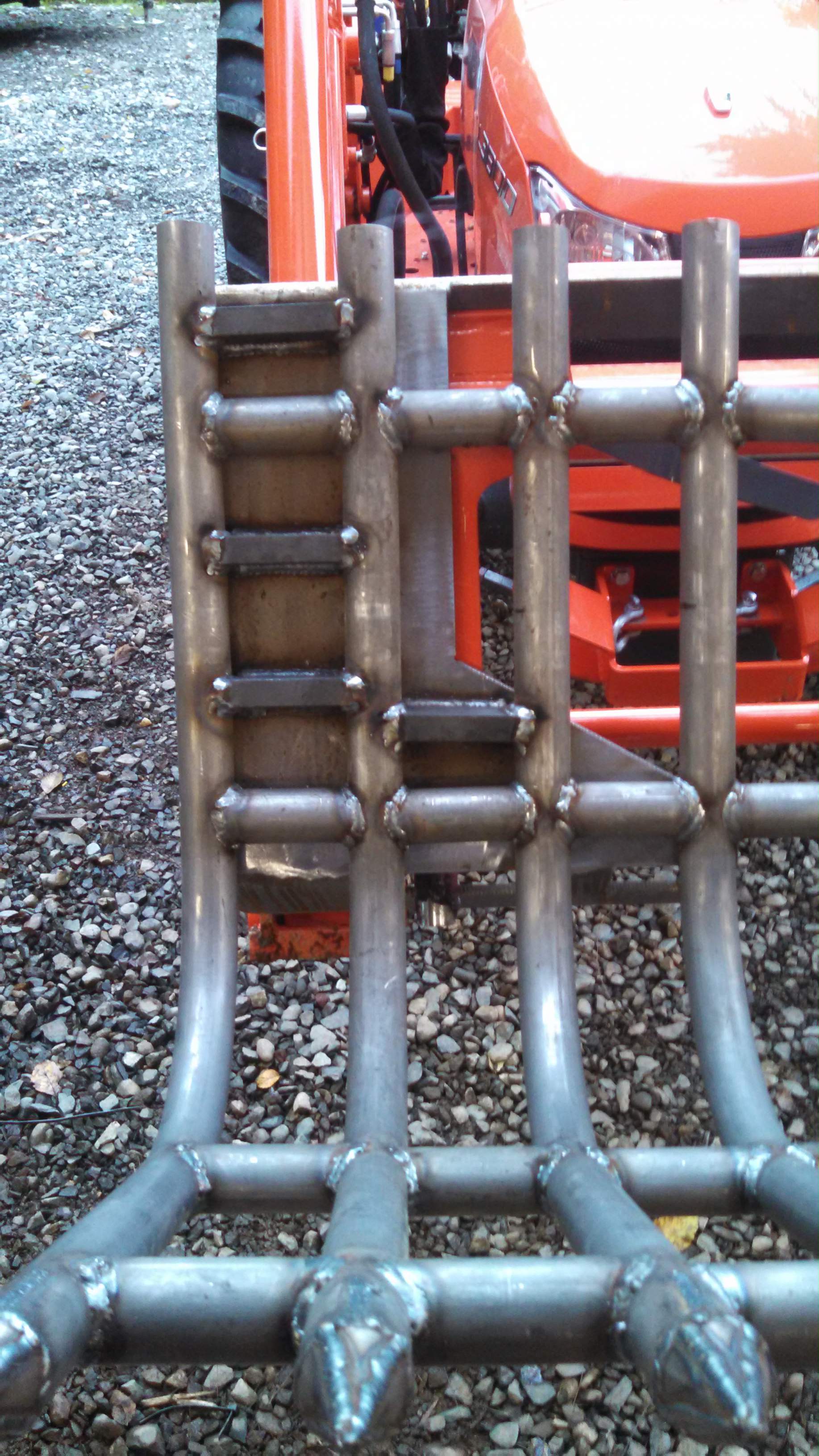

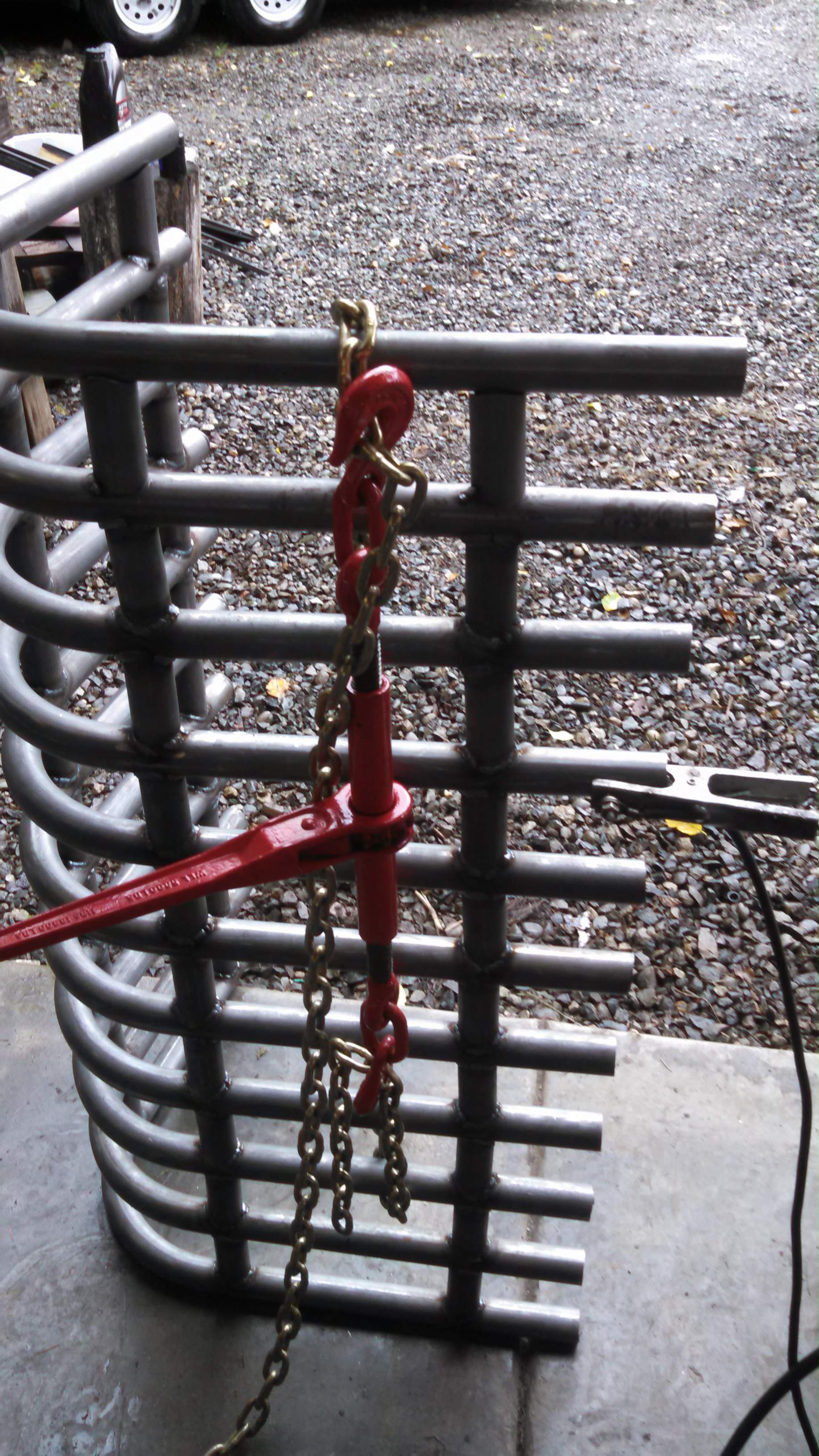

I got some things done today until I ran out of weld wire. I got lazy towards the end. Should have stopped and came back to it a few days later buy I pushed on.. so it's not as square as it could have been but close enough considering I didn't use any jigs and its gonna get abused to **** anyways.

Still need to finish weld in some spots. Build the sides, and id like to add a lip to the front to keep the larger rocks from kicking back out the front edge. Which I have an idea for.

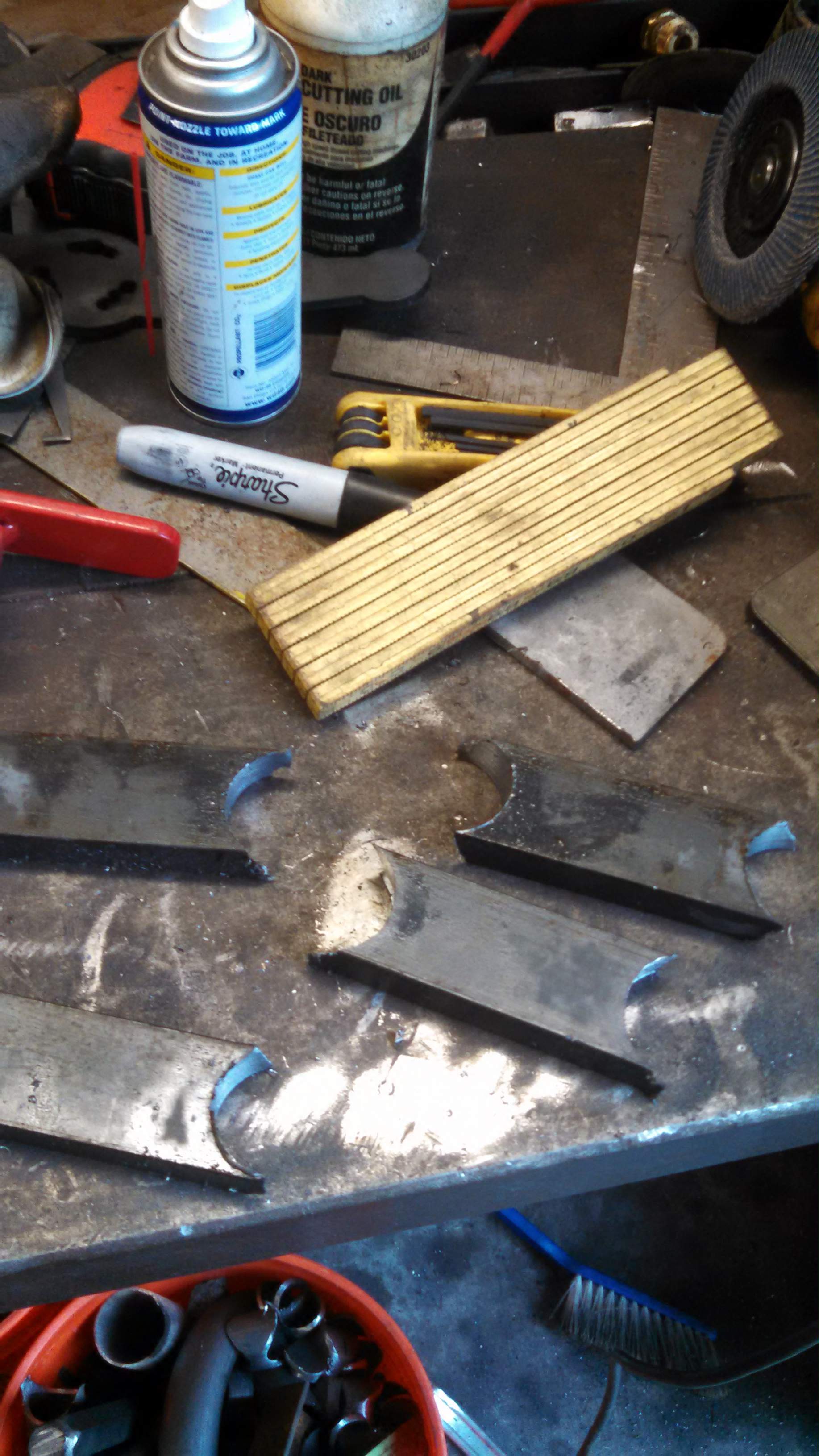

Nice... keep going. Maybe I missed it but how did you cut your tube for the perpendicular joins?
   / my home-made rock bucket
#18
I think they are referring to square tube notched on its edge. Like in a diamond shape <> ;)
