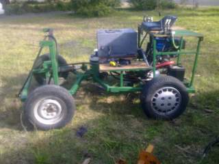

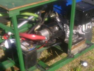

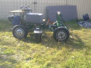

Over the weekend i started her up with the new pump and engine and low and behold it worked. Although it didn't steer i later found that the valve i used for steering didn't work so i connected the steering ram to my drive valve (two spool) it it worked although a little fast. Then the drive motor slipped on the drive coupling that was fixed by filing a key way in it.Then when i when to test it again it just wouldn't work i opened the tank and the oil was just froth so i am going to add a tube to the bottom of the tank and more oil. thanks guy pics up soon.

These pictures are smaller and hard to see any details. When you get the bugs ironed out I would like to know what kind of speed you get. Thanks
