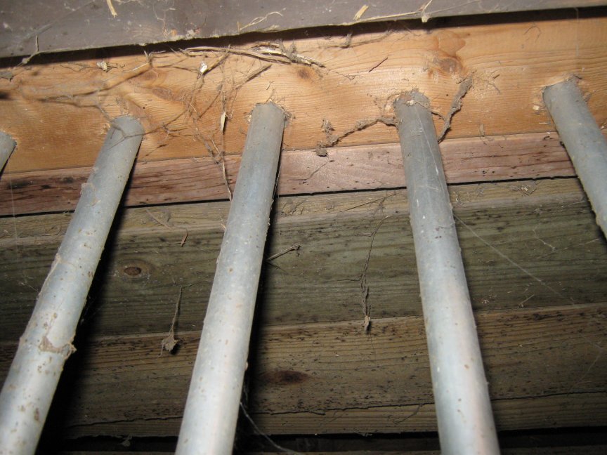

Looks really good. What are you going to use above the T&G on the stall fronts? Prefab fronts?
I haven't decided for sure yet (meaning that my wife hasn't actually decided for sure yet ;)), but I'm leaning toward the same approach that SteelDust used for his horse barn (See some pics on this page: http://www.tractorbynet.com/forums/projects/110718-want-see-yet-another-pole-17.html). He used 3/4" metal conduit for the bars. Much cheaper than prefab stall fronts or black iron pipe.
Yeah I know my barn does not look as good as a new one but it did 20 some years ago when I built it. I have to tell you the EMT conduit works well and has served me with many years of maintenance free use. As you can see I can remove mine at will although I have never needed to replace any, the removal of the bars is handy.
On more thing, Gizmo: If you're using 3/4" conduit, then it looks from the picture like you have it spaced at 3" on center. Is that right? I was thinking of going at 3.5", but yours look just about right. Are you happy with that spacing?
I do not know off hand what the spacing is but I will check and let you know. But...Spacing has a lot to do with the size of your horse's hooves. By that I mean, a horse with their foot caught between the bars is also not a pretty happening (thus my removable bars). The thought that, no way a foot can go between the bars is a bad thought, the bars will give to some degree, then try and get the foot out. I do know the bar spacing between the stalls I had to make pretty small as it was ok originally for the full grown horses but with the foals it was a completely different ball game. The stall dividers seem to be more critical as the horses are always trying to get to one another. If I had it to do over again I would do as you did, solid partitions. Yeah I know I can shut up now. I'm always learning and I am enjoying you barn project, looks sooooo nice.
