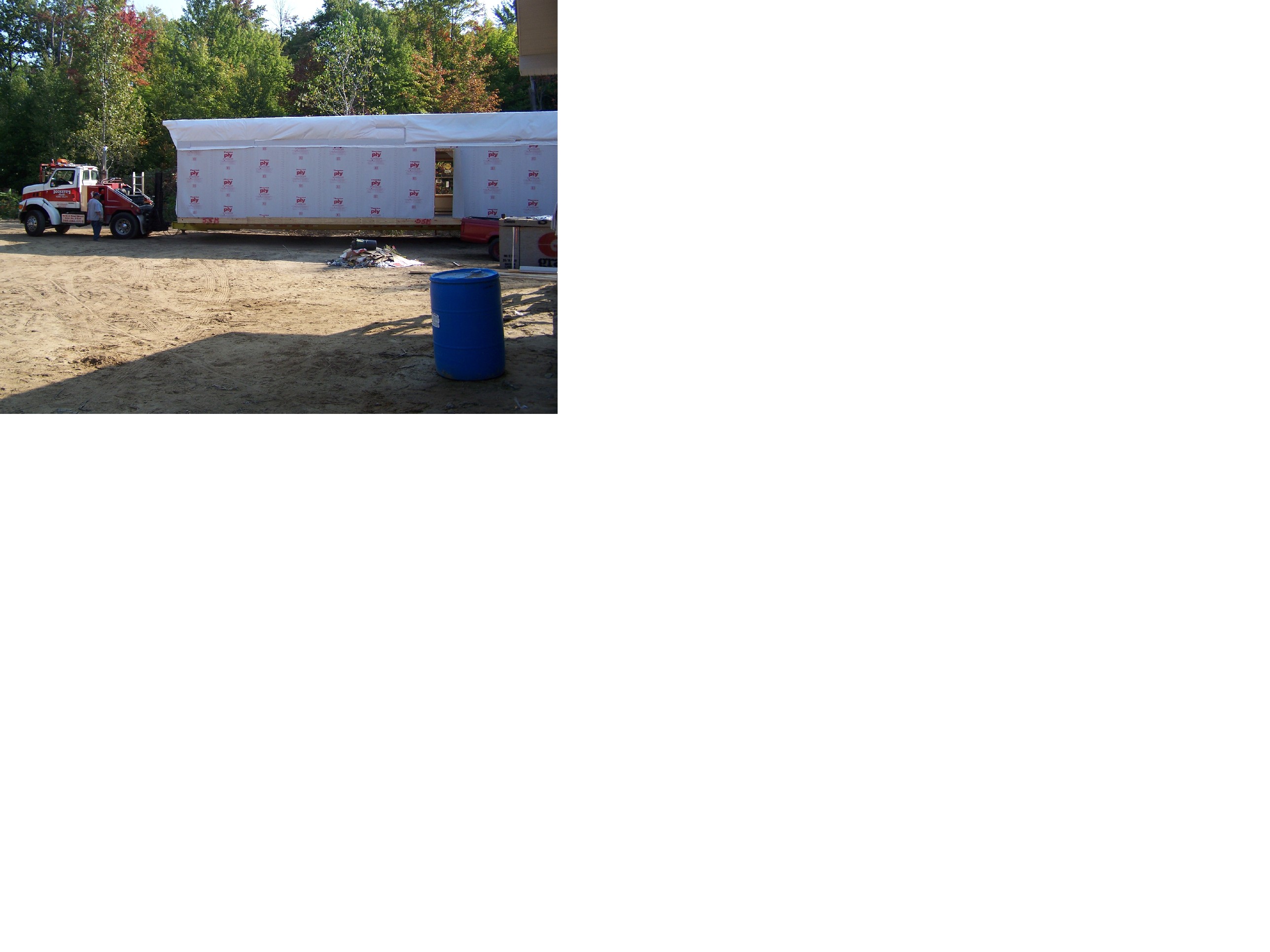

Here is one half of the house when it arrived in late Sept

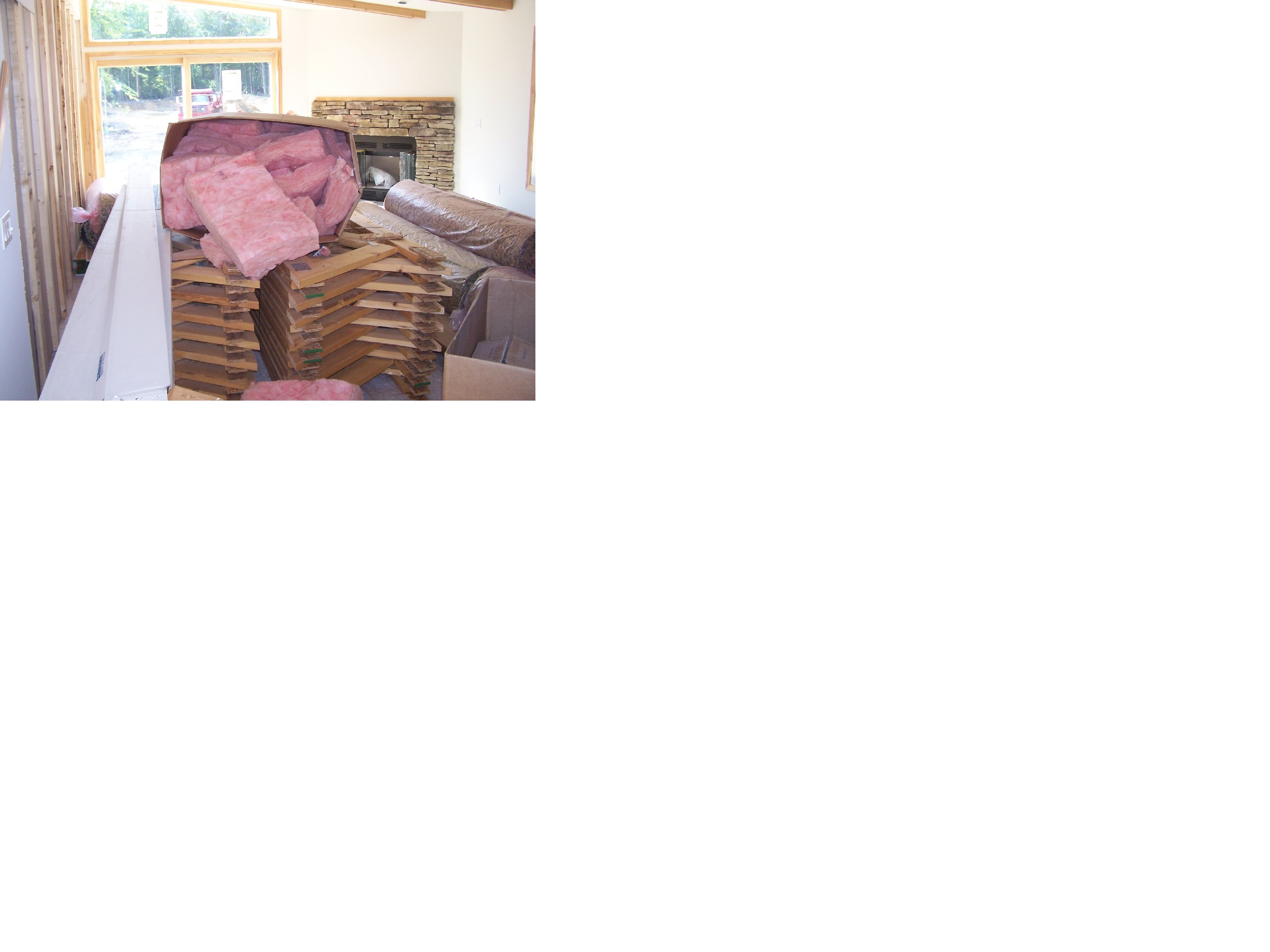

Here is a pic of the living room, you can see how they shipped the carpet, padding, and parts of the roof trusses inside the house

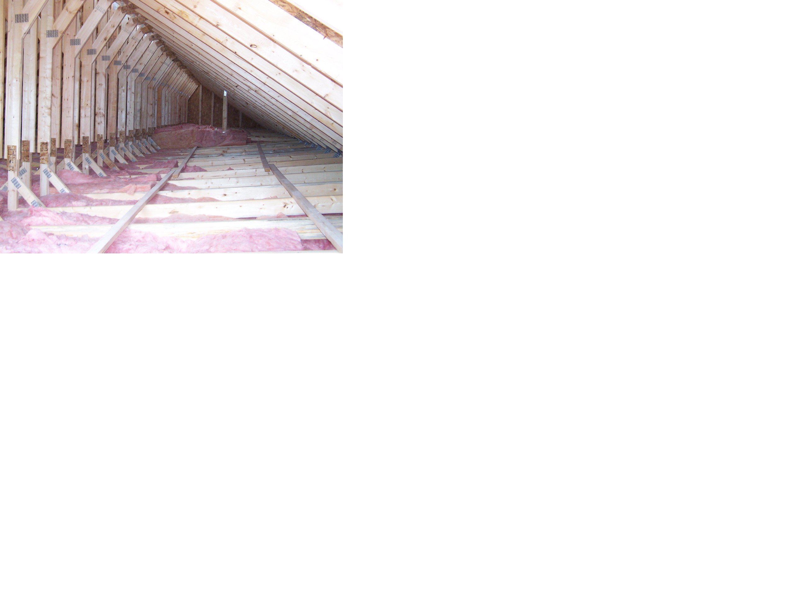

This is the assembled roof truss, there is tons of room up here but I am not sure what I am going to do with it yet. I wish I had gotten a good pic of the R-48 ceiling insulation, it was a solid 2 ft thick.100_1764 small.jpg

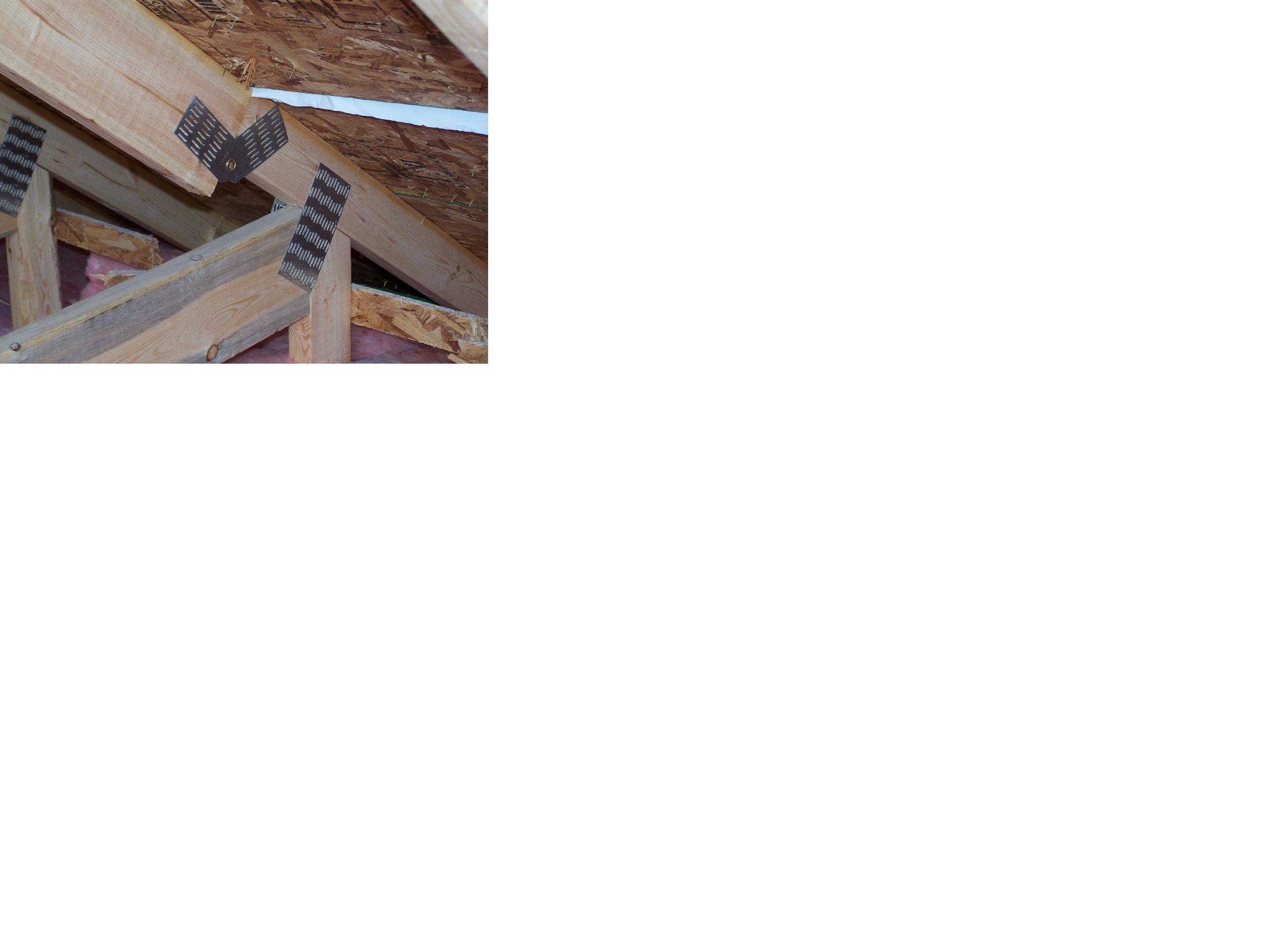

Here is the hinge on the truss to make the home setup much faster100_1766 small.jpg

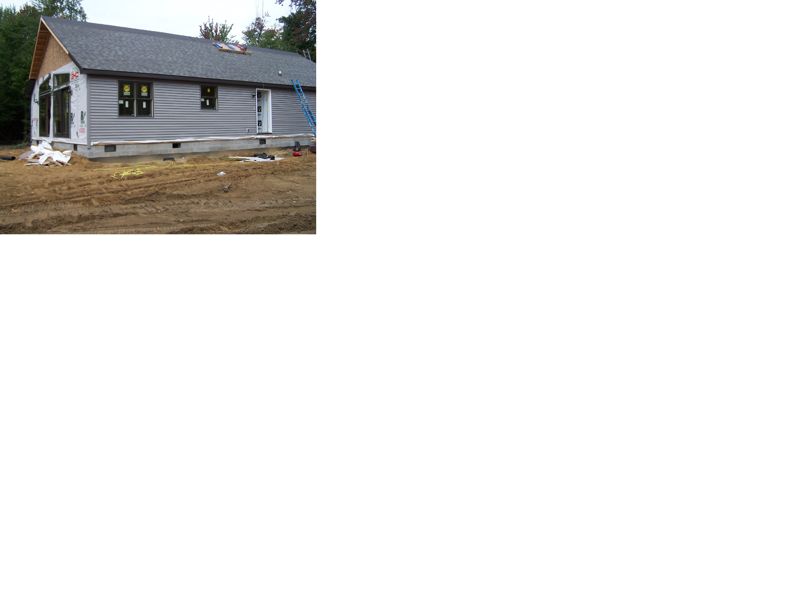

Here is the completed roof

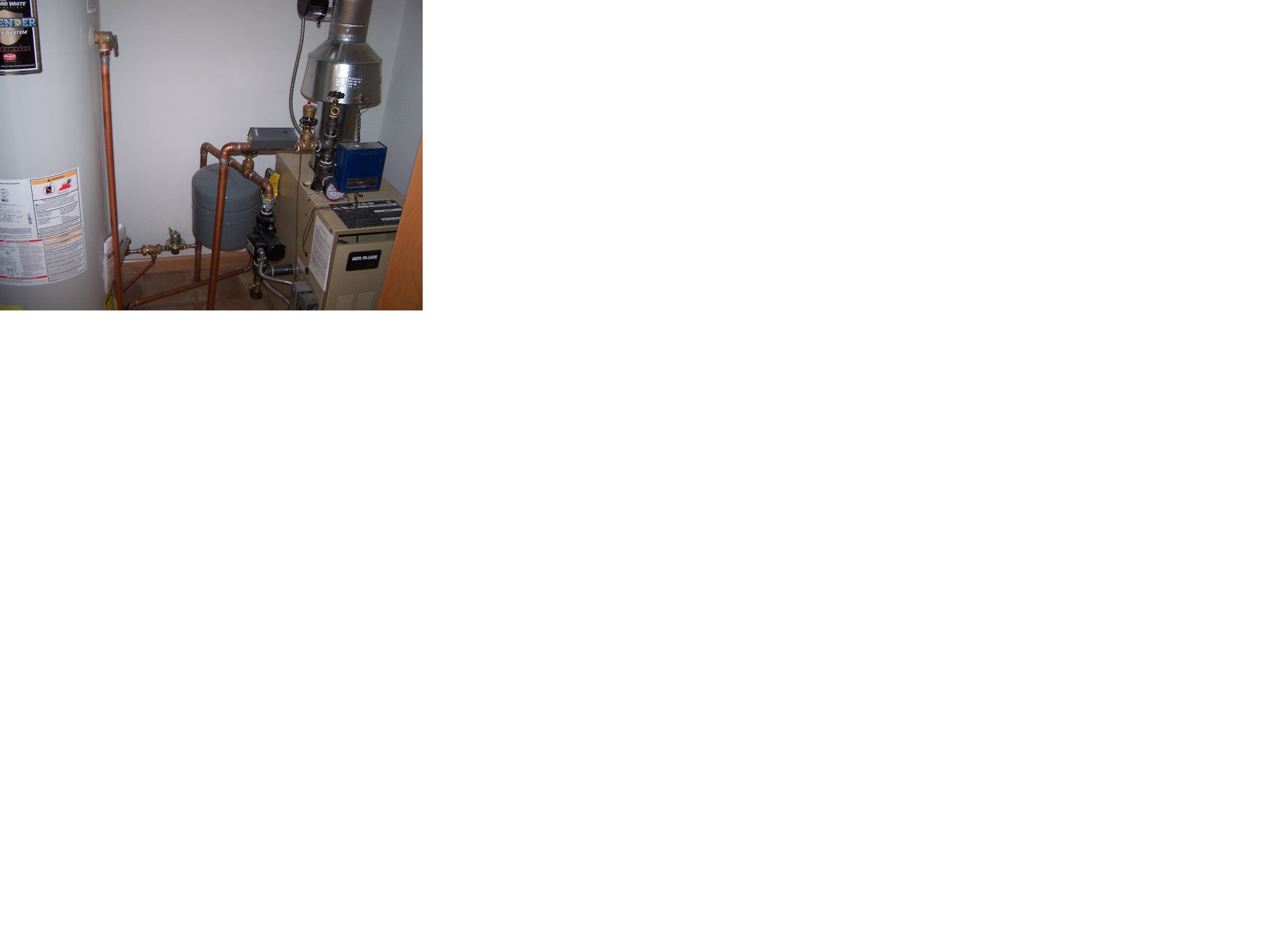

here is the water heater and furnace before I put in the heat exchangers from the outdoor wood boiler

My neighbor has a house like yours. Built on a basement. After he got it set and the brick layed on the foundation/basement you can't even tell it's a modular home. A lot of the basement is above ground. Very good construction with 2x6 trusses and 2x6 wall studs. His has 2x10 floor joists and is very well insulated.
At first you could tell where the seam was in the roof, but after a few hot days the shingles layed down and now you can't tell.
They had to set his with a 100 ton crane. Wish I had a video of that, but I don't.

Hey Chris, my shingles blended after a week or two also.

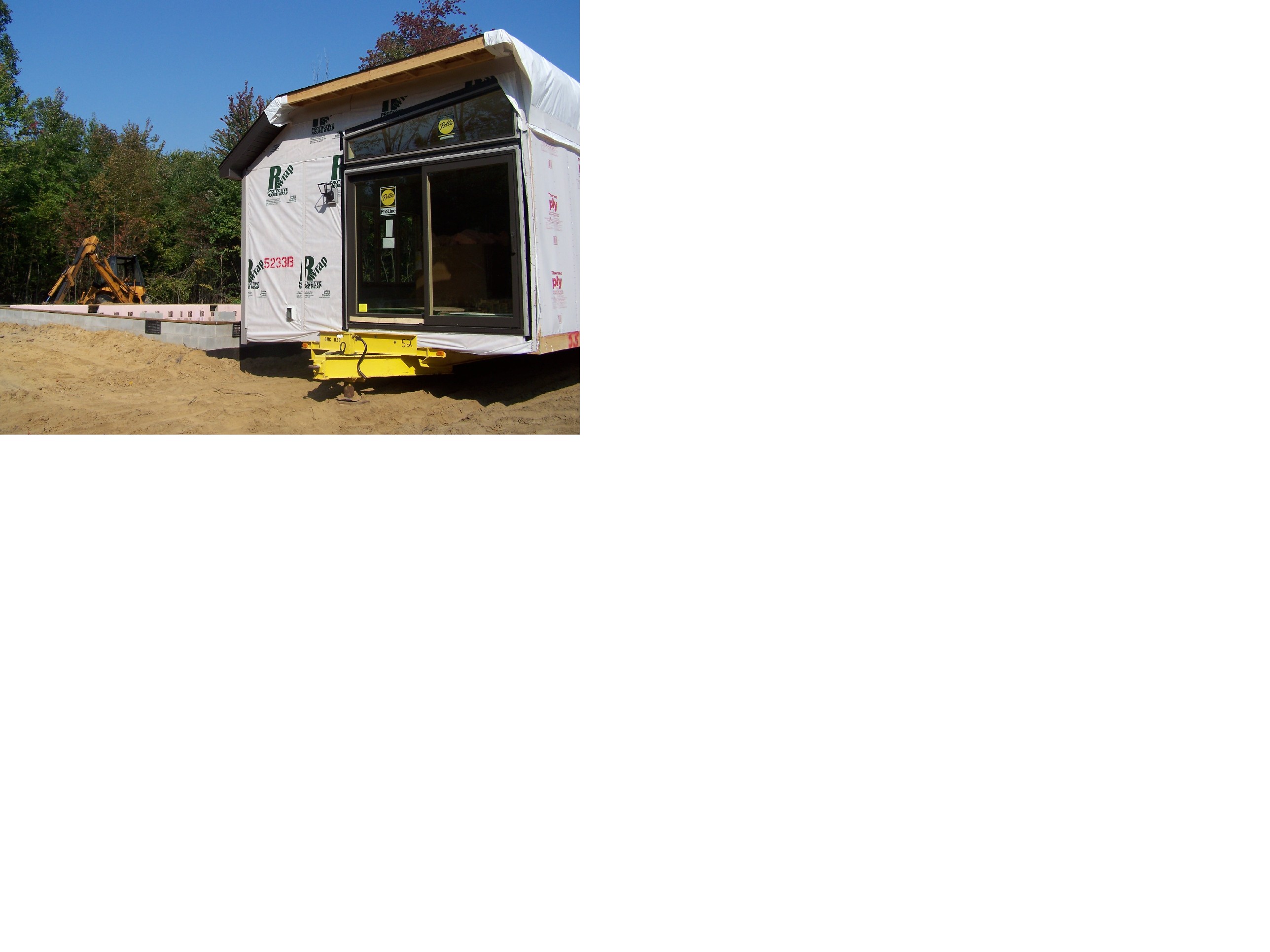

I didnt have my camera the day they set the house, but my crew didnt use a crane. They used aluminum I-beams in the vent holes of the foundation and rolled the house off the transport trailer via the I-beams. It was very slick and a lot less stressful on the house than picking it up with a crane. The rollers went North-South and East-West so it was very easy for the crew to make adjustments on the house before they set it finally. I need to get my ma to bring the pics over it was pretty cool.

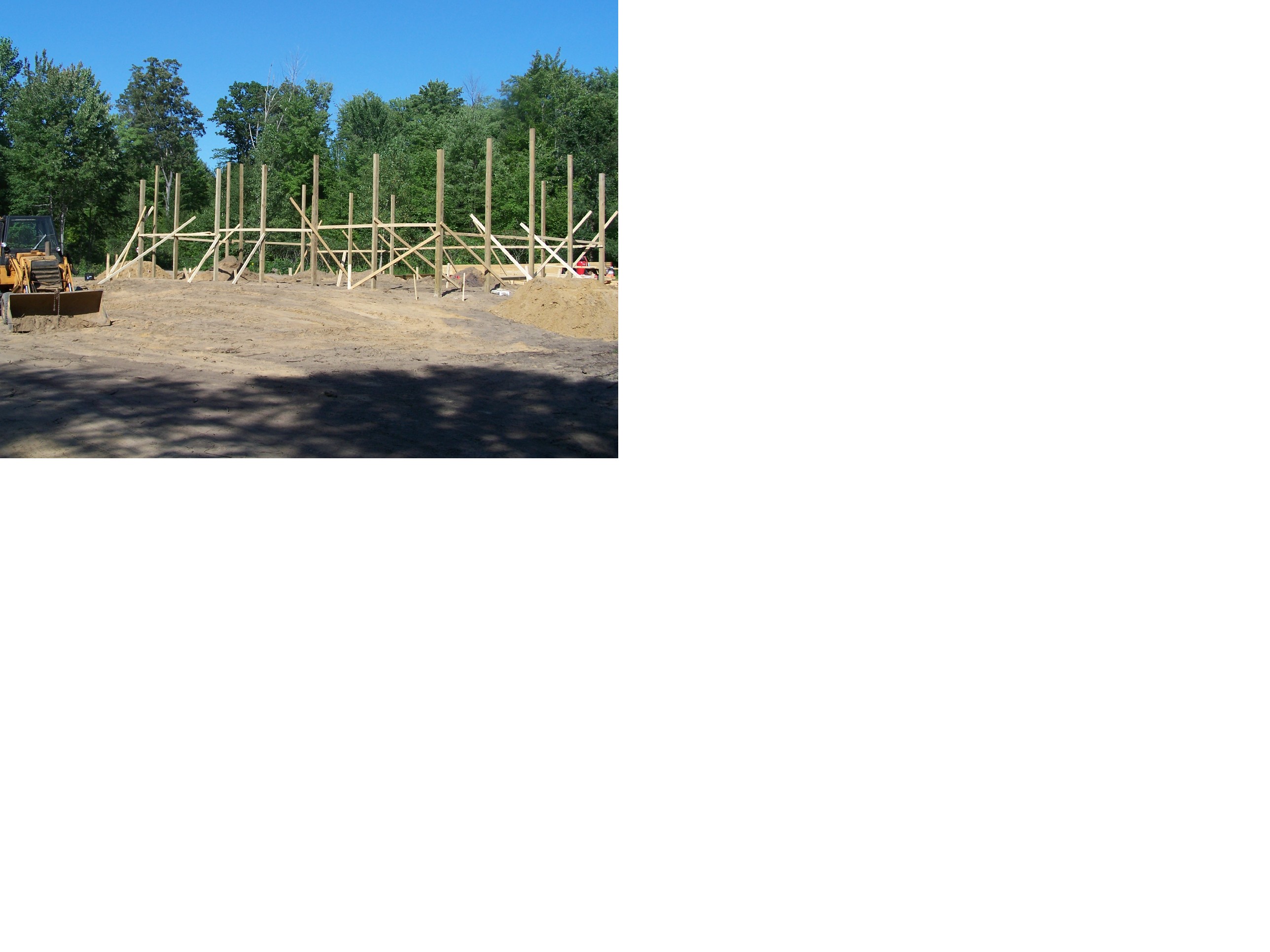

Since I cant figure out how to edit the pic I screwed up above, here is an actual look at my kitchen, not my pole barn posts lol
