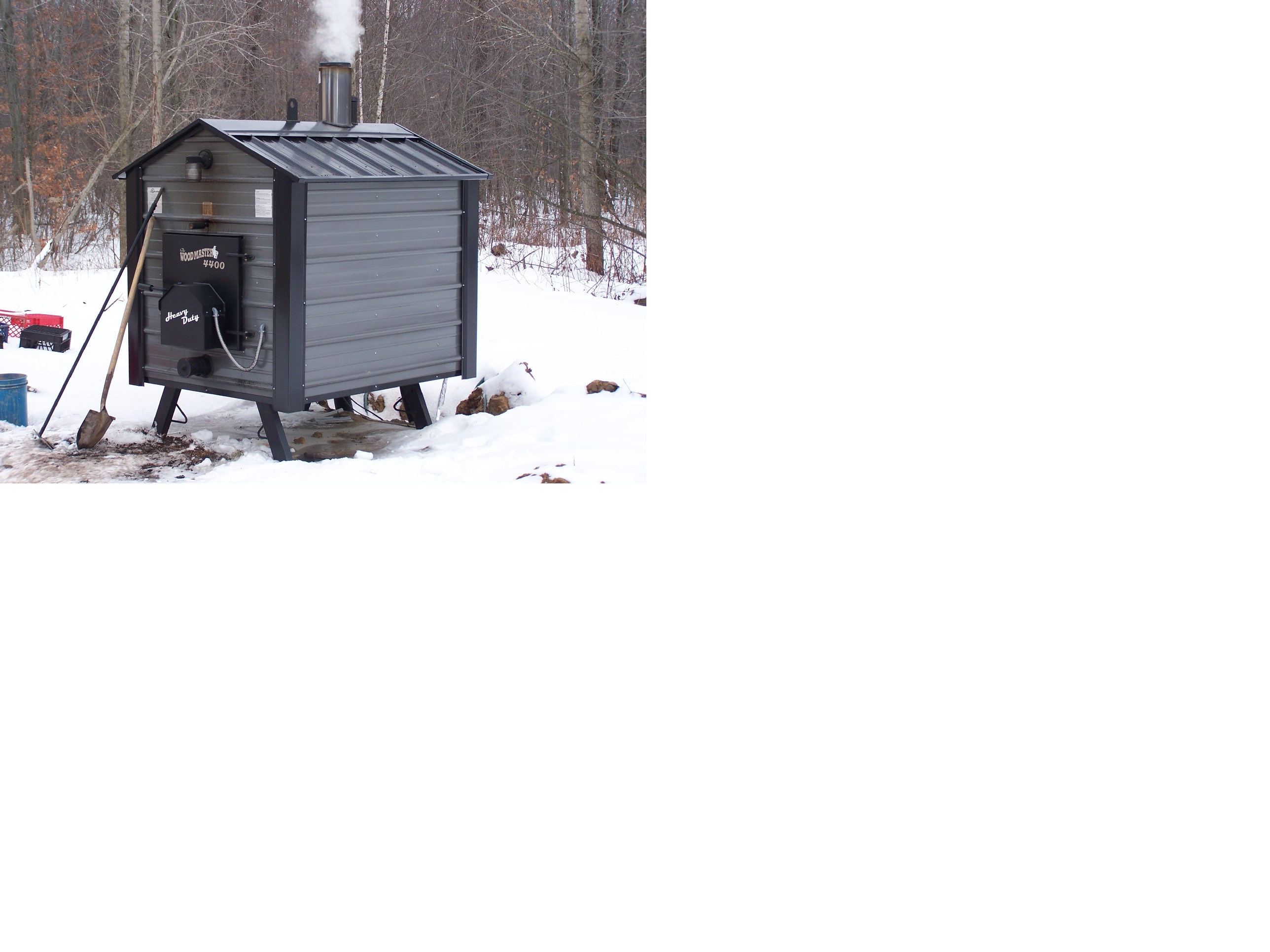

The log pile is all the good firewood that was in the 2 acre area that I cleared last year. Its about three years worth I figure. It will power my Woodmaster outdoor wood boiler which will heat my house, barn, and all my hot water. Pics are coming soon. Other than holding a few rabbits there were no problems with snakes or bees last year. Michigan has very few snakes that are poisonous, and most are in swampy areas. All I have is Garder snakes and salamanders here.

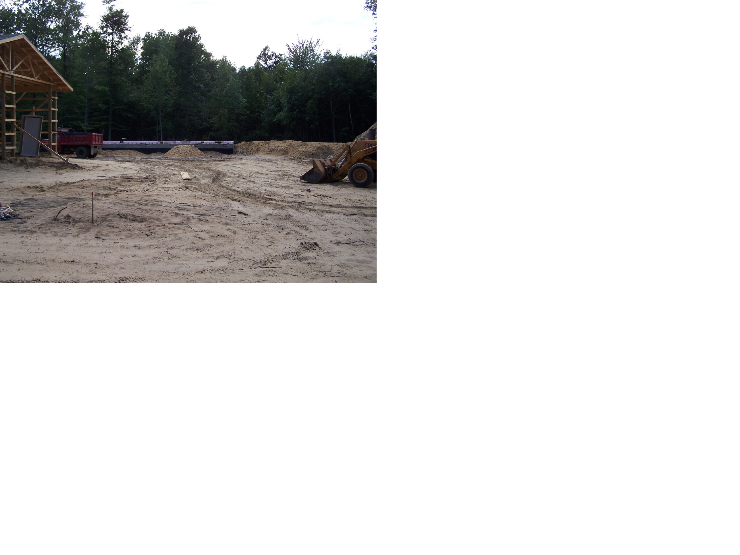

I wish I had taken more pics of the backhoe, but I have a few more I think. This machine has pulled hundreds of stumps, moved thousands of yards of sand, dug foundations and a septic field. I also skidded all my logs I sold out of the woods with it. All with 7000 hours on the clock. It does need some bushings and pins now, but it owes me nothing thats for sure. The 207 Case is no power monster, but one **** of a little motor.
This is right after I put new rear tires on the old girl
Here I used it to fill my foundation with sand up to the bottom two blocks

OK here is the final setup for the woodburner, its a Woodmaster 4400 Outdoor Wood Boiler that should save me about $2000 a year in LP costs at current prices.

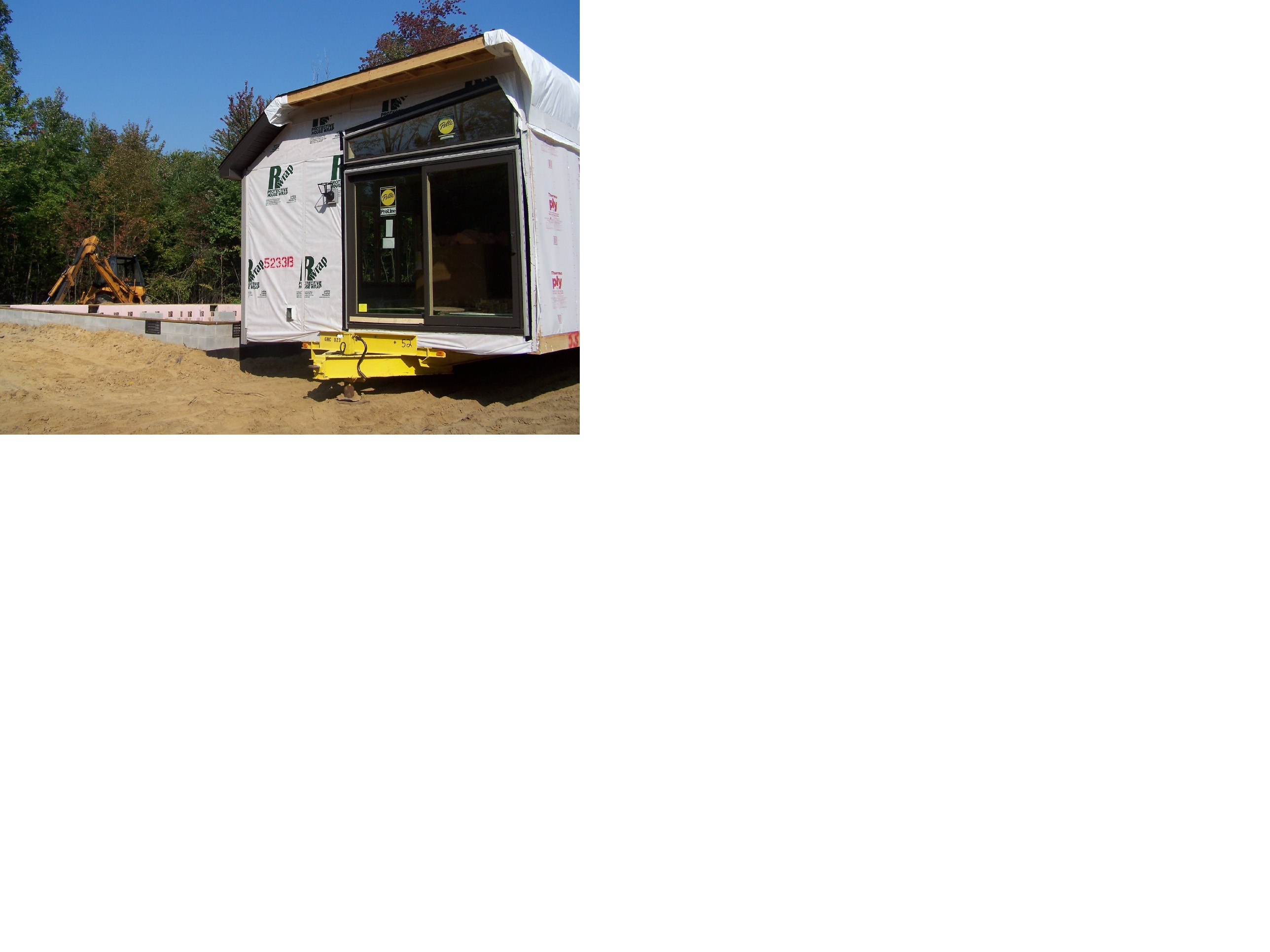

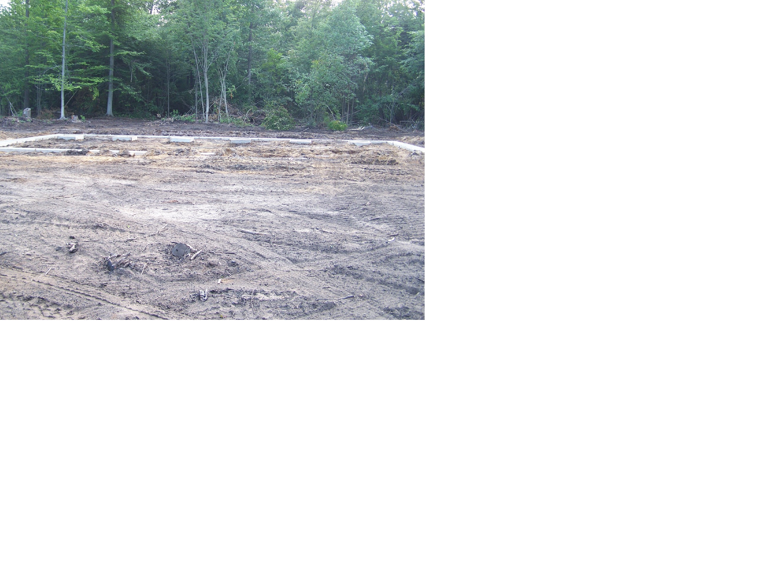

This is the foundation for the house. I basically used the existing grade as the base for the footings and then we built up from there.

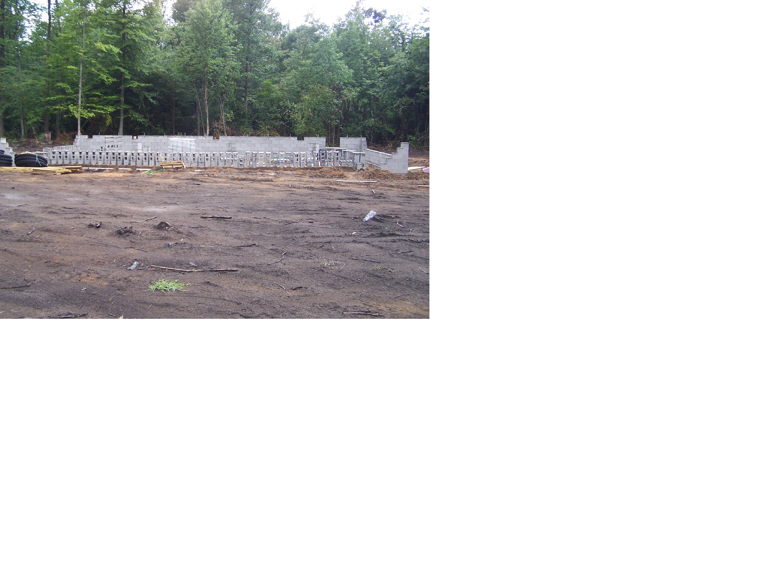

This is the foundation, I went 6 blocks high to have more room in the crawl space
Here you can see the loads of sand I placed all around the foundation to fill around it
