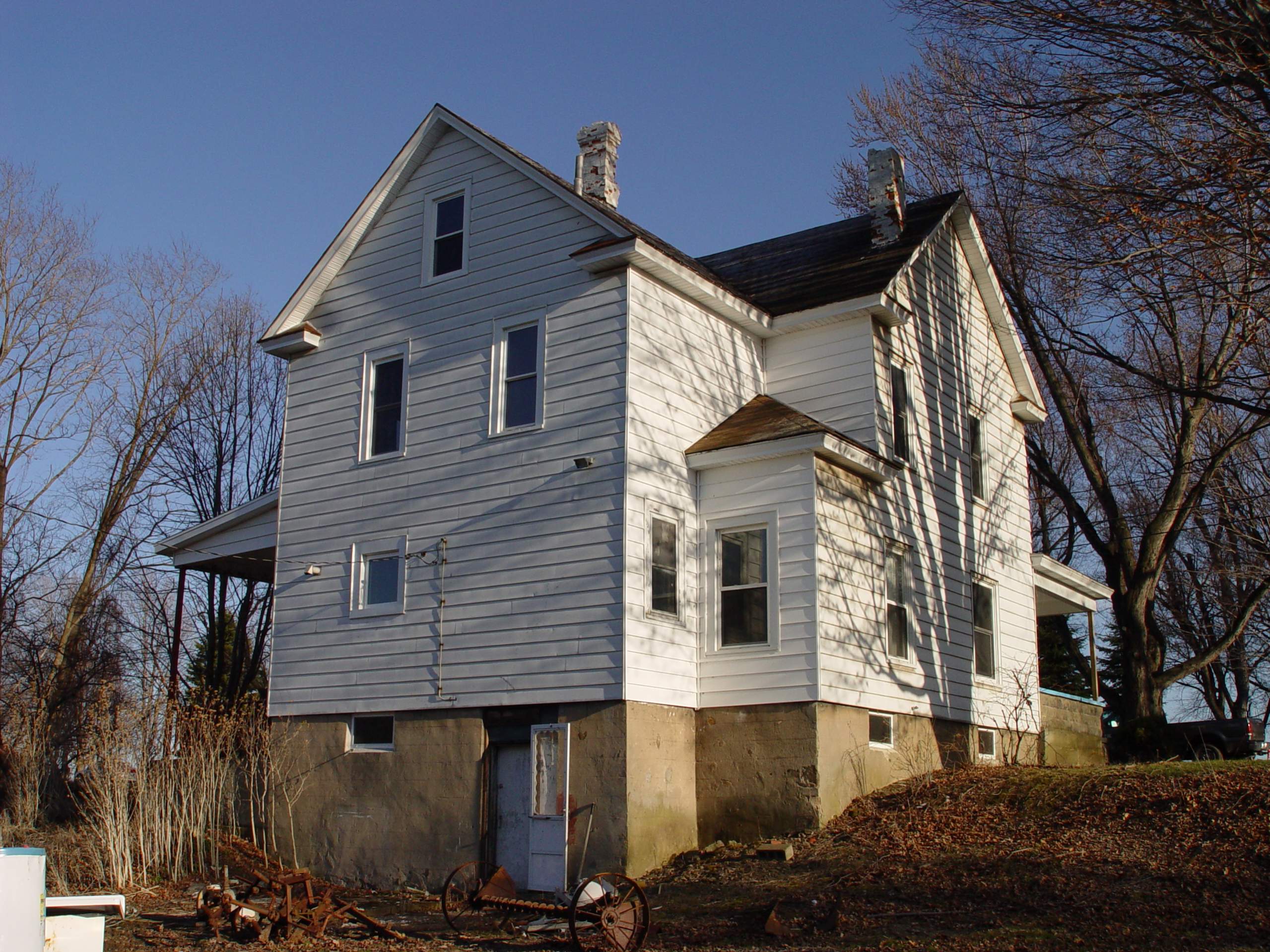

From the pics Robert, it looks like your house is straight and true, it must have good 'bones' and foundation. It's a keeper. :)
Dave.
Dave.
One of the most important things I look at with any house is the foundation and roof line. Any problems will show in those two areas and be noticeable at a glance. The foundation on this house is the old stone foundation that is about 18" thick. She is solid but I have water coming through on the front driveway side and that is why I am going to put drainage in and seal the wall at the same time.
Yep, I think the roof lines and foundation tell the story. Not that I am an expert.
I looked at an old house to buy which was a center stair story and a half cape with an attached ell with a carriage stall. They had used what I think was hydraulic cement to fill in the gaps in the original hand-split granite foundation. It was pretty dry. They hadn't redone the footer drains - (house probably didn't have any :)) so the cement alone accomplished quite a bit.
It was already sort of half redone in a way that changed the entire layout. I was very tempted but decided if I had got it before the rearranging, it would have been very cool, but as it was, I wasn't going to pay for improvements and then tear them out.
They had put in a beautiful tiled master bath shower and master bedroom in what used to be the living room. Added a laundry closet and half bath in a corner of what used to be the dining room. What was done was done well enough, but completely took away the period charm.
Dave.

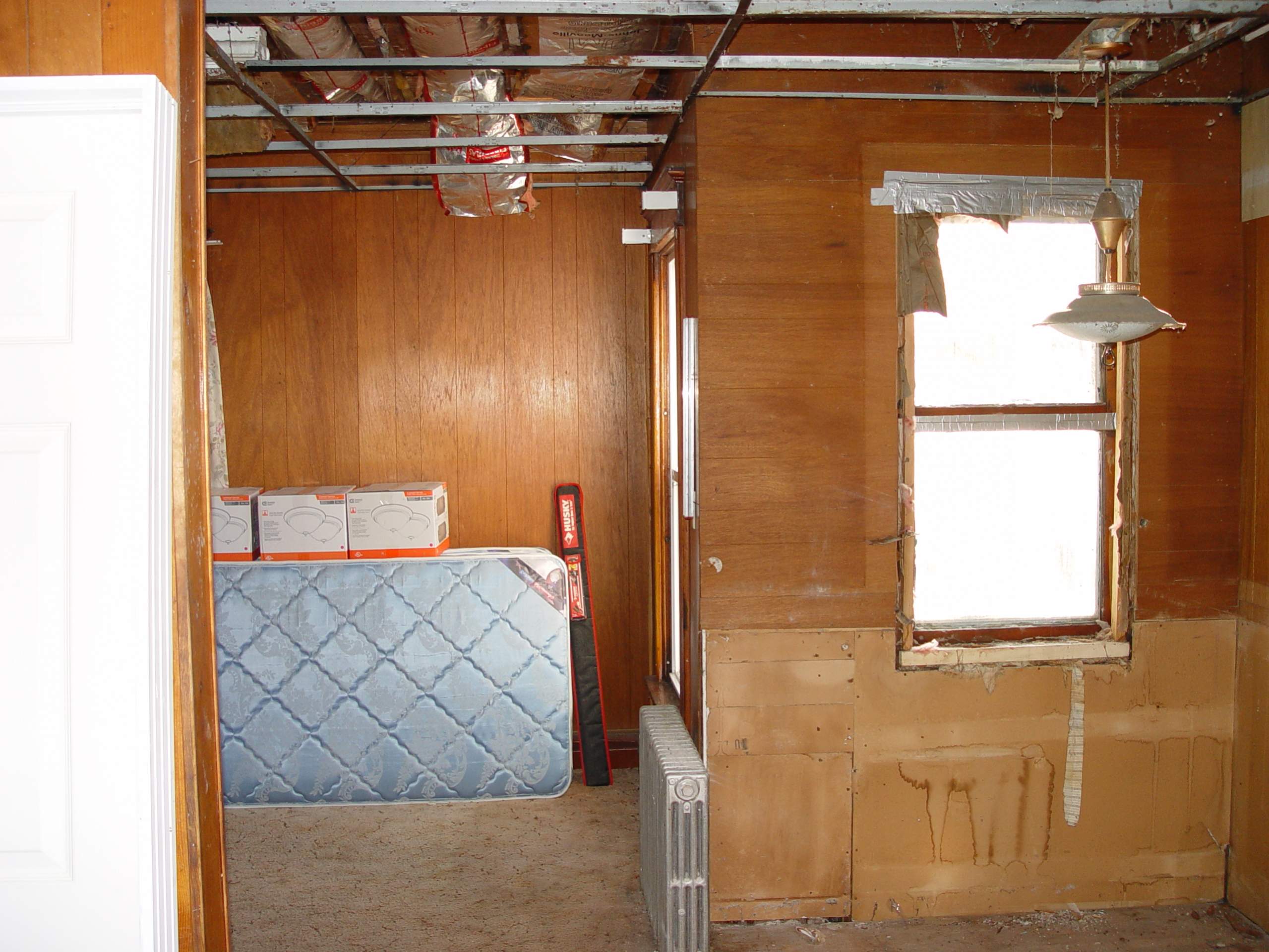

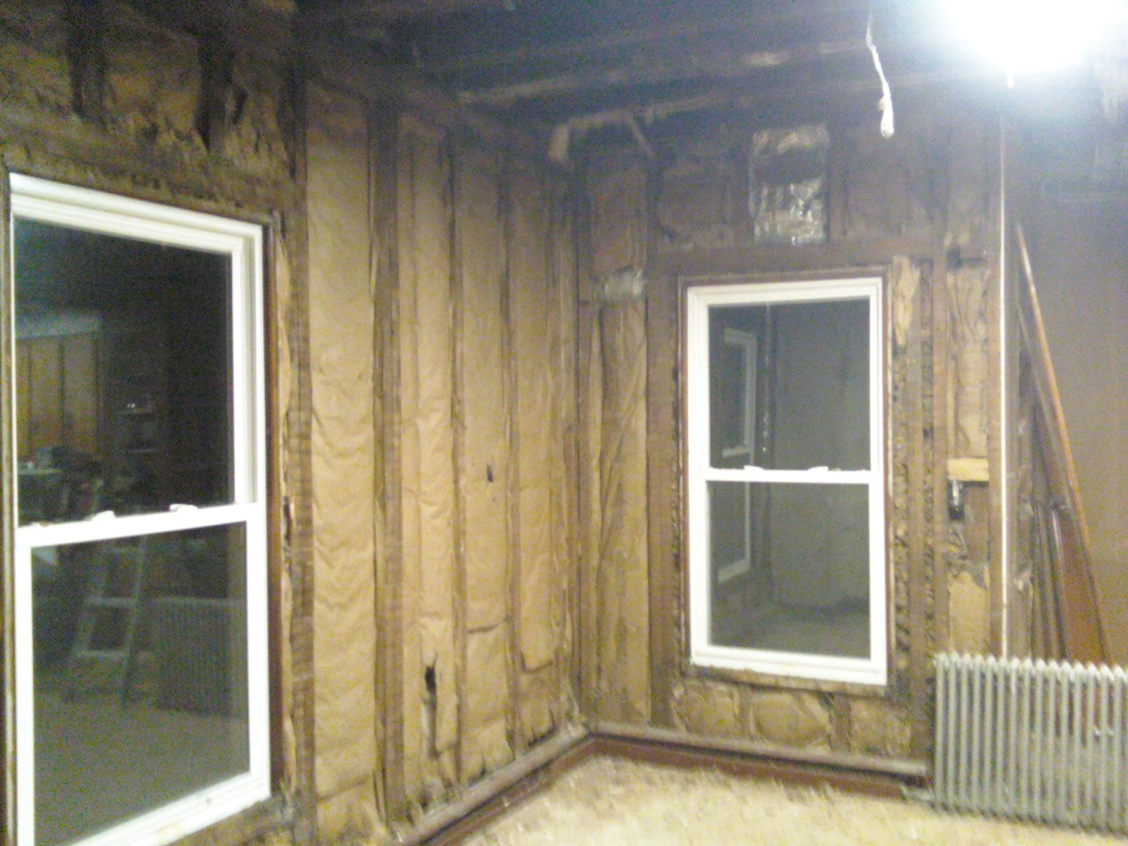

Today was kind of cool and rainy so I spent part of the day working on my house instead of playing in the barn. I started by taking down the paneling in the dining room. To do so I had to remove the window trim and am contemplating wether to try and salvage it or start from scratch with new wood. Once the paneling was off I could see the mess I had underneath. They drywalled the exterior walls at some point after they insulated them. The interior walls were lath and plaster still but was messed up from other remodeling projects. So I am tearing this room down to the studs and am going to replace the insulation with thicker insultion as this is very thin. I am also going to redo the wiring a lot easier now that its tore apart.
Also, since I now have both this wall and the upstairs wall open directly above (on the interior wall) I am going to run a conduit from the basement to the attic. This will allow me to run wires in the future if I ever decide I need another line somewhere. It will be left empty for now and capped but will be very handy in the future if I ever need another wire upstairs.
