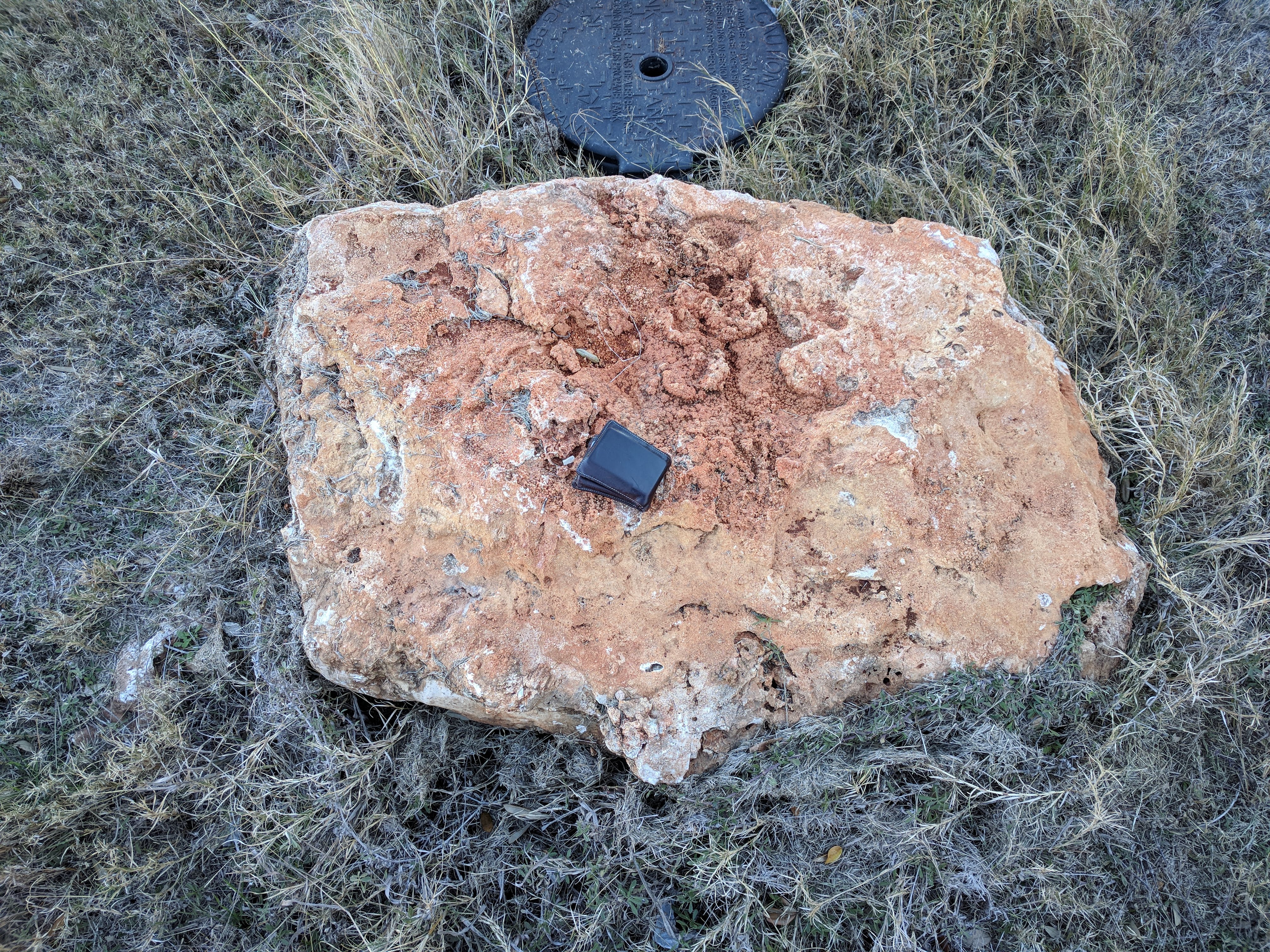

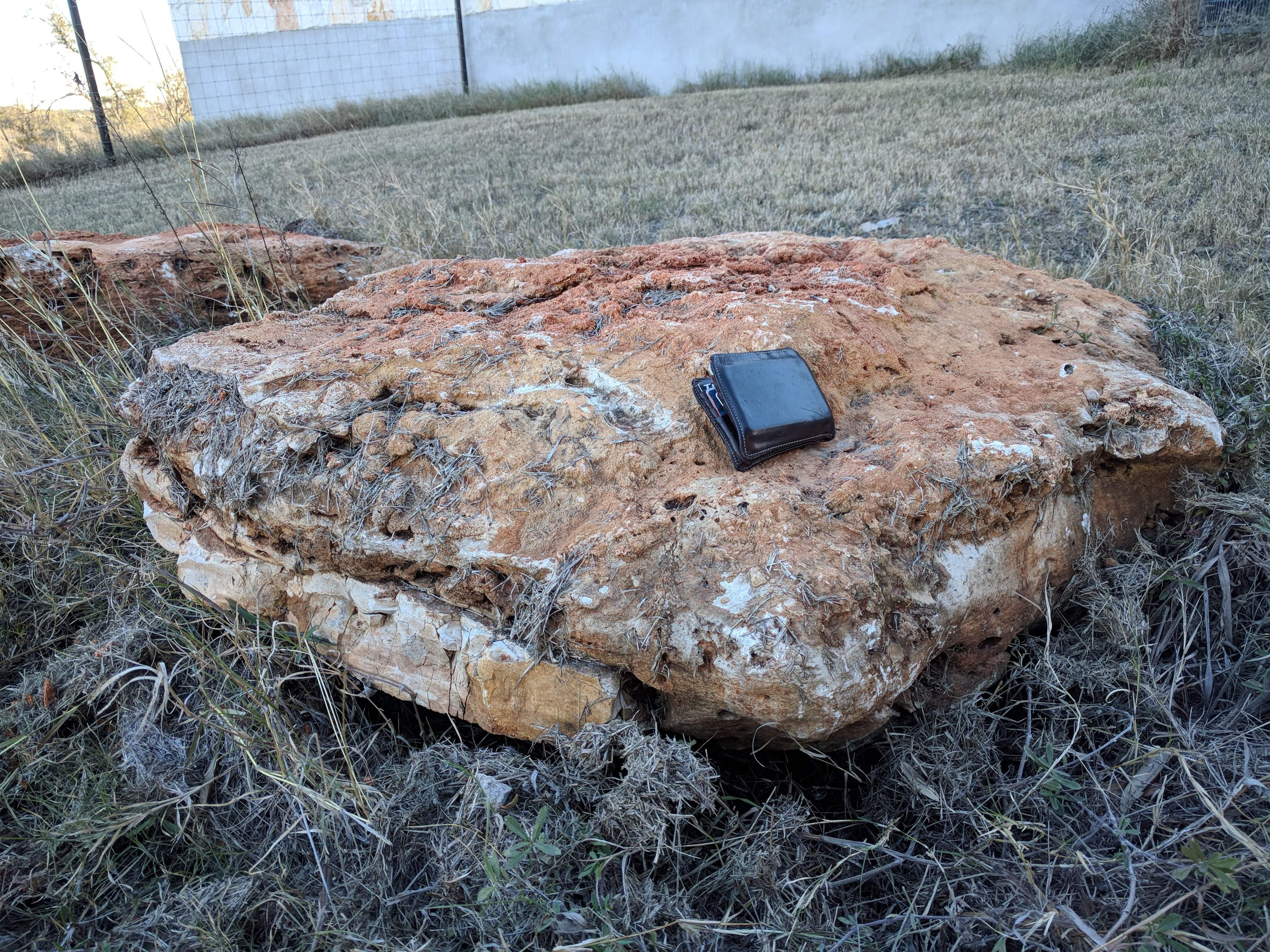

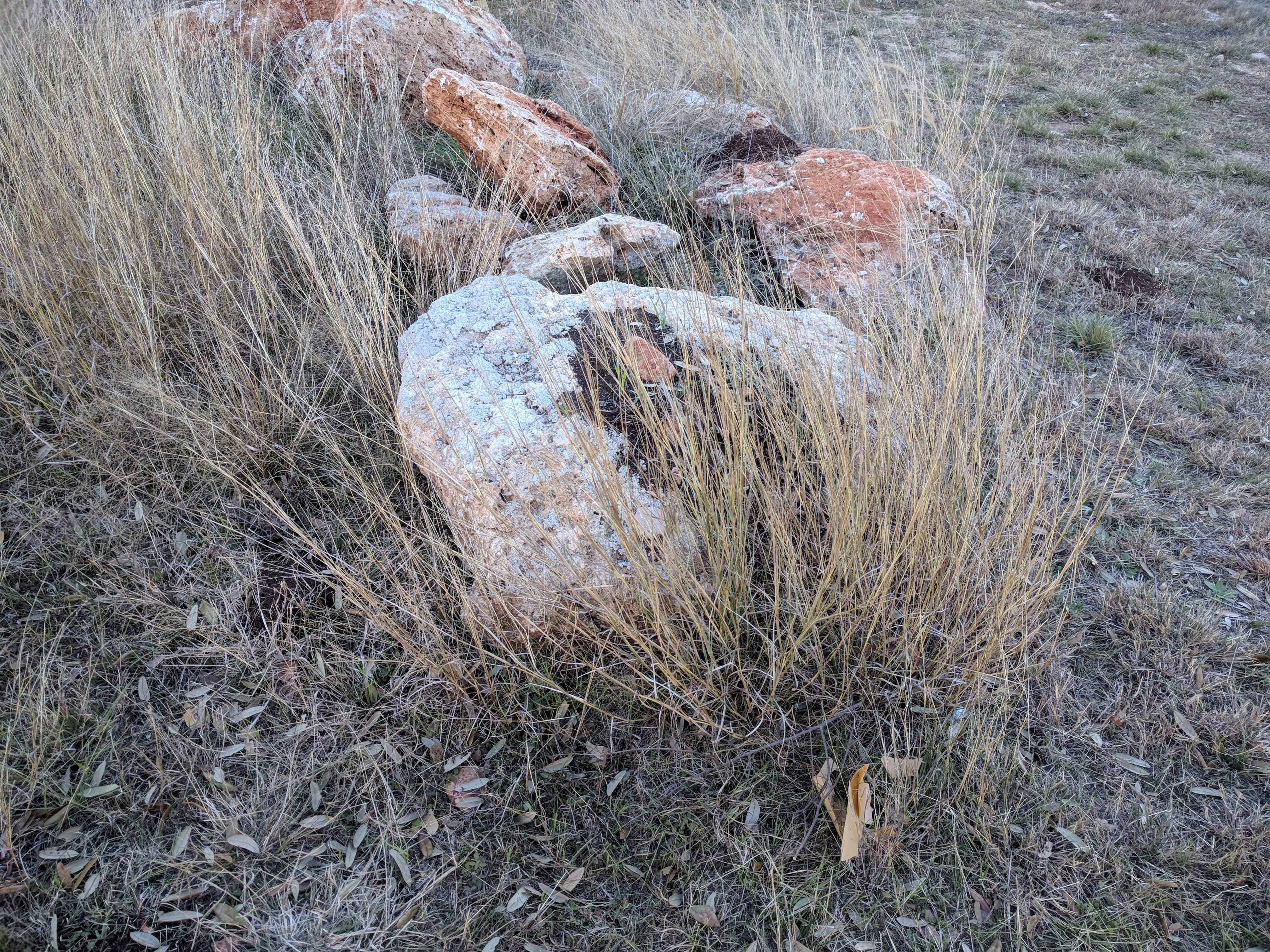

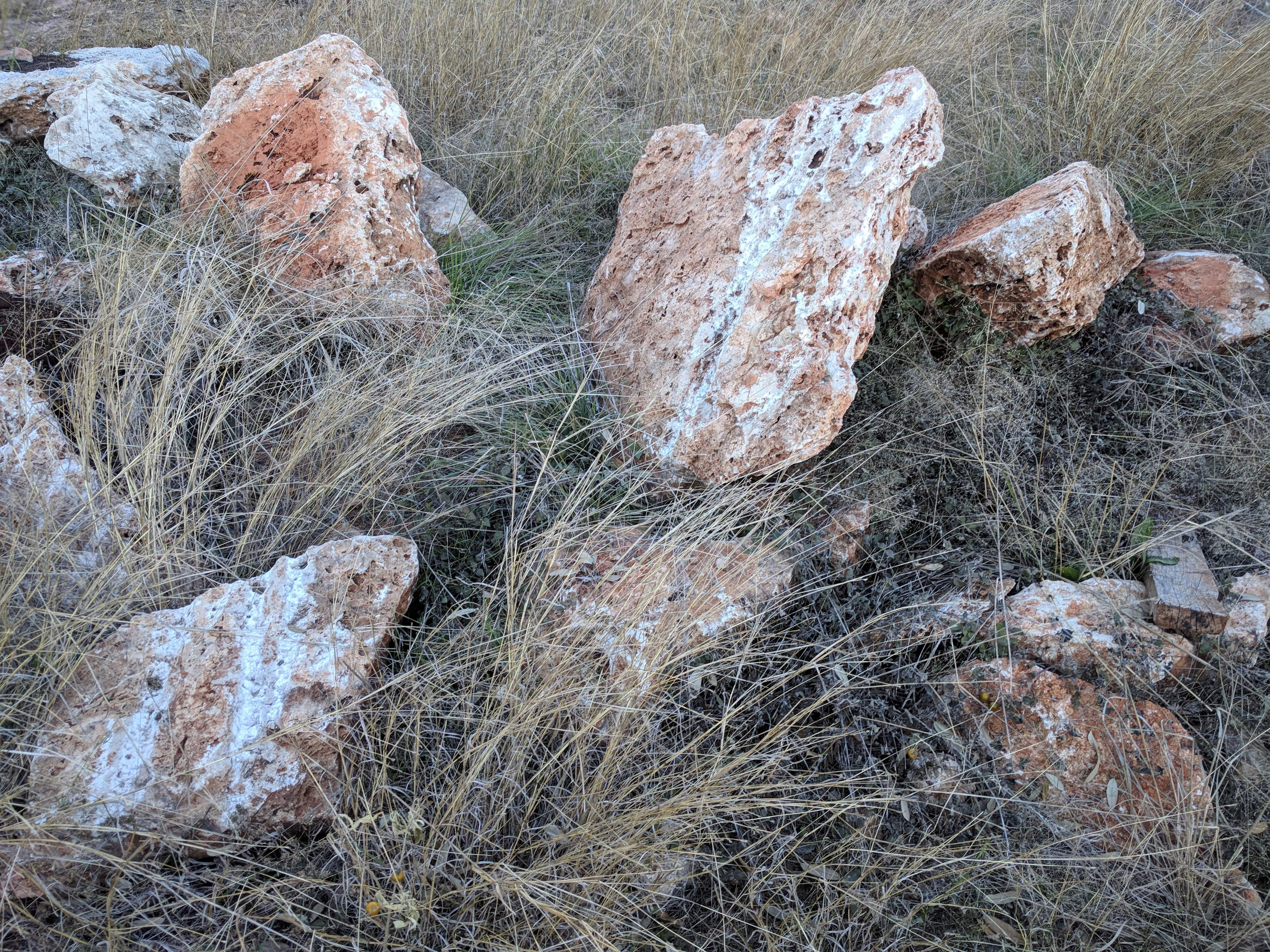

I'm in the market for a SCUT TLB. I don't exactly have a lot of land to mess with, only 1 acre and there's also a house and garage on it.
What I do have though is a lot of brush, cactus, and cedar saplings to clear out. The soil is ridiculous; I've never seen so many rocks. I want to churn them all up and out if I can, which might be futile, but ignorance is bliss? My wife is from Iowa and dreams of doing some micro-farming. She would just like a healthy garden and I want to try to make that happen for her. I also have a long list of other ground engaging projects but my free time is somewhat haphazard and I've found renting equipment to be challenging and stressful. I do also have some boulders to move around, I'll attach some pictures of those (with my wallet for scale!). I'm thinking if a SCUT isn't up to the task of dragging them around I could just rent something just to handle those and i'm pretty sure a SCUT can handle everything else. Seems silly to buy something bigger just to move some boulders that I likely wouldn't move again?
View attachment 534540View attachment 534541View attachment 534542View attachment 534543
Anyway so far I've looked at several options. I really come in to this with no foreknowledge at all but thought I would share my initial takes but also bounce them against a wiser crowd that can tell me if I'm looking at things or thinking of things in the wrong way, and of course things I should be considering but maybe haven't been. I don't know what I don't know. After reading around here for the last couple weeks I did learn what SCUT and TLB mean so that's something. :thumbsup:
Also I'm kind of a big guy. 6'4" and north of 300lbs.

So the only options left really are the Kioti CS2210 and the LS MT125. For various reasons of either value or ergonomics the rest have taken themselves out of the running.
I have not test driven anything so I think that's the next thing to do, and the Kioti dealer said he had the backhoe for the CS so I'll have to call in the next couple of days and see if he'd be willing to put it on for a test drive.
So that's it, a bunch of tractor opinions from a guy who didn't even know what SCUT meant a month ago. Any and all thoughts and feedback are welcome, feel free to be blunt, I can take it! Thanks for reading. :drink:
