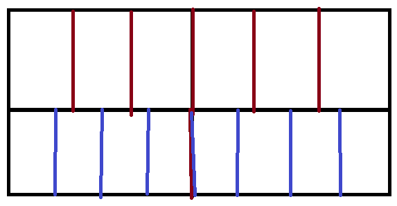

Ok Dave enlighten me. How does the 12" battens align with the 16" battens to make it look symmetrically ?? I know you have it figured out just baffles me somewhat !!
Yes they will, but to me it is not something i would like to look at ! That took some planning to make sure it all aligns with the upper and lower windows. As long as they are happy with the design is all that matters !!!
I always struggle with that Grinch thing. We are going to our Daughter's house this afternoon. Our weather is perfect for outdoors work. I'm in the middle of a backhoe project clearing brush. I'll struggle hiding the Grinch this afternoon. But I'll pull it off.....It should line up every 4 feet. There is a 3.5 inch piece of trim at the top of the 16 inch section that separates the two sections. Basically breaks it up into two visual sections. Hoping to get to that point soon.
