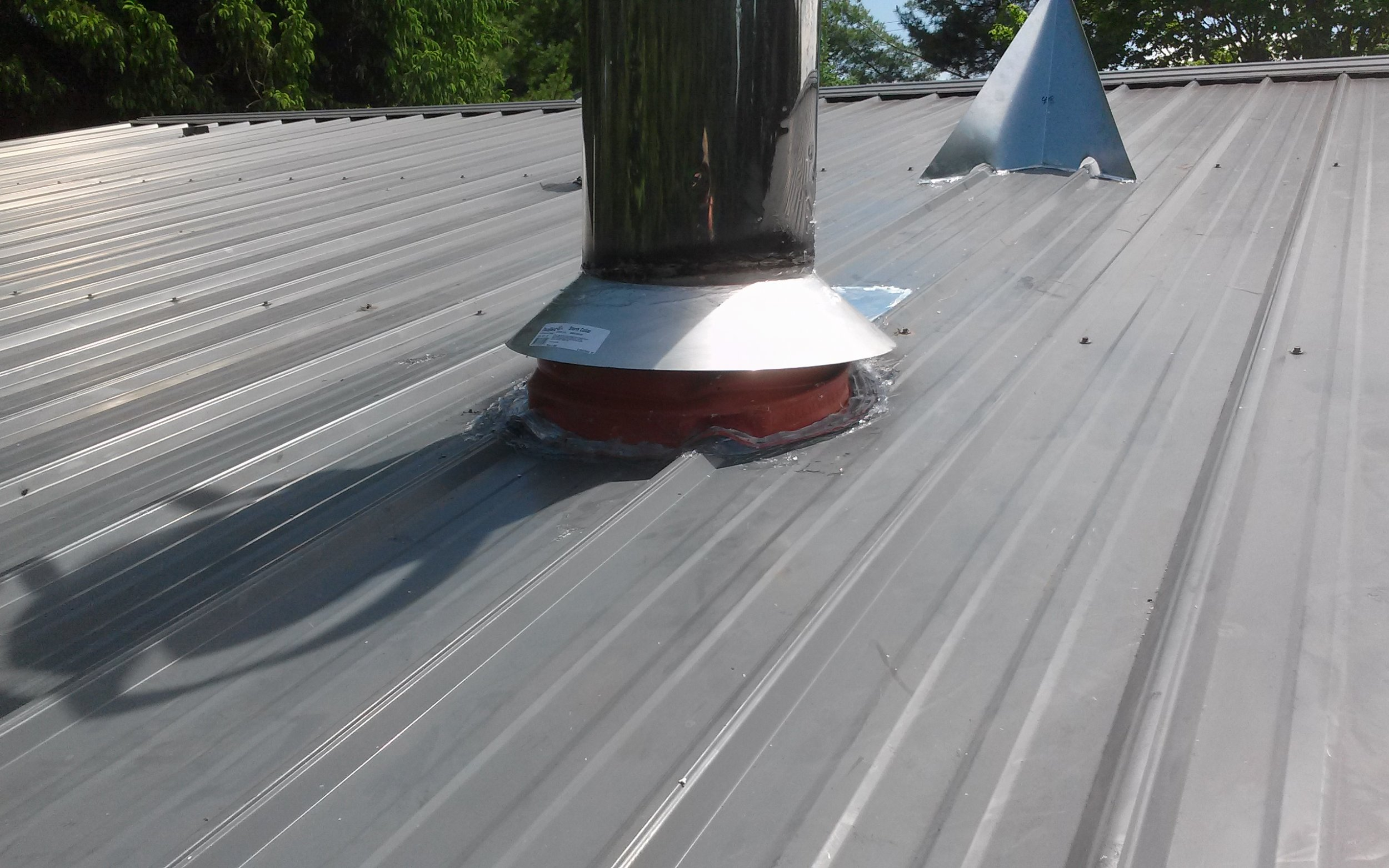

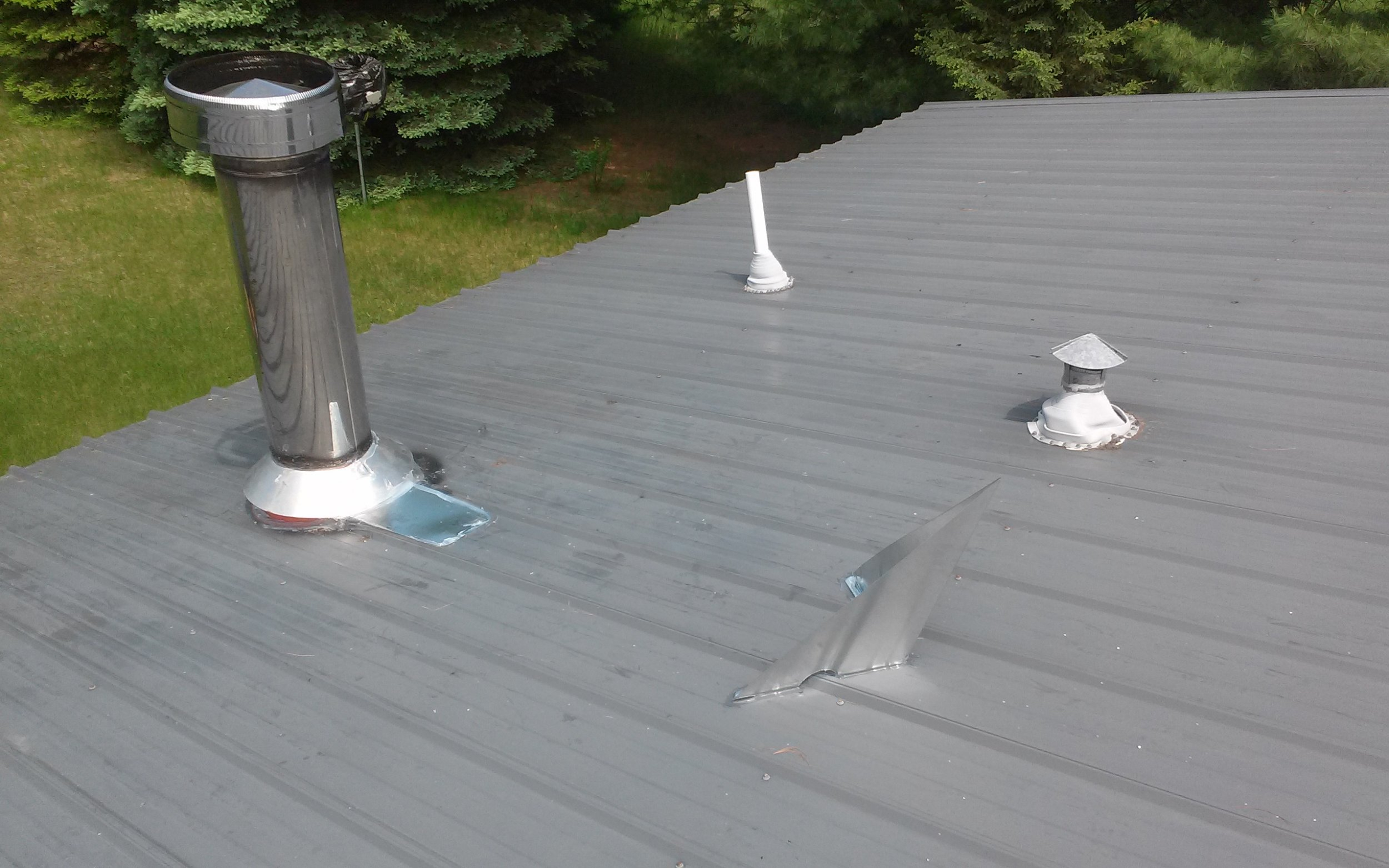

I'm curious what you're imaging for "diverters". I could picture just buying some aluminum angle strips from home depot, and bolting to s5 brackets, making a "V" above the chimney. Our basic snow guards seem to be doing the trick for 6 years now, but I can't go up and see it directly in the winter.
   / My Industrial Cabin Build #2,988
Another view.
These have been on since fall of 2015. Made by local chimney place. Jon
