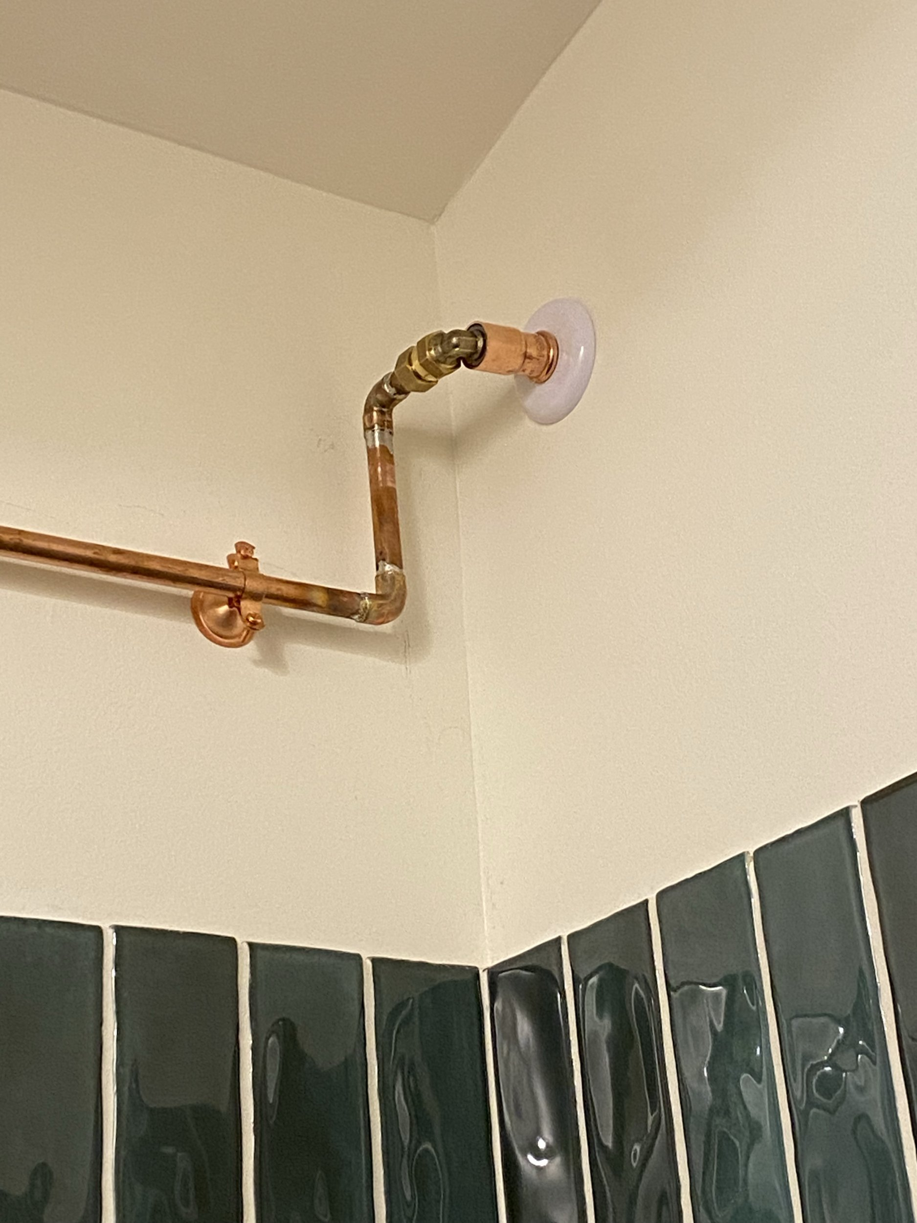

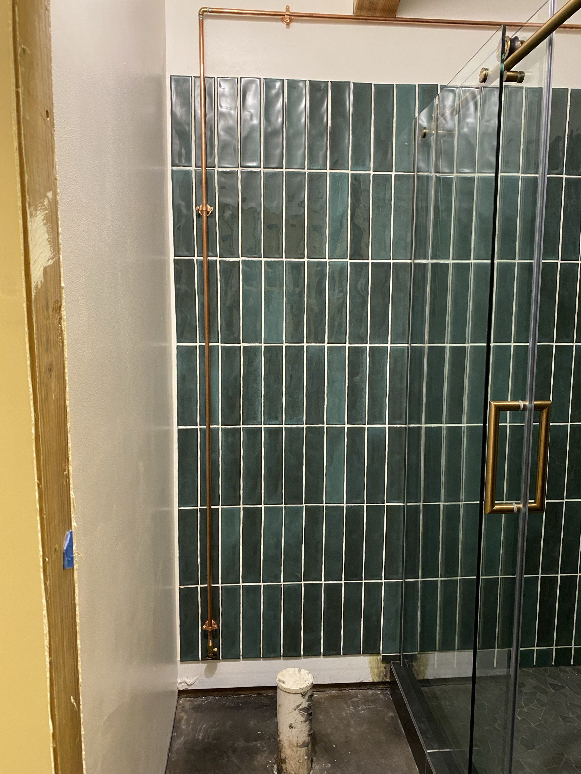

I put together the toilet water line yesterday. Camouflaged it fairly well to hide the pex feed and make it match the bathroom. I have never sweated a pipe before. Only burned myself 4 times. I hope it holds when I pressurize it.

If you see Brasso on sale buy a couple cans. The copper pipe will discolor. The Army taught me to hate exposed copper pipes. When state side, we had to shine the copper pipes in the latrine with Brasso everyday. Tents didn't have indoor plumbing.
Nah, Jefanna is all about the patina of aged copper. She was even looking up ways to artificially age it. I said tonleave it alone and it will discolor fast enough.
