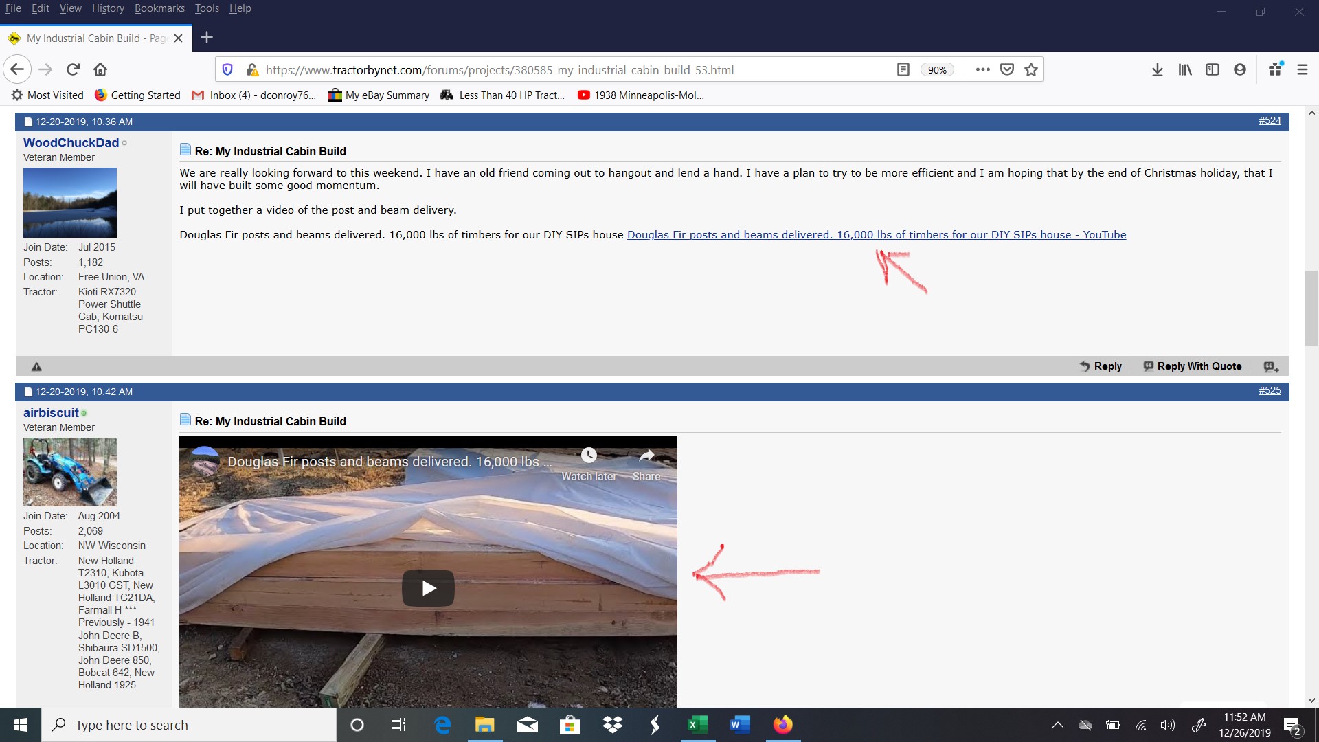

Why do you repost the video?
   / My Industrial Cabin Build #552
Just makes it more prominent for everyone instead of just a link.
   / My Industrial Cabin Build #553
It shows up the same on mine.
Anyways I found where to turn off auto play video.
   / My Industrial Cabin Build #554
Here's the difference on my computer:

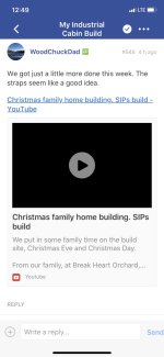

   / My Industrial Cabin Build #555
Ok. I use the app. His shows up fine in it. I turned off auto play, so blank where it used to start playing the video.
