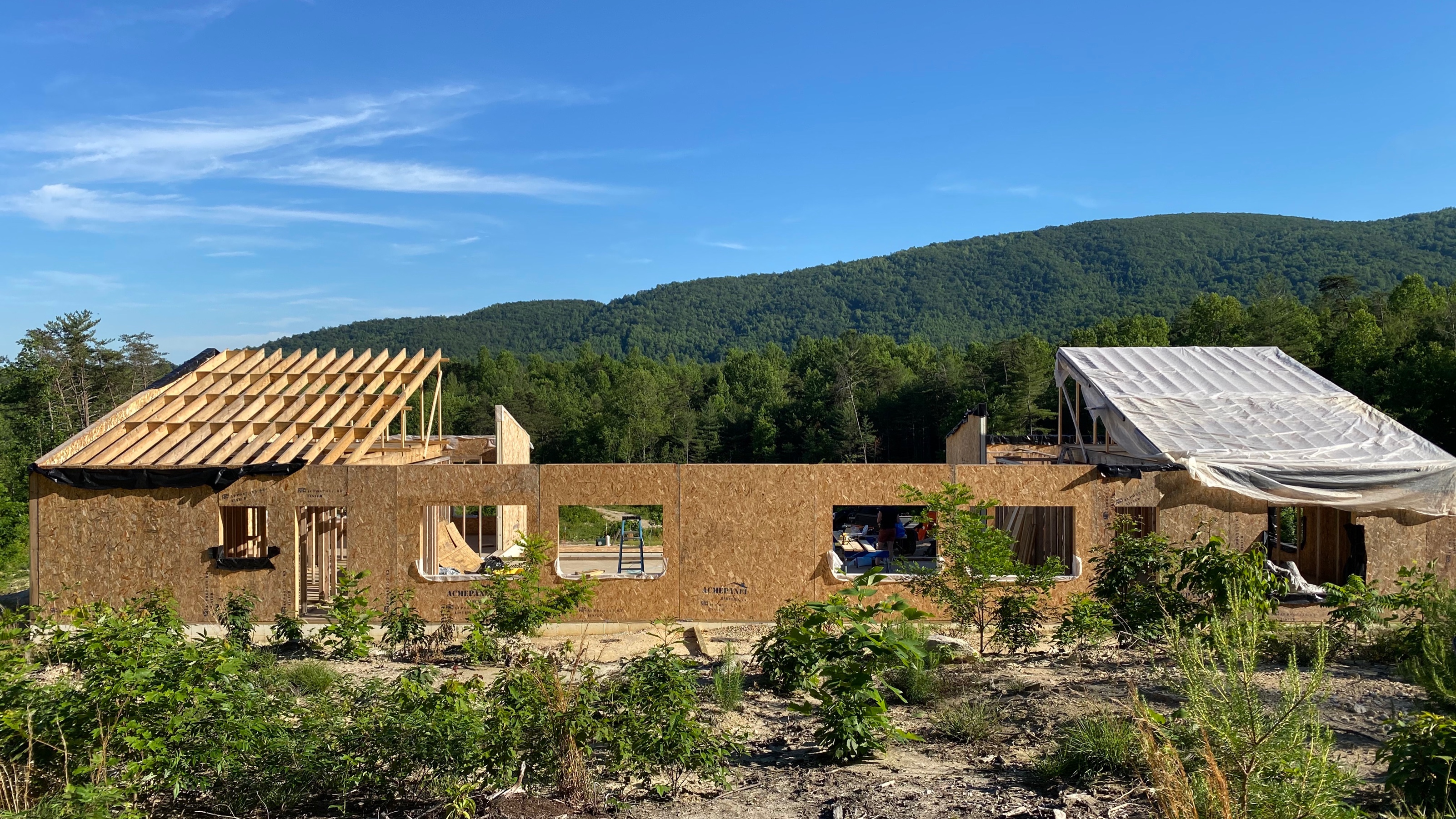

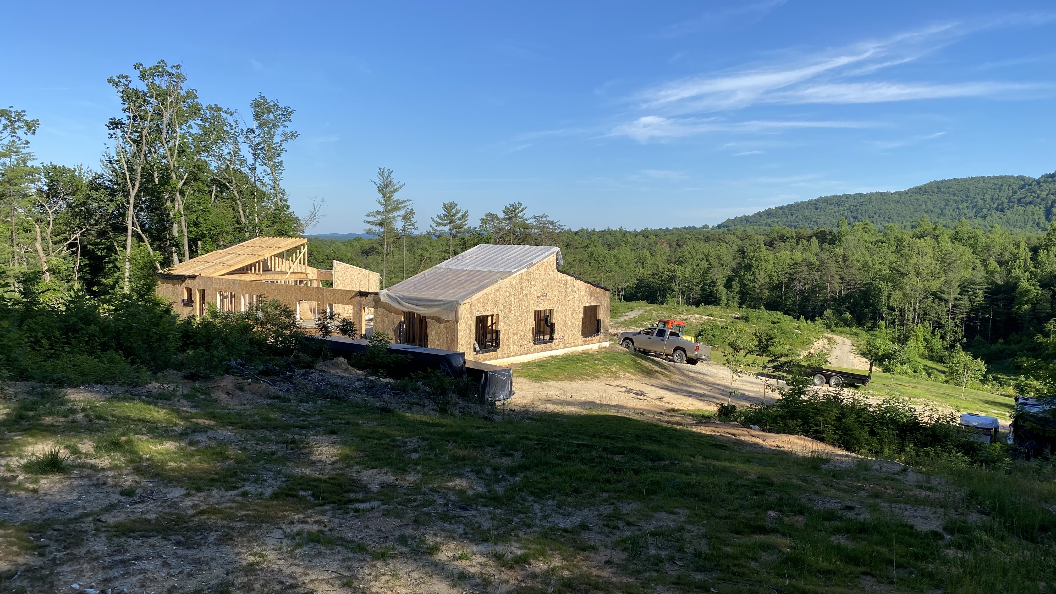

This weekend we completed the back wall. Progress is slow, but it is definitely progress.
We went up a fee days this week after work. You really only get to peck at things that late but it is still work being put in.
I am really happy with the way it looks. There is still a mountain of work in front of me to be done. But it makes the place feel different. It is hard to describe.
   / My Industrial Cabin Build #898
Awesome, pretty day!!

All your pics (which are great) are from the rear of the house. I understand it makes for a good overview because you can get some elevation above the ground floor level. Do you have any good vantage points from the front side? I threw an old wooden extension ladder against a tree in front my house, so I could climb up and take pics every day during the build (and many more after as we finished up the landscaping, etc). Still need to stitch them all together into a short video!
