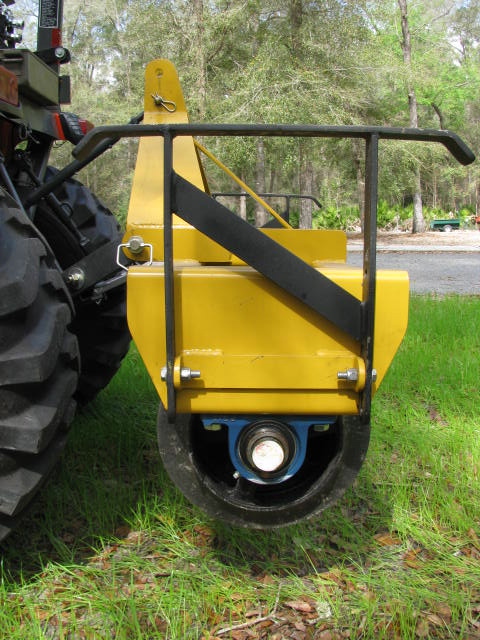

I was planning to hook up my 6' Bushhog behind the tractor to serve as a counterbalance. Is that a wise choice?
Yes.
Rotary Cutters and Box Blades are the two implements most often use as counterbalance. While the Rotary Cutter will trail way back there, per PAPPY, that adds to leverage and its effectiveness as ballast.
A good, compact form of implement counterbalance is a Three Point Hitch mounted Cultipacker.

It will work as a counterbalance, but a rotary cutter sticks way out there behind your tractor. If you're in tight quarters, it will limit maneuverability and you'll have to be careful. Also, I doubt that a 6' rotary cutter will cover your tracks on a 7060, so you're probably going to want to get a wider cutter.
A more compact solution would be to either build a ballast box or buy a heavy duty 7' box blade, such as a Gannon with hydraulic rippers (which would weigh approx 1,200 pounds).
I could also hook on my 6' tiller. That thing is a beast. 400-500 I think at least. It doesn't stick out much at all. *correction - it is 1000#. Very heavy. Although most of the work I'll be doing around the fields will require me to use the bushhog to clean up what's left after pulling the olives. So the conditions won't be tight and that's probably a better choice. Not so for clearing trails though, where it is much tighter.
