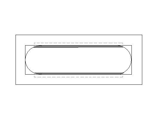

   / My letter to Kioti, loader rerepair, long #305
It looks to me like a pretty simple fix. The cracks originate where the doubler stops, extend that gussett all the way around the access hole and I'd bet you'll never have a problem. Pardon my crude "paint" sketch, but you should see what I'm suggesting.

   / My letter to Kioti, loader rerepair, long #307
That's exactly what I was figuring for a fix but I'm not a mechanical engineer. Hopefully in the very near future I'll know what my fate is.

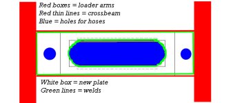

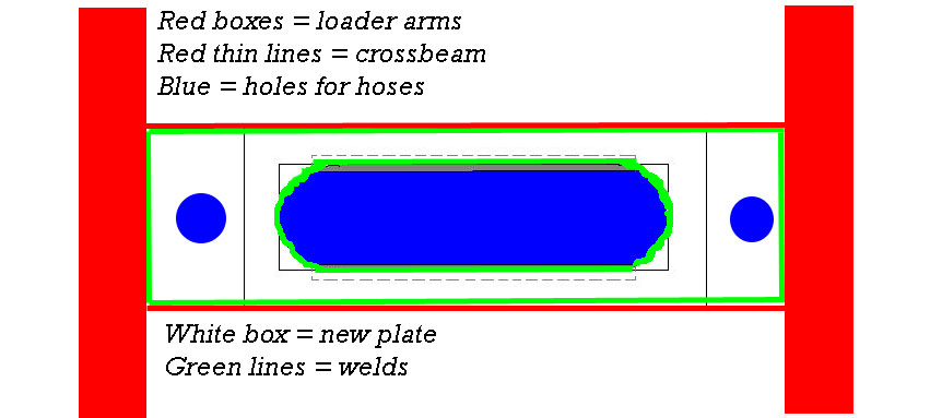

RedRocker . . . I would suggest that your fix might (?) be incomplete because to gain any significant tortional rigidity the fix should not only be welded to the crossbar to hold the cracks, but it should also be attached to the main loader arms to stiffen the loader to prevent cracks. JMO
EDIT : See my attachment, I used your original drawing and drew over it. But I would think the new plate that is added should look something like this, and preferably would have a 90 degree bend, with about a 1" lip on each end where it could be welded to the 2 loader arms. It would give a lot of structural rigidity by tying the 2 loader arms together very securly and reinforcing the crossbeam too.
