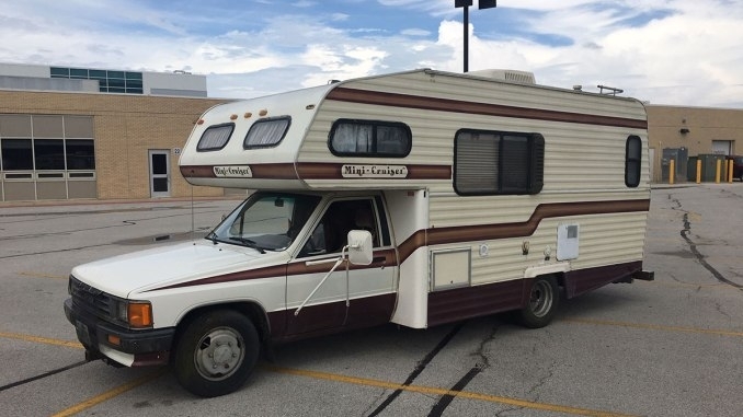

I had a 22R in an 87 Mini Motorhome. It ran great except for the overdrive. It didn't have enough horsepower to even make a slight grade in OD. Mostly ran with the OD switch off. And it was a gas guzzler. Took that to just about every Ohio State Park and all over out West with the young family. Spent a whole week just in Yellowstone. We lived in Ohio back then and bought the MH at a trip to an Indiana MH Show. It was delivered about three weeks later to an Ohio dealer. It was loaded and included a 4kw generator and roof air. Except for the horsepower, I really liked that thing.
This is an image I found off the interweb. (Mine was Blue)
