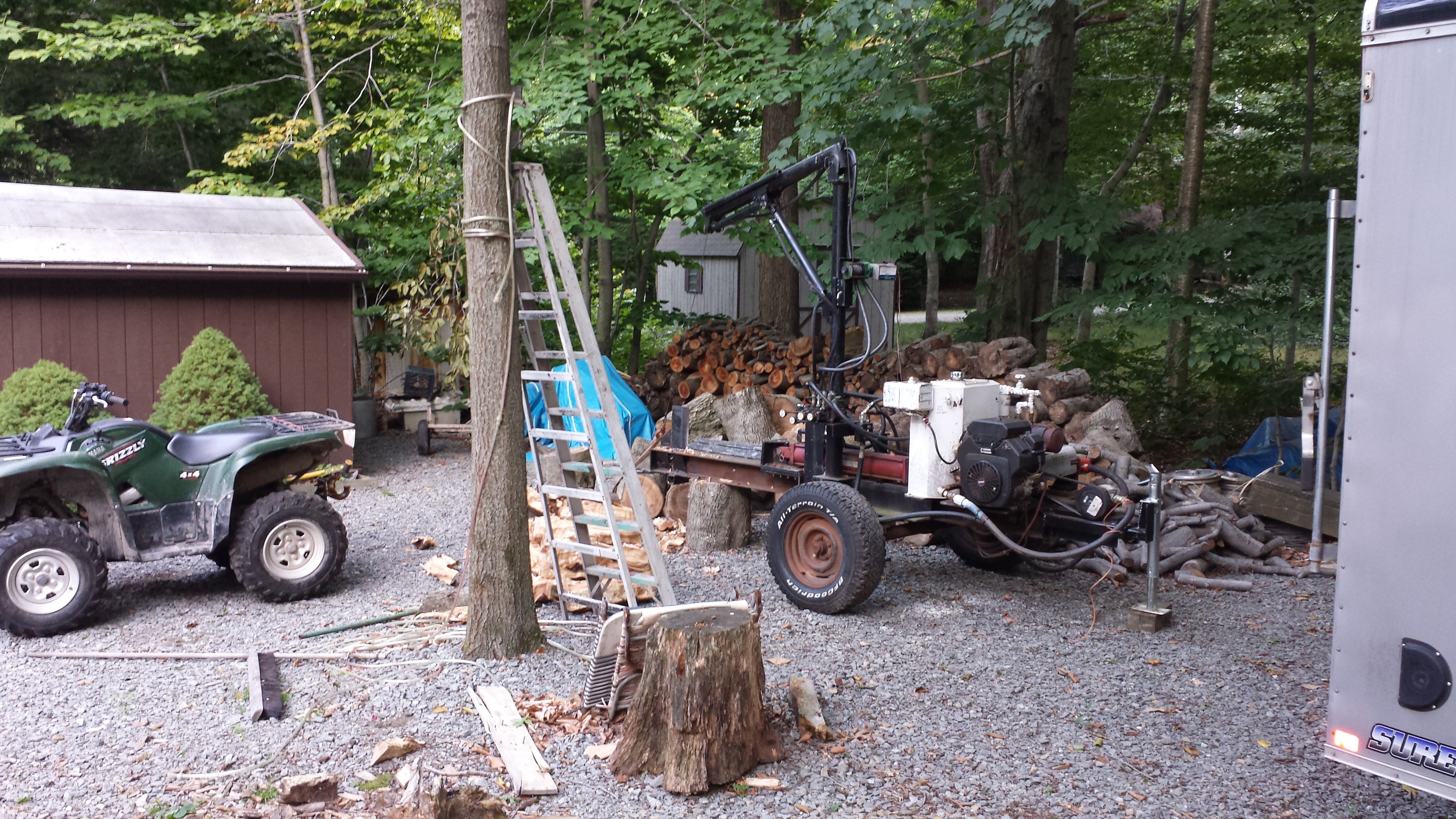

Very good build LD1, I take it the wood you split is for shop and o/s bon-fires. Pine and willow, hard wood for I/s. I have same cyl., but a horizontal shaft motor and pump that is on a splitter I got for $75. 4.5sec. out/3.5 in. Have to raise it up and add baskets, sits on axle with 8"tires. Way to low for this old fatboy, maybe 3pt hitch type. Anyways happy splitting...

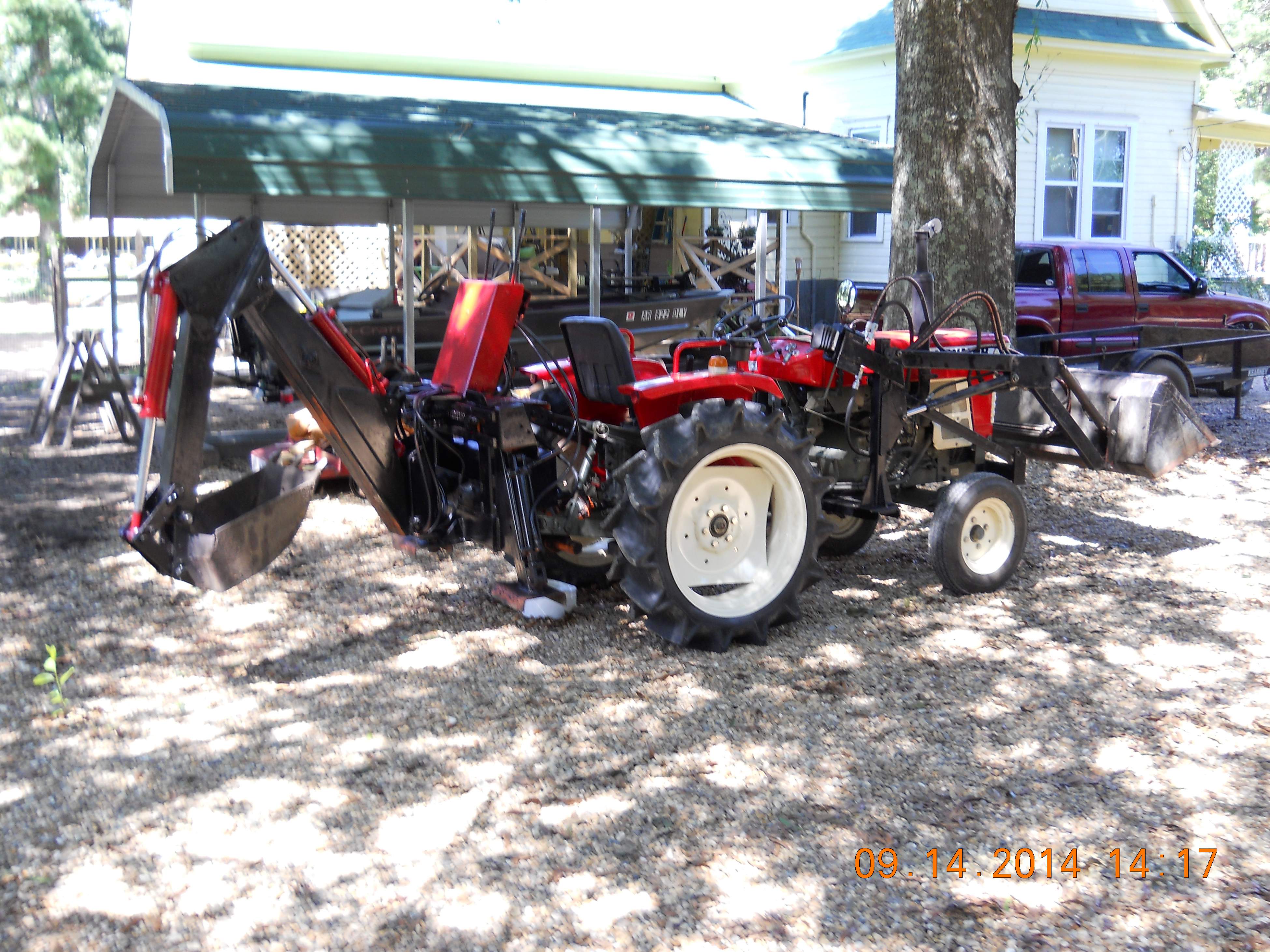

Thanks for the reply...
I will share my experiences once I get it all done. Was going to work on it this weekend but not so sure, with the snow coming and the cold weather. I am hoping to have it all hooked up in the next month to month in a half if the weather cooperates. Needs to be soon though as the wife is not happy I am blocking the driveway up for over a year now :)
I attached a pic of the first splitter that I built about 18 years ago. Works great, but as someone in this thread mentioned, once you build one, you will want to build another, and perhaps another.
