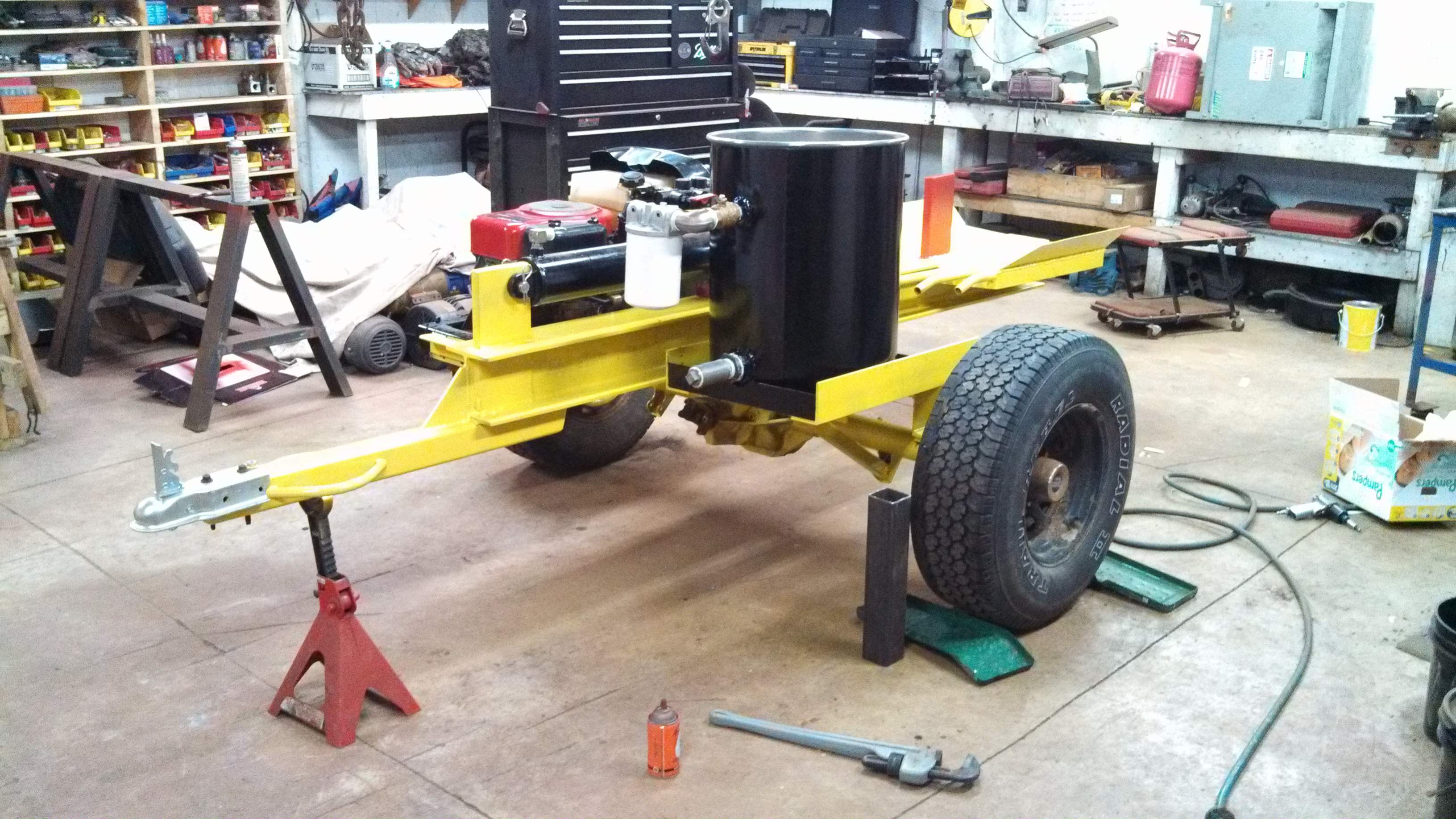

Looks good so far LD. Might consider putting angle iron on the wedge to help split apart the wood a little more. Strengthens it as well. This thing should e pretty quick with the 22 gal pump and 4" cyl. There is a company that provides this set up (Twist Eze?) They call it a "re-splitter" as it splits wood right quick. Return is quite fast for a hydraulic.

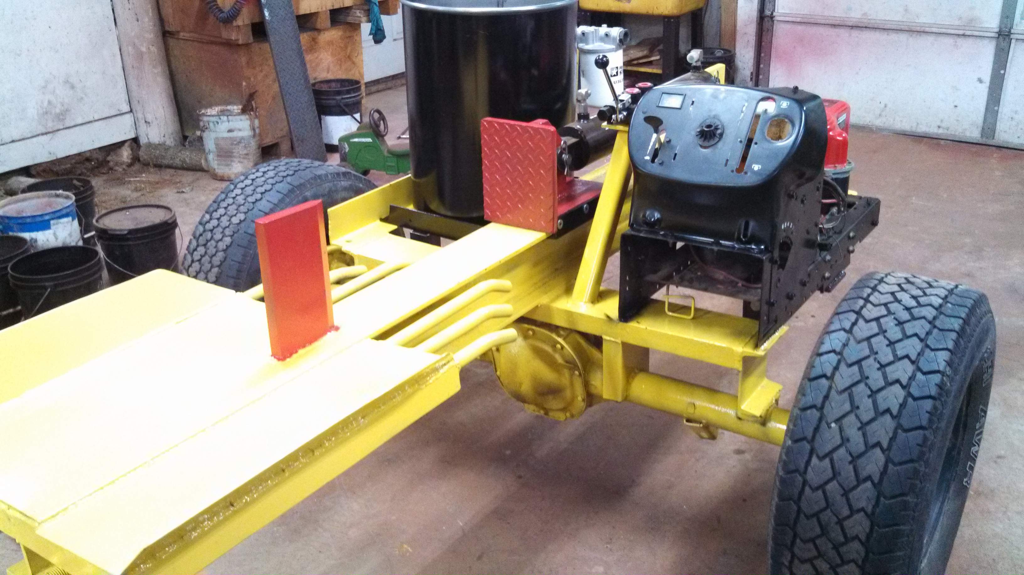

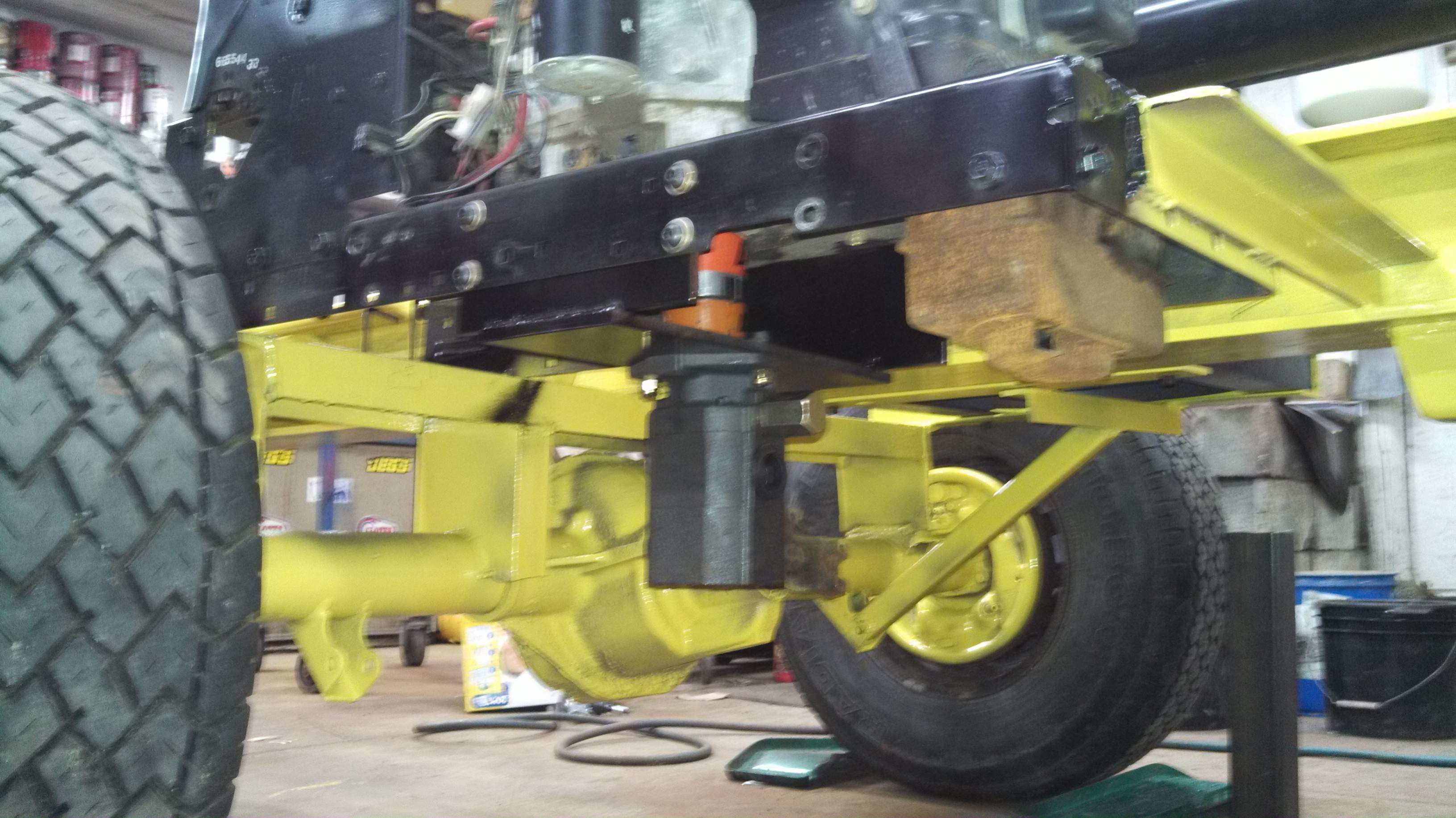

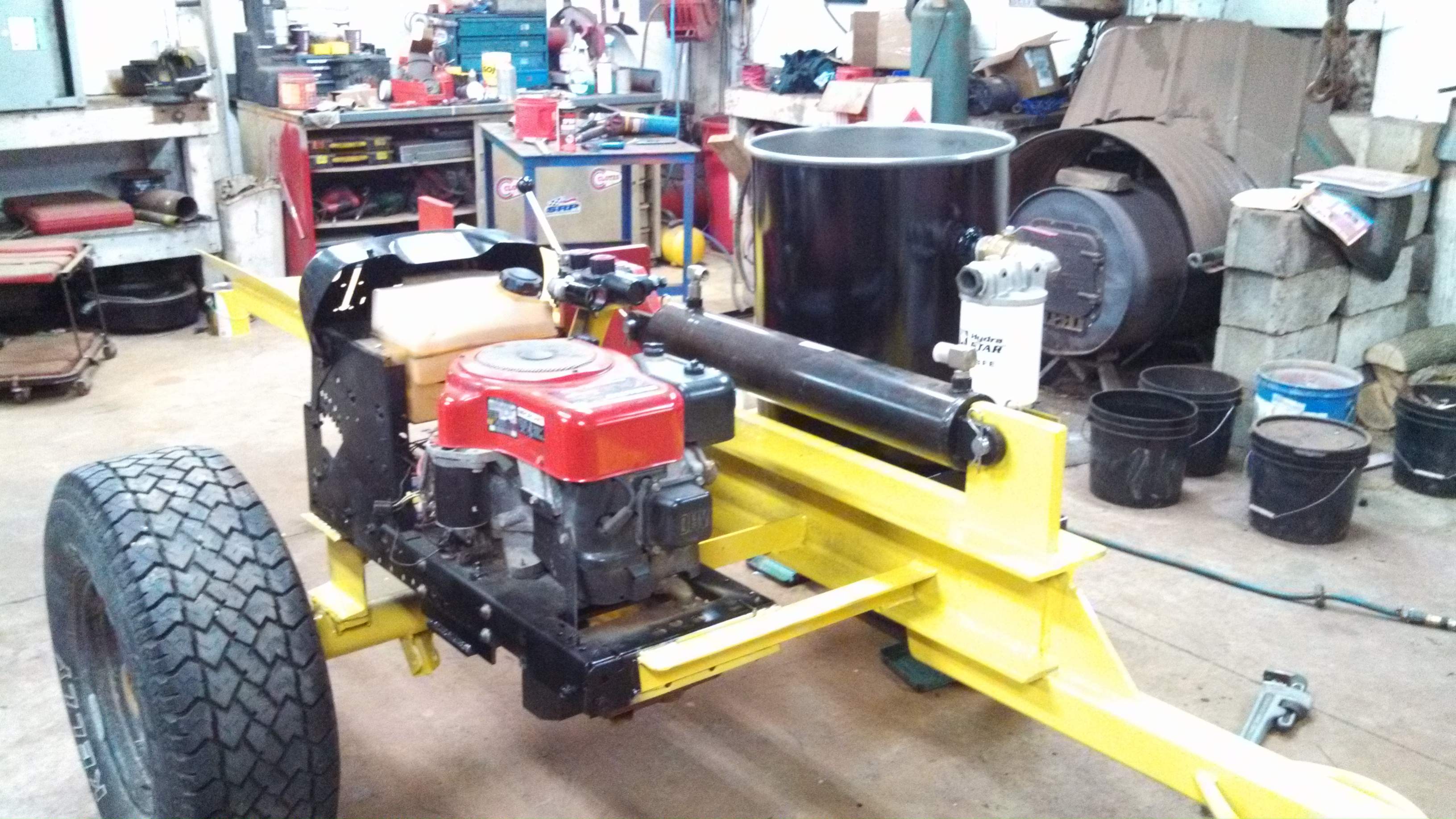

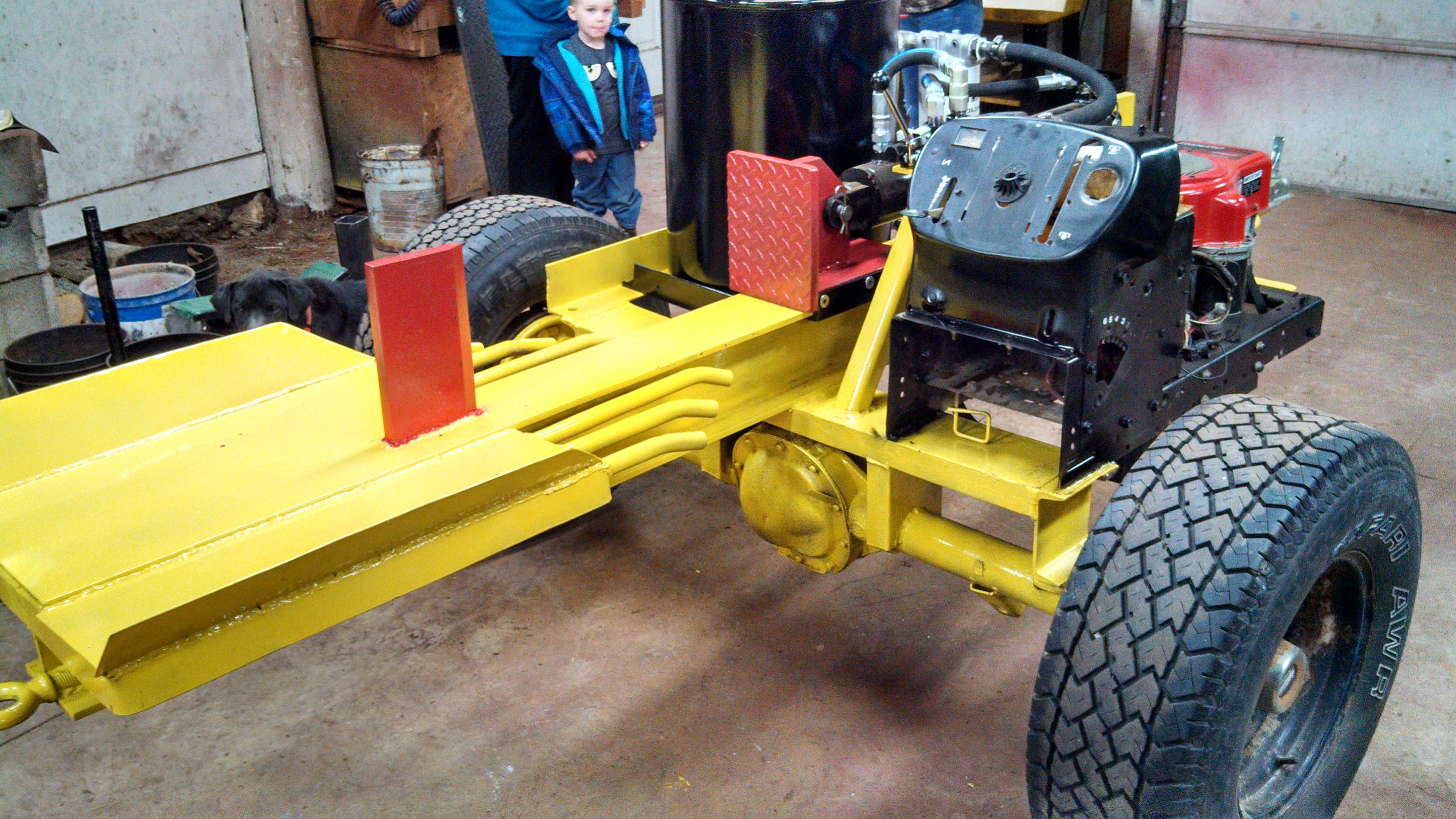

All done till hoses arrive. Except finding the key:mur: I ran across it last week cleaning up the shop and I put it up so it wouldnt get lost:laughing: Now I havent got a clue where...:confused2:

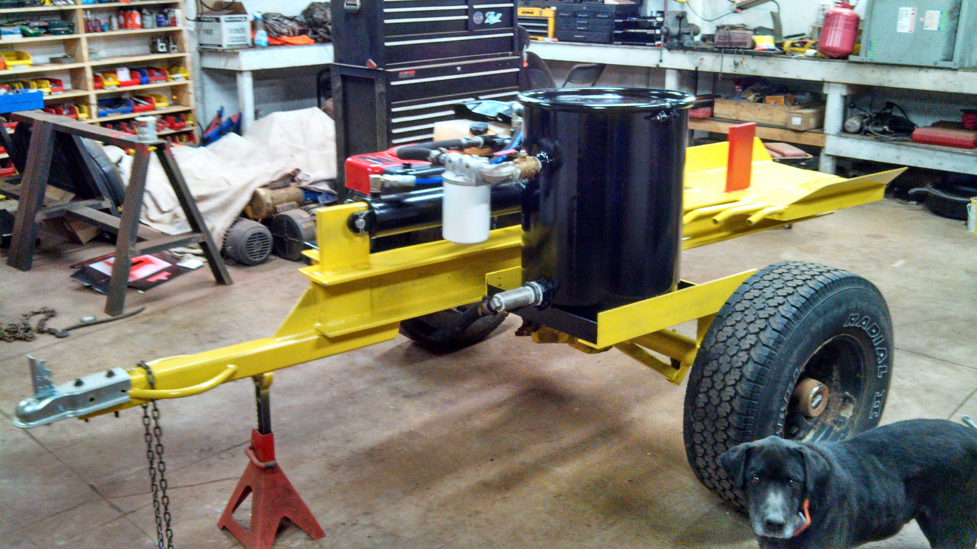

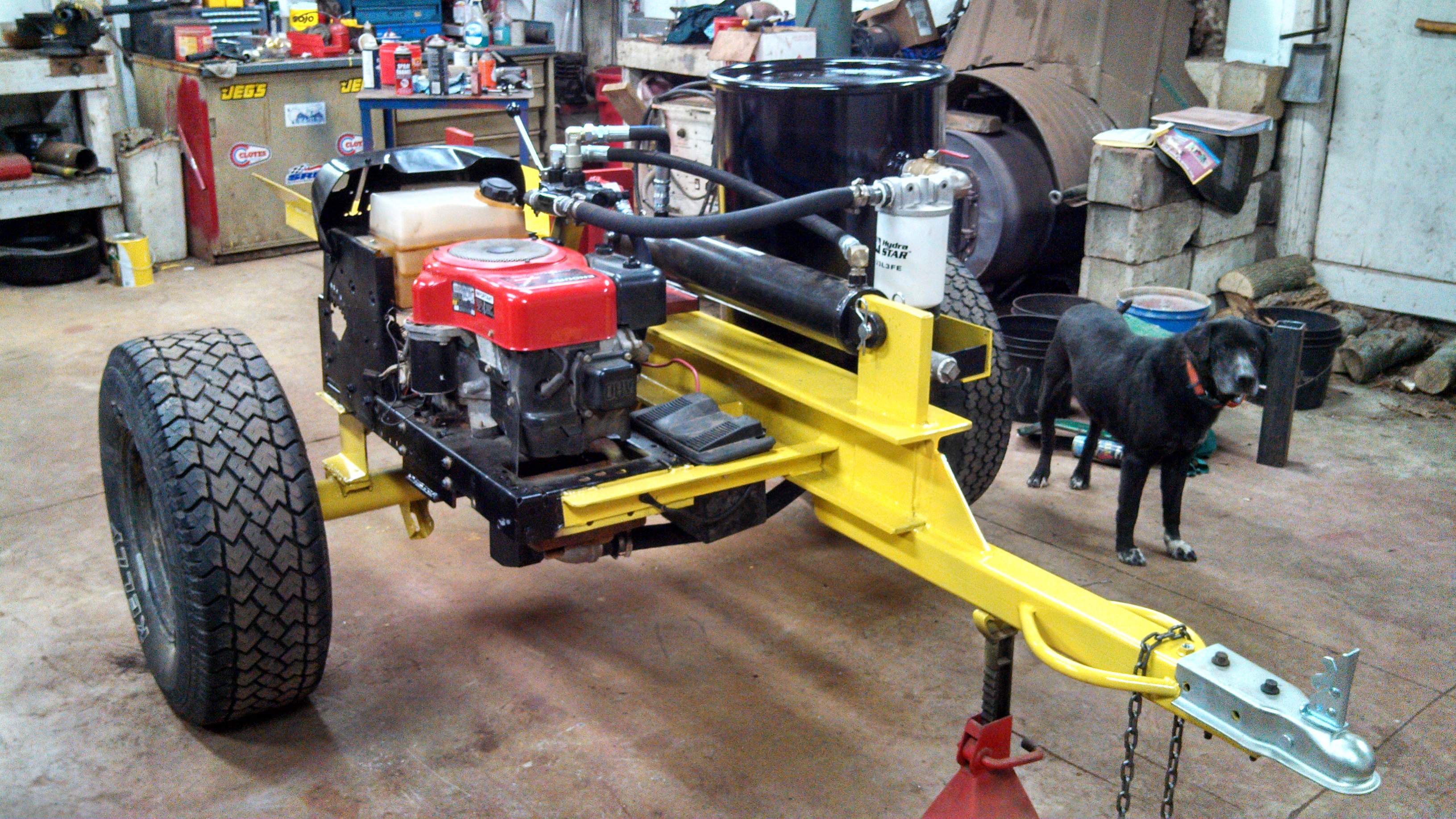

Got the hoses on last night so its officially a splitter now. I will look for the key for awhile again today. Then it may be getting a rewiring job...

   / My LOGSPLITTER Build #65
Looks great! Just need some new paint on the wheels and a jack stand! :thumbsup:
#66
Yea, I thought about doing the wheels but decided not to. They "were" powdercoated wheels. Prepping is a PITA, and I was out of black paint. And yellow dont cover well. Besides, I have plenty spares. So I wasnt too worried.
The jack should be delivered today. IT had to come from CA. But at least it is FED-ex. They deliver the earliest in the day. Usually around noon. USPS is ~2:00 and UPS is the worst @ 4:30-5:00

All done and everything works. Cycle time is about 4.5 seconds out and 3.5 seconds back. Total of 8 seconds overall. I am happy with that.
I dont think the engine runs 3600 RPM, wish it did. But sounds like it is closer to 3k.
I have a video but I have no way to post it. No youtube account or whatnot. If anyone wants to see a video and has ability to post for me, shoot me a PM with your e-mail address and I can send it to you.
