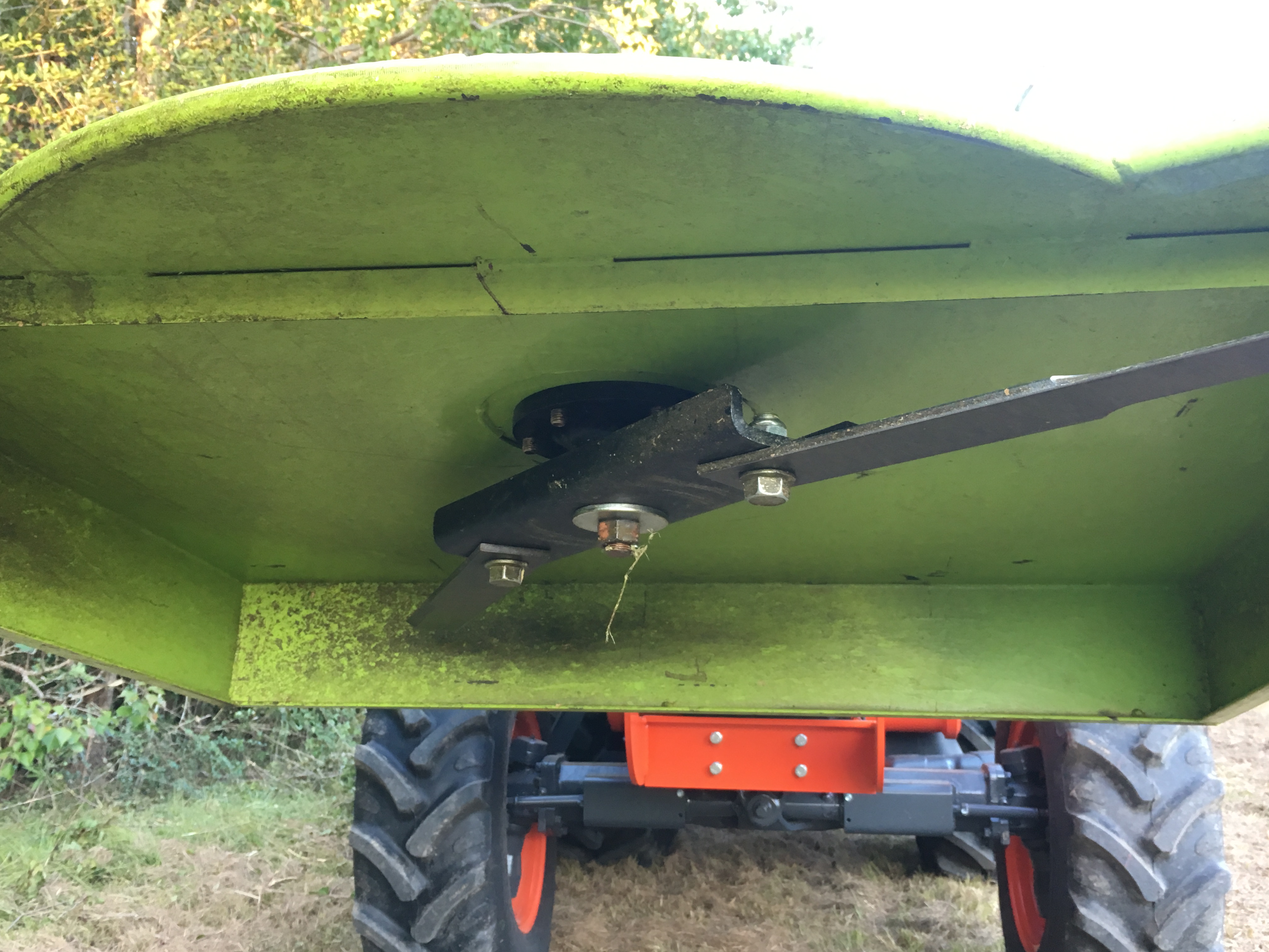

It is only supplied by one hose from the rear remote. The return line goes directly into the sump so it can free wheel. It is however, doing more than freewheeling while moving the loader boom, it is still powered and cuts very well even though it is likely more receiving full flow. Lots of stuff I cut while moving the loader would have stopped it in its tracks if it was not still receiving flow. There is not a huge amount of mass spinning and there is no flywheel or stump jumper as can be seen by this picture. Also if you look at there youtube videos you can see the unit cutting some pretty gnarly bushes while the moving the boom all the time, and that is with a MUCH smaller tractor.
