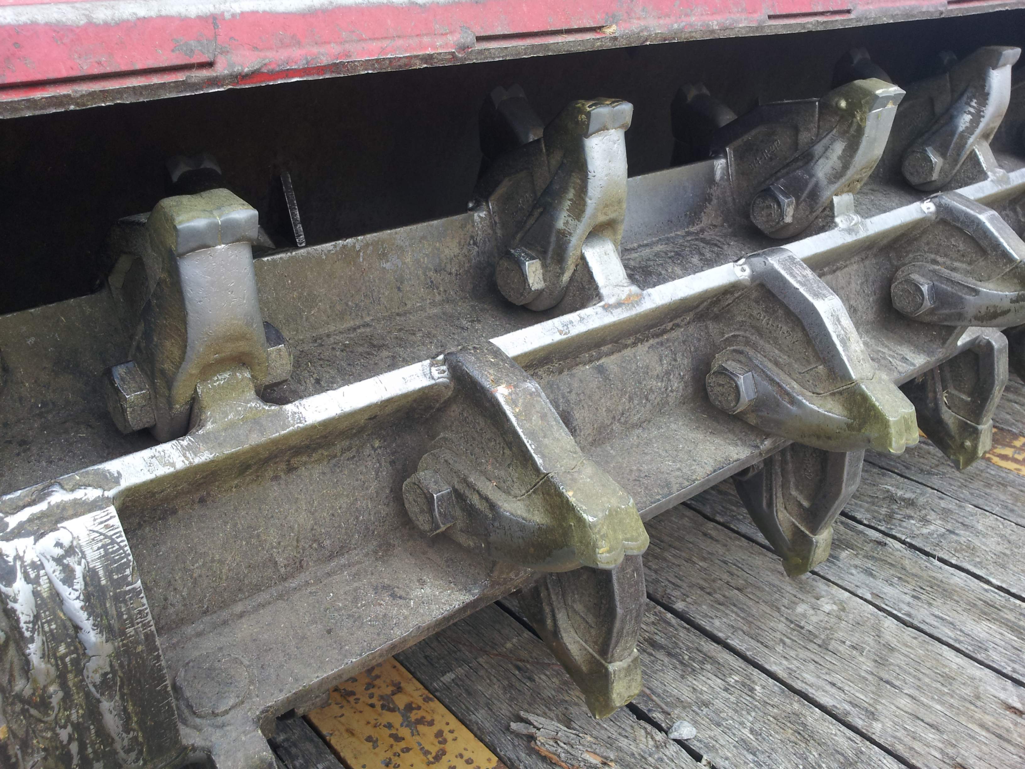

So on this link is the one you call blades the chipper tool? Tools - Fecon
This is the head I ran that I thought was crap. It plugged, took forever mulching, and would leave huge chunks of **** everywhere that would destroy tractor tires later and more of a mess than standing trees for what I wanted to do, pasture reclamation. I'm wondering if the "blade" would have been better? 20120917_143704.jpg

No, that is the pre-historic model, no offense Fecon. Very tough rotor but very old. The chippers they make for this rotor were not the best. You are looking for a large diameter smooth rotor similar to the one Bobcat has private labeled. I believe they have removed pictures of the DCR from there website. Your Fecon guy is Bob Candy (i think) call Fecon and ask for info on it.
Hmm. It would have been late summer of 2012 when I had them bring that demo out. I told them I wasn't spending close to 30k on that piece of crap :laughing:
This is the head I ran that I thought was crap. It plugged, took forever mulching, and would leave huge chunks of **** everywhere that would destroy tractor tires later and more of a mess than standing trees for what I wanted to do, pasture reclamation. I'm wondering if the "blade" would have been better? View attachment 391654
I run this head and swear buy it. I drive my ute over my work and have NEVER had a puncture in 8yrs. If you put the door on it leaves a completely different product. I run against FAE Loftness an will piss all over them any day of the week in any timber and terrain. A good workman never blames his tools
So the HDT is old technology or not as good as smooth drum? Here I've been wondering if I'm missing something running a smooth drum FAE (remember I'm in rocky areas) with a few chipper blades the middle of the drum.
My Bobcat dealer just got a new fecon head in with a smooth drum. Looks like the Bobcat drum but it's got a single bolt to attach teeth. I've been considering switching for FAE to Fecon to keep all my service in-house but can't get a demo to see what the shreds look like. My FAE leaves a pretty good finished product.
